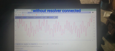

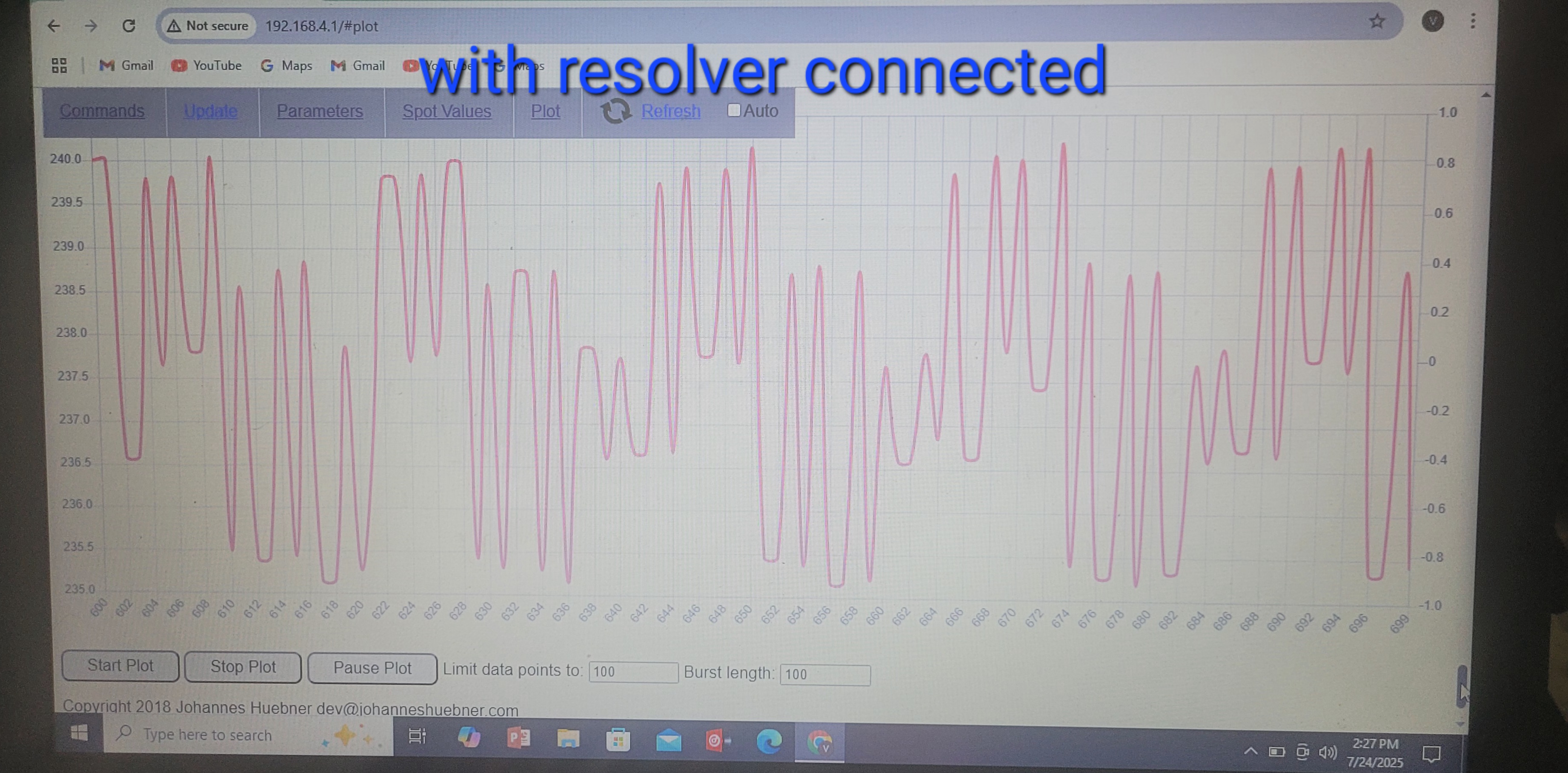

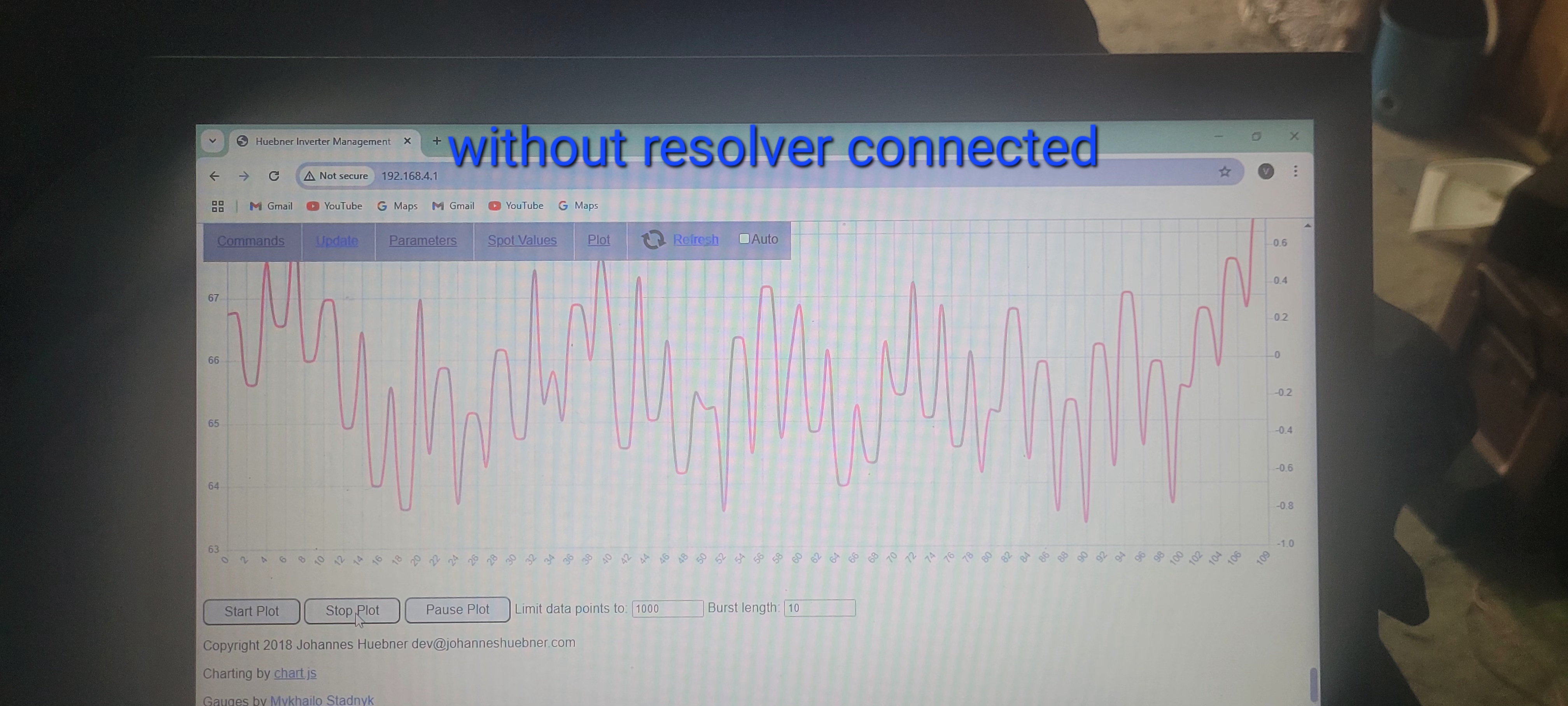

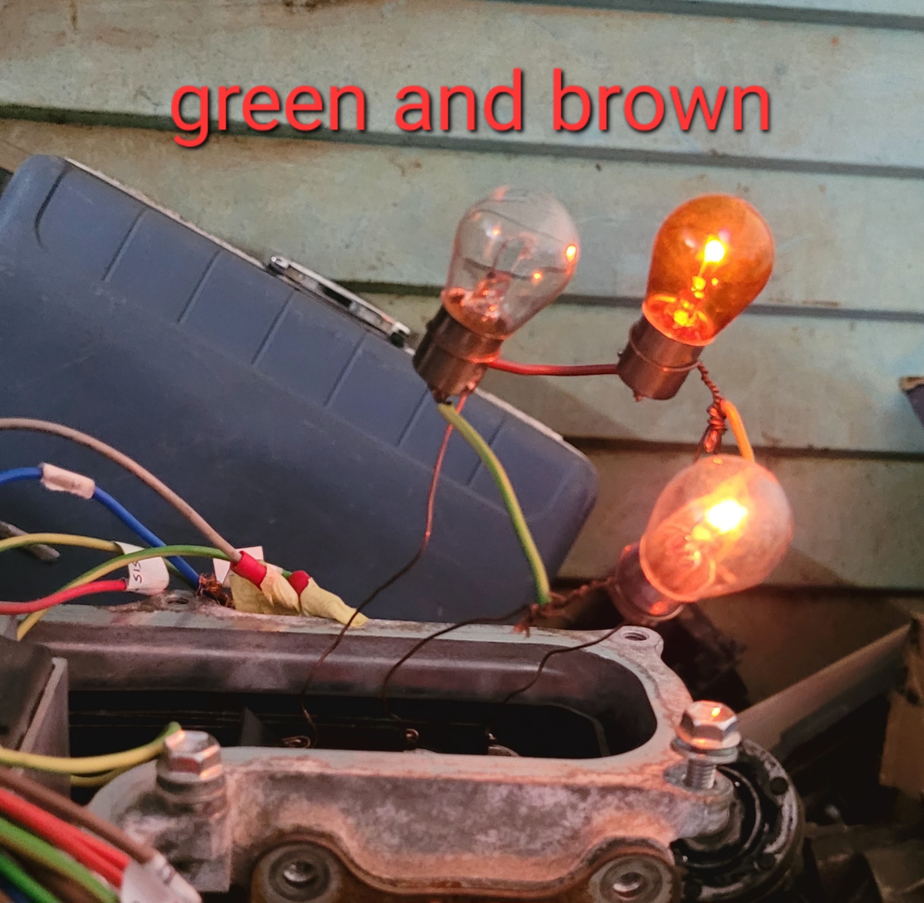

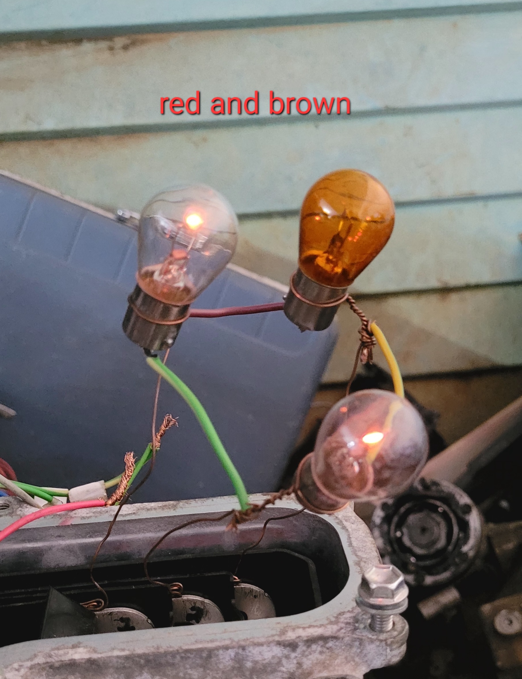

I'm home this weekend. And I'm here for the tests.
OK. I did two test of test for angle. One with the resolver connected and the other with it disconnected. The outputs were almost similar, just the graphs. What I noticed it when I spun the output shafts by hand, the graphs didn't change. But they stayed the same as when not spinning. I've attached pictures belows.
And when I say SHAFT I meant the cv axles and the engine output/input shaft to the transaxle. When doing this tests I was spinning both because none of them was responding so I didn't know what was going on
I have a question. The planetary gear set inside the transaxle is not yet welded to link Mg1 and Mg2 together thus making them rotate together like Damien did. Well not yet. So my question is why is the engine output/input shaft jerking more that the cv axles output. Because in my understanding the engine shaft is only connected to mg1 and since we are working with Mg2 the cv axles outputs should be the ones that are my main focus. But they are not responding. I hope I'm making sense.
At first I thought Maybe the parking pawl was activated hence why the Mg2 is not spinning, but I'm able to spin both the cv axles and also the engine shaft spins by hand.
But when I test spin the motor via the web interface, the motor jerks and the engine shaft seems to be the one more aggressive not the cv axles output.

Good to have this info. In order to rotate mg2, I would say you have to rotate both driveshafts in the same direction at the same speed. Input shaft is connected to mg1, correct. Planet gear turns on itself, so since it's not locked, you will not get identical outputs as per other setups.
Path of torque is via the easiest route, least amount of resistance, so planet gear and mg1, thats why the jerky input shaft.
For testing mg2, I suggest locking one driveshaft. The other one is what you will turn by hand (or long spanner) & recheck plot.
You are looking for 0 to 360 waves.

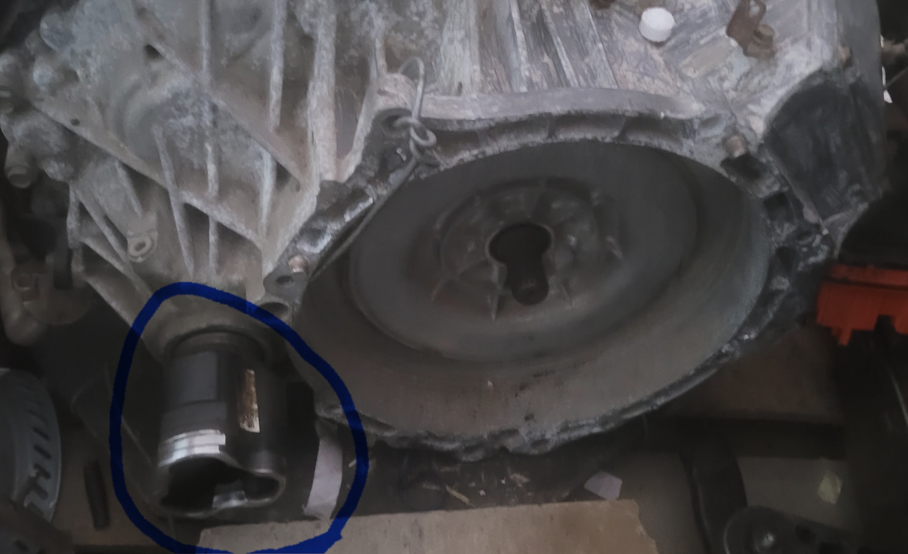

Say I lock the engine Input part.
The cv axles are too loose, They spin to easily like they are not connected to anything internally. While the engine input shaft is a bit harder to spin, you can feel that a whole lot of stuff is moving on the inside.
The cv axles on the other hand are way to easy to spin, like a fidget spinner. Is it supposed to be like that?

Cv axles are connected to differential, and planet gears. If not turned together in same direction, they turn around themselves.
See previous post. I would say you have to rotate both driveshafts in the same direction at the same speed.

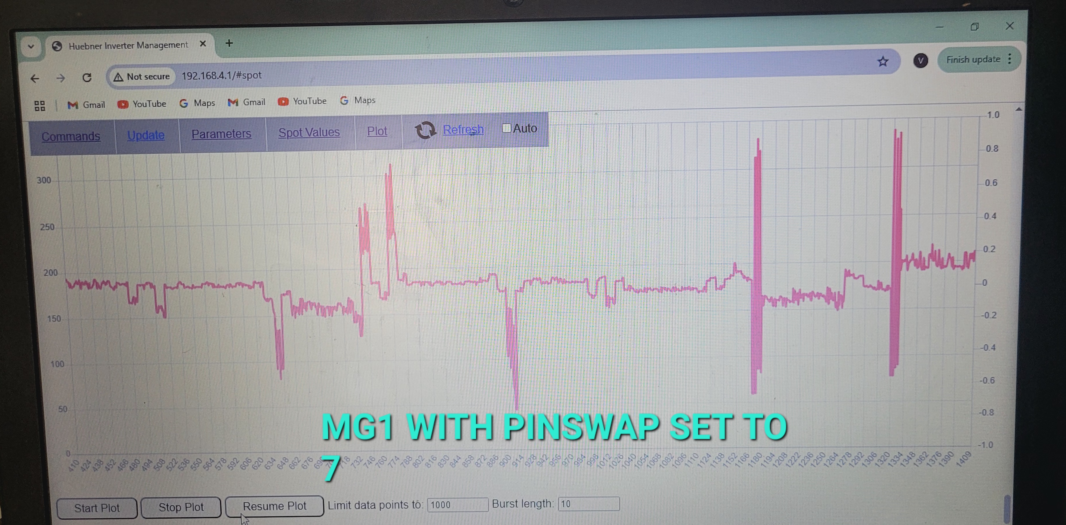

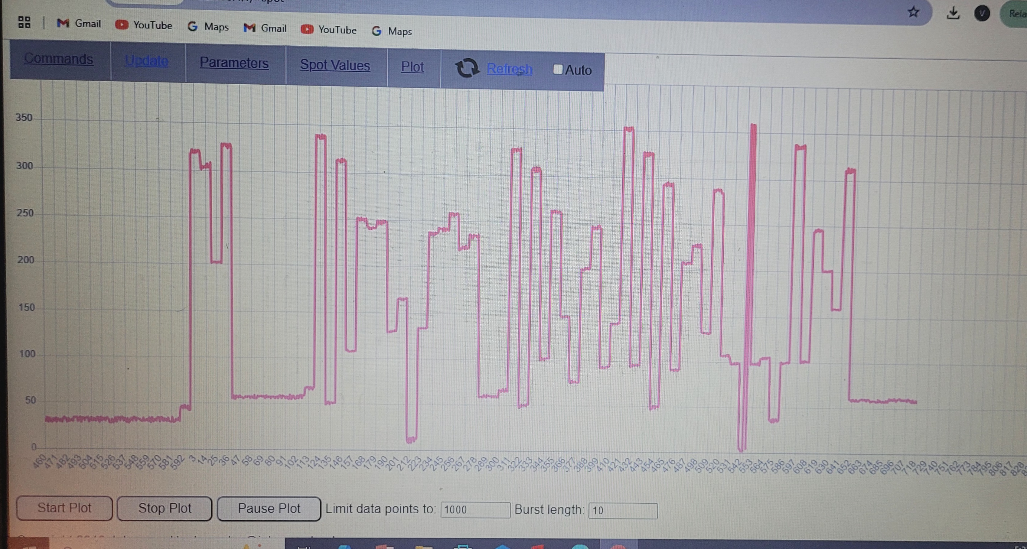

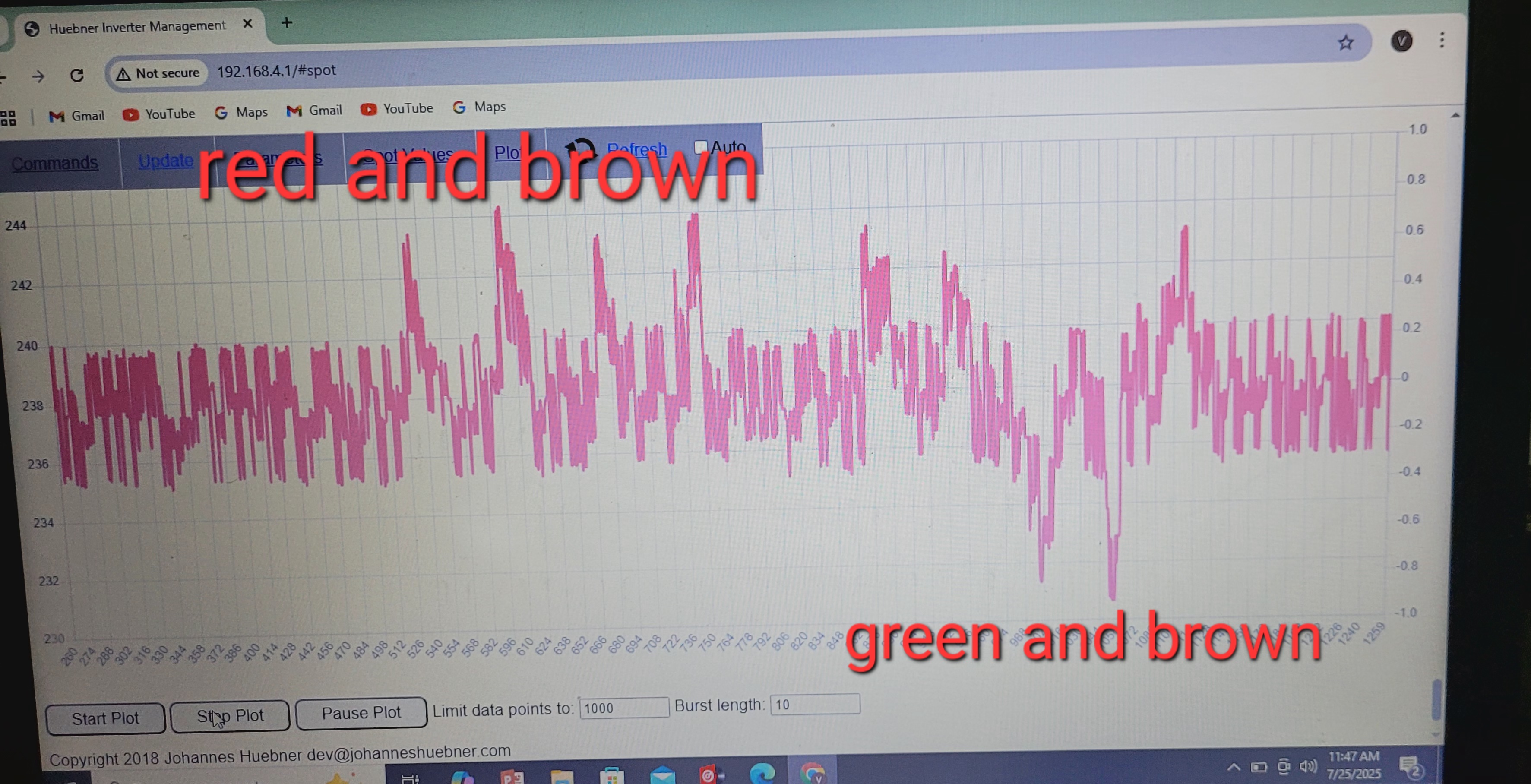

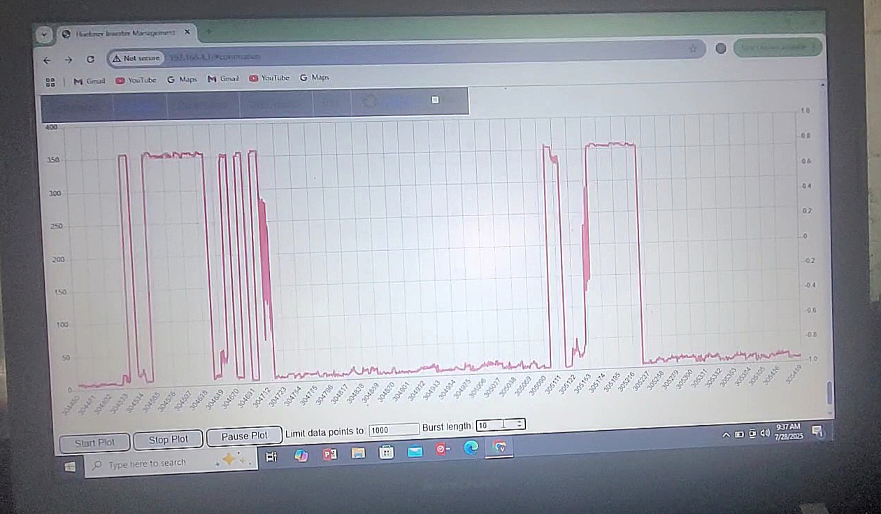

I've removed the acc pedal and connected mg1 to the three phase inverter output and also connected the resolver cable to it. What I first noticed with this is that the engine input shaft suddenly become stiff and very hard to turn. Prior when Mg2 was connected I was able to spin it by hand. But with Mg1 connected its hard spinning it even with a pliers, it's very stiff.
What I also noticed I there was a green led blinking on the control board. I also head a different whine sound coming from the transaxle and for a second there I had all three delta connected light bulbs all lit. I'm pointing out all this little details so you guys can be able to know what's going on.
Below I've uploaded a video of how the graph looked when I spun mg1 and I think I might have hit 0 to 360. Please check it out.

Ok. Getting somewhere. Do you have mg1 & mg2 phase wires connected to the Inverter? Mg1 difficult to turn means phases are supplied with voltage causing magnets to block the motor/rotor. Remove mg1 phase wires & isolate them. Block one cv output shaft & rotate the other with and without resolver wires connected to mg2. What does the graph look like?

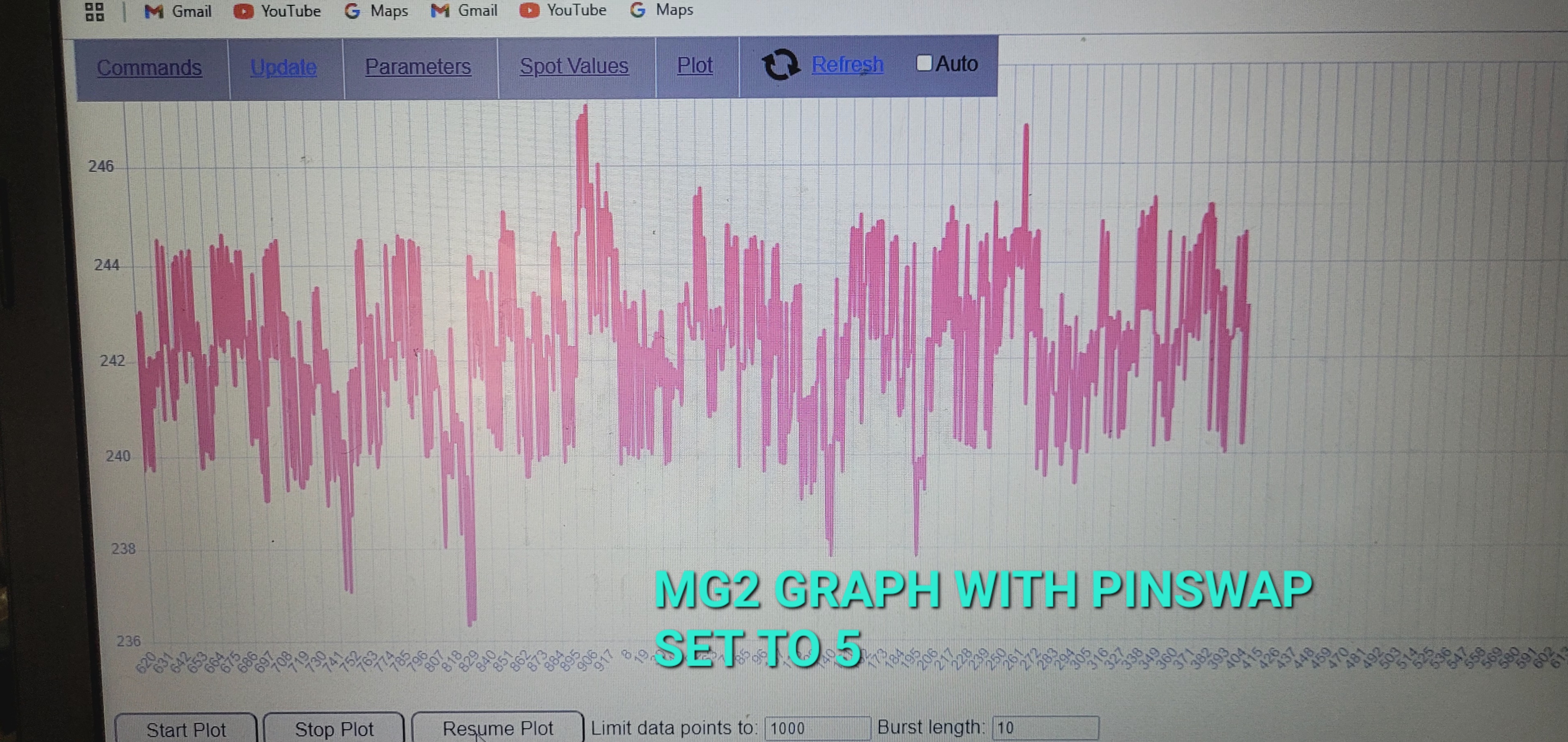

I removed mg1 phase wires, connected the resolver cable back to mg2 and tested again. The graph didn't hit 0 to 360. I've attached a picture of the graph below. When I disconnected the resolver l, the graphs showed no changes when the engine input shaft was rotated. What I also noticed is, I'm only able to get this readings when spinning the engine input shat. When I spin the CV drives shafts and lock the engine shaft nothings happens.
johu wrote: Mon Aug 04, 2025 4:41 am Just found this, maybe it helps viewtopic.php?p=37706#p37706
I confirmed my resolver configuration based on this post and found that I pretty much matches the way I have already have it connected. My brown and green are combined and connected to pin 2 while yellow is connected to pin 1 and red to pin 3. Then it's the exciter ones pins 4 and 5. What I noticed is that when I set pinswap to 7 like the post suggested l, I wasn't able to hit 0 to 360 with either MG1 and MG, while with pinswap set to 5 I was able to hit it with MG1.

Your graphs plot differently, pinswap 5 doesn't have the same scaling, it's not 0 to 300 like pinswap 7.
If this is automatic, pinswap 7 graph is what you want.
So with pinswap 7 and turning both cv joints, what do you get as a plot?

Oooooooohh man oh man. Now I get it.when you say lock one cv output it's because they rotate in different directions right????. Well for now but once connected to the wheel they turn in the same direction due to the force of the wheel.
Cool, I did that and man oh man that shaft was hard to spin. Infact I couldn't get it to turn on bit. Is it suppose to be this hard. Like it seems locked or some sort.

Are you sure the Park lock is not engaged? It should be difficult to turn, but it should turn from the cv joints. ( in same direction at the same speed)

I unscrewed the electronic mechanism and manually unlocked it with a pliers by turning the shaft.

Turns out my parking pawl was engaged all this time.
I was able to unlocked it and the shaft started spinning. Please see the attached below. I think k this is the saw tooth that's supposed to show and a clean 0 to 360.
