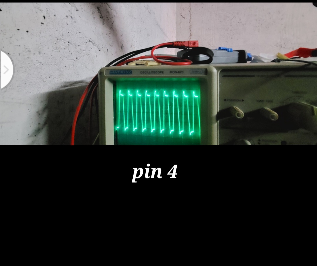

Coming to the resolver. Each time I connect it, everything just stops working, the light bulbs turn on but the pedal then stops working and when I press it nothing happens.
I disconnected the HV and tested pins 1 to 5 which are the resolver pins and tested for AC waveforms. I've attached pictures below of these waveforms for each pin. I've also attached a picture of the pins configuration that i also found on other topics.
Please remember that the only parameters I'm putting In are changing udcsw to 0, DefaultForward and adding values on manualid only. Should I still set ocurlim -1 even on the new FOC firmwares updated version that i'm using now ?

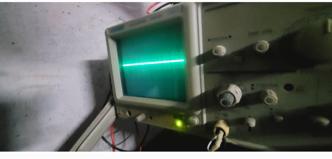

Re: EV Conversion using prius gen 2 inverter/transaxle
Swap the brown and the red.
Also try completely disconnecting the phase cables and check if you get a steady 0-360 sawtooth pattern when turning the shaft by hand. Plot setting is burst length 1000, data points 1000

I swapped and connected the brown and red. On pin 2 I'm reading a straight line and pin 3 nothing. My yellow is still connected to pin 1 and my green is now connected on pin 3
I've also attached pictures of the patterns I got when spinning the motor manually.
I had my resolver disconnected when doing this test.
