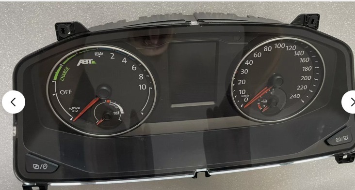

Do you have a place to go for a custom cluster disc ? I want the rpm disc of my Porsche 986 to have the style of the abt t6

Making dials is no problem. In the picture it looks as if it is translucent, i.e. the lighting comes from behind. For this, an acrylic glass would first have to be laser-cut. There are online suppliers for this on the Internet. Then print directly, e.g. https://hd-xxlprint.de/. The laser cutter needs a DXF file, the printer needs adobe illustrater or pdf. You would have to do both according to your wishes.

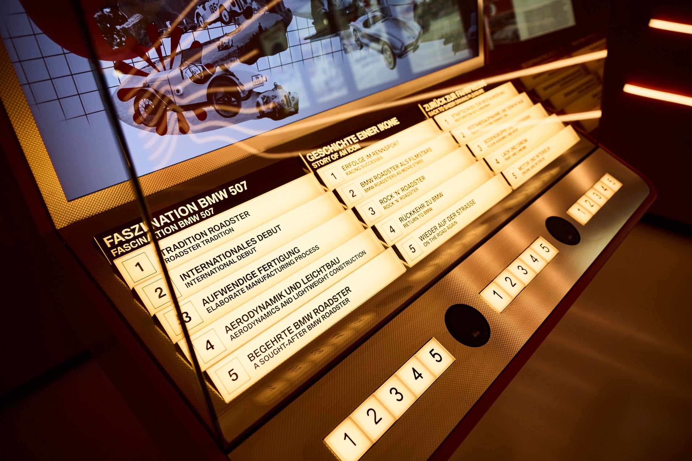

I haven't had any dials printed for cars yet, but I have had other things printed for the company. For example, these backlit letter boards on a fake jukebox for BMW.
