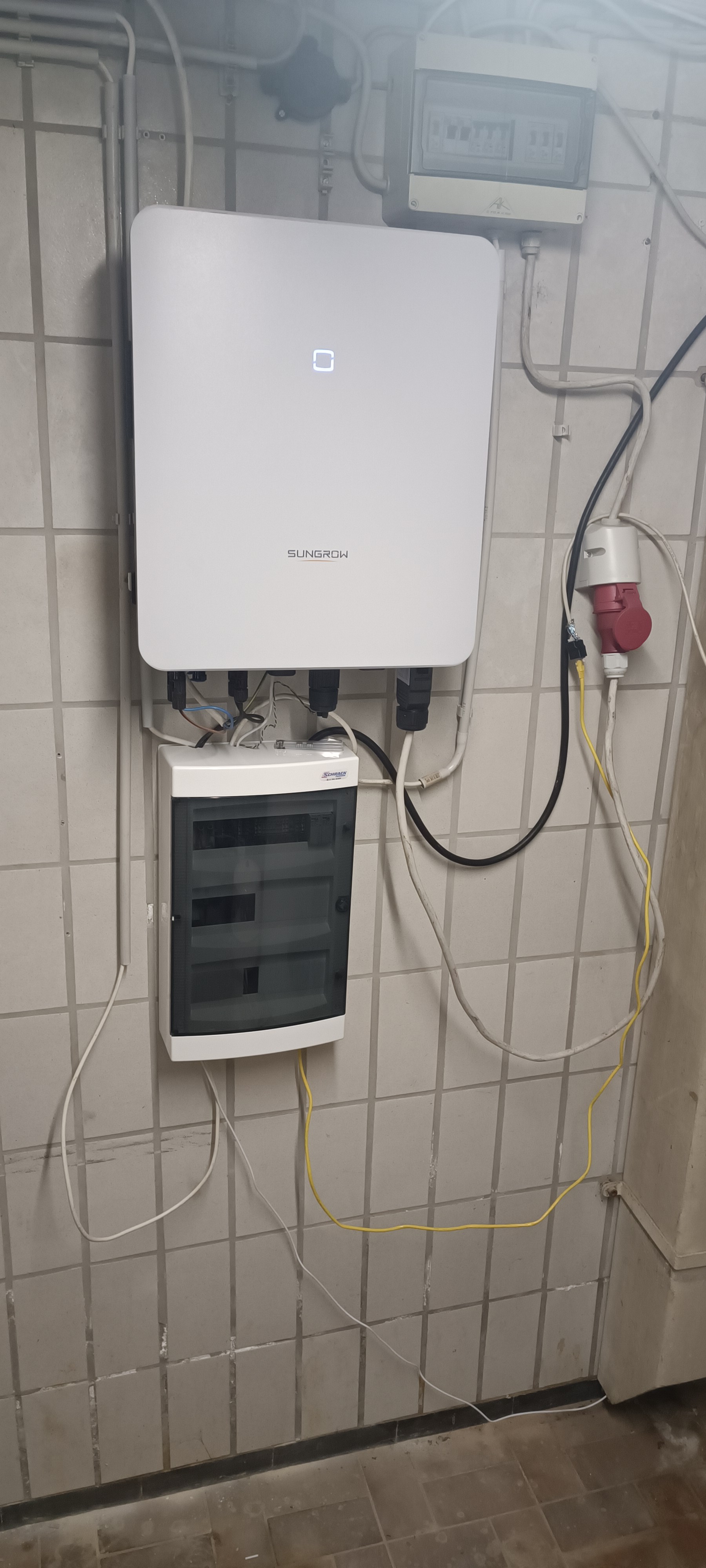

Re: Bidirectional charger with PV Hybrid inverter and pyPLC
So far I haven't. The inverter stays in standby mode if there is no sufficient voltage on the battery input (or PV I suppose)
I'm trying to pull some more data from the inverter.
I found modbus register 5147 (5146 0-based) contains bus voltage. While the inverter is not running and assuming there are no PV panels attached then bus voltage is equal to the battery input voltage. When running it looks like the boost converter becomes active and voltage rises to 600V
On the CAN bus I also found some stuff that is not yet in BYD-CAN.cpp
0x091:
(byte[2] << 8 + byte[3])/10 is battery current
(byte[4] << 8 + byte[5])/10 is inverter temperature
Also battery power is reported correctly. I sent a dummy value of 360V but the power (register 13022) is actually based on the physical voltage. So that is one way to obtain present voltage, just divide by current.
I ran some tests with the little HV supply. I was hoping it would deliver the threshold voltage to start up the inverter with 0 power. But it already takes minutes to charge up the very small input capacity. The inverter does indeed change into Startup mode, at least that's a bonus. But it then seems to realize that the input voltage isn't stable and returns to Standby mode.
Not quite sure where to go from there. Since it takes very long to precharge the inverter there is no use in turning on the HV supply on the point. It would need to be always on and keep the inverter precharged and ready to run. Have to check how long it takes from setting the parameter to it actually transferring power.
This could also mean I'd need a relay to direct the precharge voltage away from the CCS connector. I think OEM cars will be angry if they see voltage outside of CableCheck, PreCharge or CurrentDemand
EDIT: wait... the capacity inside the inverter is behind a diode. So as soon as the HV supply is off, there is no more voltage on the CCS connector. So then we don't need a relay.
EDIT2: the new plan!
- System is off (i.e. hybrid inverter, 5% PWM, PLC and HV supply shut off)
- CCS is plugged in denoted by 5V on PP pin
- Power up inverter and HV supply (set to 500V)
- After some minutes inverter is precharged and ready to run
- Start 5% PWM and PLC, shut down HV supply
- Inverter should remain precharged as its DC bus discharges rather slowly. DC bus voltage does not exit the inverter as it's behind a diode
- In CableCheck fire up HV supply again
- In PreCharge apply cars battery voltage by slowly pulsing the HV supply (maybe attach a 1u cap to its output)
- In CurrentDemand bring up inverter and shut down HV supply
- When we reach a SoC limit or press some button on the EVSE side power down, then exit the CCS session when current is gone
- If the car exits the charge session try to shut down the inverter quickly
More thinking out loud
Measured some times (bus charged to 370V, well above threshold of 160V):
0:00 Send start command
2:15 Standby to Startup
2:25 Click
2:45 Start Boost
2:50 Error
Then the HV supply, cranked up to the max setting: It takes 6 minutes to reach 370V and doesn't go any higher. As expected voltage drops very quickly when turning it off and steps right back up to bus voltage when re-enabled.
So now we have to time the CCS state machine to connect the battery at around 2:30 minutes. The big question is, how will cars react if they see voltage before CableCheck? I think this should be avoided, making it even more challenging.
So we precharge the inverter to 370V and as soon as we enter state CableCheck we need to turn off the HV supply
Then:
For cars that don't time out we can proceed to CurrentDemand as quickly as possible and the car will just sit there until the inverter has started up. This makes stuff much simpler:
Tested the above with Touran (well it had to work as it doesn't care about port voltage). What was more interesting was the timing.
Started with 370V on the DC bus. From plugging in to Current demand took 25s and bus voltage had sagged to 348V (Battery voltage 366V). CableCheck and Precharge went through so quickly that the voltage change didn't even show.
Currently electricity is expensive so I'm sucking energy from the car: Not super precise but should be good enough. Target values are maybe written every 5s, not quite sure how modbus4mqtt works in that regard
(Sorry for posting charger related stuff in the other thread: viewtopic.php?p=79001#p79001 )
For completness, also mentioning it here: To apply a HV voltage to the DC lines, I use this modded step-up converter: https://github.com/dalathegreat/Battery ... age-source In pyPLC I then just try a few PWM frequencies, until the car is happy: https://github.com/lewurm/pyPLC/blob/cd ... #L303-L339
However that doesn't work well if the inverter is on the same line, as the capacitor in the inverter would take aaaaages (I tried, and stopped after 30min). For my inverter, Kostal Plenticore Plus G1, that wouldn't work anyway: The protocol essentially requires to apply HV voltage to the battery input at a given time when the inverter asks for it. So matching that timing with the PreCharge of the car is kind of impossible.
Instead I'm using three contactors (one with a precharge resistor, although I think that one wouldn't be strictly necessary in my case). I only start communication with the inverter once the car is in CurrentDemand and thus only once in this state the inverter can request closing the contactors.
I'm using this: https://www.te.com/de/product-2071584-4.html
With this setup the car (Tesla Model 3) is in CurrentDemand within less than 10s after plugging in. Until the inverter then finally (dis)charges, it can take up to two minutes. Not great, not terrible
No physical interaction with the inverter is needed in my setup, which was particularly important because the inverter is located in the basement.
I should mention that someone wrote a tool to interact with the web API of the inverter, and that allows me to toggle battery support of the inverter programmatically, which makes it overall more predictable: https://github.com/lewurm/pyPLC/blob/cd ... 1105-L1117

Big update on this. I have removed the old 1.5 kWh storage system and now rely solely on the Sungrow inverter to shift all the power around
To give the inverter something more to do I connected some PV panels to it:
In summer this yields 2-3x more energy than I use on a typical day. Will now stick a dumb heater in the warm water reservoir and replace some natural gas with it.
I've ordered a small cabinet to tug it all into
I connect V2x and the stationary battery via a changeover relay. It would be great to change over from the stationary to the car battery without powering down the inverter.To give the inverter something more to do I connected some PV panels to it:
