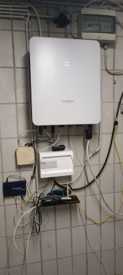

Finally got around to make this look nicer.
Tied everything together in one box
Looks more tidy with the lid on
Whole system
And finally even did some labels
My label "machine" doesn't have a + sign. But I have a bit of a thing for outdated equipment ;)
Will connect the inverter directly to the distribution box above it and free up the the CEE outlet for the traditional EVSE. Plus some more cable management and it should like real shiny :)
Functionwise does the same as before

johu wrote: Wed Jul 02, 2025 7:03 pm Big update on this. I have removed the old 1.5 kWh storage system and now rely solely on the Sungrow inverter to shift all the power around
I connect V2x and the stationary battery via a changeover relay. It would be great to change over from the stationary to the car battery without powering down the inverter.
To give the inverter something more to do I connected some PV panels to it:
In summer this yields 2-3x more energy than I use on a typical day. Will now stick a dumb heater in the warm water reservoir and replace some natural gas with it.
I've ordered a small cabinet to tug it all into

jrichl wrote: Mon Mar 16, 2026 12:23 pm but isn't it risky with the different voltage levels of the car, and the voltage level the inverter still has from the stationary battery before switching.
No.
You turn off the inverter which seems to open a relay internally, disconnecting the bus cap from the input or just leaving it connected via a high value precharge resistor.
Then the switch occurs.
Then after a minute or so the inverter turns back on.
At least that's how Sungrow works. Not sure about others.
