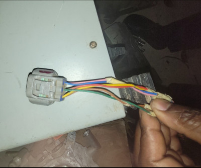

I connected my resolver the way Damien did in the tutorial video. Is it correct or should I change to
pin 1 = yellow ( enc b)
pin 2= green and brown (sin a and cos a)
pin 3= red ( enc a)
pin 4 = black r1
pin 5 = white r2
For excitation I have blue and pink not black and white.

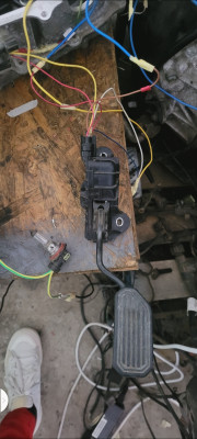

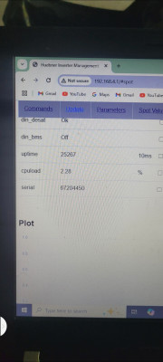

I changed my resolver connection today and connected it as pair discussed in the screenshot attached below.
I tested first without it connected and I got the same results of having the Delta connected light bulbs connected on the inverters three phase output light up and turn off again continuously. The inverter goes into run mode when I set udcsw to 0 and this blinking behavior then starts even before I put any numbers in the manualid. Please see video attached in comment above. On angle when the light bulbs started blinking an angle of 63 degrees showed up even without the resolver connected.
Then after I connected the resolver and shortly after setting udcsw to 0, the light bulbs turn on and they stay lit. This time around they don't blink but they say lit. When testing with a scope the PWM wave shows but it doesn't move. It stays in one position. On angle under spot values the angle was 239 degrees but kept changing by a value of 1 either increasing or decreasing when I pressed refresh even without turning the drive shaft.
I went on to connect the throttle pedal also with the discussed instructions on the screenshot below and tested with both the resolver and the pedal connected. Now the light bulbs didn't turn on and the inverter didn't go to Runmode it stay off even after setting udcsw to 0. While on previous tests I set udcsw to 0 because that was the only way I could get the inverter to go Runmode because even with manual start turned on, the inverter would still be on opmode> OFF.

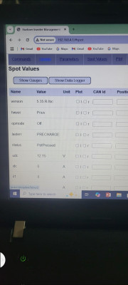

When I had the throttle connected STATUS on spot values first showed "PotPressed" and on another test it said "UdcBelowUdcSw|PotPressed" .
Please see attached pictures.

Just to be sure.
You have 2 seperate batteries. 1 for 12v circuit, & another for High Voltage circuit. Can you check that they are well charged.
In spot values, please report back on UDC voltage & Pot1/Pot2.
The pedal should read 0 , if not, it requires setting. I think there is a set-up in the adapter board thread. Once set up correctly, check by pressing the pedal all the way and verify you have 100%
UDC should read the same as your battery ' HV'

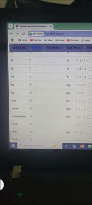

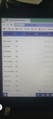

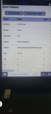

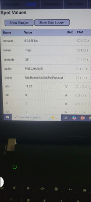

Below I've attached my entire spot values, please go through and check for all the settings you want to see pot1 and pot2 and any other that are important for testinh stage.. Also please check for faults that might appear.
I'm planning on connecting a high Amp 12v battery for my next test to my HV supply. On UDC now it says 11.87v.
I forgot to mention that now that I have connected both the resolver and the throttle, I cannot get the inverter to go on manualRun. Even after setting udcsw to 0, It stays off.

@voti: the screenshots are hard to read. Please just attach the contents of http://192.168.4.1/cmd?cmd=json instead
UdcBelowUdcSw means bus voltage (udc) is smaller than udcsw . So at this point it cannot have been at 0

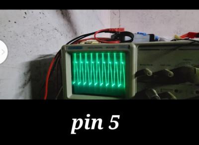

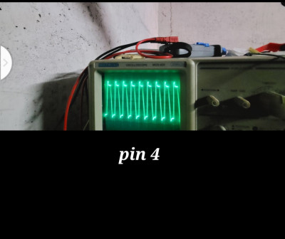

I disconnected the HV and tested pins 1 to 5 which are the resolver pins and tested for AC waveforms. I've attached pictures below of these waveforms for each pin. I've also attached a picture of the pins configuration that i also found on other topics.
Please remember that the only parameters I'm putting In are changing udcsw to 0, DefaultForward and adding values on manualid only. Should I still set ocurlim -1 even on the new FOC firmwares updated version that i'm using now ?

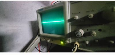

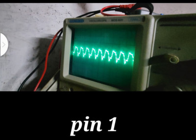

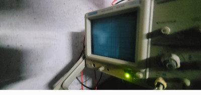

I swapped and connected the brown and red. On pin 2 I'm reading a straight line and pin 3 nothing. My yellow is still connected to pin 1 and my green is now connected on pin 3
I've also attached pictures of the patterns I got when spinning the motor manually.
I had my resolver disconnected when doing this test.

I popped the hood ( remove dusty cover first) and went to look at resolver wires, as I can't remember what was done and how.
Resolver - Pin 1 - (Blue) = Adapter board pin 4
Resolver - Pin 2 - (Green) = Adapter board pin 1
Resolver - Pin 3 - (Yellow) = Adapter board pin 3
Resolver - Pin ? - (Pink) = Adapter board pin 5
Resolver - Pin 5 - (Red) = Adapter board pin 2
Resolver - Pin ? - (Brown) = Adapter board pin 2
I had the car running with this config....hope it helps

RetroZero wrote: Fri Jul 04, 2025 8:20 am Resolver - Pin 5 - (Red) = Adapter board pin 2
Is that a typo or do they both go to the same pin?

They both go to the same ground référence.

First things first, when the resolver is connected, the transaxle doesn't jitter when I put in the parameters and press the throttle pedal. But when I disconnect it and press the pedal it jitters. So I'm guessing my resolver cable is messed up.
I tested each strad from the resolver cable and also tested the combos (Green and brown) and also (red and brown). Please see attached pictures and tell me what you think.
RetroZero

Can you connect the resolver back and turn the transaxke by hand, replotting the angles in the User Interface as you did in earlier post?
voti
Posts: 120
Joined: Wed Oct 02, 2024 12:35 pm
Has thanked: 17 times
Been thanked: 11 times
Re: EV Conversion using prius gen 2 inverter/transaxle
Post by voti »
RetroZero wrote: Sun Jul 13, 2025 6:14 am Can you connect the resolver back and turn the transaxke by hand, replotting the angles in the User Interface as you did in earlier post?

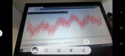

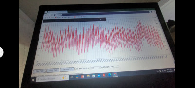

I did, just that I didn't post the outcome. What I noticed was that the straight line that appeared on the scope when I had connected brown and red to pin 2 of control board, when I turned the transaxle by hand the straight line didn't change but the faint waveform that appears noisy on the background of it seemed to be moving when the transaxle was also moving.
Should I connect the brown and green or Brown and red.
Below I've attached a screenshot of the pattern that appeared on the plotter
My big problem is I don't know which of the two is correct.
Why is it that when not connected to pin 2 the Sin/Cos does show a waveform but once connected to the control board it fades and only a straight line appears on the scope. It's a bit visible at the background of the straight line but faded out. I hope you understand what I mean.

The plot you are showing doesn't seem to be the correct value. You should see your angle go from 0° to 360°
see here - https://openinverter.org/forum/viewtopi ... 780#p56780

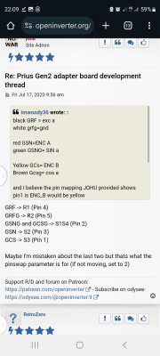

arber333 wrote: Fri Jul 17, 2020 11:48 am Re: Prius Gen2 adapter board development thread
ReportQuoteQuoteThanks
Post Fri Jul 17, 2020 1:48 pm
Quote
RetroZero wrote: ↑
Throttle pedal from gen 2 prius:
Pin 1 - VCP2 = PIN 6 - 5V
PIN 2 - EP2 = PIN19 - GRND
PIN 3 - VPA2 = PIN 8 THROTTLE 2
PIN 4 - VCPA = PIN 6 - 5V
PIN 5 - EPA = PIN PIN 19 - GRND
PIN 6 - VPA = PIN 7 - THROTTLE 1
Again, good if someone with experience with this could validate.
See here the pin positions: viewtopic.php?f=9&t=335#p3772
You probably have the 2gen pedal with wider pins. I used one in mazda https://mazdamx3ev.wordpress.com/2016/02/12/pedal/
Pin 1 is the lowest pin on connector when pedal is installed.
This is how I have my throttle pedal connected
RetroZero
Posts: 945
Location: France
Has thanked: 624 times
Been thanked: 64 times
Post by RetroZero »
Before getting to throttle, can you disconnect it and check what value you get for angle before going further? Lets confirm 0-360 form then move on.
