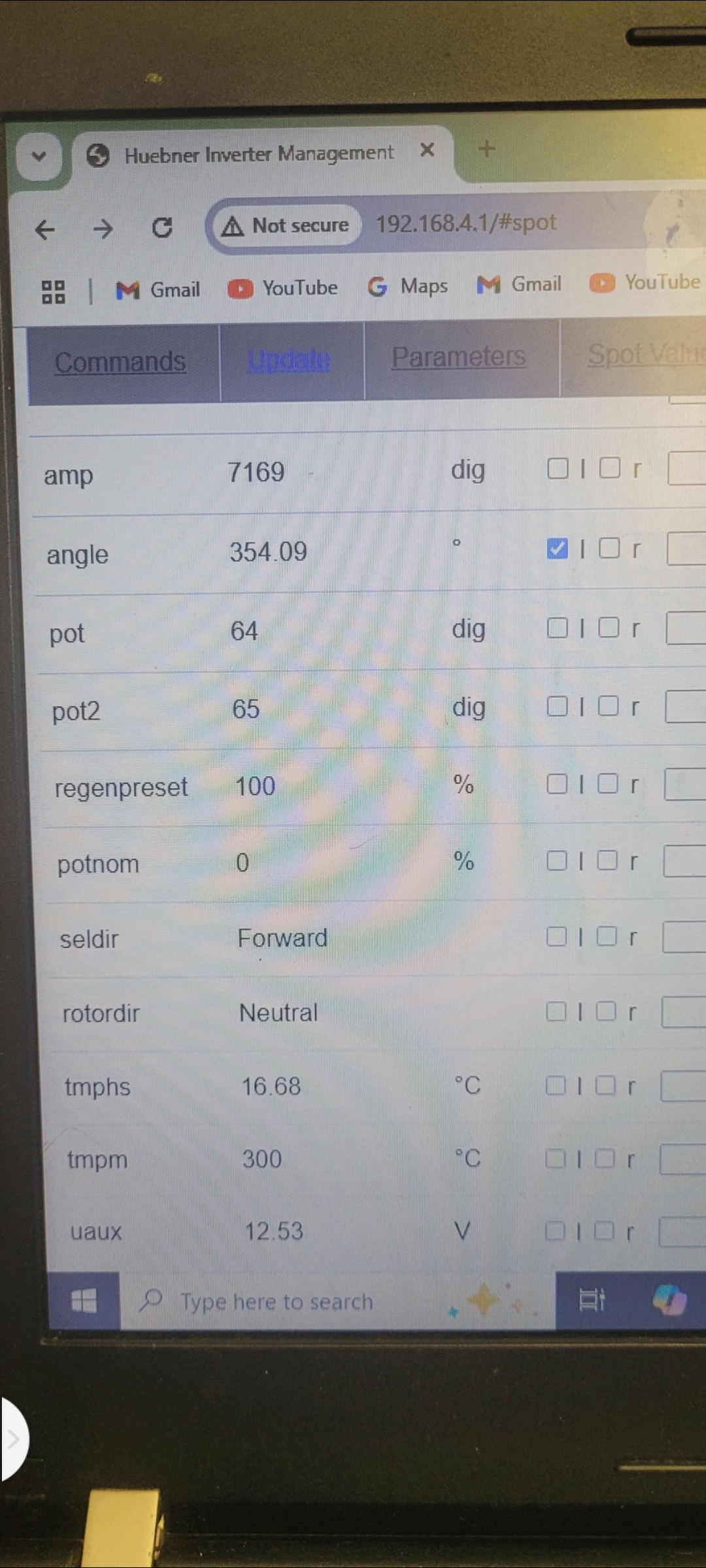

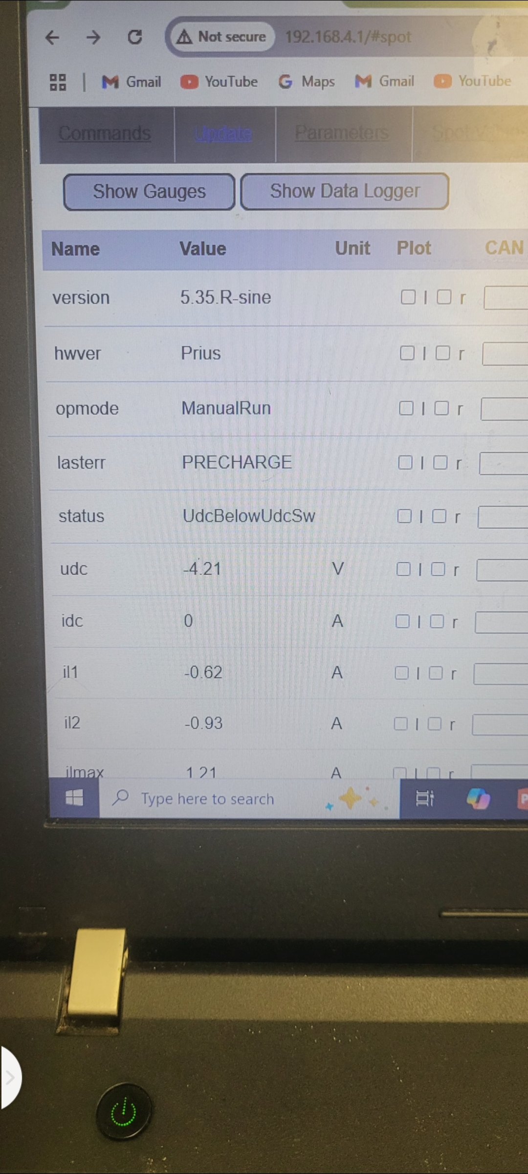

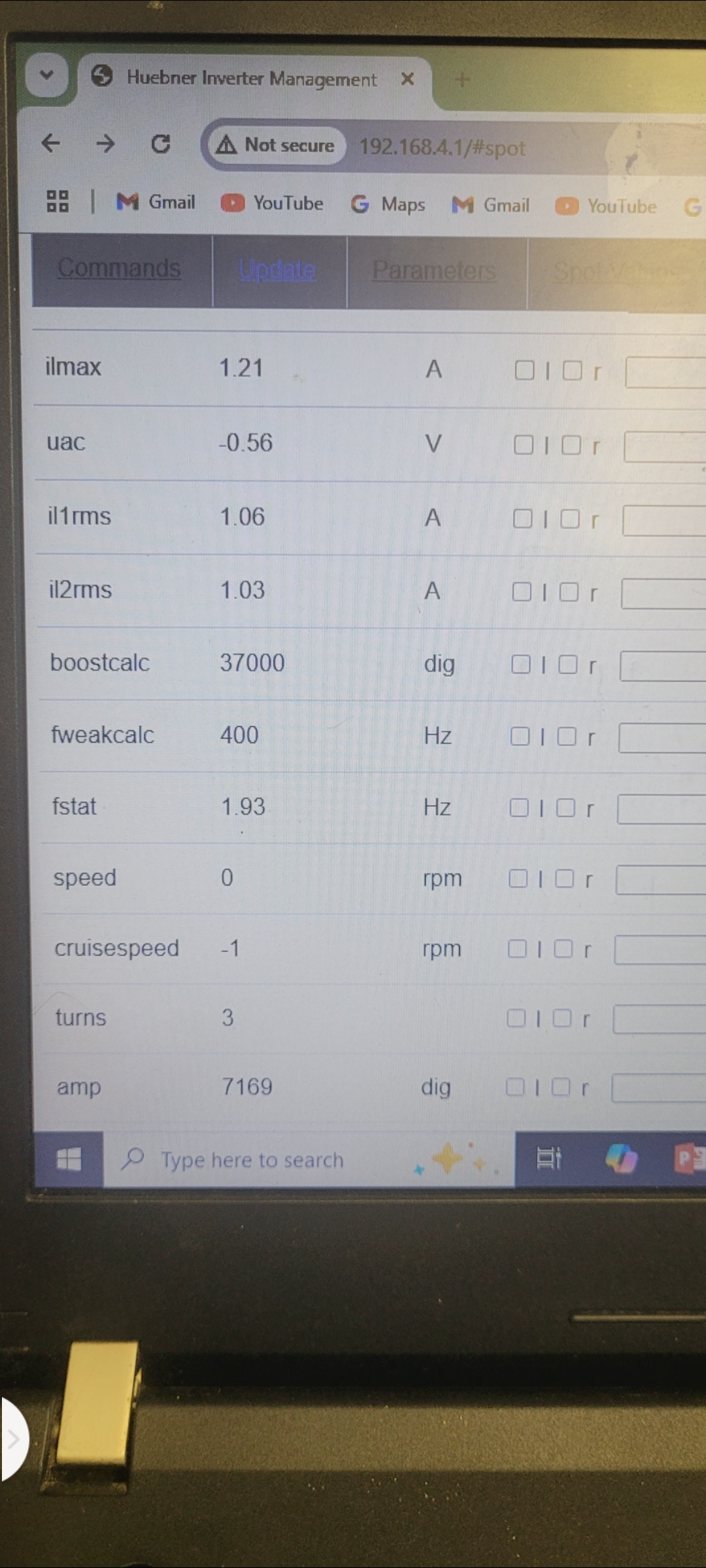

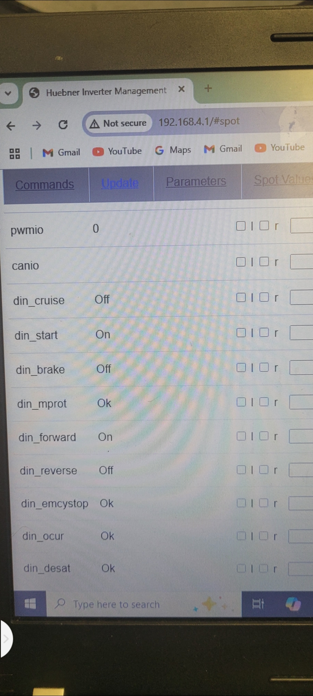

I connected my resolver and on the spot values I got an angle reading, does that mean that I've connected it correctly ?
Even with the resolver connected I still could t get the motor spinning, which is sad.
I've taken screenshots of my spot values for you guys to please go through and see if my parameters are OK.
What I noticed was I had my "laster" on PRECHARGE, I don't know it it should be like that because as I followed the video and put in some of Damiens parameters, it changed to TMPMMAX and opmode at that time changed to RUN. During that stage the light bulbs connected on the inverter output stopped blinking meaning the was no PWM coming out.
Following the video I also noticed that Damiens web Interface had settings light manualid and some other manualiq or something. Mine doesn't, should I be worried?
Im stuck and I don't know what to do next.

Didn't look through everything, but first mistake: you haven't flashed FOC firmware https://github.com/jsphuebner/stm32-sine/releases
