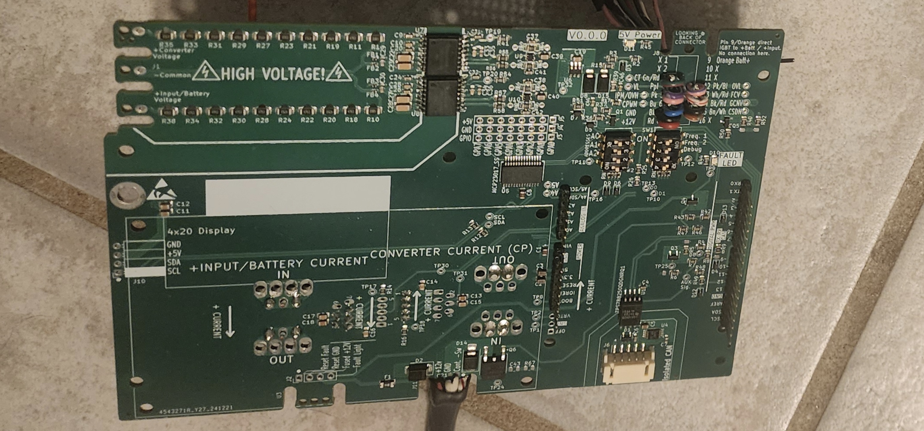

I have a project that will need to pull energy from a 96s ~380vdc battery (1% of the time) then be able to put power back into the battery (99% of the time) that I am doing a bunch of research and testing on. I will respect all of these projects and use none of them if this goes into production. I will also be giving back if this works out. Time is short and its a lot to get this together for testing using existing oem hacked hardware and open source solutions to bridge the pieces together. I can't currently discuss the details of the project past:
- the working voltage will be 12-48v and about 8kw max. of energy generation.
- This 12-48v will have to be boosted to push the energy back into the Leaf pack. It has to stay 48vdc, direct to ~380vdc wont work.
- there may be times the motor controller will be run as a motor to get it moving, then switch to regen mode so a bidirectional dc-dc is ideal.
- I made a 48v GaN motor control board for this (sorry, won't be open source) for the generator side of things that is pin compatible with VESC for testing and future repurposing for/by the DIY community. Max voltage is 100vdc for components but will be kept to 48v in this application. This is the only pc board so far that is meant for this project that's done (but not tested.) The rest will be piecing stuff together to do testing.
- There may be multiple generators with their own motor controllers.
- has isolation between voltage sections
- I do have an isolated 3.3v current sensor rated for +/- 40A on the motor control board for the DC power in / out (a bit under 2kw.) It also has an unpopulated shunt across it so I can adjust the range if needed.
I have spent a lot of time searching / researching / watching Damien & Johu's videos for this bidirectional DC-DC part but I'm coming up short. So where I'm looking for direction / clarity from the group is:
  • on hardware I'm thinking late Gen 2 Prius or Gen 3 Prius inverter to use the boost converter - Which would be recommended (or something else)? I have not been able to find enough details so far to help choose which would be ideal. I've seen the boost converter can fail in the gen3 where gen 2 seems bullet proof.
  • I think I only need the bidirectional DC-DC / boost converter so the rest of the inverter might be gutted to make room for whatever is needed.
  • what inverter connectors will I need for the inverter to use the DC-DC?
  • if I have the dc-dc pwm set to say 14v, will anything on the generator side past 14v be pushing back into the traction battery? I think the motor controller running as regen control will be able to control the power output from each generator as the current control.
  • I found celeron55's prius3charger_buck software for gen3 Prius. This wont be plug and play for my testing but is a great starting point for this testing.
  • Does any standalone hardware exist for running the boost converter? Looks like Damien's gen 3 board has it for celeron's code, any others? I might just do an arduino or spin up a quick board (might have one with some 7 segment displays i could use...) but I'm unsure of 5v? 3.3V? in the boost converter. Most projects / discussion is around AC charging, hard to find info about DC.
  • Do i need a precharge resistor for the dc-dc by itself? Plan is to tap off the PDM for the traction battery voltage.
  • Anyone know the capacitor value in the boost converter?
Any guidance or different ideas are appreciated!

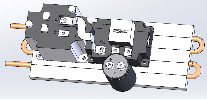

I got a 2008 Prius inverter and pulled the inductor and igbt out. I need to put them in a different housing to fit this in my project and will need water cooling based on where its located.
I really couldn't find any hardware to run this directly. I'm making an Atmel 328P board to run this along with a 4x20 display. I'll share my results as I make progress on this.
Thanks for the info johu. Your video along with the charging wiki page, https://openinverter.org/wiki/Operating ... pplication helped a bunch to wrap my head around this.
jrbe
Posts: 595
Has thanked: 212 times
Been thanked: 173 times
Re: Bidirectional DC-DC 48v to 400v
Post by jrbe »
I just got this running at low voltage for some testing over the last 2 days.
I was able to amplify 20.0v input up to 196vdc at 5khz and 10% duty cycle wired as it is in the Prius.
Flipping the power and the igbt sense wire to CP so input is on CP instead of on the far side of the inductor it reduces power. Using 9% duty cycle is a 10:1 reduction, so 10v in equals 1v out.
Both tests are at low current, testing with a 2k ohm 225 watt resistor at first then I'll move to higher power tests once stable.
There is a 3x power surge when turned off so I'm working on some pwm voltage sense to shutdown the igbt if it senses brownout / power dips too far.
This is using a high side switch to apply +12v to the IPM enable and pwm circuit.
The csdn is turned on after a short wait after pwm starts. This will also be switched off if the pwm supply voltage falls below around 7 volts, the igbt starts glitching / shutting down around there.
I'm only planning on using a fixed ratio for my project. But this could be a great option to move power between DC sources if a current mode is added.
This is using an Arduino R4 WiFi to transmit data over ble. Also might add a sparkfun 20x4 LCD if I have time.
Not sure anyone is interested but wanted to share my progress so far.
