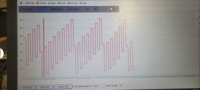

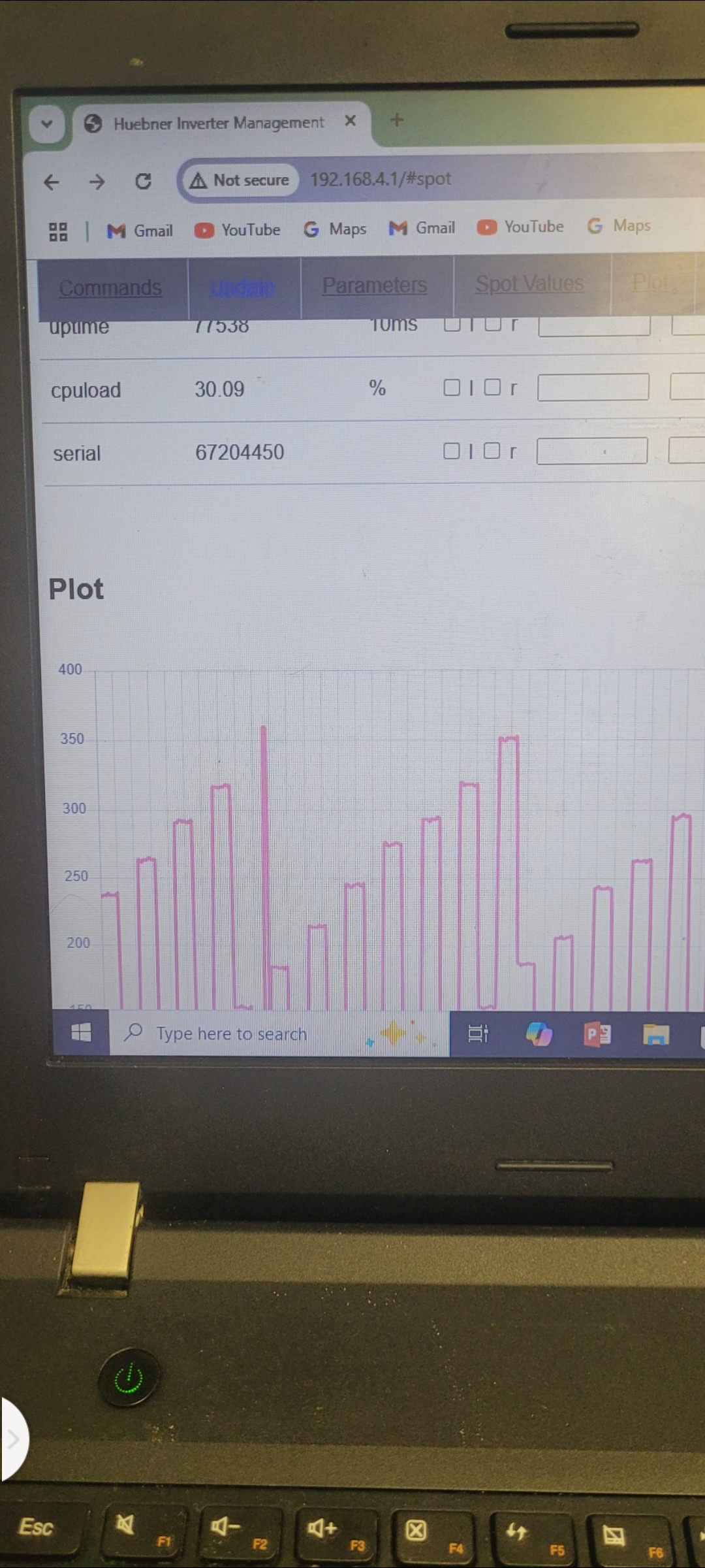

Re: EV Conversion using prius gen 2 inverter/transaxle
Please don't mind the noise on the scope but I think the duty cycle with PWM is there

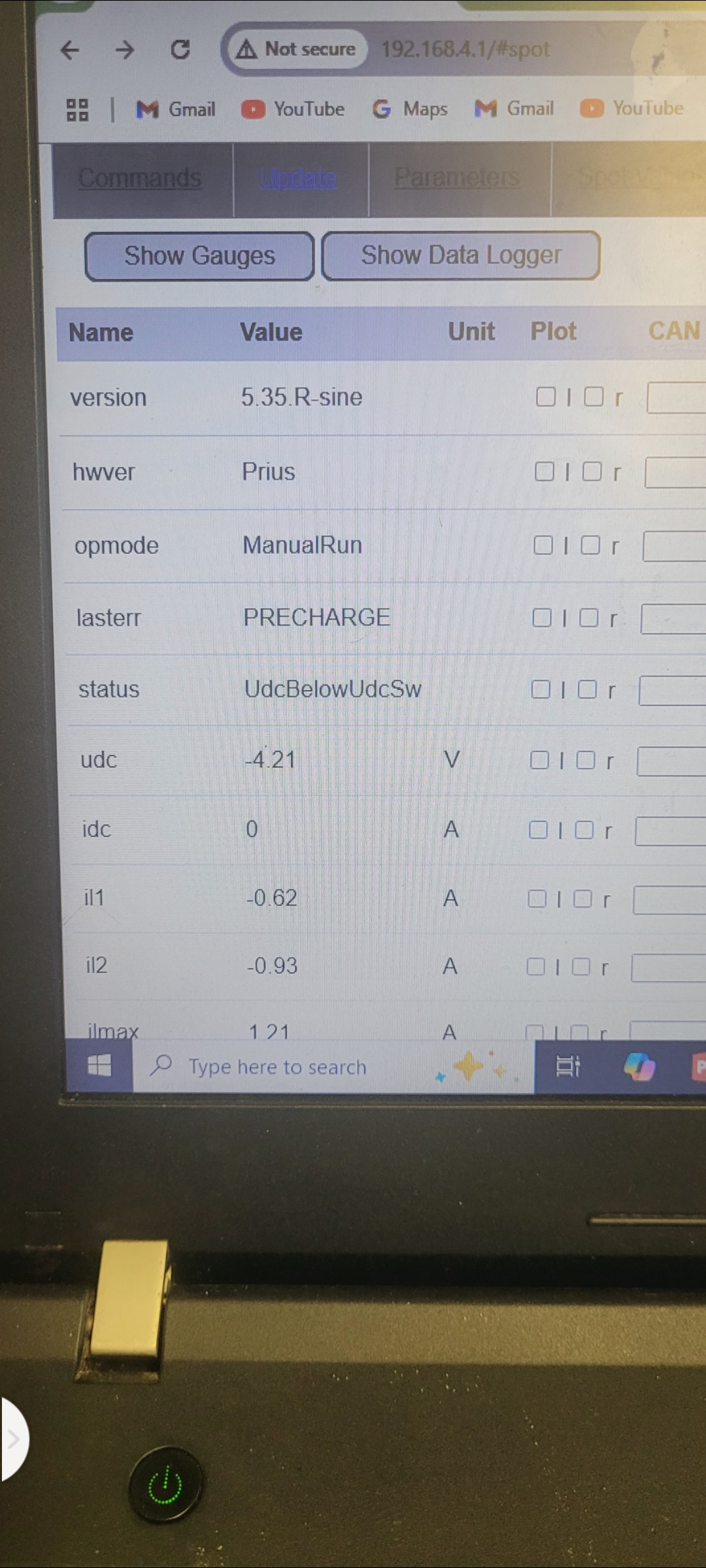

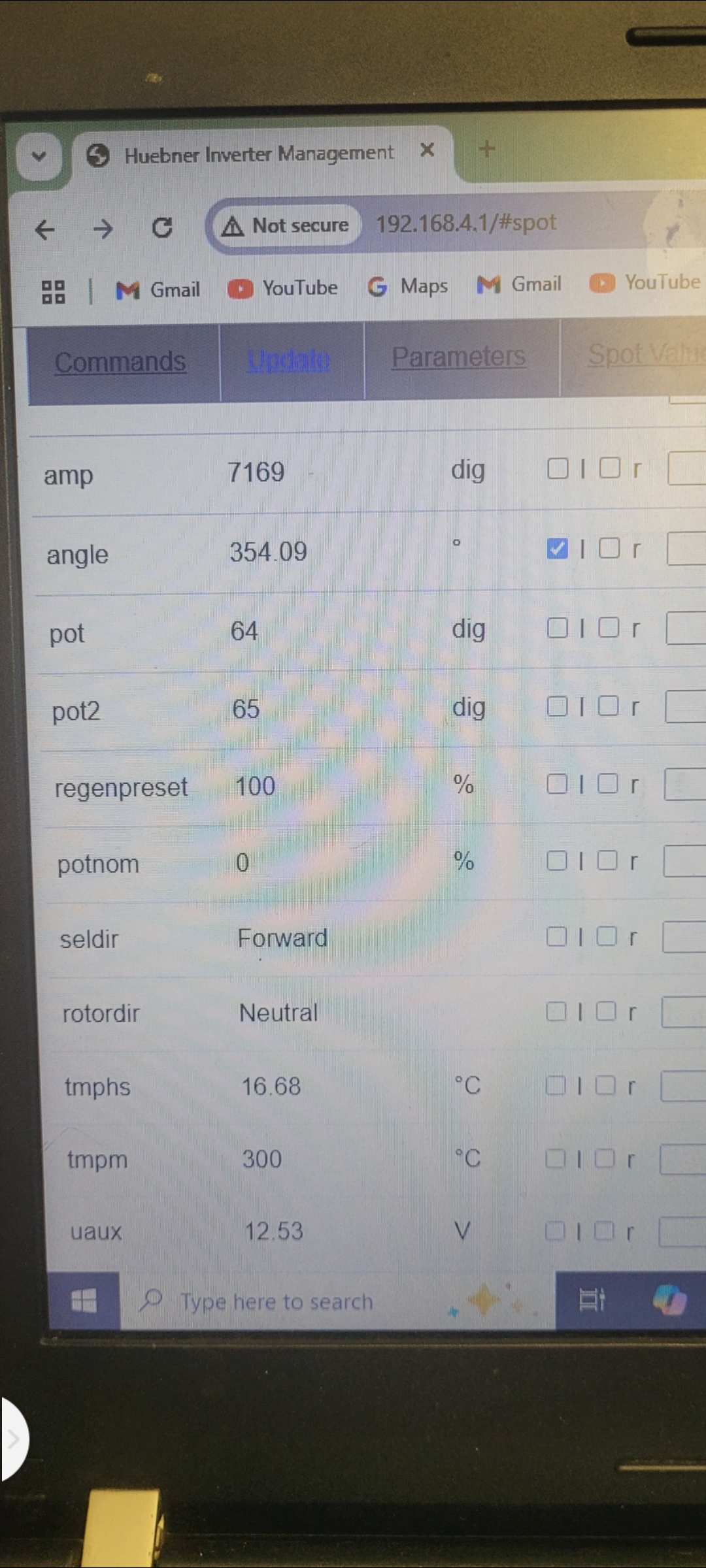

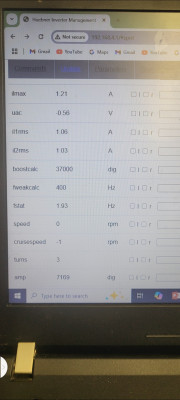

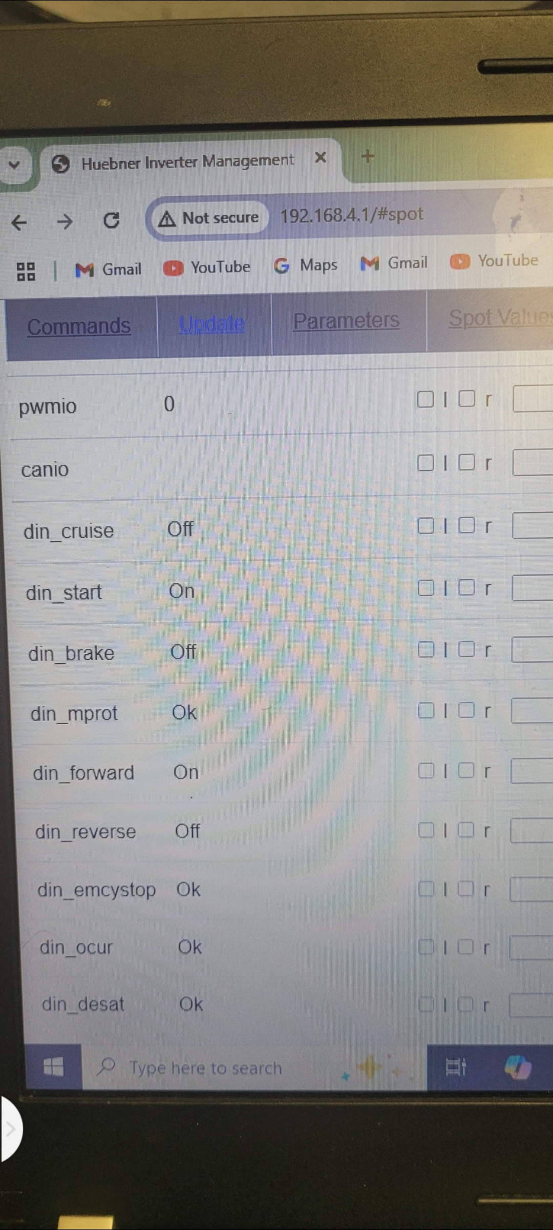

I connected my resolver and on the spot values I got an angle reading, does that mean that I've connected it correctly ?
Even with the resolver connected I still could t get the motor spinning, which is sad.
I've taken screenshots of my spot values for you guys to please go through and see if my parameters are OK.
What I noticed was I had my "laster" on PRECHARGE, I don't know it it should be like that because as I followed the video and put in some of Damiens parameters, it changed to TMPMMAX and opmode at that time changed to RUN. During that stage the light bulbs connected on the inverter output stopped blinking meaning the was no PWM coming out.
Following the video I also noticed that Damiens web Interface had settings light manualid and some other manualiq or something. Mine doesn't, should I be worried?
Im stuck and I don't know what to do next.
Didn't look through everything, but first mistake: you haven't flashed FOC firmware https://github.com/jsphuebner/stm32-sine/releases

My problem is that I'm not sure if this connection is correct because when I have the resolver connected I can see an angle reading yes but it's not convincing enough because it keeps on changing when I hit refresh even without spinning the shaft by hand. Another problem I encountered is that when I have the resolver connected amd I set udcsw to 0 the 22w light bulbs connected in delta at the inverter output they light up and they li, they don't blink showing a PWM signal.
I disconnected the resolver and when I set udcsw to 0, after a about 5 minutes, the light bulbs blinked and turn off and this continued until I put in a value in manualid.
Does that mean my resolver is faulty or am I putting the wrong valued for udcsw?.
