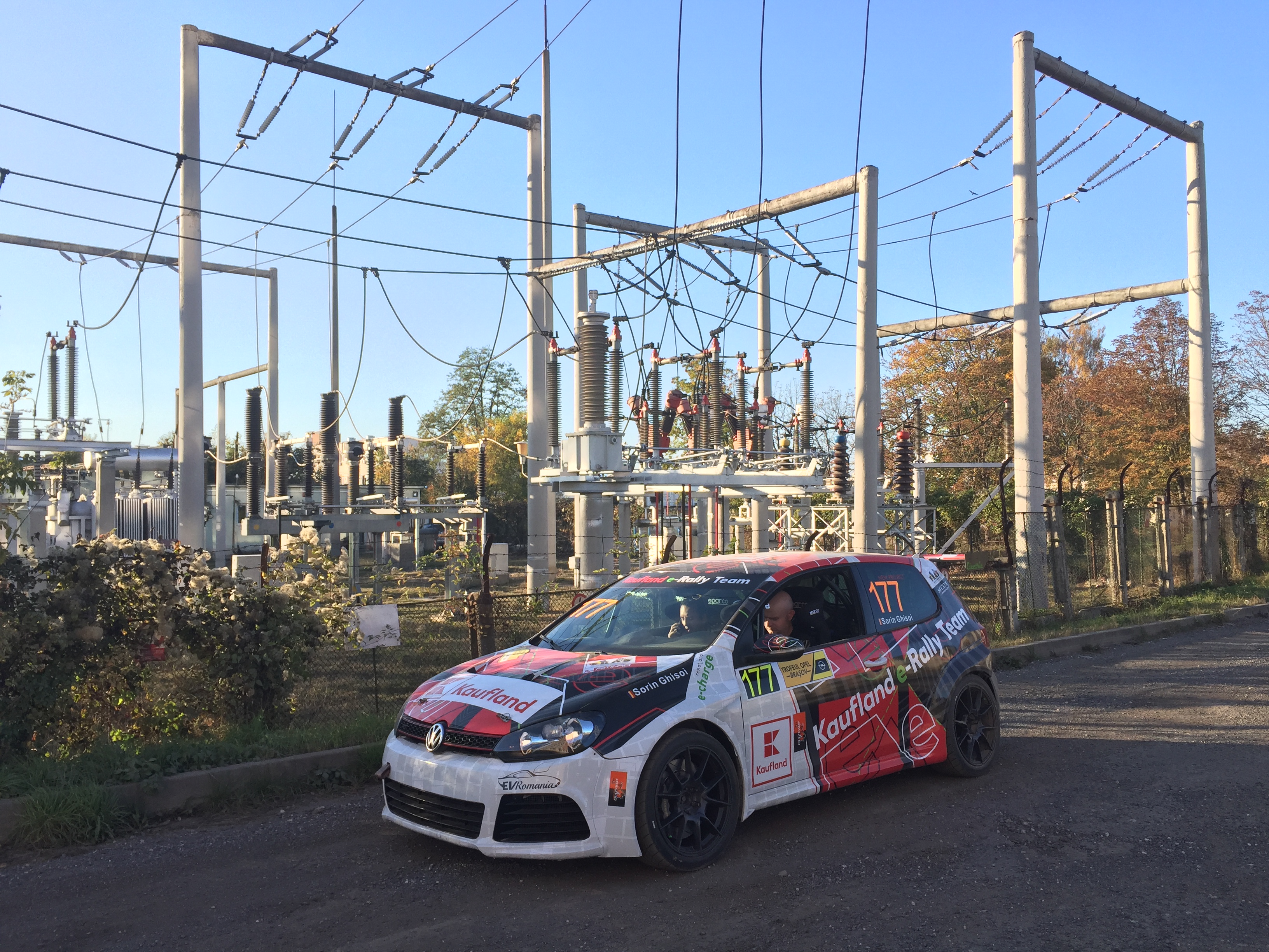

Some background on the car... built by EV Romania (here) using the open source inverter controller developed by Damien and Johannes. Uses a Tesla small front drive unit driving in reverse with an external oil pump 8-)

Need an LSD :D

some fabulous pictures in the EV Romania blog (here) 8-)

A few more shots of the car in this video on homologation in Europe 8-)

The Golf VI is not the best choice ....
I will take more pictures this weekend and show you how we made it

Looks like plenty of power (and too little grip) :D Nicely tuned
