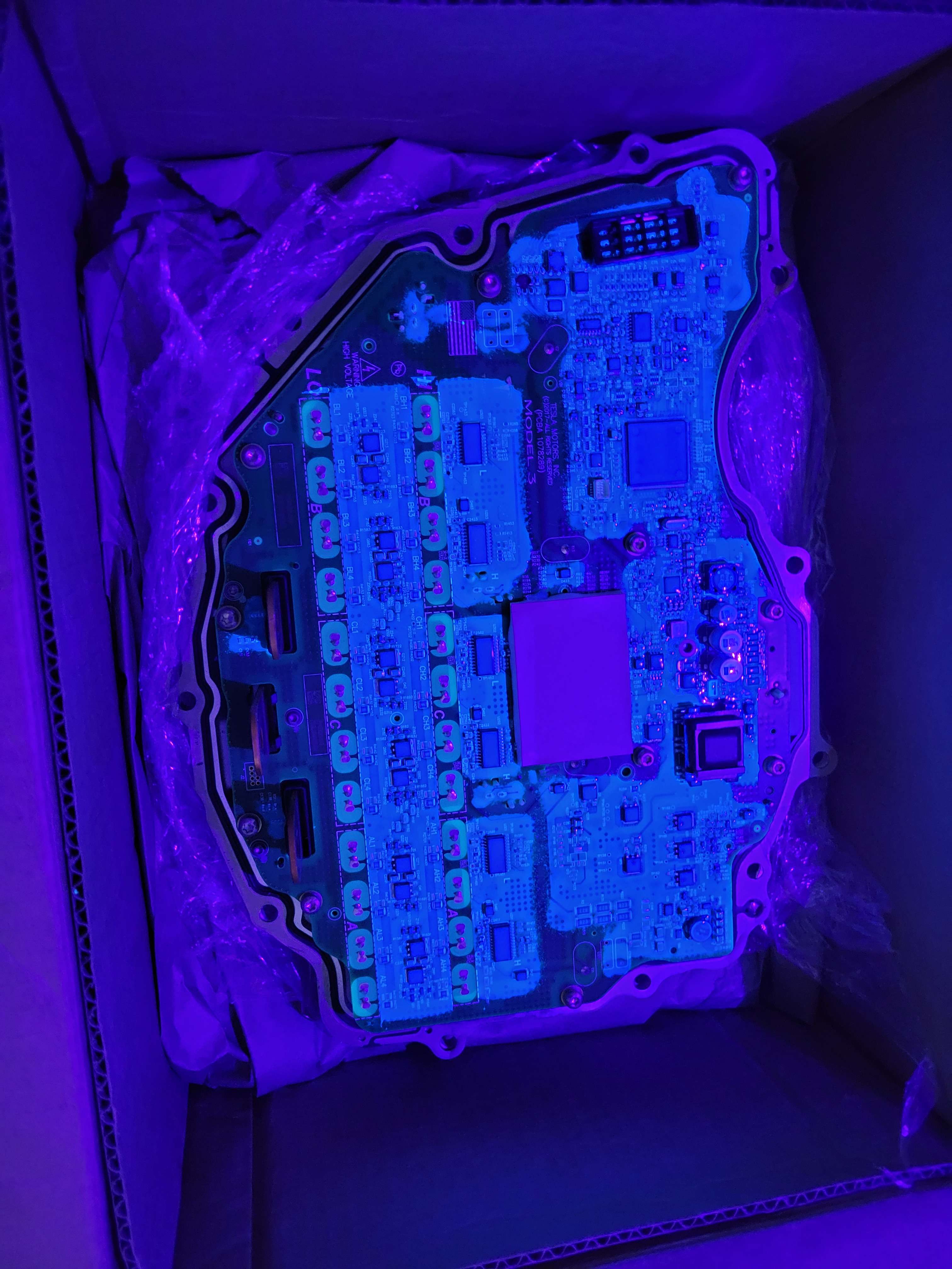

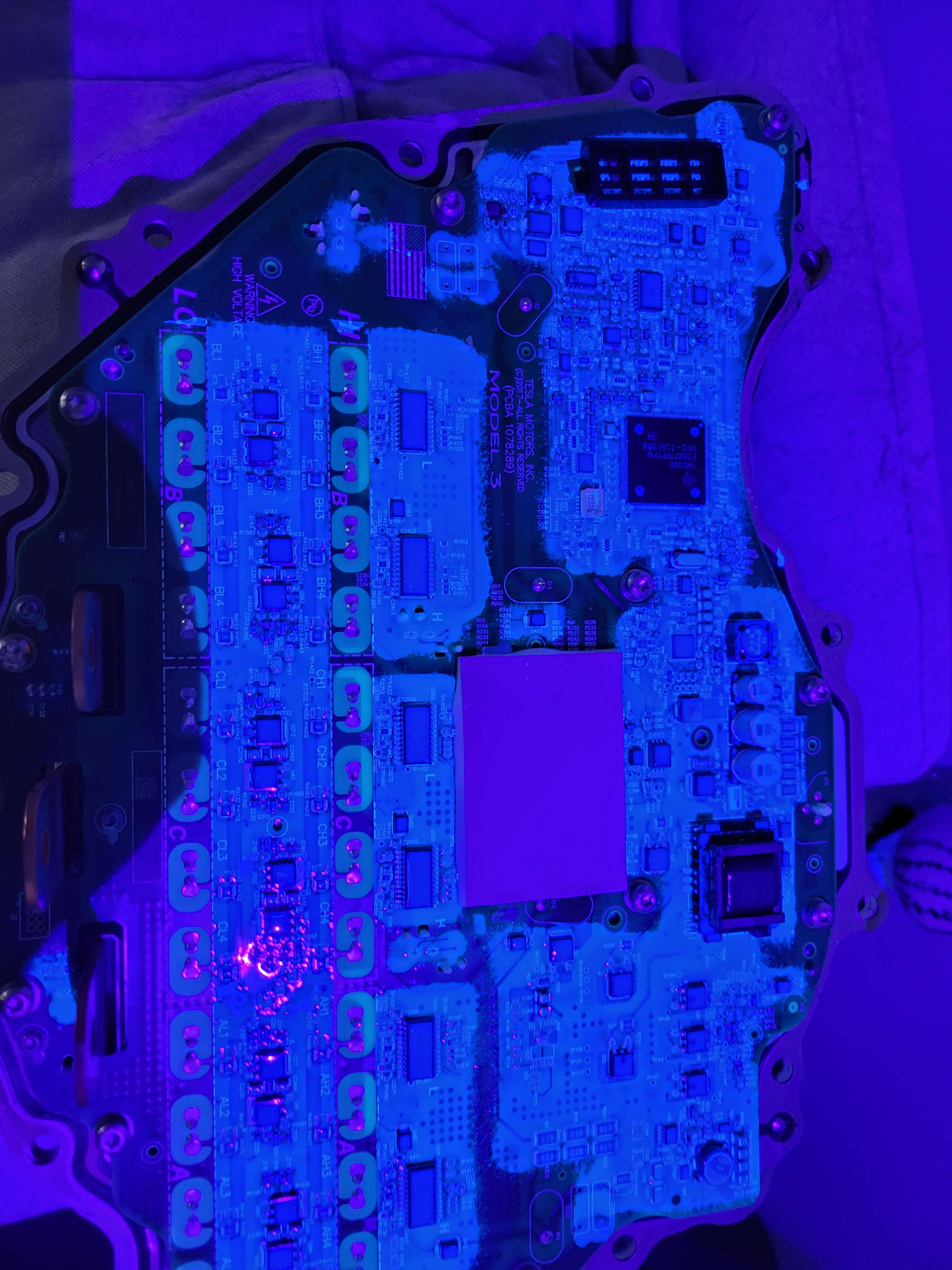

I want to preface by saying this is an outstanding post and I will do my best to add to it based on my abilities. to prevent damage, it is best to use a stripping agent to remove the conformal coating on the affected areas. I suspected the conformal coating (referred to in your post as "solder mask") might be polyurethane based, and so found a stripping agent capable of softening said coating for mechanical removal. I did a small experiment on the main TI chip surface to verify function and will post an updated later during the week with detailed images and timings to help anyone using the chemical method in the future.Davidk wrote: ↑Sat Apr 19, 2025 4:54 pm Now you can continue with 30 pin connector in purple colour, this is bit painful part:
1. leads and whole surrounding area is covered by solder mask, i used Dremel with small tip to clean as much as i could.
2. Even when i tried a lot i was not able to wick solder from joins and free connector.
3. I ended with propane torch and connector just slid our, by this i obviously damaged board beyond repair/reuse.
4. To do this without damage to board you will need to use hot air soldering station.
Current sensor. Area around is again covered by solder mask a lot, i used Dremel again to clean area around. Housing is hold by 3 T10 bolts, coloured with blue dots. When trying to desolder sensors they slid out from black plastic housing, not sure if this is suppose to happen or not. I definitely used force to press housing away from board. Now i have plastic housing and two sensors which i desoldered later.
additional tools needed aside from those listed in this post:
Mg chemicals 8310/8310A as available in your locality or equivalent mg chemicals 8310A
UV/blacklight (I have party store blacklights at home and they work as shown) as conformal coating is uv reactive
Various stiffness brushes
Nitrile gloves, eyepro and respirator with volatile chemical filtering or some kind of active ventilation (or both for maximum safety)
Xacto blade or sharp flat screwdriver (again, peel not scrape, don't want to damage things)
Fine picks and tweezers to aid in coating removal of challenging areas and around leads. I have attached photos from my experiment
before after
I will copy it to Wiki once commented by others, I will also add notes around whole motor, how i disassembled it.Jack Bauer wrote: ↑Sun Apr 20, 2025 8:29 am Thats great info thanks:) Can someone please add this to the wiki.

Interesting experiments with conformal coating. I saw a video about someone repairing a potted hybrid module in an old computer the other week using regular paint stripper (with dimethoxymethane) and wondered if this approach might work on Telsa board but didn't want to experiment as I'd really quite like to keep my board operational...
MG Chemicals 8310A is readily available in the UK from Farnell and RS Components so I might give this a try. I still don't understand how the Tesla standby PSU works and this is obviously not something Damien is interested in.

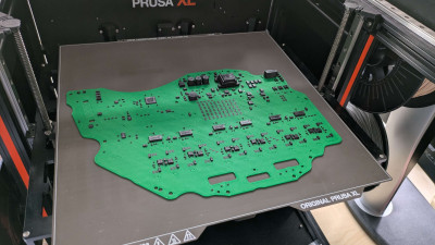

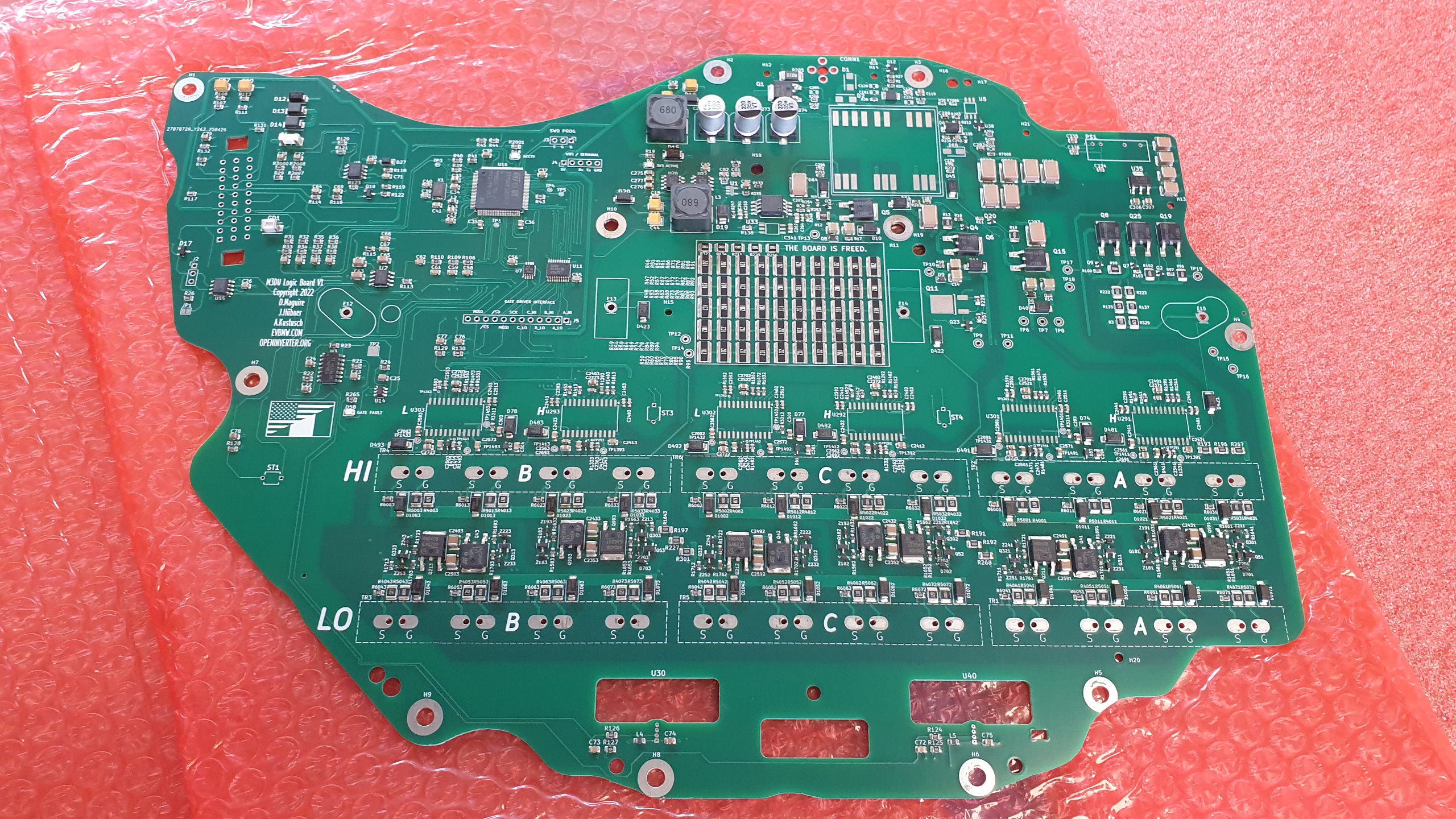

I ordered the 8310A from RS today. Also spent a few hours cleaning up the JLC bom and cpl so they dont generate weird errors. Good thing I did as JLC now have the STM32F103VCT6 as preorder only so I "reserved" 10. In any event, am ready to push the button finally to order 2 real prototypes as soon as confirm the fit of the 3d printed version.
- Posts: 4000
- Been thanked: 1115 times
Real prototypes ordered. Wish me luck:)
- Posts: 4000
In production at JLC. BOM and footprints all match.

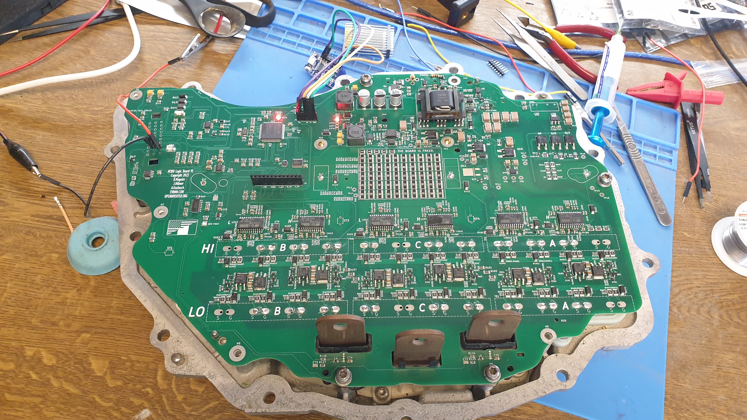

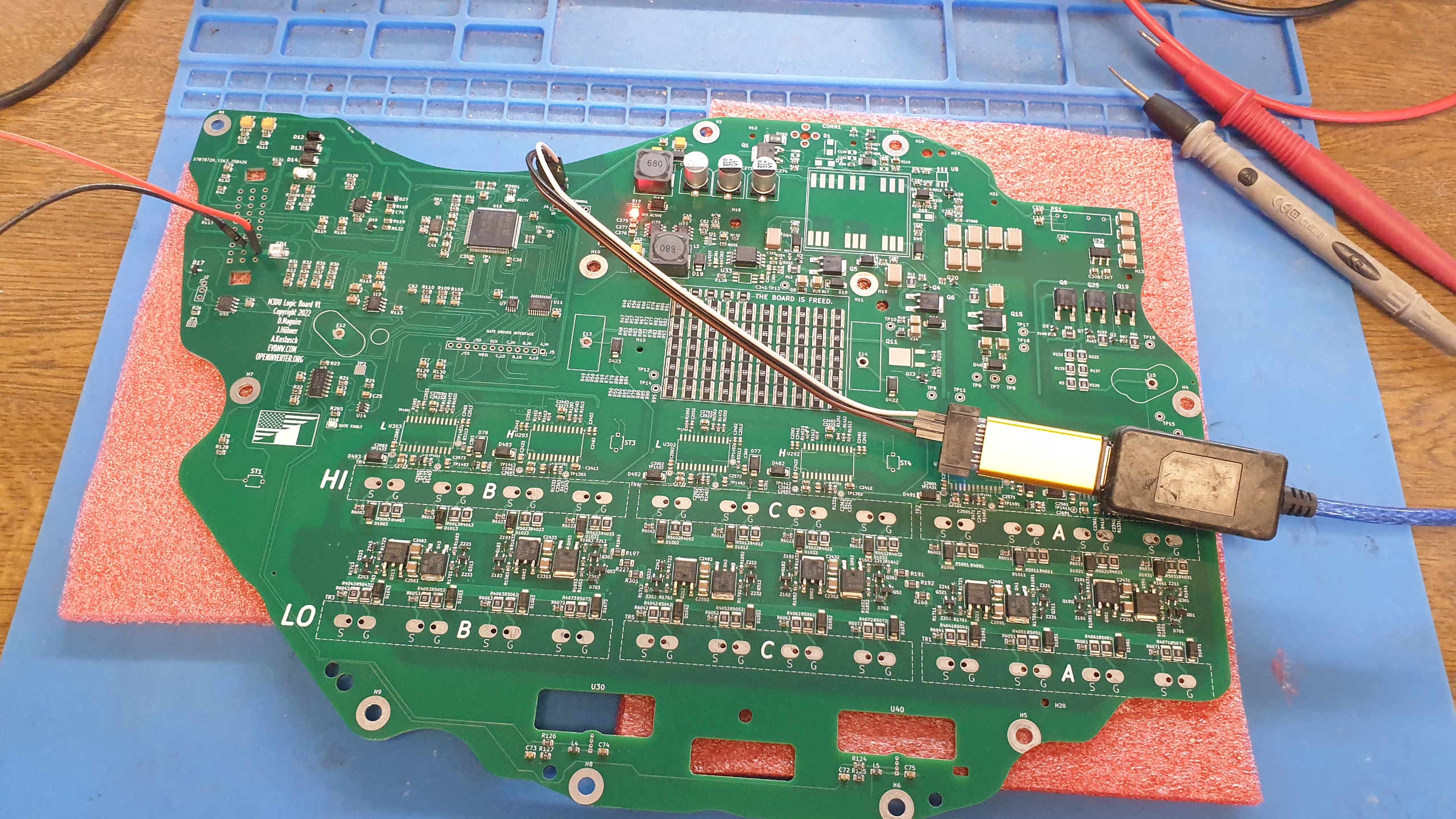

So far so good. Boards power up , 5v and 3v3 work and I can talk to the STM32.
Getting interesting:)

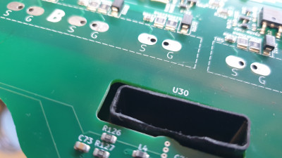

Sadly missed one locating peg for the current sensor block. No big deal. I can just snip it on this one.

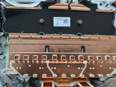

Recently found a german guy who shows some "reverse engineering light" of the front and rear M3 drive units.
Latest video: and ~2 more. In one video he cuts the copper and aluminium to get out the "SiC FETs" but surprisingly just finds IGBTs.
He explains that the front drive unit uses IGBTs, the rear SiC FETs. He also explains why this makes sense. He also explains why the rear unit has the backup power supply: to get a defined state if the 12V is lost and the PMSM creates voltage. He says, the front unit drives a async machine, which does not create voltage when turned without 12V, so there is no need to bring the gate drivers into a defined state, and so no backup power supply is necessary.

I don't think I'd seen anyone say that the front drive unit used IGBTs before. If anyone harbours a desire to run this with Damien's board it would be useful to get an SPI capture of the gate driver initialisation sequence before removing the Tesla PCB from the rest of the inverter. It doesn't need any more equipment than a cheap ebay USB logic analyser and a handful of hook up wires. I'm assuming that driving IGBTs and driving SiC FETs will require different gate driver behaviour even if the circuitry is otherwise the same?
- Posts: 4000
I'll see if I can get my hands on a front inverter. I did attempt to contact the German guy. So far no reply.

All gate drivers powered up, reset and waiting for spi configuration to be loaded.
davefiddes
- Posts: 416
- Has thanked: 206 times
- Been thanked: 256 times
Um. I dont think you need to be worrying about the spi configuration. That's looks to be all in place and working. Those chips are generally very unhappy until properly initialised with a working isolated gate supply. In my experience if the fault light is out the gate driver chips are happy or the power is off.Jack Bauer wrote: ↑Thu May 15, 2025 12:54 pm All gate drivers powered up, reset and waiting for spi configuration to be loaded.
If you're running the MG_DU branch code there's no reason it couldn't have just started working... I didn't check your schematic for any differences compared to the MG board. You might have just got lucky.
Can you check your error log for any GATEDRIVEFAULT or GATEDRIVEINITFAIL messages. Is it reporting 11 for the "hwrev" param? If so it's correctly identifying the TeslaM3 variant (HWREVS in param_prj.h needs updating to have the correct strings for the MG and TeslaM3).

Sorry Dave I should have said the gate psu is on and I just strobbed SD.

Every day is a school day it seems. Didn't know you could run the gate drivers without any config but the DS confirms this.
I've checked against your latest schematics and the code in the MG_DU branch stands, nothing has changed with the SPI and SD control that would break it that I can see. I don't see a ready signal on your gate PSU like the Tesla board has so you'll need to put in a delay before starting the gate driver. The current code tries to initialise everything immediately which won't work.
The TeslaModel3 class in teslamodel3.cpp is where you want to go putting your changes.

Yeah my initial modboard just ran them in default config as didnt have the spi worked out at that point. Sadly the good luck streak has finally ended. All the drivers fault as soon as pwm is applied. No doubt some error in the HW reverse engineering. I'll get spi coms running to try and narrow it down.

Hmm. That's unfortunate. Maybe it'll be fine with the correct config loaded. My driver code will need a bit of work to get useful debug info out of it beyond "There is a fault". Hopefully that won't be required.
