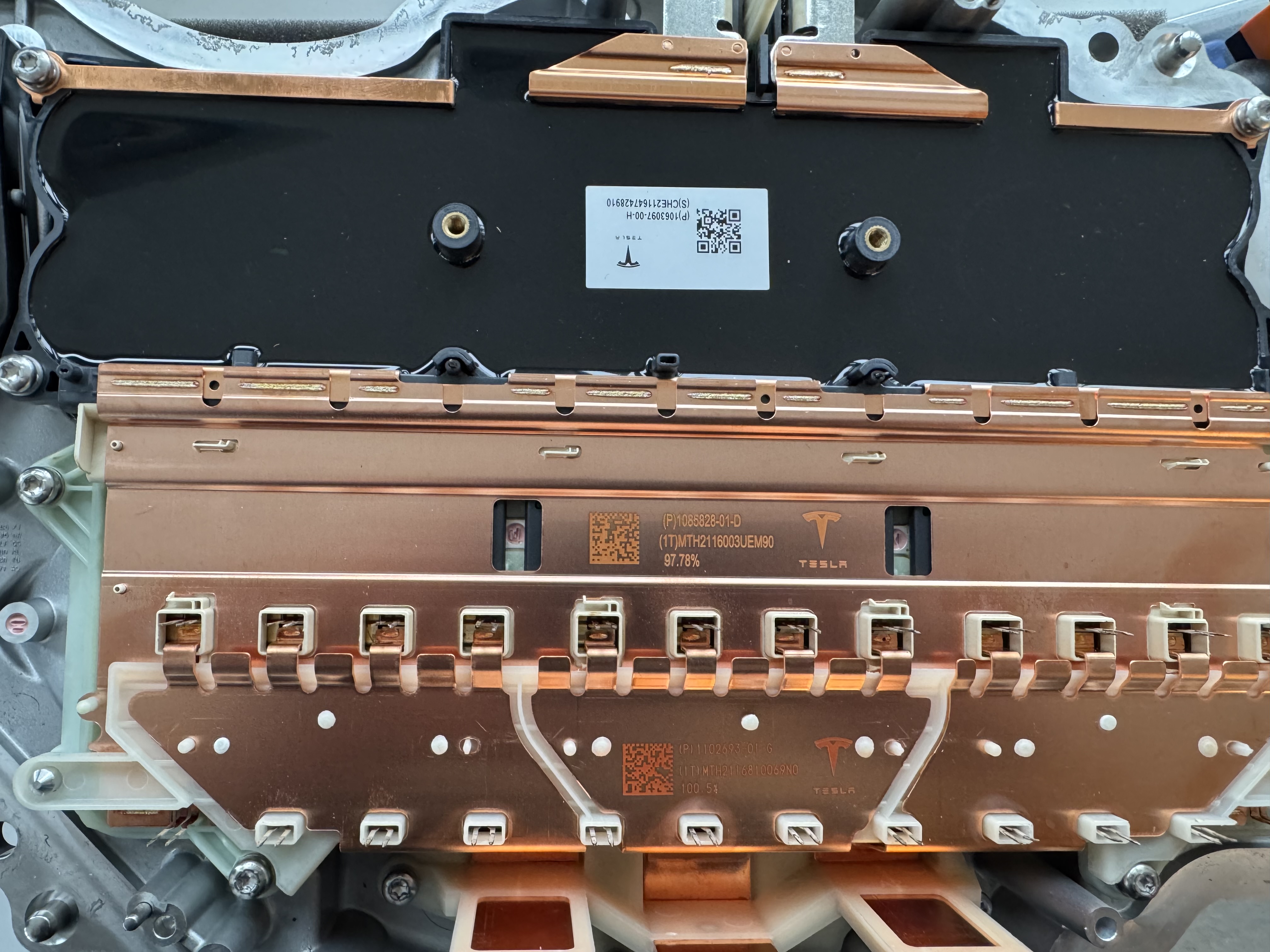

I very slowly but work on this way to run M3 inverter. I make some research on MY and change rear drive inverter from 990 to 980 version. I make new IMMO pair with VCSEC and DIR with Tesla Toolbox. But then I change back stock inverter, VCSEC forgot it, so VCSEC can make pair only with one inverter.
I buy MCU with old software , display, motor, VCSEC, pedal and wiring for bench test. MCU help me rewrite software in inverter for more old version, when I start redeploy. And MCU help me make IMMO pair.
Next step emulate CAN frame to make motor spin)))

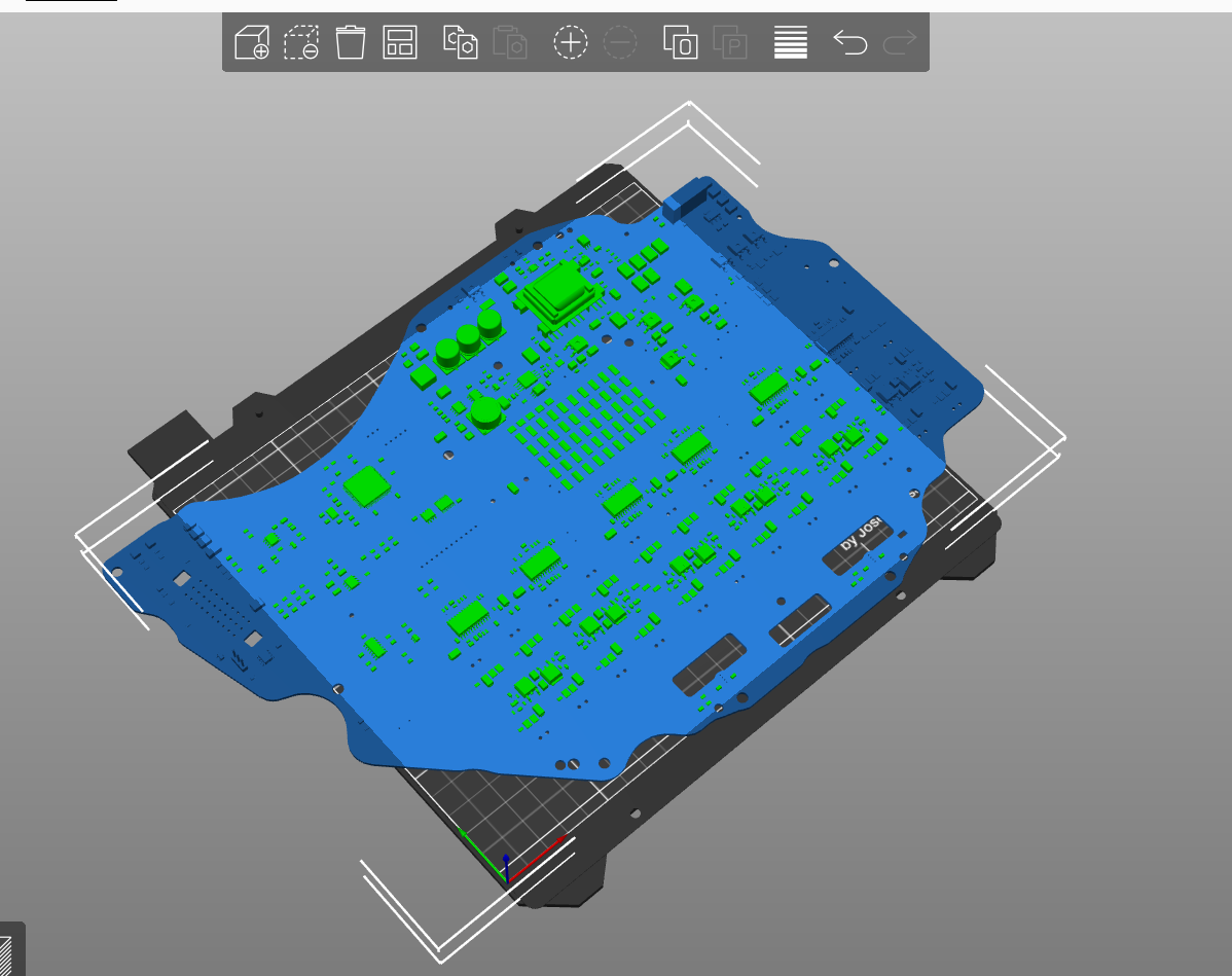

Almost ready for first real prototype from JLC
Dont you miss holes for white plastic stands next to ST1/2/3?
Not sure what is under as i did not desolder my board yet.

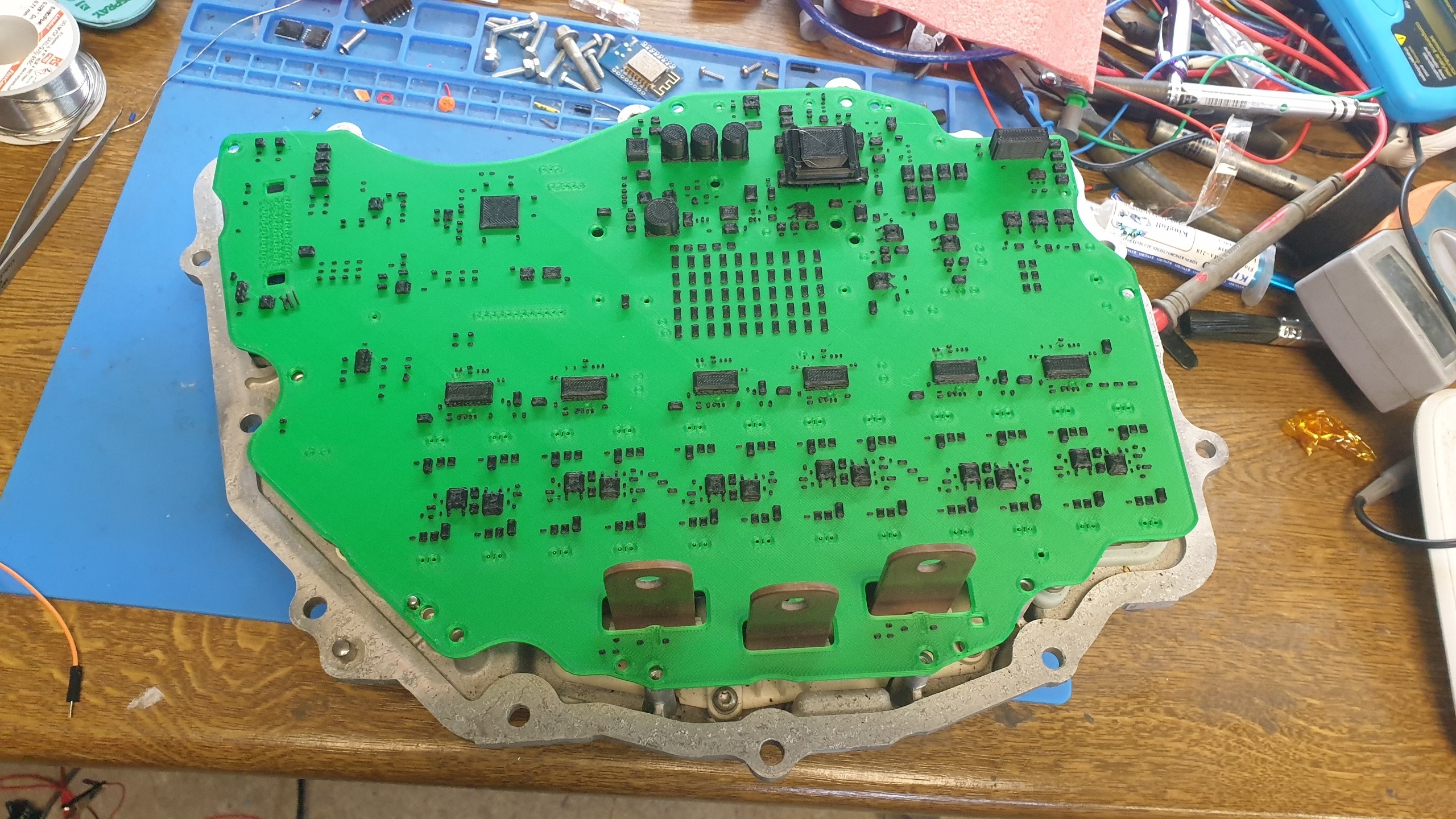

Because I desoldered my board i will post few notes for future adventurers:
2. You need to desolder High Voltage interlock loop marked in orange, only top and bottom solder joints are actually connected. Be kind to white plastic, it burns very easily.
3. You need to remove clamp over 30 pin connector, just take long flat screwdriver and move latches inward from plug side
4. Remove 11 T20 bolts (they are all same length). Yellow circles.
Now you can remove board, with connector, temp sensors and current sensors. For me this was easy and i did not had issue, i just wiggled it a bit.
Now you can continue with 30 pin connector in purple colour, this is bit painful part:
1. leads and whole surrounding area is covered by solder mask, i used Dremel with small tip to clean as much as i could.
2. Even when i tried a lot i was not able to wick solder from joins and free connector.
3. I ended with propane torch and connector just slid our, by this i obviously damaged board beyond repair/reuse.
4. To do this without damage to board you will need to use hot air soldering station.
Current sensor. Area around is again covered by solder mask a lot, i used Dremel again to clean area around. Housing is hold by 3 T10 bolts, coloured with blue dots. When trying to desolder sensors they slid out from black plastic housing, not sure if this is suppose to happen or not. I definitely used force to press housing away from board. Now i have plastic housing and two sensors which i desoldered later.
Tools used:
Solder iron, Solder wick, Bit of solder and flux, Torx T20 and T10, Dremel with small tip, propane torch.
Totally i spend 6-8 hours, i did not used solder iron for last 15 years and first two joints took me 30-40 minutes...
1. To remove board you need to desolder all joints marked in green, total of 51 solder joints. I used just solder iron and solder wick.2. You need to desolder High Voltage interlock loop marked in orange, only top and bottom solder joints are actually connected. Be kind to white plastic, it burns very easily.
Tools used:

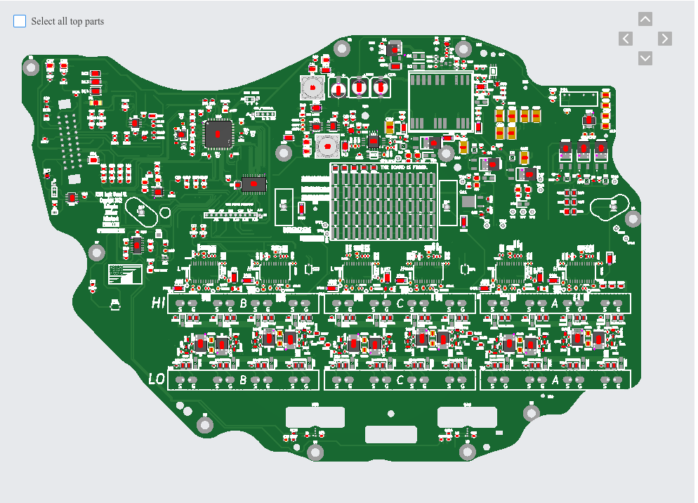

I ordered the 8310A from RS today. Also spent a few hours cleaning up the JLC bom and cpl so they dont generate weird errors. Good thing I did as JLC now have the STM32F103VCT6 as preorder only so I "reserved" 10. In any event, am ready to push the button finally to order 2 real prototypes as soon as confirm the fit of the 3d printed version.

So far so good. Boards power up , 5v and 3v3 work and I can talk to the STM32.
Getting interesting:)

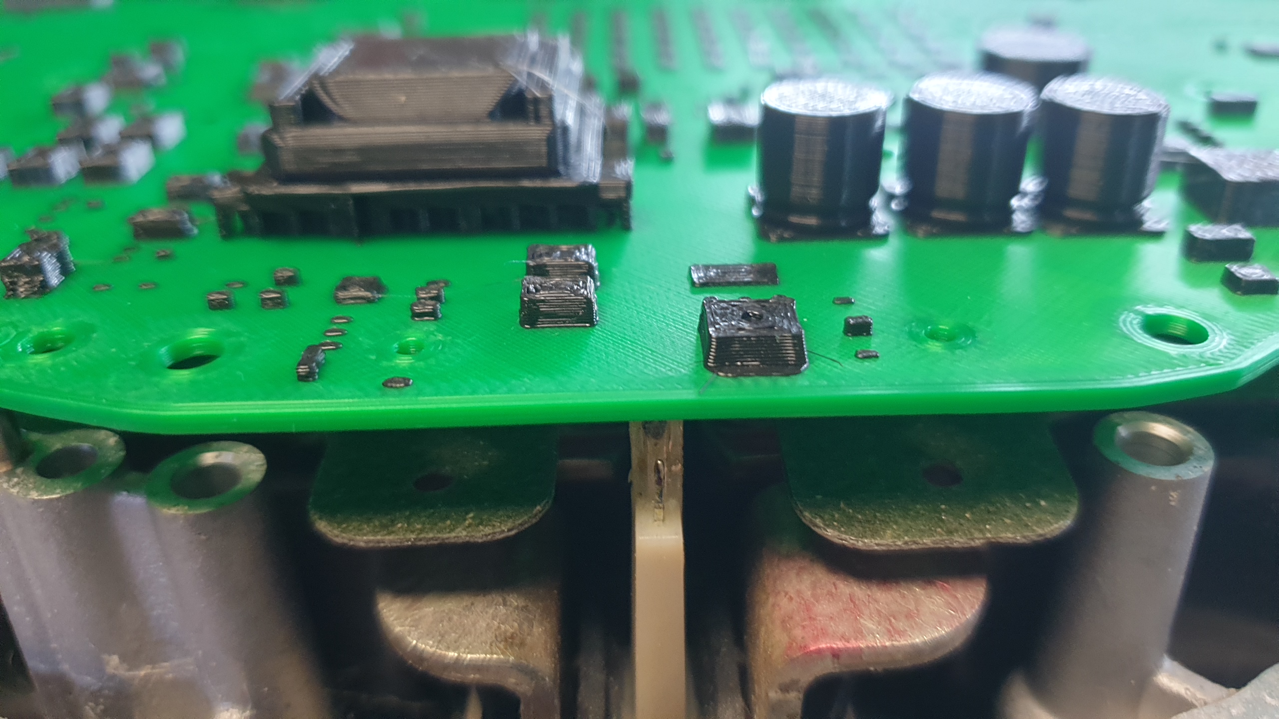

Sadly missed one locating peg for the current sensor block. No big deal. I can just snip it on this one.
