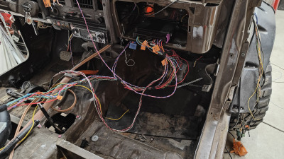

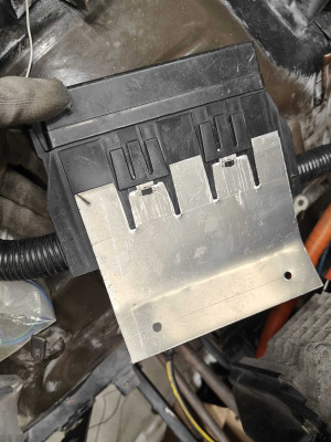

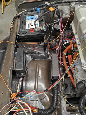

Cleaned up the main fuse box and pulled out a few meters of copper. Then made some mounts (brackets).
Yet another scrap piece of metal found a new life as a sparse comb
Wip on the spaghetti, but hey it's cleaning up
Installed quite nicely to Suzuki air box mounts

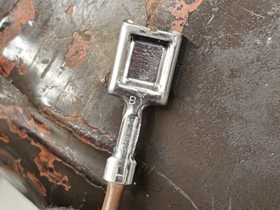

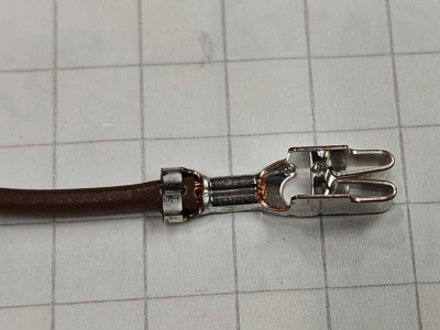

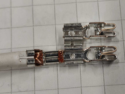

Been hunting terminals
The single mini fuse terminal seems to be Sumitomo 8100-1233 (-1236, -1237) / Yazaki 7126-8850 (-8851, -8852) Two-way Yazaki 7126-8822 The terminals used in relay sockets I have not identified yet
Possibly Yazaki F250-M-LC-M, See Rakuten

Looks alot like the things MTA would also use in their products https://www.12voltplanet.co.uk/mta.html
Or the TE terminals https://www.te.com/commerce/DocumentDel ... t=880398-2
https://www.te.com/en/product-881572-3.html
Then again its a Suzuki so likey uses Japanese terminals.

Oh, key piece of information left out in my post, I was working on the Leaf main harness (or what's left of it)
But yes, Japanese connectors/terminals are the usual suspects anyways
Most of the connectors on the Suzuki harness look like they are Sumitomo 250 series sealed and unsealed
DS 250, MT 090 and some others, luckily these are well available
I suspect that my parts donor Leaf was made in the UK, wire harnesses are made in France as they have French labels when you peel away all the sheathing and tape. For reference, I'll try to remember to get a picture next time around.

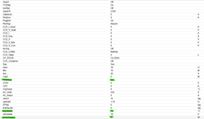

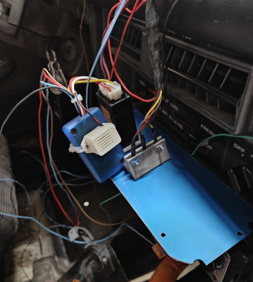

Today I got all the pumps running and updated to latest Zombieverter FW to make a test drive outside. Well, no test drive yet as there is some hiccup in reversing
The TRW pump needed just the alternator signal switched to inverter on and it was screaming again like there's no tomorrow. Water pumps are getting quieter, there must have been some air in the lines regardless of the fancy vacuum filling. Wired up the VW heater, but it did not seem to want to heat. Didn't do much diagnosing on that yet.
Heater params were VW, control enable, power 6500W and HeatPercent 100. I also used PB3IN as Heat request and that didn't seem to change things either. Tips are welcome
I have the R50 and C45 changed as per the note mentioned in Zombieverter hardware NOTE : R50 will need to be changed to 1k and C45 to 1n in order for LIN to work properly. This will be amended on further builds. So if you have a board ordered before 14/03/24 this change is required.
Taming the spaghetti has proceeded as expected and there are very few on the "get back to this later" -list Zombieverter will find its new home under the glovebox, similarly to the ICE ECU I had mounted there. That way I don't have to "recalibrate" my max water level

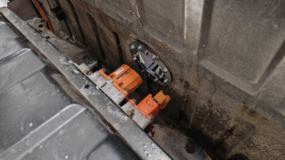

Had ordered a new LV connector for battery, crimped and pinned that. Reused the blind plugs from old connector. I'll save that for any and all possible future use scenarios
Since I have now tried 3 different FW releases and none of them had any torque in reverse, I started to look into this and did some CAN logging. Maybe my 2017 30kWh Leaf driveline (stack and battery) is a snowflake, or is it possible that this is a bug left unexposed? I don't know, but I will find out
Alishit, found the perfect high voltage warning sticker

Please post your params. You know PB3 is a pull to ground. Did you see the Heat request spot value go to ON?
- J0hannes
- Posts: 115
- Joined: Sat Nov 11, 2023 10:29 am
- Has thanked: 15 times
- Been thanked: 131 times
Re: [FIRST DRIVE] Project Rising Sun: Suzuki SJ410k meets Leaf full stack
Yes, heat request spot value changes to ON.
Params are same as I'm using now to test the 2.31 TH (with fw version this the heater works!)

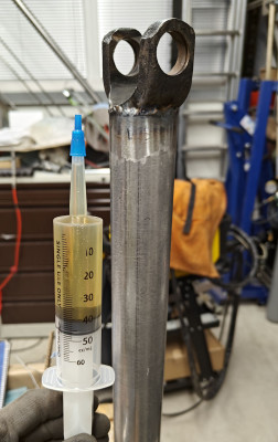

Gave a shot on redoing the intermediate driveshaft. Been wanting to try out oil fill for balancing, so here goes nothing!

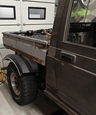

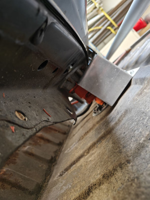

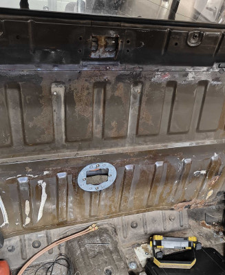

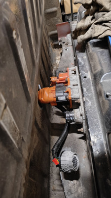

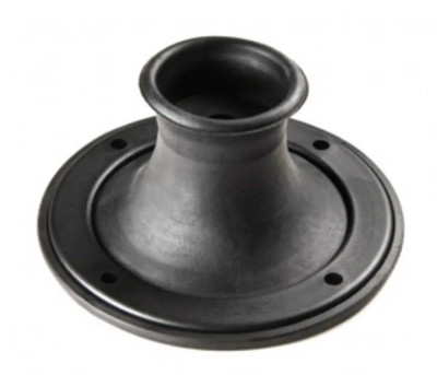

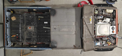

Had found a suitable cable feed through for HV battery cable from the boat section of local auto parts shop
As I have route it through the cockpit. Also had some interface plates cut, so I have something more rigid to mount the feed through to
I'll try to remember to snap a pic of the end result too

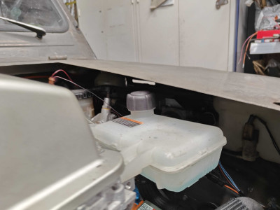

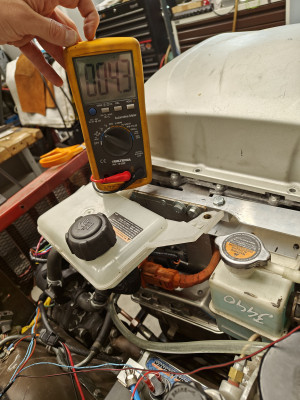

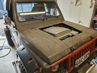

The hood closes now
Coolant reservoir would have had enough clearance
Leaf PDM doesn't really clear it, but damn that's close
It looked like it was close and so it is, but still the original bed sides fit.
Its still a WIP, but I figured that I can use the Leaf battery mounts also to build an interface to mount the bed sides

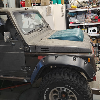

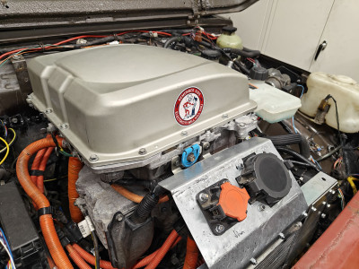

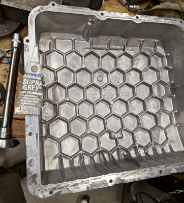

Well I've been working on my brown list until all got struck over
The hood scoop is now really made from a snow scoop I picked up from for free. It was probably run over with a car or something and didn't work for snow scooping. For hood scooping there was enough material to work with
Added a shield over the battery connectors, theres also a nice ISO 7001-W12 sticker on it now
Sealed the PDM, didn't have the Nissan spec stuff, but the grey is probably good enough
Added the "warning" sticker

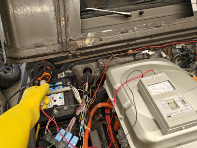

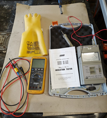

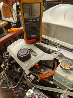

Did some insulation resistance measurements with my Kaise SK-3100, which I got on Facebook for freebie. 500V rated Yellow condom gloves for safety, you know
Prodded the HV connectors on main harness and VW heater as well as the charge ports. The analog gauge is not the most precise, but got tha ball park numbers that I could use for the report for initial inspection I'm writing for MOT.

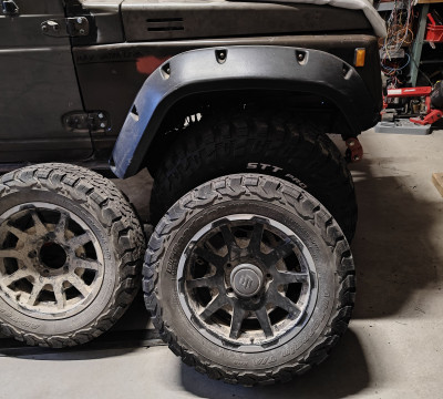

Changed these lighter wheels as D-day is nigh
First charge at home
Today I drove to work and back. Remembered to check soc before and after only on my way to work, that was about 29km. Consumption was roughly 19kWh/100km. No heater used and max 70km/h (my subpar driveshaft adapter give heavy vibrations, so I need to drive nice until a better one emerges
). Will have to do more logbook work on getting a better understanding on the possible consumption.

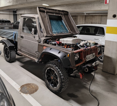

[DRIVING] Project Rising Sun: Suzuki SJ410k meets Leaf full stack

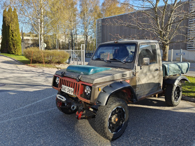

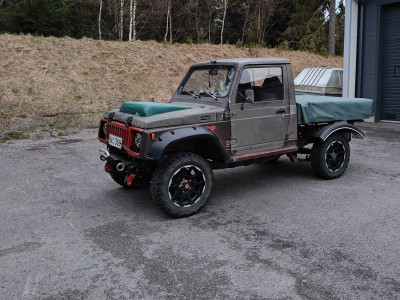

Today I went and had this bucket MOT'd
So with this, I declare this DRIVING.
This concludes phase I of my project
Next I'll take some time driving around on and off road, getting a better understanding on the range I'm going to have and fix some minor things.
Stay tuned

[OFF ROAD DRIVING] Project Rising Sun: Suzuki SJ410k meets Leaf full stack
The real first drive
Oh boy this is more than insane!
Don't really have the words to describe how it feels, other than brutally and awesome!
What I have identified as needs for improvement / development during the drive or earlier:
-This needs creep, adjustable preferrably
-Pressing the brake pedal and throttle is uninevitable, torque request being cut by touching the brake pedal makes driving difficult in situations where physics wants to move the car opposite direction to what the driver wants... Some finer system, maybe based on brake pressure or something to limit max toque request, but not kill it completely
-Air compressor is noisy
-I really need to upgrade the rear springs to slightly higher load range, now they sag and rear end feels too soft
