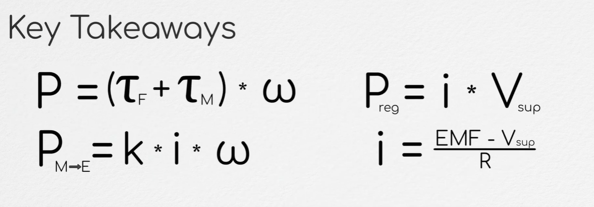

You clearly lack understanding of how a brushless motor works (induction motors work similarly but very different in some ways but wont create voltage on their own).
Here is info on controlling them
Point on regen
So yes the way to control the current that is allowed out of the coils/magnetic field into the battery pack the pwm duty is adjusted. Note the speed thus frequency is locked together.
This is key, You NEED emf (motor produced voltage) higher then the battery to push current back to the battery. Current always flows from low to you, you PWM it to control how much current is allowed through.
Point on regen

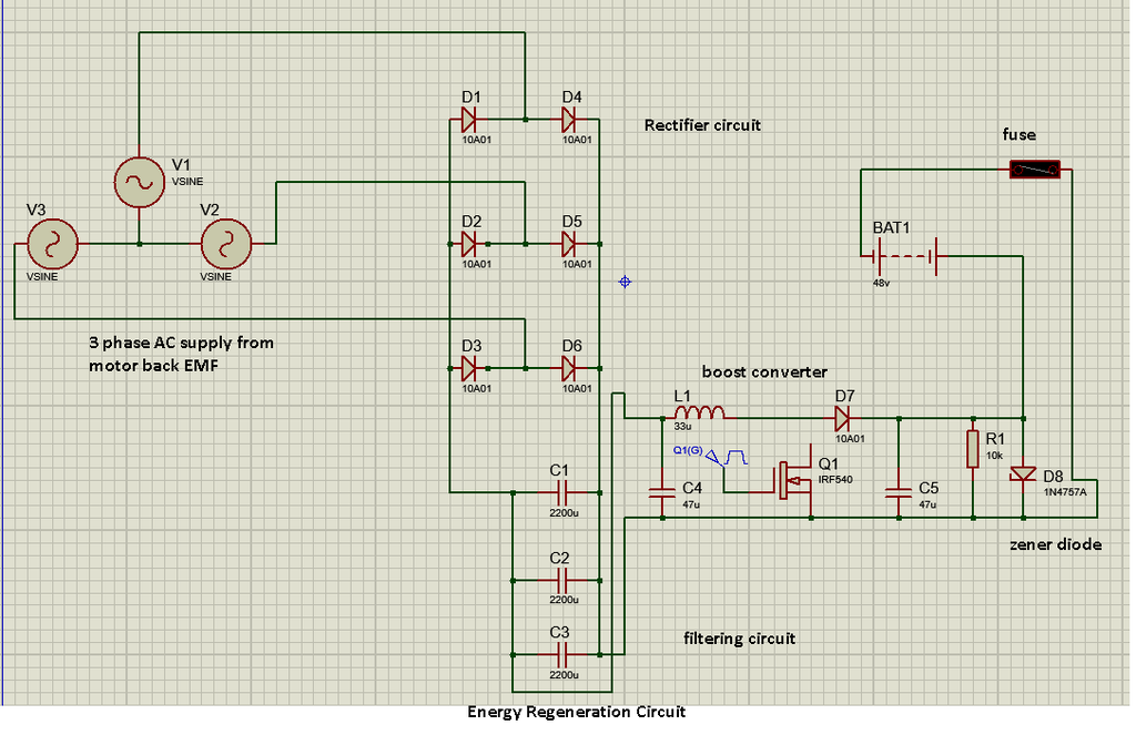

Funny but it seems you clearly lack knowledge of the techniques that allow a BLDC inverter to function as a boost converter to charge the battery even when the EMF is lower than the battery voltage. Here is one technique that utilizes the motor's internal coils to boost the regen voltage:
https://www.slideshare.net/slideshow/re ... s/54859643
Additionally, from your previous replies, it seems you are only considering the freewheeling diodes for regen, which is a primitive and inefficient method. This is why you keep stating, 'You NEED emf (motor-produced voltage) higher than the battery to push current back.' Yes, with just freewheeling diodes, the EMF needs to be higher than Vbat + Vdiodes. However, this is not the only method we are discussing.
another way is i am not sure if this is used in any commercial inverter but another approach can be like this
This method clearly demonstrates that you can still charge the battery even if the EMF is lower than the battery voltage, thanks to the external boost converter.
another approach is bidirectional dc dc converter
https://www.mdpi.com/2032-6653/15/1/12
and there are more....
i am asking which topology tesla using for its inverters....

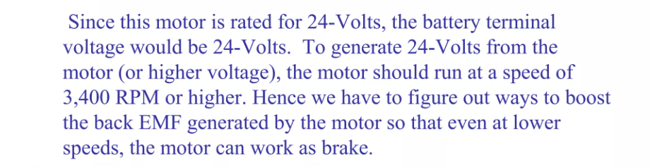

A "simple" 3 phase mosfet based full bridge, like everyone else. Nothing unique or special there, just the fact they have done this with IGBTs on the Model S in small packages and on the Model 3 now with also small package Mosfets.
Okay where did all this knowledge magically come from all of sudden? Guess ChatGPT "made" you smart.
- Posts: 2962
- Has thanked: 330 times
- Been thanked: 848 times
Re: Tesla regen regulation/charging
Did you watch this...
You can use the motor to generate a higher EMF by having is short its coil to build charge to raise the voltage. Then connect it to the battery to let the energy flow there. It would be useful to actually look at my responses in detail.
