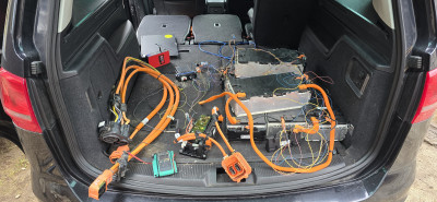

Touran
Picture still shows CHAdeMO adapter, now it is fully integrated. Charge limits calculated by stm32-car MEB BMS module. Max charging power 85 kW

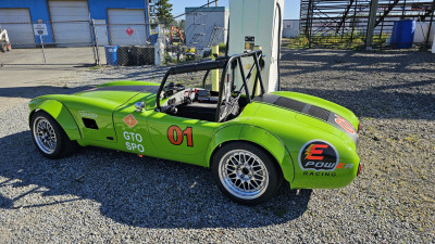

Charging at 120kW - which is the maximum output of our station at Mission Raceway near Vancouver, BC. At some point, we will visit a commercial charge station and see if we can charge at 350kW. We're using water cooled Tesla Model 3 modules, so there are no issues with heat. Charge profile is managed by our own controller with an Orion2 BMS also watching in the background for safety.

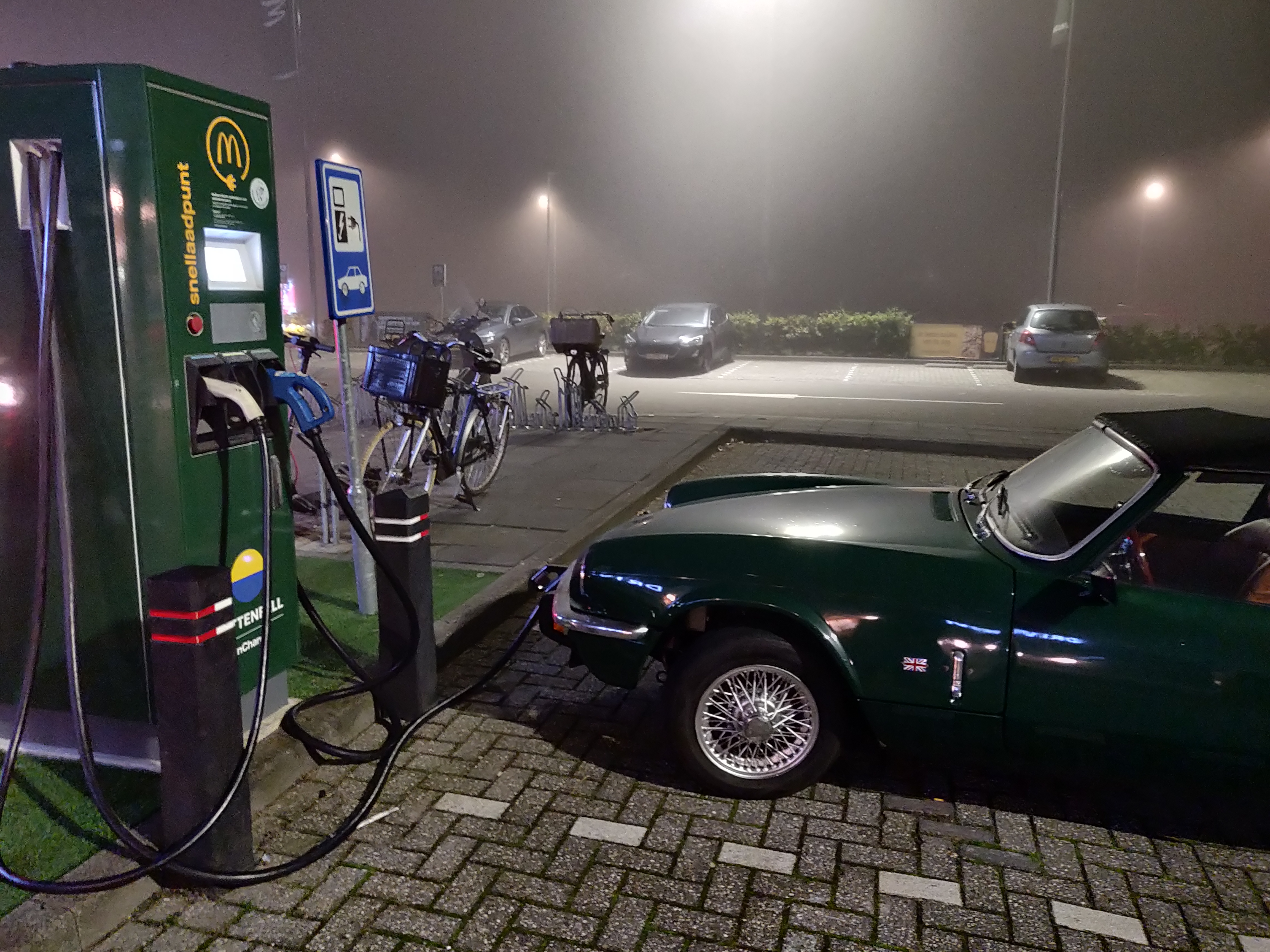

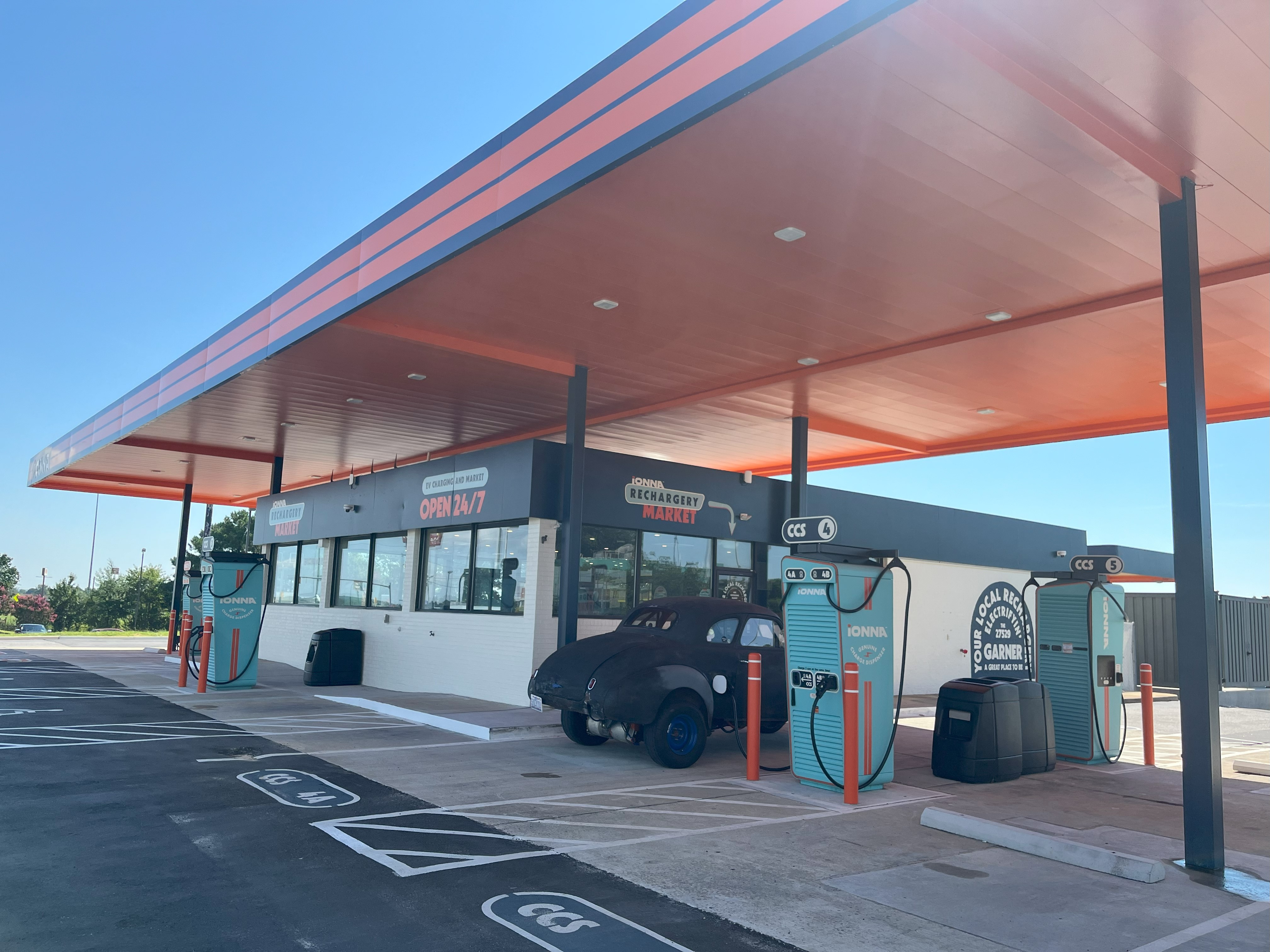

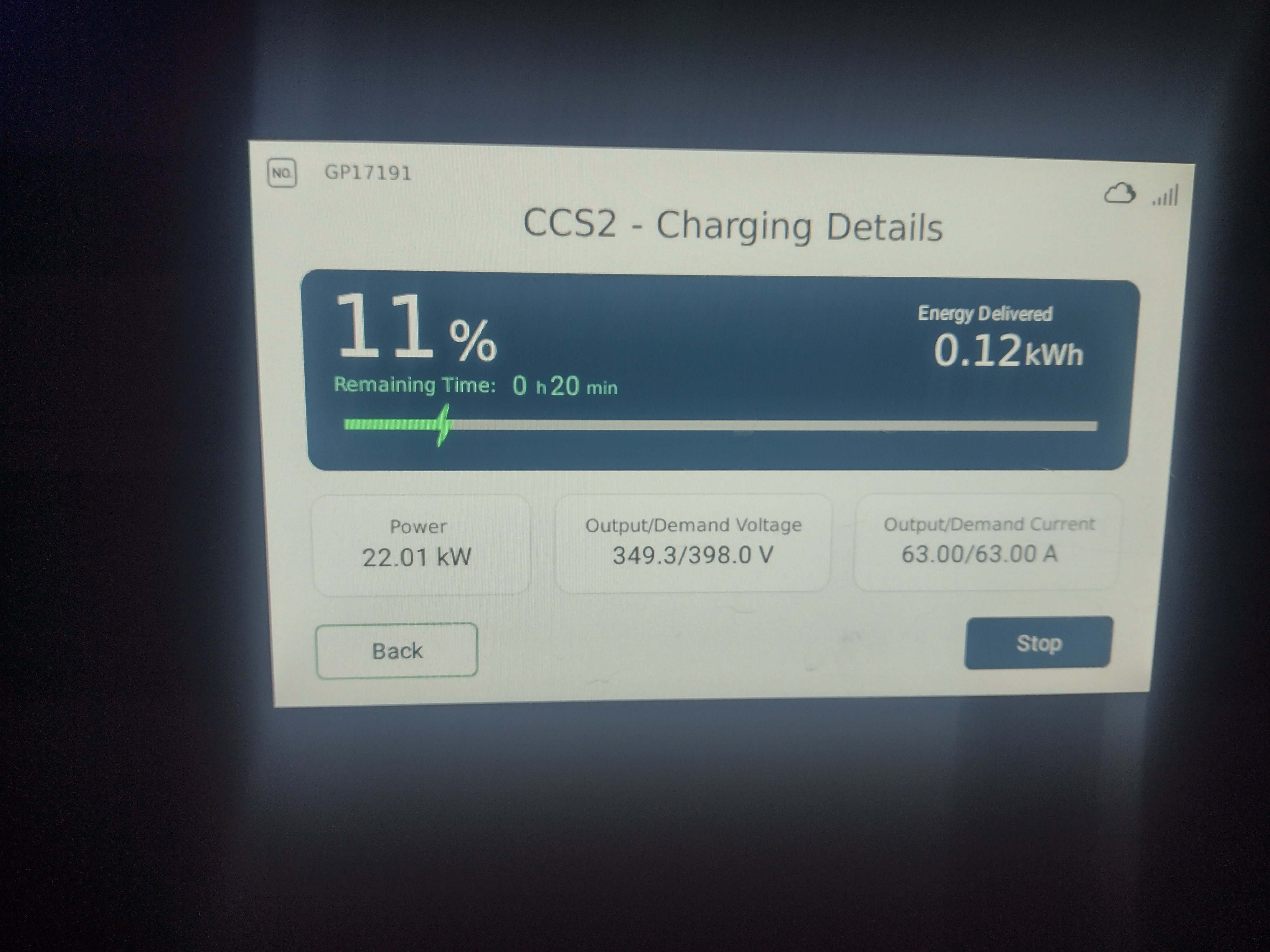

To add a couple to the gallery, replaced the LIM dit the Foccci controller, after finished the CAN implementation in my VCU project AC charging was working so I wanted to test the DC charging. I have 3 chargers near me and all of them worked perfectly in one try!
Thanks for all the effort you people put into this project!
nathaniel
Posts: 95
Joined: Thu Jun 09, 2022 10:17 am
Been thanked: 50 times
Re: The Foccci gallery
Post by nathaniel »

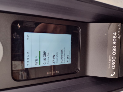

Today tried a couple of others, Tesla v2 and a new abb one. Both of them worked directly! No drama, just charging. Very nice. Was one other charger that did not want to charge but it was one without display so no feedback of any kind. Also tried via the qr code also no succes, site was very not responsive. But at this point I don't blame the Foccci for this fail

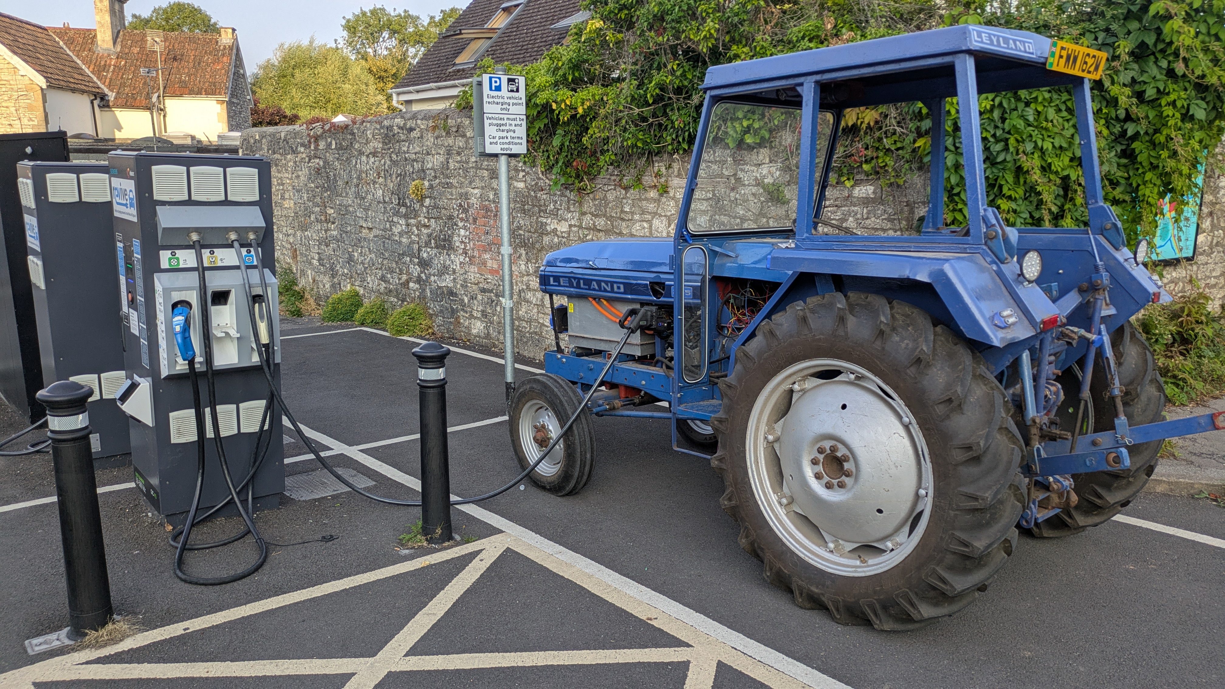

Zombie + FOCCCI is a go.

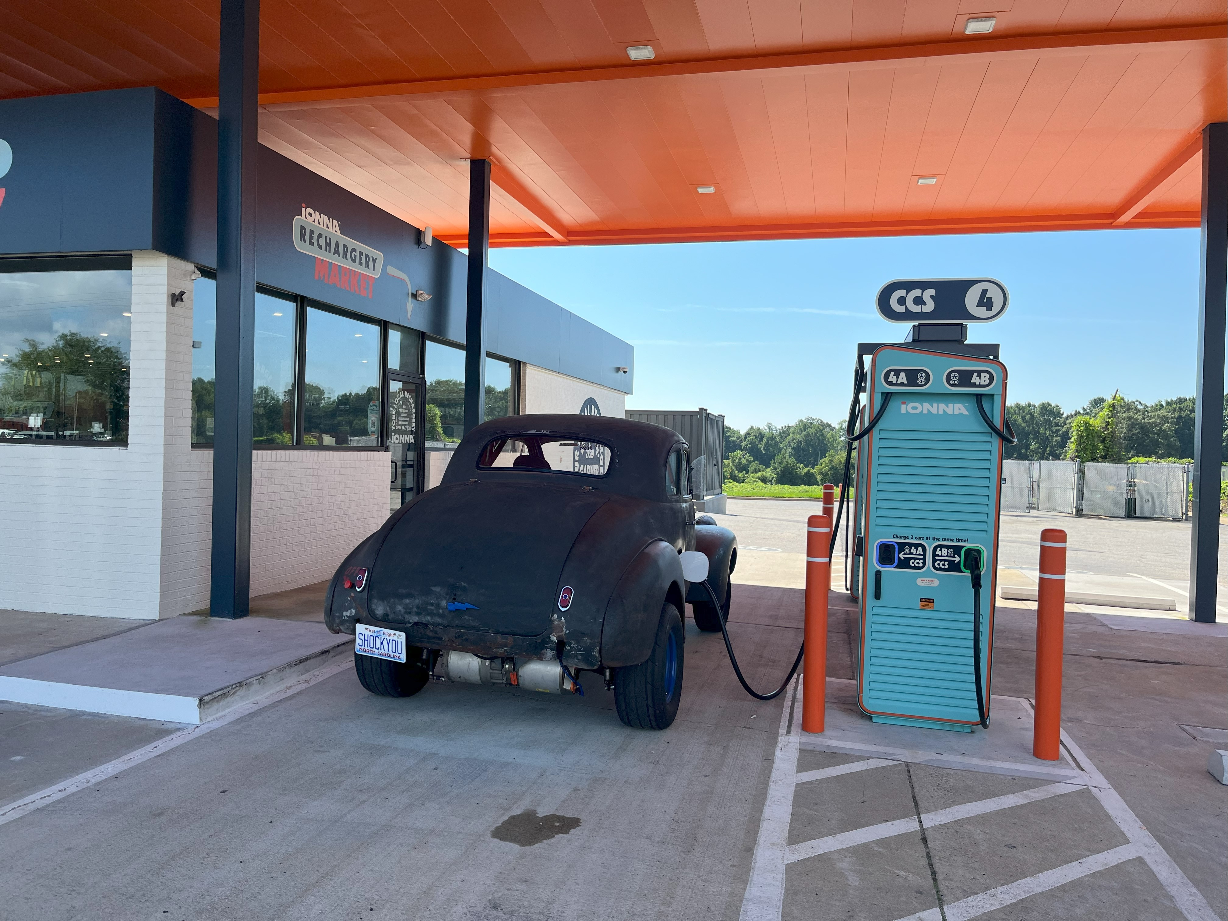

V4 SuC success

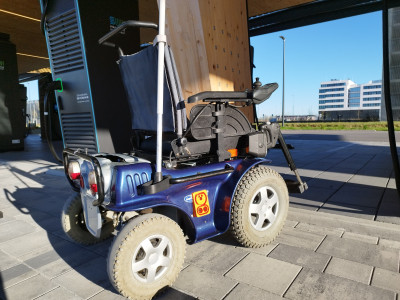

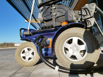

Charging the wheel chair, 24V lead acid, using industrial switch mode power supply to convert 230V DC to 28V DC. Foccci powered by USB power bank because I killed the planned 24V to USB by shortcut ;-)

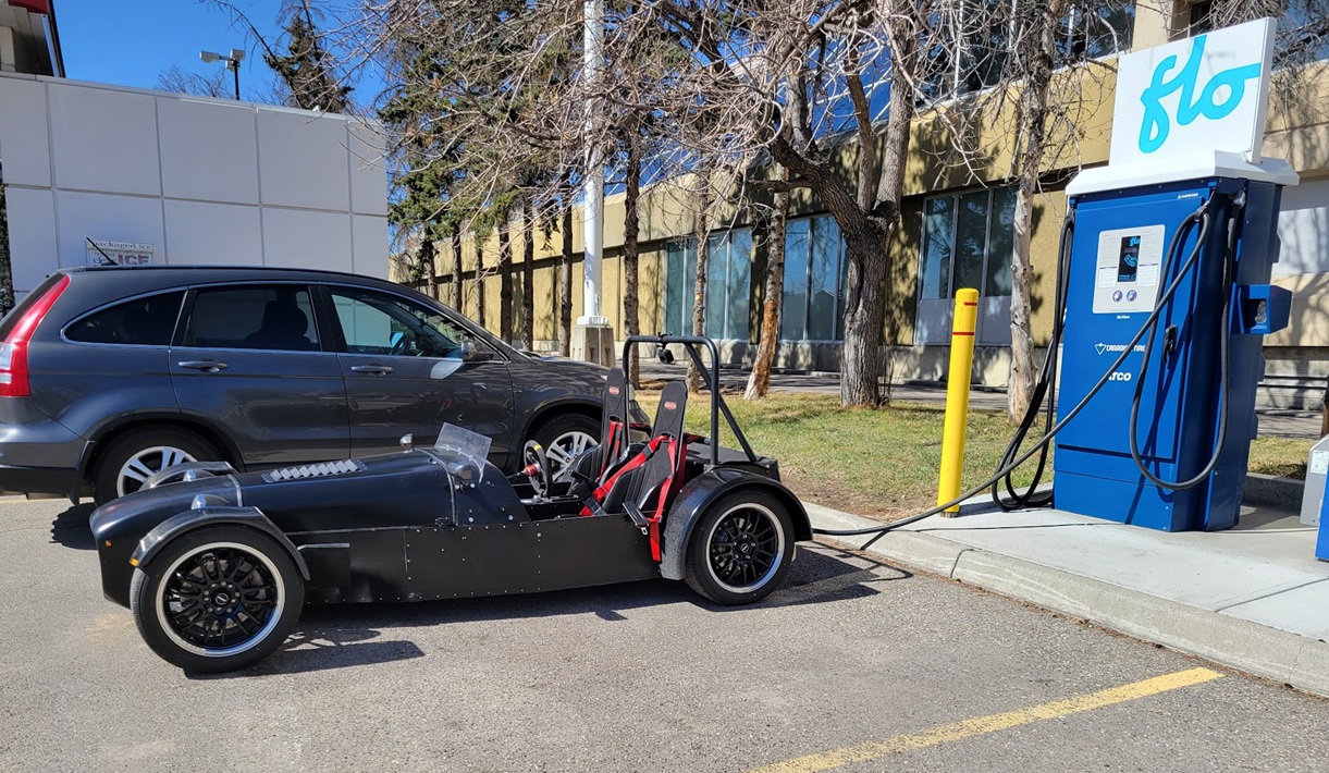

Edit: And a big thankyou to everyone who has developed or contributed to the project. I never thought I'd be able to do fast charging on this car. I've still got to sort a few things out but I'm happy that my first attempt was already relatively successful!
