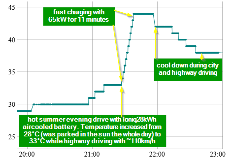

Back from the trip and have some data to share.
I drove the car lightly to the first charge stop and also topped up 9 kWh while visiting Udo (that 3.3 kW OBC is really inappropriate now). I started in the morning with 13°C in the battery and arrived at the one and only quick charge stop with 22°C after 284 km. Again the battery reached 36°C from charging 15 kWh with about 60 kW average charge rate. I throttled it straight from the beginning as I had to leave the car alone to take care of my own business.
The temperature then dropped to 34°C while b-road driving. Then on A49 I drove a bit more spirited with 140 kph cruise control and ended up back home with 40°C in the battery. So 110 kph it is for long range driving until I improve battery cooling.
Temperature is spread evenly across the modules, the warmest one was 41°C and the coldest one 38°C.
I'm no longer 100% sure what it is that starts to smell during a quick charge session. It could also be my 50cm extension lead from the MG charge port. Will check that at some point for signs of over temperature. So maybe I don't need to drop the battery for just that. It seems impractical to charge at 100 kW anyway with a lack of battery cooling.

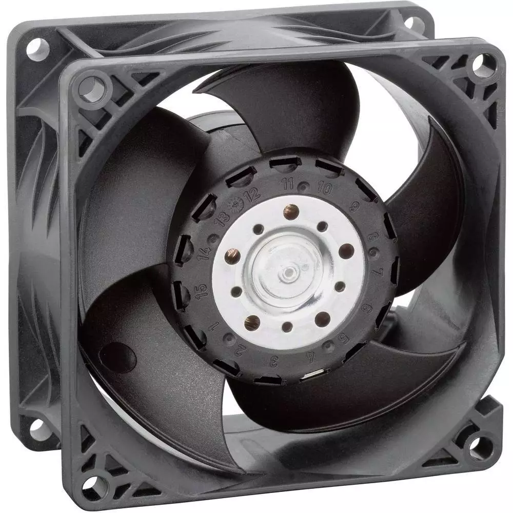

I have such a fan installed inside the battery case.
https://aliexpress.ru/item/32797575257. ... 3931858497

Can it blow air out of the case? How do you make sure no water gets in?

I plan to route the air ducts under the hood or into the trunk

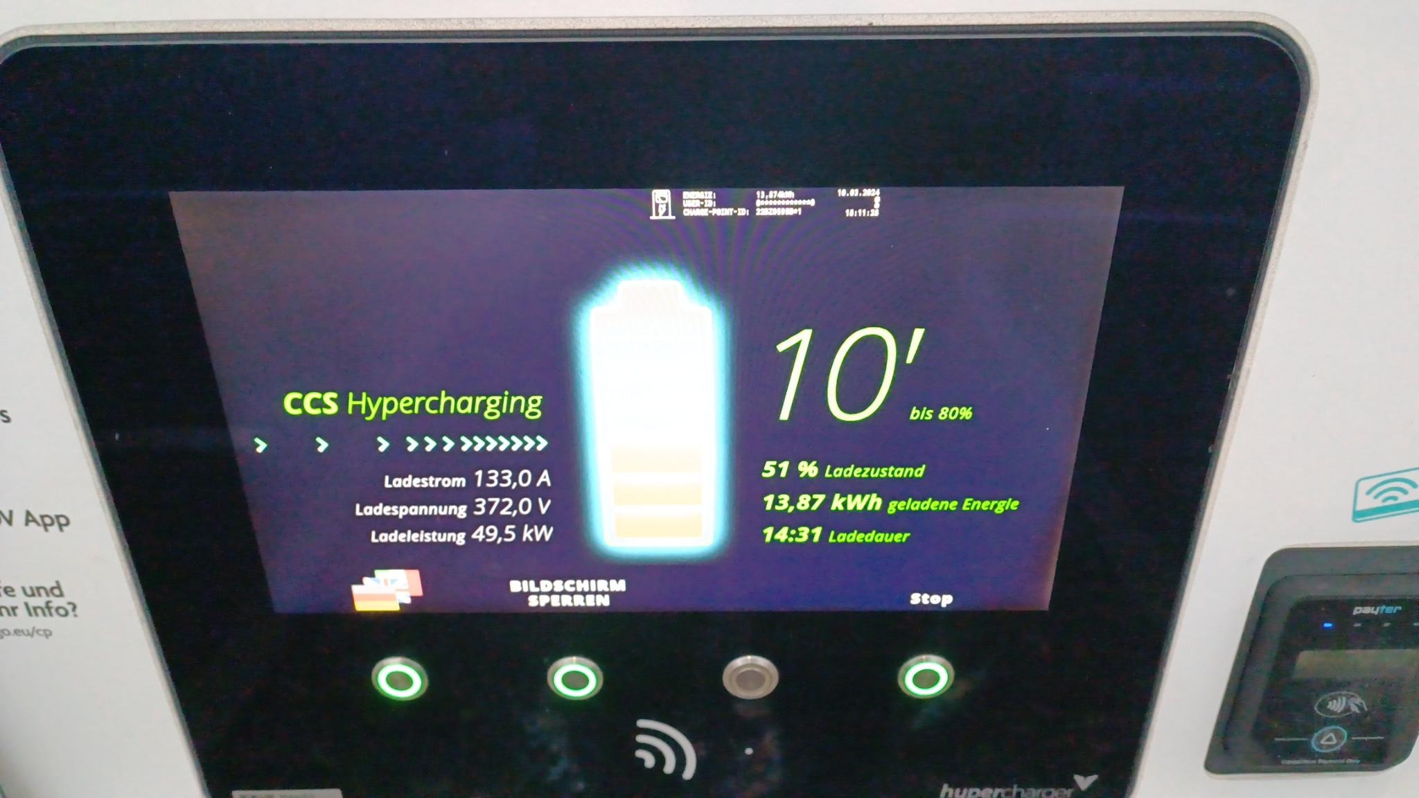

I wanted to make it to Hamburg (300 km) on a single charge but 40 km before my destination and with 18% left I chickened out and plugged in for a few minutes. When I arrived the battery had time to rest and let the SoH estimation run: 100.5%
That is with 155 Ah configured (158 Ah is spec). So the 18% were accurate and I could have made it on a single charge. Also I didn't start at 100% but 91%.

As a consequence I have now made the derating curve for temperature less steep. Derating starts at 43°C for charging and at 45°C for discharging. That increases the chance of hitting and equilibrium instead of switching back and forth between 100A and 0A.
On the hardware side I fitted a larger fan: 14000 rpm, 40W, 230m³/minute.

The temperature increase while just moderate driving is surprising. Maybe there is still unintended resistance in the module connections (oxide, missing screw torque?).
For comparision, my also air-cooled Ioniq, which has a quite low temperature increase while highway driving in summer. The blower only started while fast charging.

Well actually those plots sort of align. I add 10 °C by driving 250 km with a taller and heavier vehicle while you add 5°C by driving how many km? Also it looks like the Ioniq battery also collects most heat towards the end.
What's way better in your case is the cool down.
