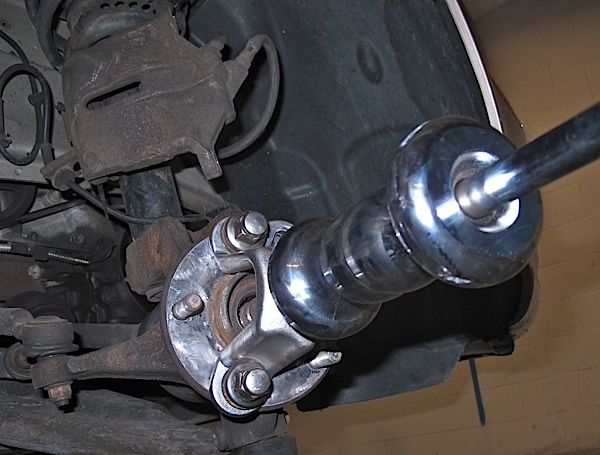

yeah you'll want to make a piece of steel with three holes, so your slide hammer is centred on the flange. Bolt your steel on where the CV attaches.
This is a wheel hub, but you'll want to end up with the same alignment:

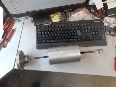

What did you use for the attachment piece? Is that a machined piece or something reused?

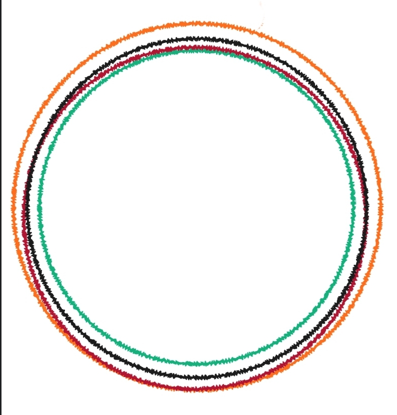

As for getting this style axles out, some have too sloppy of a bore for the retainer spring and the spring can get out of place to where it binds between the ID (Green) and OD (orange). The retaining clip (red) needs to be aligned concentrically with the black circle but it can fall down to the OD or even past if the groove isn't designed properly or it's the almost right retainer clip that floats too much. The clip blocks the splines from pulling out on the sides where it overlaps the ID & OD.
So what has to happen is you rotate the stub axle as you gently pull out or do a quick twist and a quick pull mid twist and keep trying for the clip to fall into the right place. When it is in the right place the stub axle will pull out a little bit more than it was / you can feel the spring being squeezed while pulling vs. feeling like it's just hitting a wall. You have to keep slight outward pressure to keep it in the right spot once you get it until you can pop it out.
If you pull hard enough to distort the retaining ring it can get very tough to get the stub able out.

SO built a slide hammer attachment that allowed me to pull directly on the adapters, and no luck. I got the case open the 1/2" that it is able with the adapters in, and tried applying pressure from the back side of the axle, no luck. I tried combinations of those, and with/without the axle fork, no luck. These damn things do not want to come out. The splines are all fine/aren't jammed, as the adapter still slides in and out slightly, it really is the damn retaining ring does not want to compress.
I'm trying to avoid just buying another set of adapters, especially as I need lots of other parts for other upgrades, but I'm at a loss at this point. I appreciate the help from everyone.
