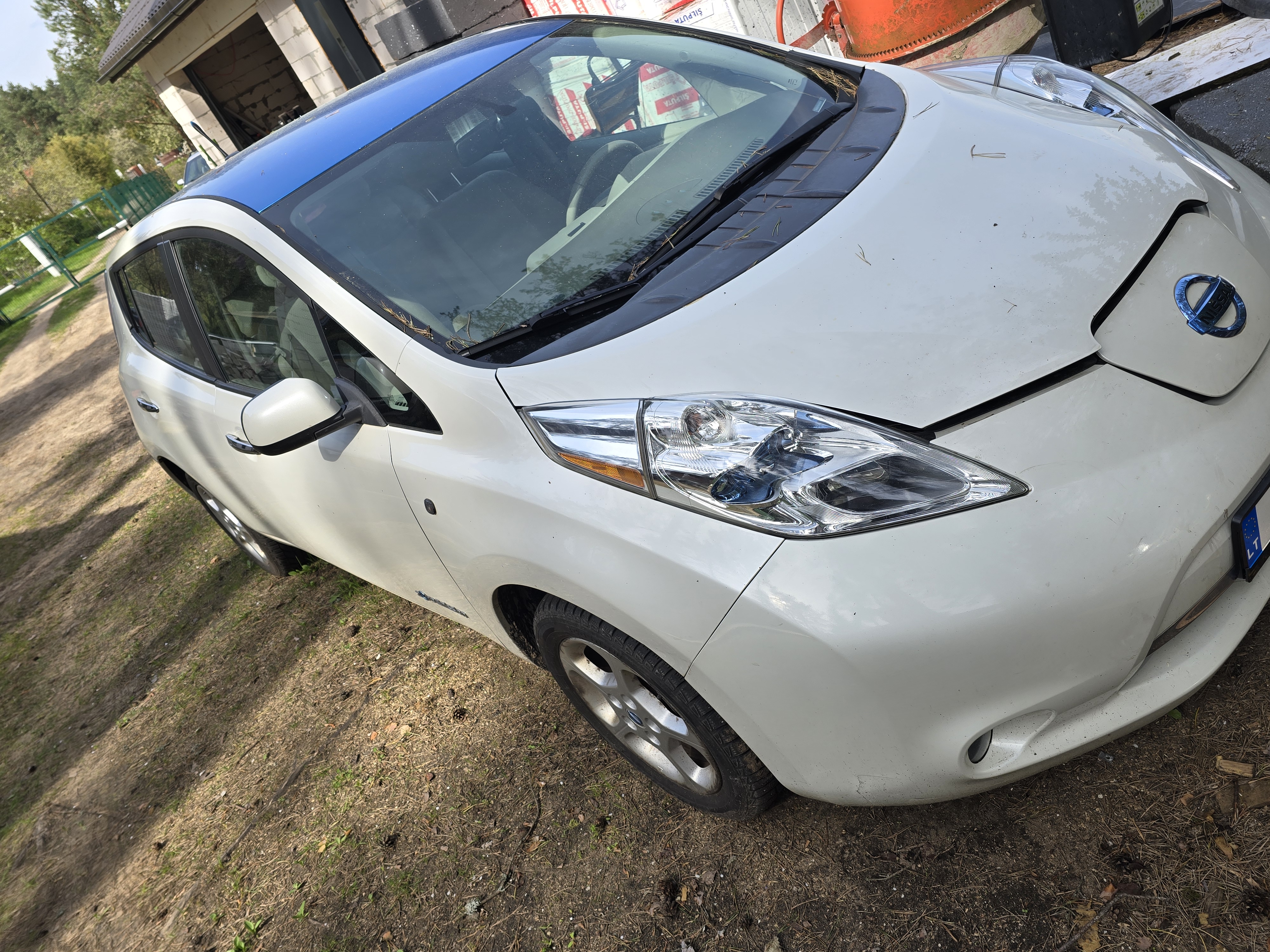

Hi. is is possible to power on full Leaf 2015 car with ZombieVerter? i would like to test all on actual Leaf donor car before taking components of it.
As I understand the ZombieVerter could use Leaf BMS messages instead of ISA shunt?
Waiting for VCU to come to start testing

Hi. Leaf service manuals, wirings are beeing analised. Leafspy pro is in the pocket for last 2 years
received Zombie, will try to destroy still drivable Leaf. Just passed inspection and is road legal for next 2 years. Should be good test kit before installing it in receipent car
