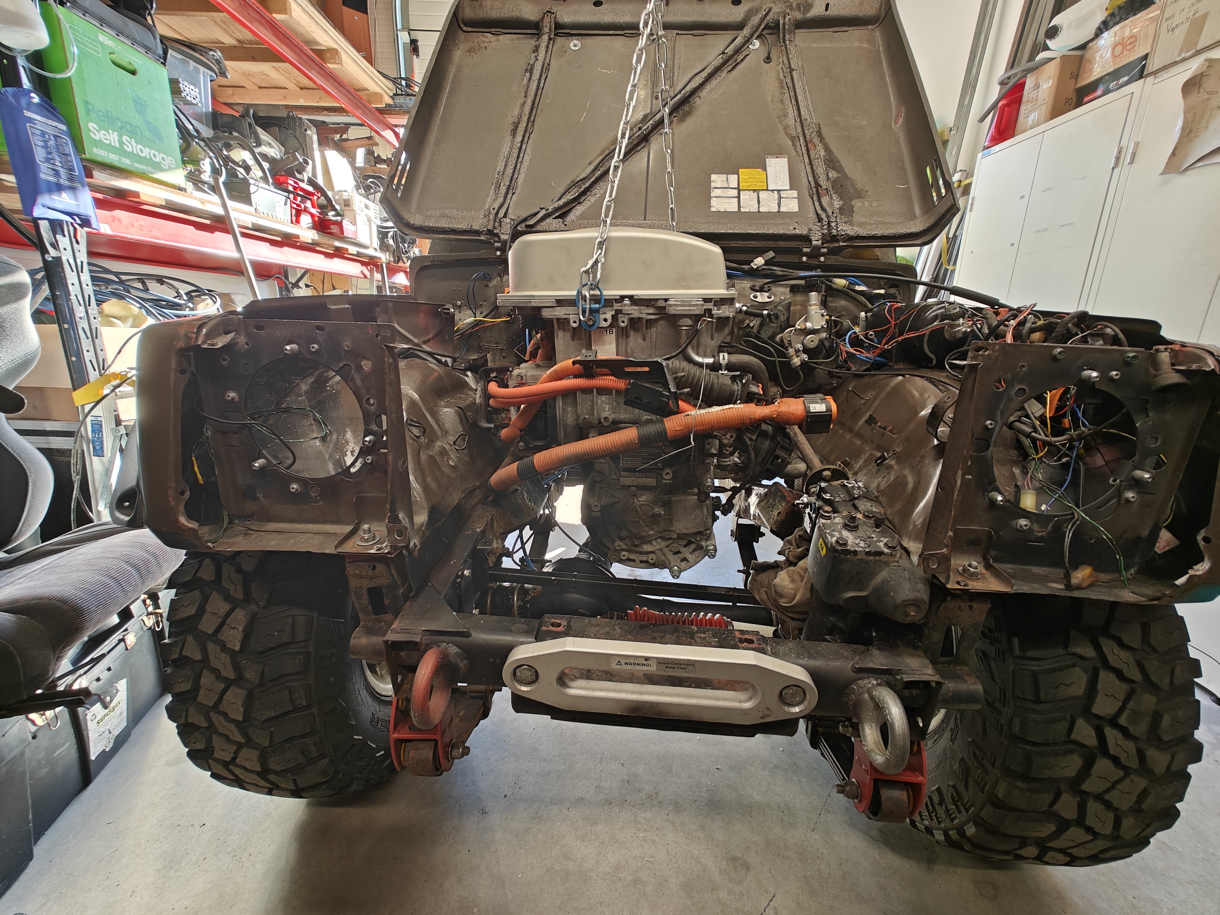

Well, looks like I'm in the business to shine some light to this project.
Maybe a word about myself first. I'm a mechanical engineer and a Suzuki nutter. The SJ Suzuki has been my 1st choise to rid me of my excess time and currency for over 25 years.
I've got a Suzuki SJ410k which has met a Samurai along its life and thus has Samurai running gear in.
This is a recreational Offroad vehicle for me but is also driven on pavement a day of driving is maybe 100-120km at worst (typical would be less than 50km and then a day of wheeling) So in that sense also a perfect candidate for a Leaf swap:)
Yes, this is a rusty shitbox, but I'm not bothered about it.
The plan:
Phase I - Get the motor stack in and run Leaf battery on the pick up bed (if it fits). The idea is to skip motor coupling with transmission and go to TC with a drive shaft. Gearing should be ok
As this will be a road use car, I'll need to add a heater. Suzuki didn't make the heater core too big, so instead of shoehorning a PTC in place of it, I'm thinking about solving heater topic with a Volkswagen heater. I was looking at them from a online wrecker and they don't seem to cost a dick and an arm. This probably needs another coolant circulation pump?
I've already converted the retrofit powersteering to electrohydraulic, so brakes would be next. Vacuum pump should do the job.
It should be a first drive at the end of Phase I.
Phase II - Repack the battery so it can be squeezed lower, between the frame rails and majority of the mass in front of the rear axle to better weight distribution. Cleanup the rats nest of cable job that will definetly emerge along the way. I'll most likely eat my words, but for the time being I don't want to invest in a separate BMS, so Leaf LBC will be used and rewiring ahead.
I can't seem to get my head wrapped around the BMS topic. Why people seem to chose something else over the Leaf LBC even when using Leaf modules?
Inspection / MOT at the end of Phase II
Phase III - The winch --> This is a wild thought for the moment, but once I have 400V on the car, why not upgrade the winch motor from a 12v Amp chomper to something more sensible? A typical winch motor is 2-3Hp, so there should be at least some options for this. Hyundai HSG or something like that? Any Idea what power the electric AC compressor motors make?
Next on the list would be yanking all the ICE stuff out and get on with building.
I've ordered a full Leaf drive stack with a 30kWh battery, they should be arriving during next few weeks.
I'm now in the controller lookout phase.
At the moment my understanding is that Zombieverter would be the way to go if opting the Leaf full stack path. Any reason why not?

Some goodies came in yesterday!
Got the motor stack and battery in the shop now.
Looks like I got most of what I is needed. The heater? cable/connector seems to be the only thing missing. Anyone have a part number for this cable so I can find this easier online?

The other day I got things connected to the extent that I plugged the HV battery to see if the inverter would see the voltage rise during precharge (I did study the Leaf SM and to me it looks like the inverter voltage measurement is used during precharge to determine when to close main contactor.
Inverter voltage goes up during precharge, so next I'll attempt some copy-paste-coding and see if I can get the Leaf BMS talking with zombie
After some headscratching and pain with getting my modifications to compile, success?
The Leaf inverter module in the Stm32-vcu code seems to send Leaf BMS messages to the CAN, I suppose these can be commented out, if the real thing is connected? :)

There was a divorce this weekend! Didn't weigh the engine and transmission yet, but so far I've removed about 150kg of parts and this doesn't include the exhaust or fuel tank either.
Washed the engine bay, although it wasn't too bad, now at least it's nicer to fit the Leaf drive stack in.
Did also some heater cable modding so I can plug it in Leaf PDM.
VW heater cable now in Leaf AC compressor cable gland.

CANified meter cluster working!
Intermediate driveshaft would be close to 80 cm, I I'm not going to divorce the drivestack
Otherwise it looks that it would fit
Ok, not really...
I was secretly hoping that this would fit, but the PDM really is a chunk
Weighed the Leaf divestack, 104kg
Removed GTi engine with gearbox approx 135kg
Tires are quite heavy, 33,2gk each.
