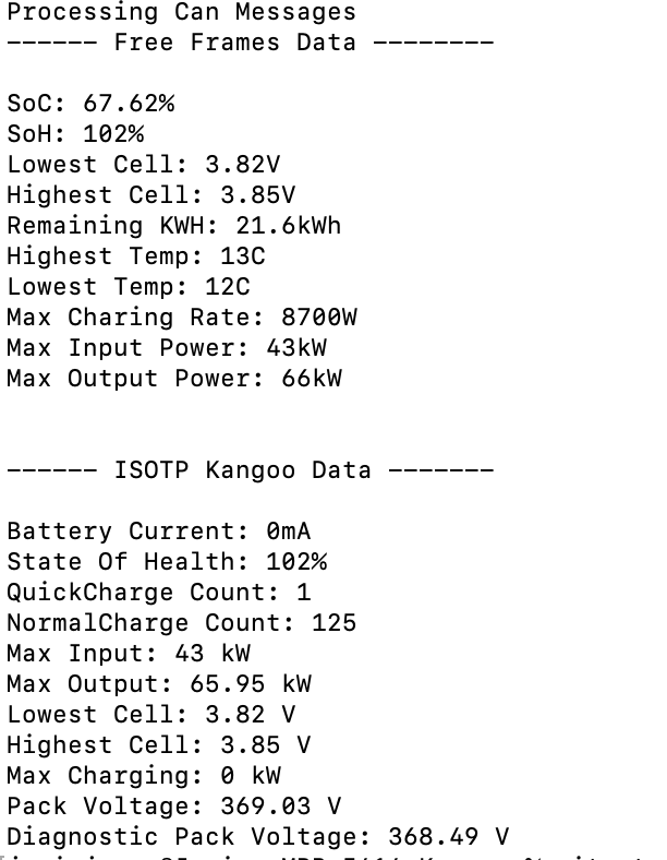

Ive figured it out, and now working on some code, will add the github when it's done.
Some values still need some work, but I'm able to query all the cell voltages and some other values.

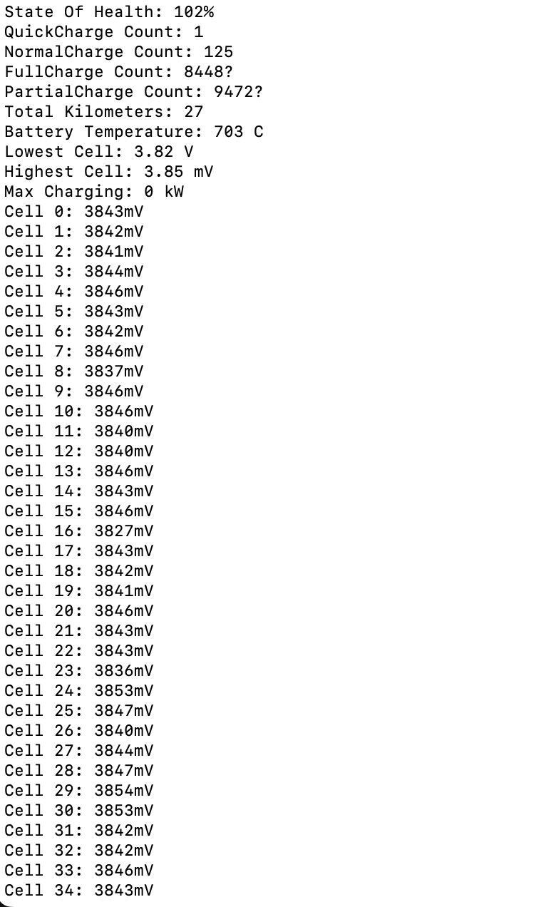

Thanks, I'll give it a watch. Interested in now they get the ISO-TP response mappings. I've got much of it now, I think, but would be nice to be able to confirm with something 'official'
I couldn't get canZE to work with just the pack.

I am he. Zombieverter doesn't need to know the individual cell values so haven't implemented that in zombie. Other than the decoder I put on GitHub I've not touched it since, but I never automated the isotp to request them, I just sent them with savvycan.
