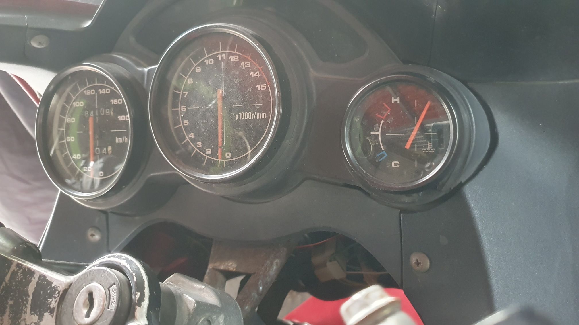

Well, that was one evening mostly wasted:
[*] RF600 wiring colours don't match with the RF400... At least the connector pinout seems to be the same
[*] probably busted the temp gauge with 12V applied...
[*] couldn't get the RPM gauge to move with function generator of my hobby charger. Probably have to take it out to bench test with the iPDM56.
[*] labelled the wires for some of the idiot lights at least
Also ordered a second 56pin connector that I can keep wired in the bike as I add features on the bench. I think I found a location last weekend with some CAD, will make a compartment.

marcexec wrote: Wed May 17, 2023 10:03 am
A lot of older gauges are run at around 9V through a voltage regulator, but I would have thought it would survive 12V at least for a while. Is it just stuck at the top of the scale? perhaps a little percussive maintenance is needed??
marcexec
Posts: 122
Location: Dublin, Ireland
Has thanked: 536 times
Been thanked: 45 times
Re: The Hitchhiker's guide to Celeron55's iPDM56 VCU & automotive Arduinoing
Post by marcexec »
You might be right. I removed the gauges (and cleaned them) yesterday and realized I should probably have done that from the start.
Well, lesson learned - take the gauges out to bench test, guys.
It looks indeed to be stuck just under the plexiglass cover.
I'll whip up something this weekend.
