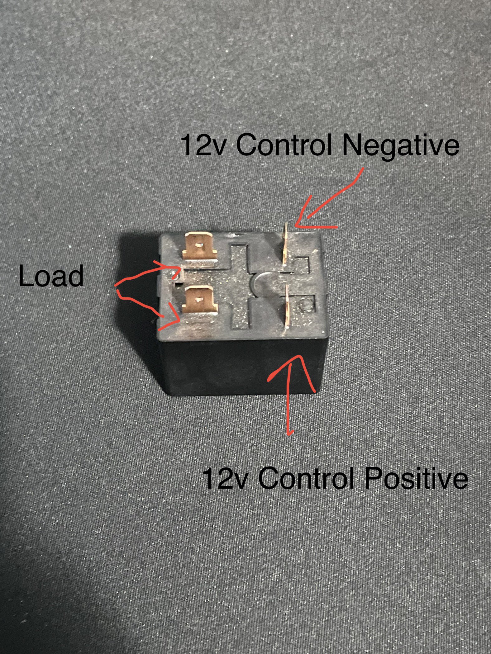

AEV6501C Diagram Nissan Leaf Precharge Relay
lukes
Posts: 14
Joined: Sun Mar 06, 2022 12:56 am
Has thanked: 4 times
Post by lukes »
Pin diagram for Nissan Leaf Precharge Relay
Holding wattage ~1.7w
