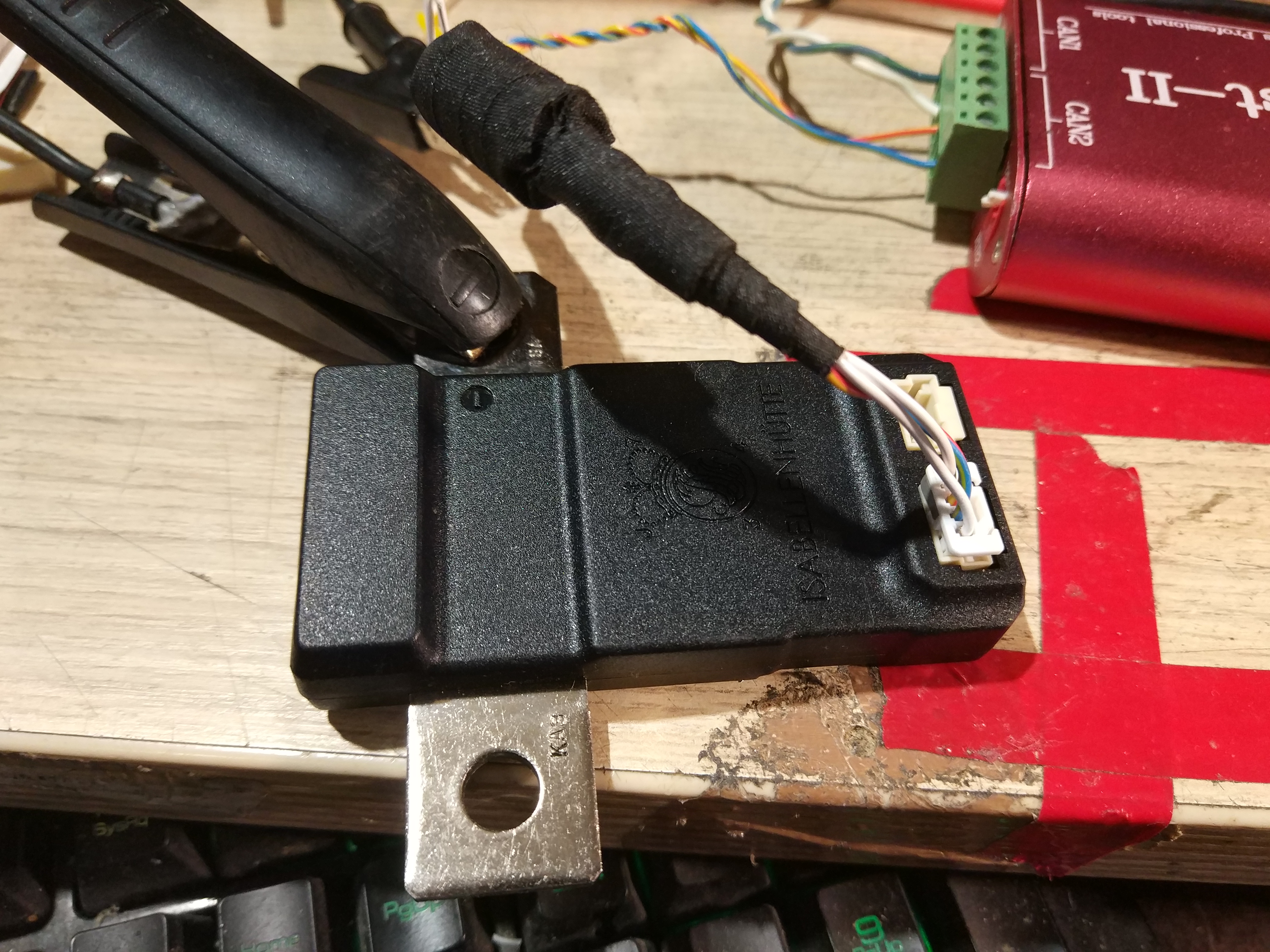

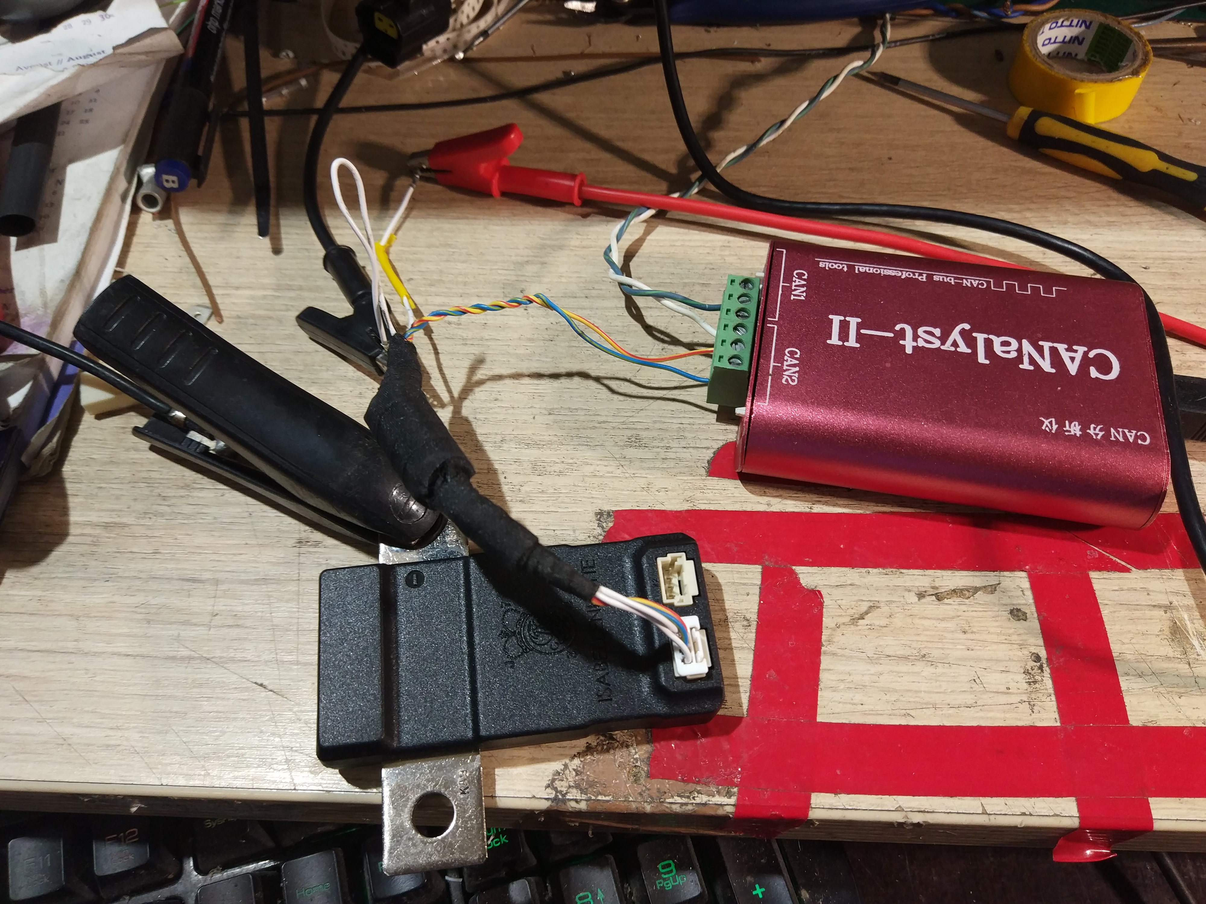

You may remember i pulled the ISA shunt from IPACE battery assembly together with two Gigavac GV200-051 contactors.
There was also a LEM DHAB S/159 current sensor in the same box on the same connector. That seemed strange.
So i went and tried to connect ISA shunt. I got it 12V and its CAN came to life. Surprise surprise! CAN bus IDs are not the ones that Isabellenhutte is saying in its manual. But i can see they should be configurable.
For now i get this msgs:
03C3 00 01 FF FF FF EB
03D2 04 06 00 00 00 D6
03D2 stays pretty much the same even if i apply current.
But 03C3 reacts to current flowing through it. For a start i gave it a small 12V light bulb which i see pulls 1.7A. And i get response
03C3 00 02 FF FF F8 C4
I see i will have to test this further with known loads and log results. But i see that FF FF FF FF is an area for reporting current. I will just have to see how accurate this is.

So you do: FFEB(65515) - F8C4(63684) = 727 (1831)
So It is reporting back 1831 mA

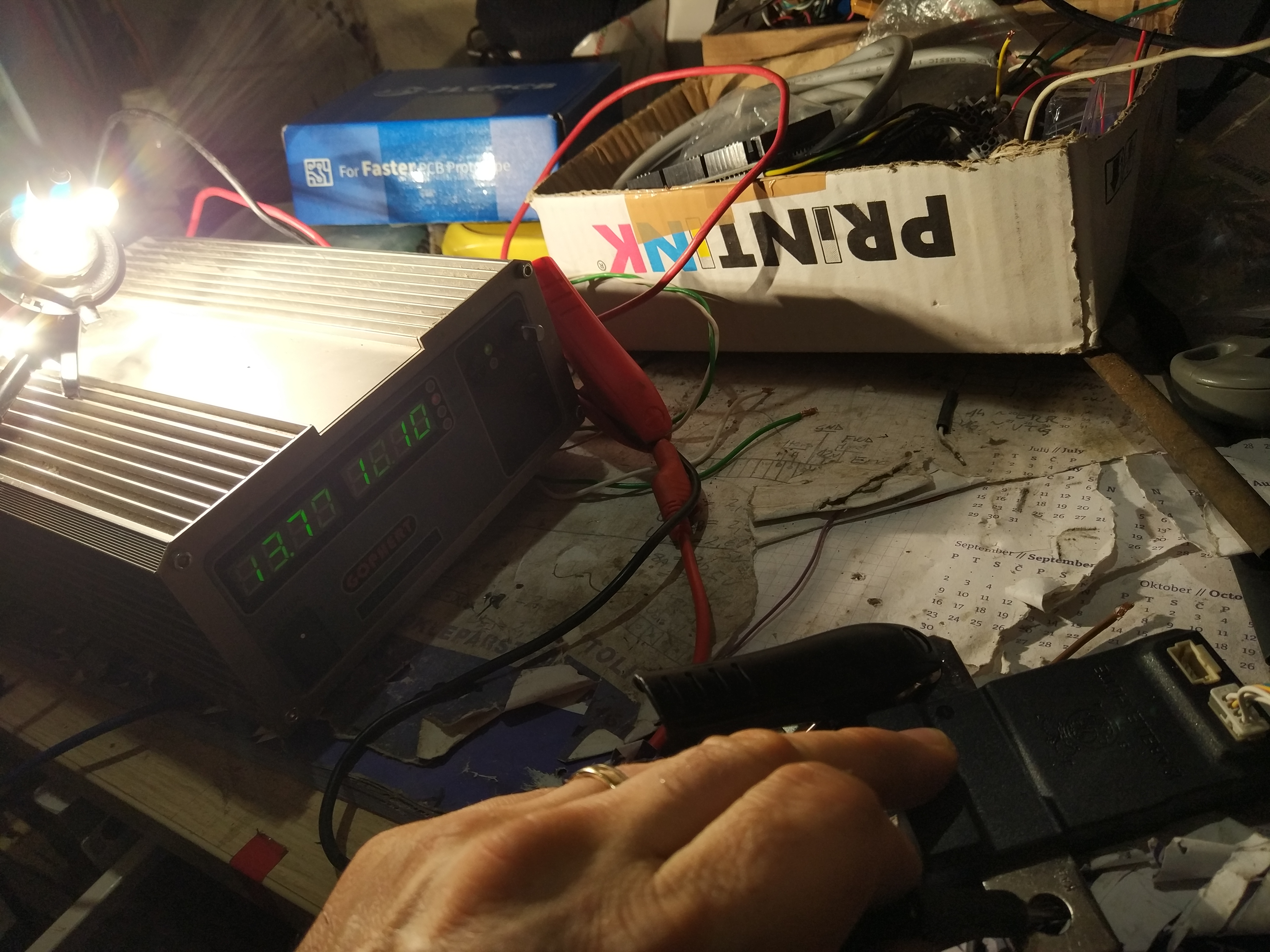

Ok i tried progresively with H7 light bulbs that i have here plenty.
1x H7 Light bulb at 13,65Vdc draws 4.25A and that translates to ID 03C3 msg 00 0F FF FF EE BC.
So i get 4399mA! Quite good i think.
2x H7 Bulbs were drawing 8.55A according to my power supply which gave ID 03C3 msg 00 0E FF FF DD 77.
Which i calculated to 8820mA!
I now used 1x H7 and one H4 bulb with both elements lit. This setup had a draw of 14.5A. I got 14791mA draw on ISA shunt.
Next one 2x H7 and one dual H4 bulb for 18.2A. I got 18763mA on ISA.
Then i reversed the current and reduced load.
With 18.2A load i got 18667mA! ID 03C3 msg 00 00 00 00 48 EB
With 14.25A i got 14534mA.
With 8.5A i got 8741mA.
Last one for the day was 4.35A for msg at 4418mA!
Really accurate at low end. Next i will setup my PTC heater and try to load my cars 12V wiring with it.
