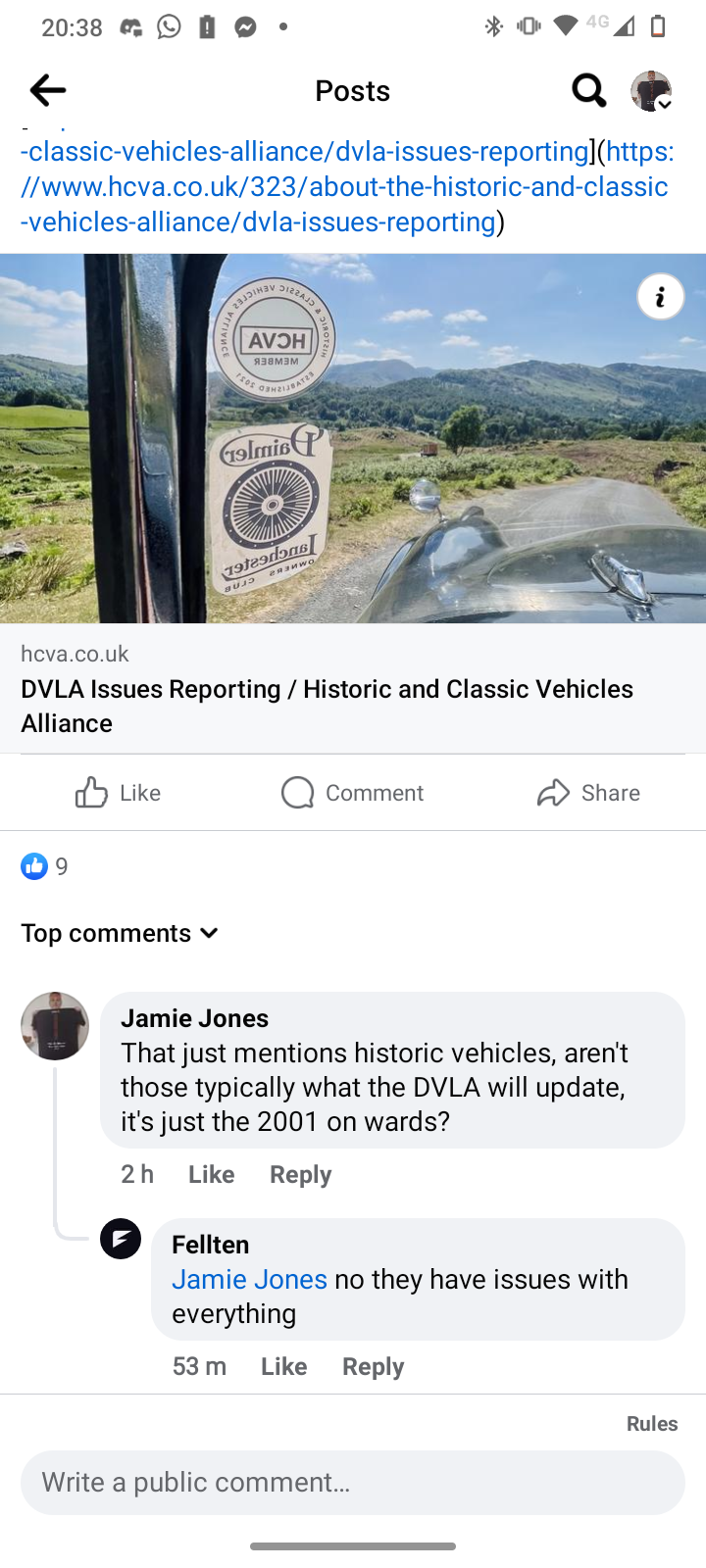

Feltham are asking for DVLA feedback, seems to be saying they're having issues with even pre 2001 now. Fill in if you can.
