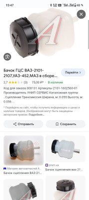

look for an option from very old fiat or look for lada stores (vaz from Russia) . they have external brake tanks small for the hose and cost 1€

Romale wrote: Tue Oct 24, 2023 12:47 pm look for an option from very old fiat or look for lada stores (vaz from Russia) . they have external brake tanks small for the hose and cost 1€
Yeah that's one option for sure.
Still would need something on top of the master cylinder though, and that's the trickier part than the remote reservoir. :? For the remote reservoir I'd like to use the VW original, since it has the original mounting screw holes in right places and does feature a hose outlet in the bottom.
I mean I now know how to lathe so making some aluminium plugs and drilling and tapping threads on those for the remote reservoir is an option I'm considering. That way it'd not matter what the remote reservoir is, as long as it'd have a connection for a hose.
But for safety I'd like to have some small reservoir directly connected to the master cylinder, then run the hose to that. That way if the hose is damaged and the fluid runs out from the main reservoir, there's at least some still sitting on top of the master cylinder.

Bought the two-piece reservoir
Widened the bolt pattern with a file juuust about 2mm and mounted the thing in there. Just to find out that the tie rod conflicts right where the motor connector is. :D There's no steering with this!

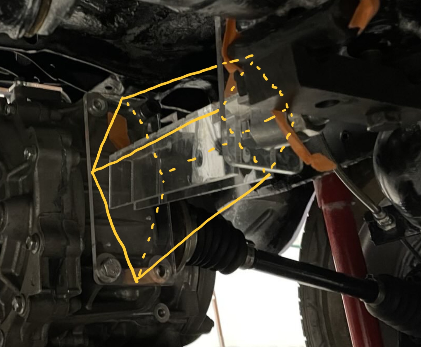

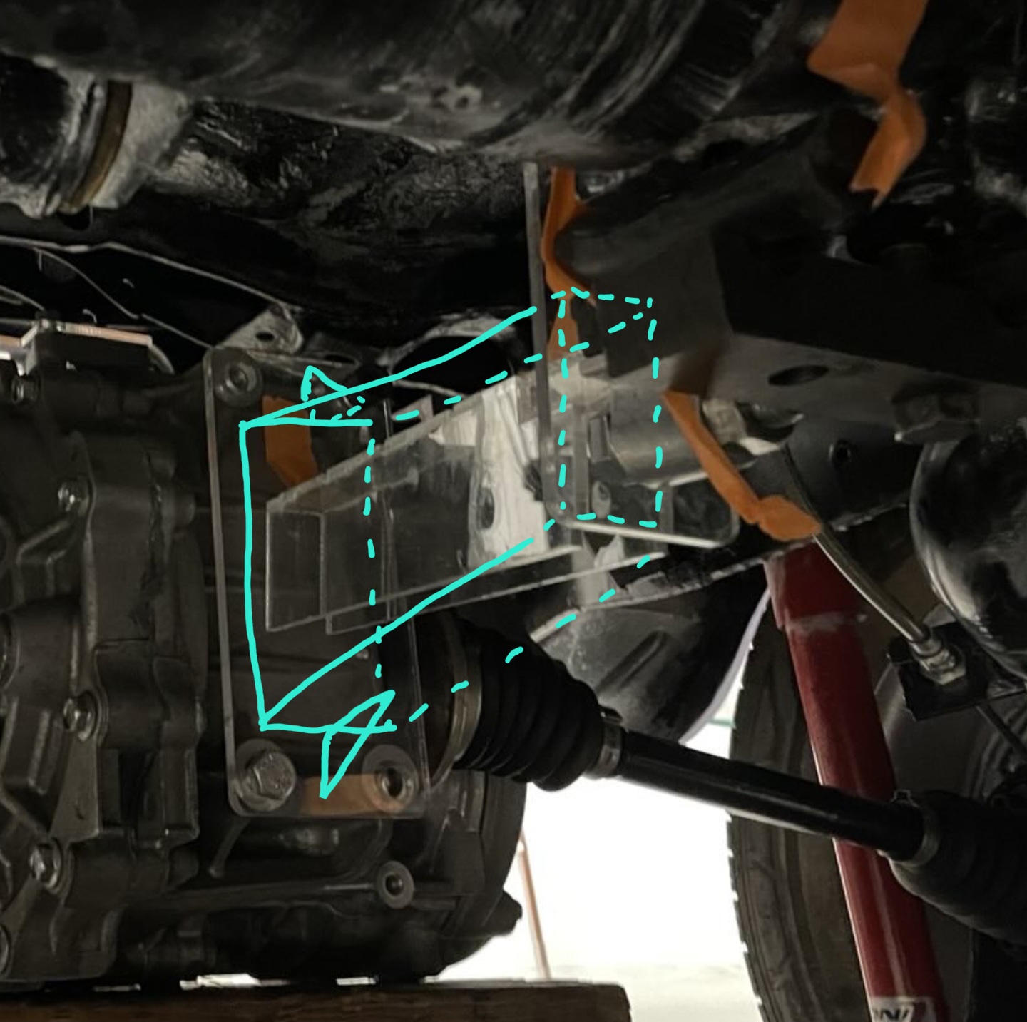

Lasercut templates from clear acrylic to check that everything fits:
And oh does it. It's so satisfying to draw things onto the 3D-scan, make templates and find out it's within 0.25mm! :D
Crossbar 30x30x3mm
L-profiles 40x40x3mm
Front mount 50x30x3mm U-profile
Upper mount and all the sheet steel parts: 6mm plasmacut sheet welded together.
You with more experience in motor mount building, does this style of mounting sound too much? Too little? I'm bit unsure still with the 3mm thickness, but I don't have any intuition on how strong these are. I just want my motor to not eject itself on a motorway... :D

The bolts through the tube will likely crush over time. Consider drilling them out and adding a welded tube through the bolt hole to take the load.
Conical / flush head screws help center holes as you weld things together.
The long gap in the u should get an I beam type reinforcement, especially with the long lever arm to the motor acting on it.
Think about the wheel torque as motor torque x gear ratio. The motor / transmission gets that same torque but in the opposite direction. As the mount legs get longer there's less load on the mount itself but you need more strength for the mount material the longer they get.
Your welds look decent, maybe a bit hot. Look at the weld's penetration on the inside of the tube.
Do not use brake clean to clean the tubes.
Also consider boxing your mounts like these,
I'm not sure what the small side looks like, but leave room to tighten the bolts.
