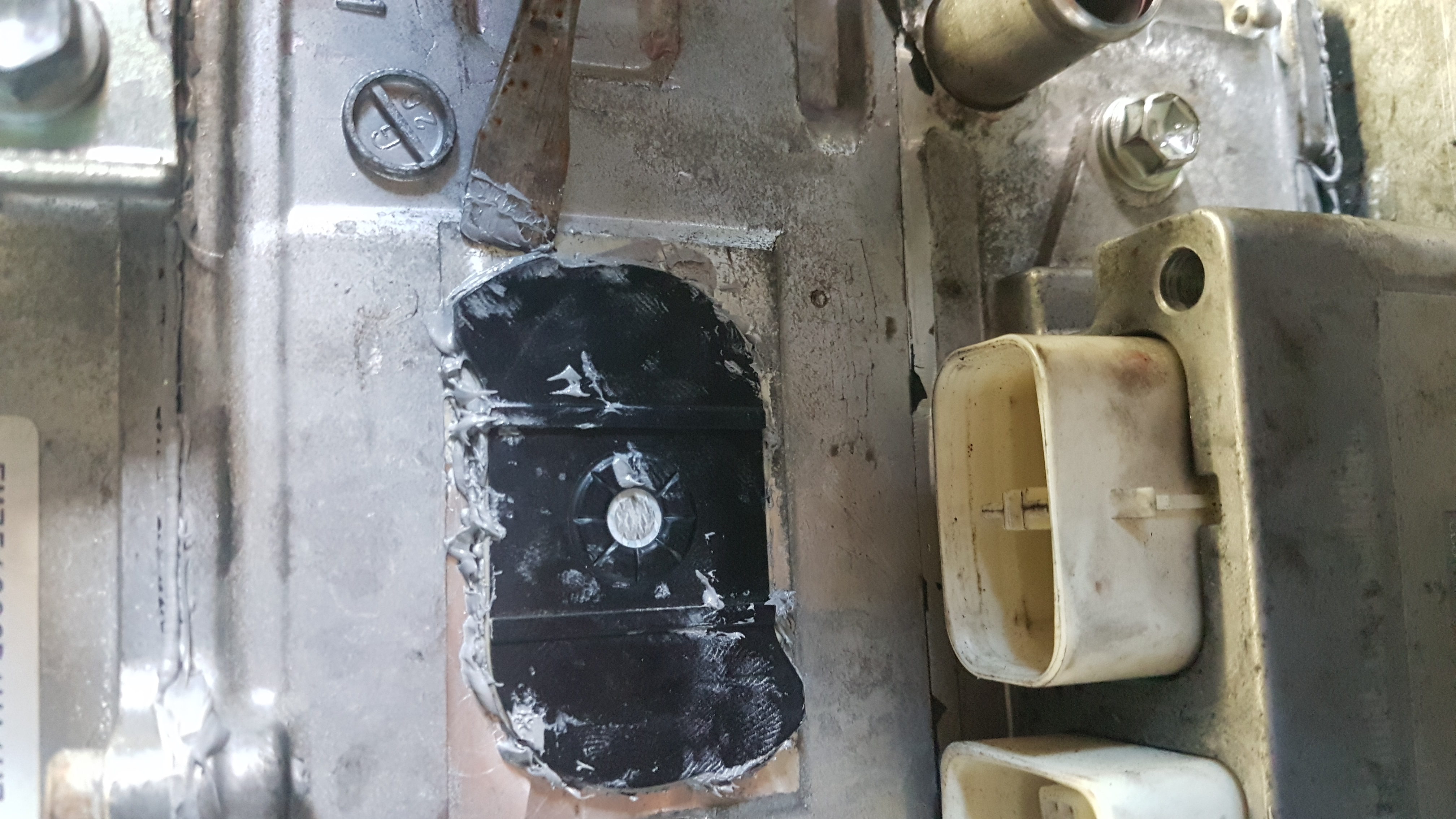

Now strip the lower half of the camry inverter off by
First removing 2x 10mm bolts on the coolant conection side holding the black plate on
Then pry the black plastic plug out ( dont damage this to much u need it)
Undo the 2x 10mm u see in the hole
Now undo the 4mm allen bolts holding the lower half on
And very cearfully pry the base off (note the 2x dowels i start at the end with the coolant connections at the dowel) remove base

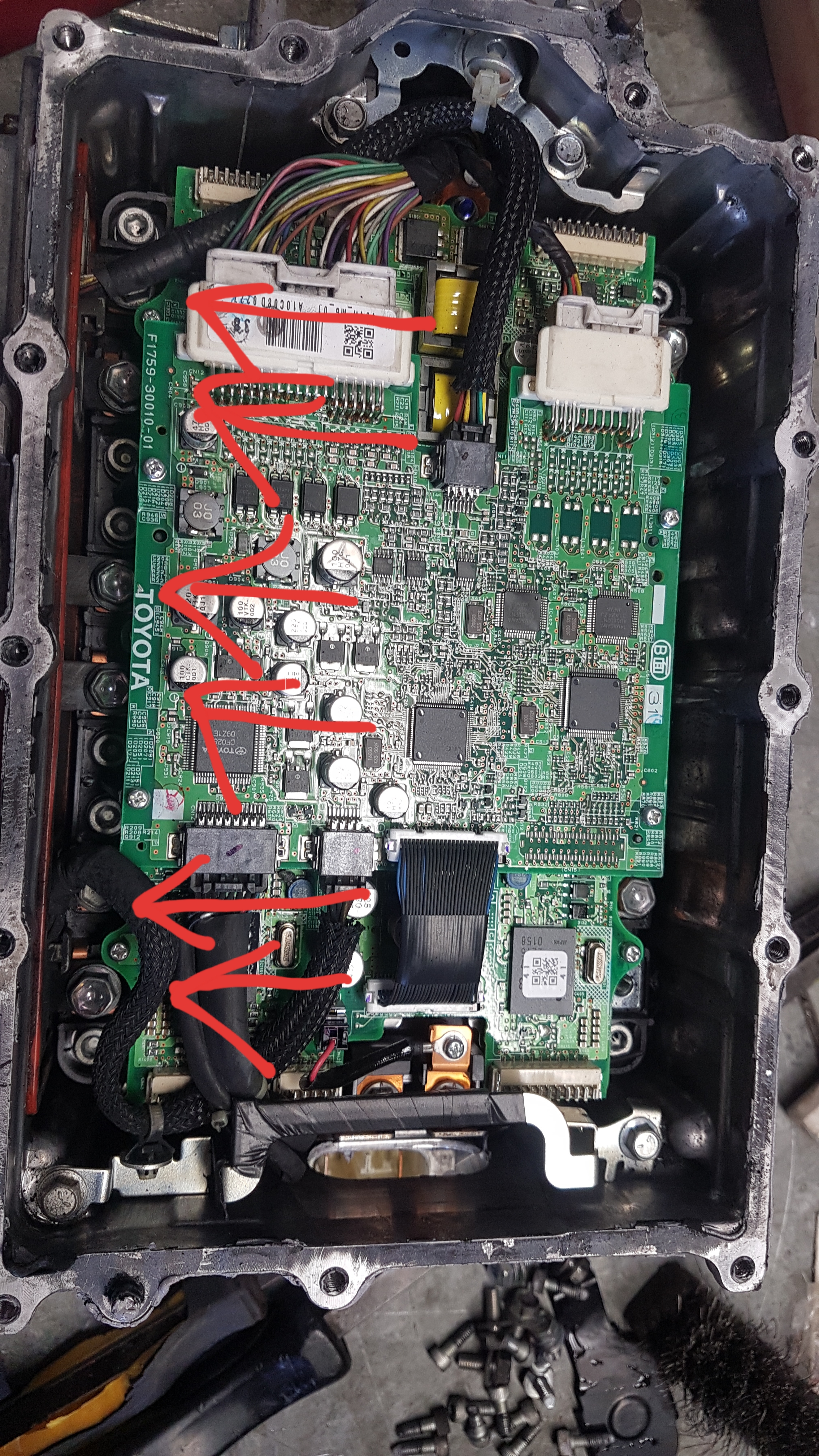

Remove the board with 4x screws and 6x plugs

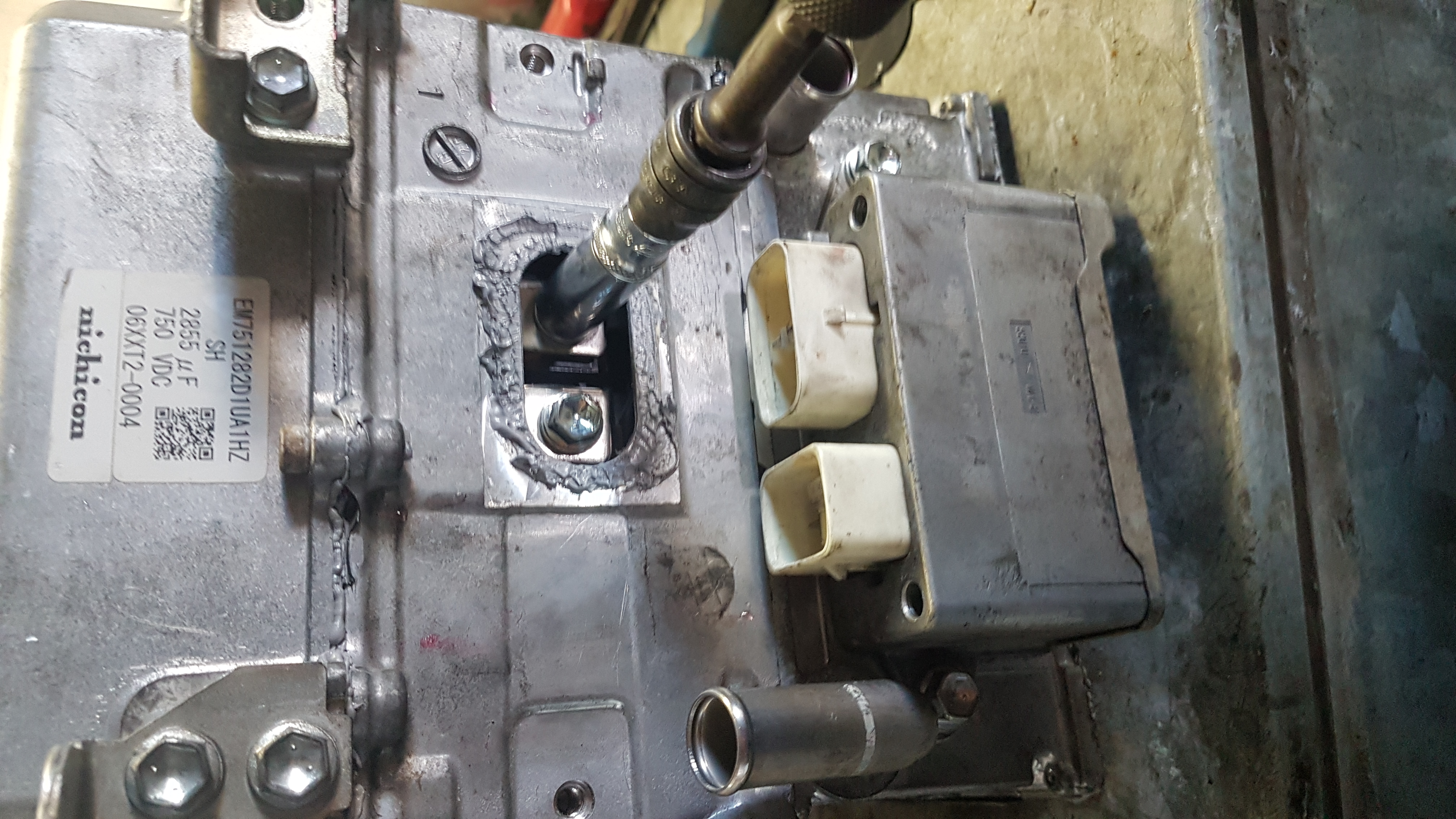

Now undo the 4x 10mm in the side that hold the two motor/gen cables
Now remove the 6x 10mm bolts (ones with red arrows in pic) holding the motor/gen bus bar connectors and pry the connector and housing off
Now remove the 12x6mm allen screws holding the IGBTs to the inverter body
Now remove the IGTBs and soldered on board (this is all u need from the camry inverter)

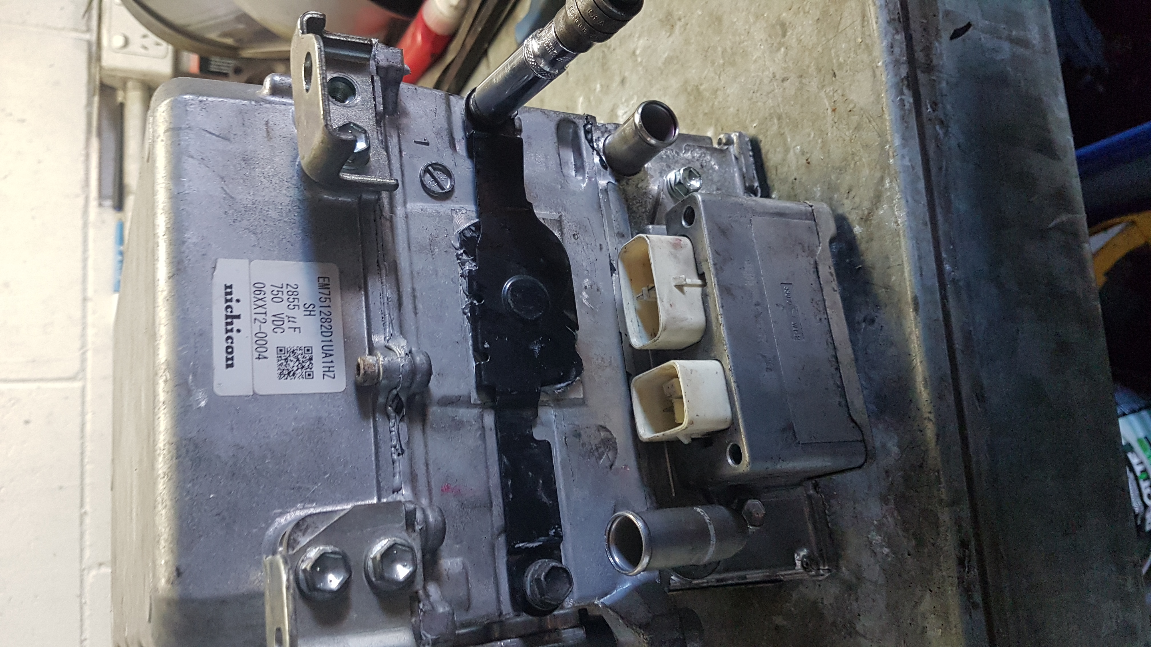

Now strip ur GS450H inverter same as above
Remove the board with 4x screws and 6x plugs and keep you need to refit this
Now remove the IGTBs and soldered on board (if u look under the board you will see the blowen IGBTs) and discard

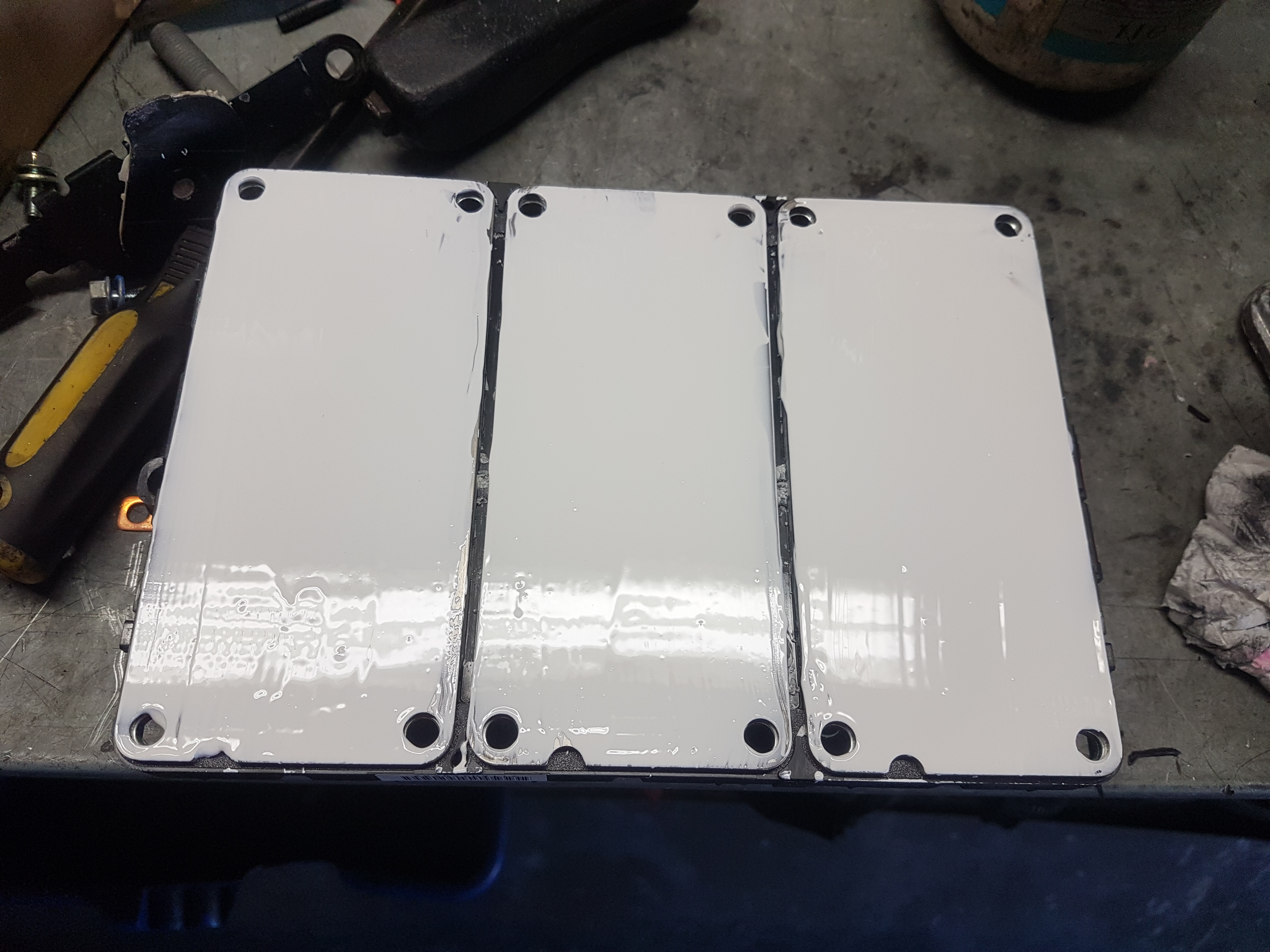

Clean off all the thermal paste off of both inverter and IGBTs
Reapply a very thin layer of thermal paste to the IGBT side (if u leave the paste in a cup of hot water it is easyer to work with)
Now fit the IGTBs and soldered on board from the camry to ur GS450H inverter in the reverse of above

Hi, nice thread. A question for you. Where you marked, does this means that is where the IGBTs are, or you are just pointing at the PCB, where they are mounted?
