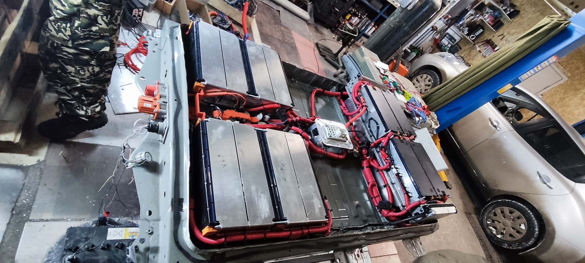

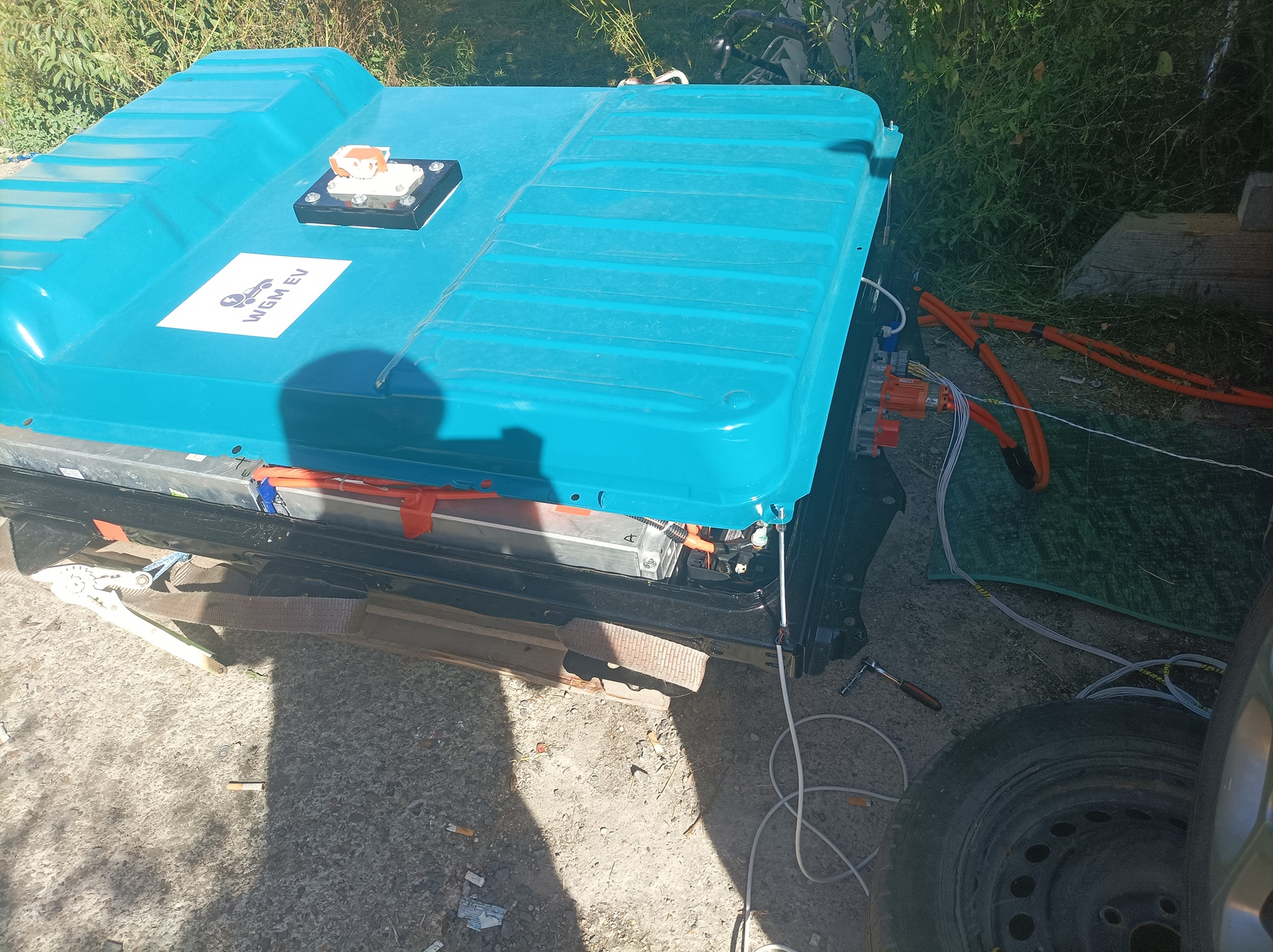

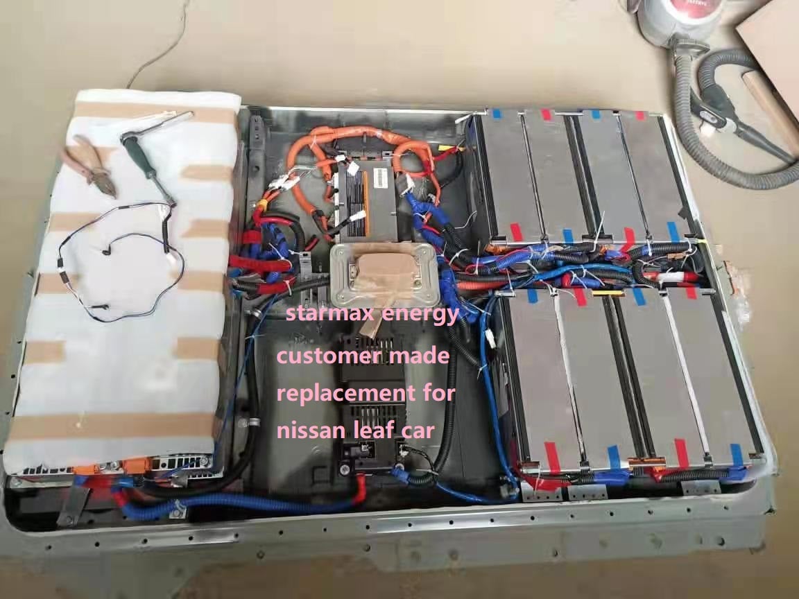

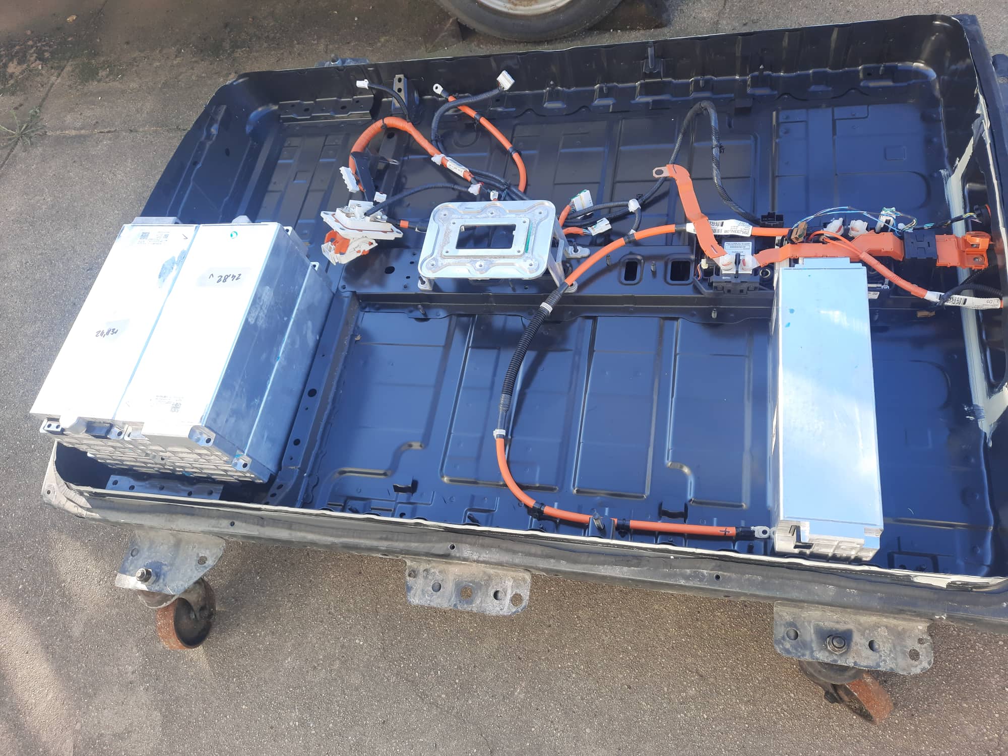

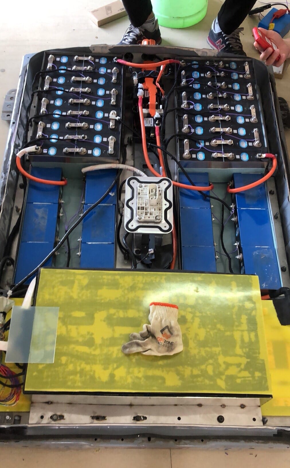

Sometimes we see pictures of upgrades made with Calb/LG 6s modules(standard +-110x151x358mm long):
I tested my taycan modules (390mm long) it's very tight but itlooks like it fits, but the smaller modules leave more space for cables.
On the Nissan LEAF Battery Upgrade fb group some people are reprogramming the oem bms for different capacity.
Who else is upgrading the battery this way and what have you experienced with the bms?
Battery upgrade same case, new modules
