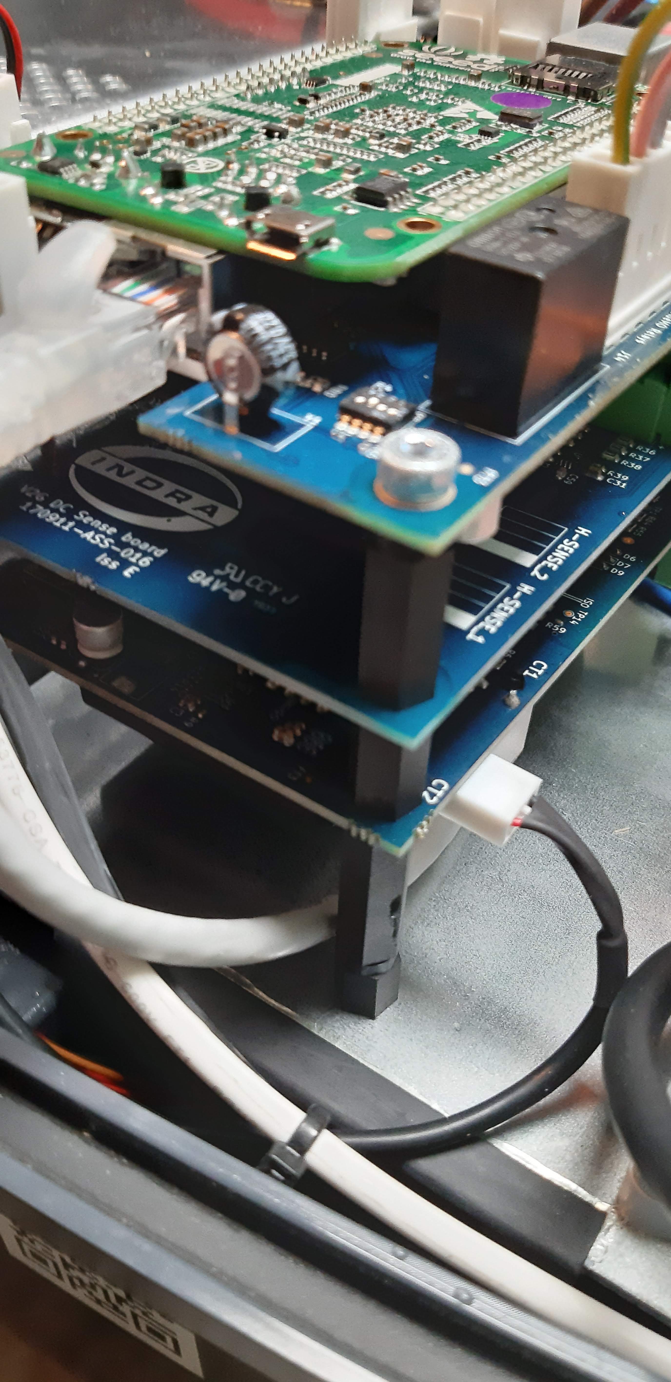

A few photos below of a commercial 6kw v2g/ h unit.
Unit was bought second hand and noticed a sloshing noise when I moved it so had an excuse to submit to my curiousity.[

Odd for a high volume commercial product to be based around a dev board,

Ev8 wrote: Mon Oct 17, 2022 4:43 pm Odd for a high volume commercial product to be based around a dev board,
Oh, to be that young again. And also a robot.
This is FAR more common than you would hope. Ironically, the more big and expensive the stuff, the less you have to bother with things like miniaturization and cost savings.

This is an early version i believe based on beagle board black, later ones indra roled out a more integrated board i think to meet new regs maybe.

:twisted: nope it's current production from what I have seen , there is a new proposed design with in house bidirectional design using sic components. But don't think they are in the wild. Every opened unit I have seen is like this.
