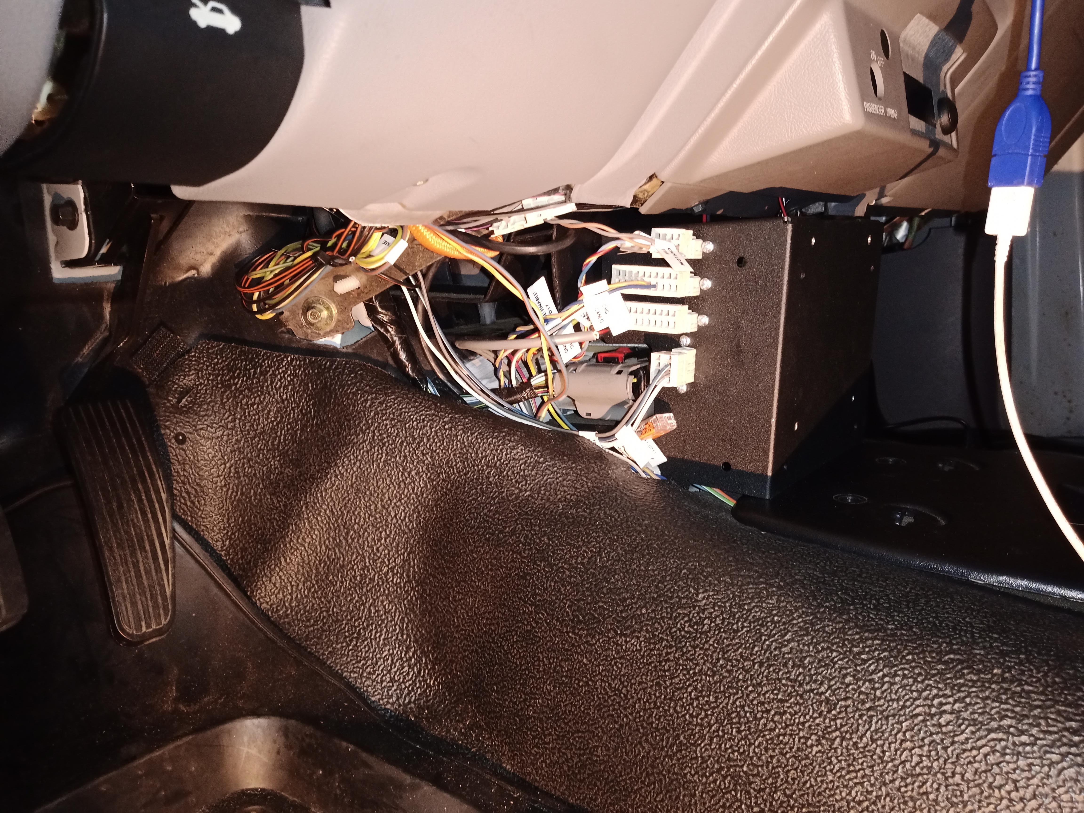

Finally I got time to install the box and cover for the main ECU (Teensy 4)
Have made a cad file, if you want to do the same.
Will only fit in the Ford Ranger, without drilling, using existing fixing holes.
Can make it and powder coat it for you, if you don't have equipment to make it.
There are room for connecting more stuff.....
Easy access to connectors, without the cover.
