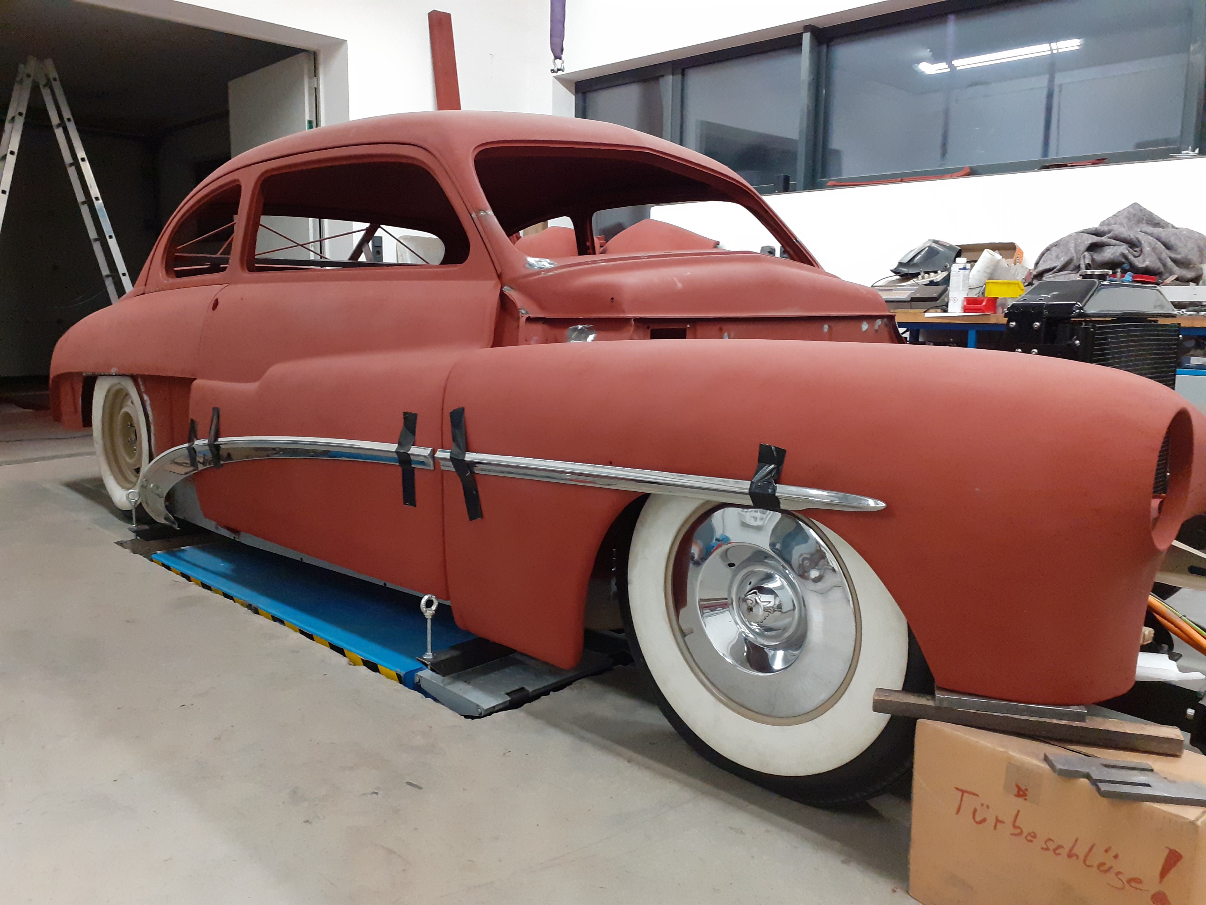

Re: 1950 Mercury Lead sled
Post by muehlpower »
At the moment I only do sheet metal work. No bits and bytes ;) . That's not so interesting here. I cut up the body and sandblasted and primed the individual pieces. Now I put everything back together. Of course with the changes on the floor for the electrical components and to go much lower. :evil:

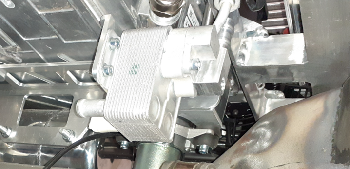

Could you please post some pictures of your high voltage junction box?
Also, which car your heat exchanger is from?

golfdubcrazy
Posts: 75
Post by golfdubcrazy »
alexbeatle wrote: Sun Oct 30, 2022 12:34 am Also, which car your heat exchanger is from?
I believe this is a heat exchange from a golf GTE / A3 Etron. if you order one make sure you have the high pressure side pipe as it has a restrictor installed inside as the heat exchange does not have a TXV on it.

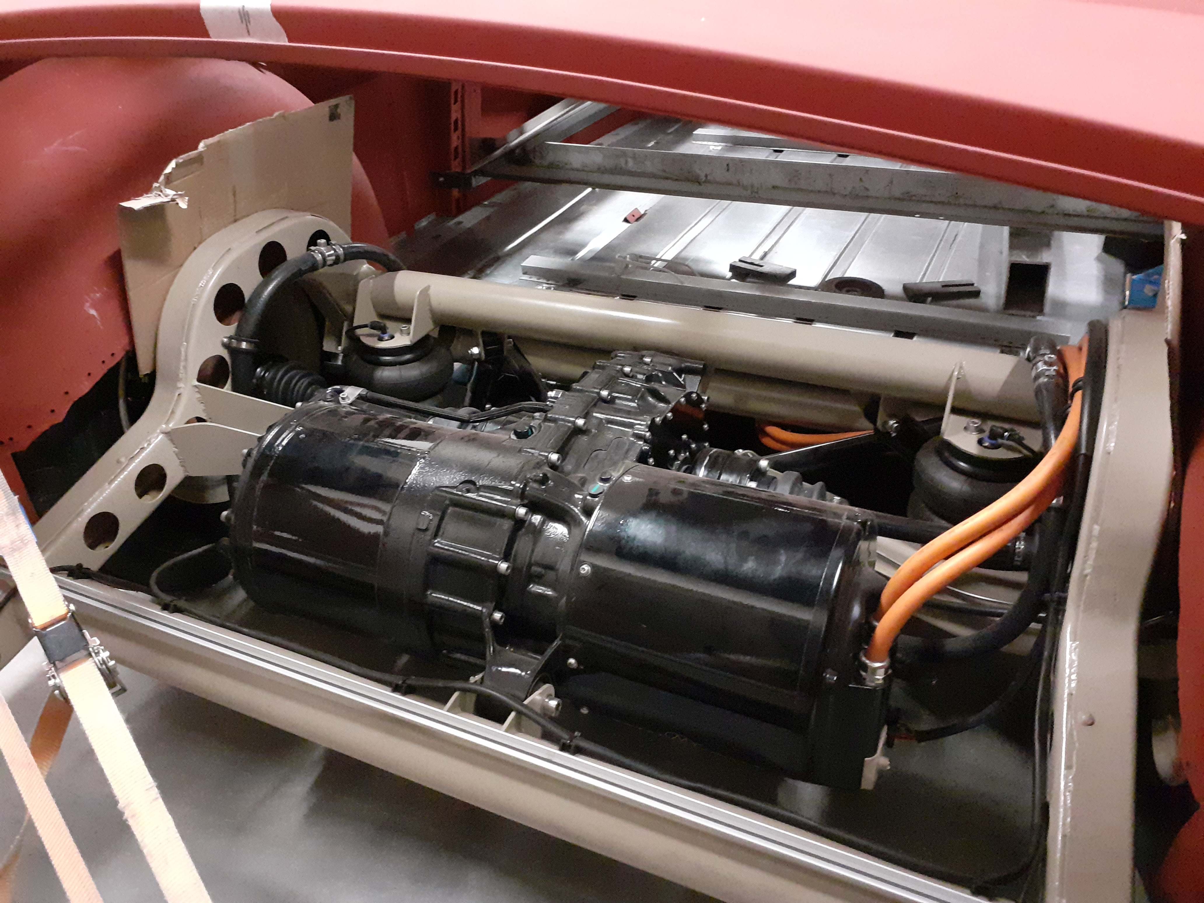

golfdubcrazy wrote: Tue Nov 01, 2022 10:29 am I believe this is a heat exchange from a golf GTE / A3 Etron. if you order one make sure you have the high pressure side pipe as it has a restrictor installed inside as the heat exchange does not have a TXV on it.
that's right. I installed the entire system from the Golf GTE Hybrid. It consists of chiller, A/C compressor, evaporator, condenser, pressure sensor and 2 solenoid valves. The pipes are custom made, of course with the restrictor!
I don't use an extra HV junction box. The main contactors, main fuse, pre-charge relay and resistor, current sensor and BMS are housed in the battery box. DC charging contactors and the required voltage measurement for the LIM are in the AC charger. Further fuses for cabin heater, battery heater, A/C compressor and DC-DC converter are in one housing, as in the first Model S (front junction box). I mounted all components in a new rectangular case

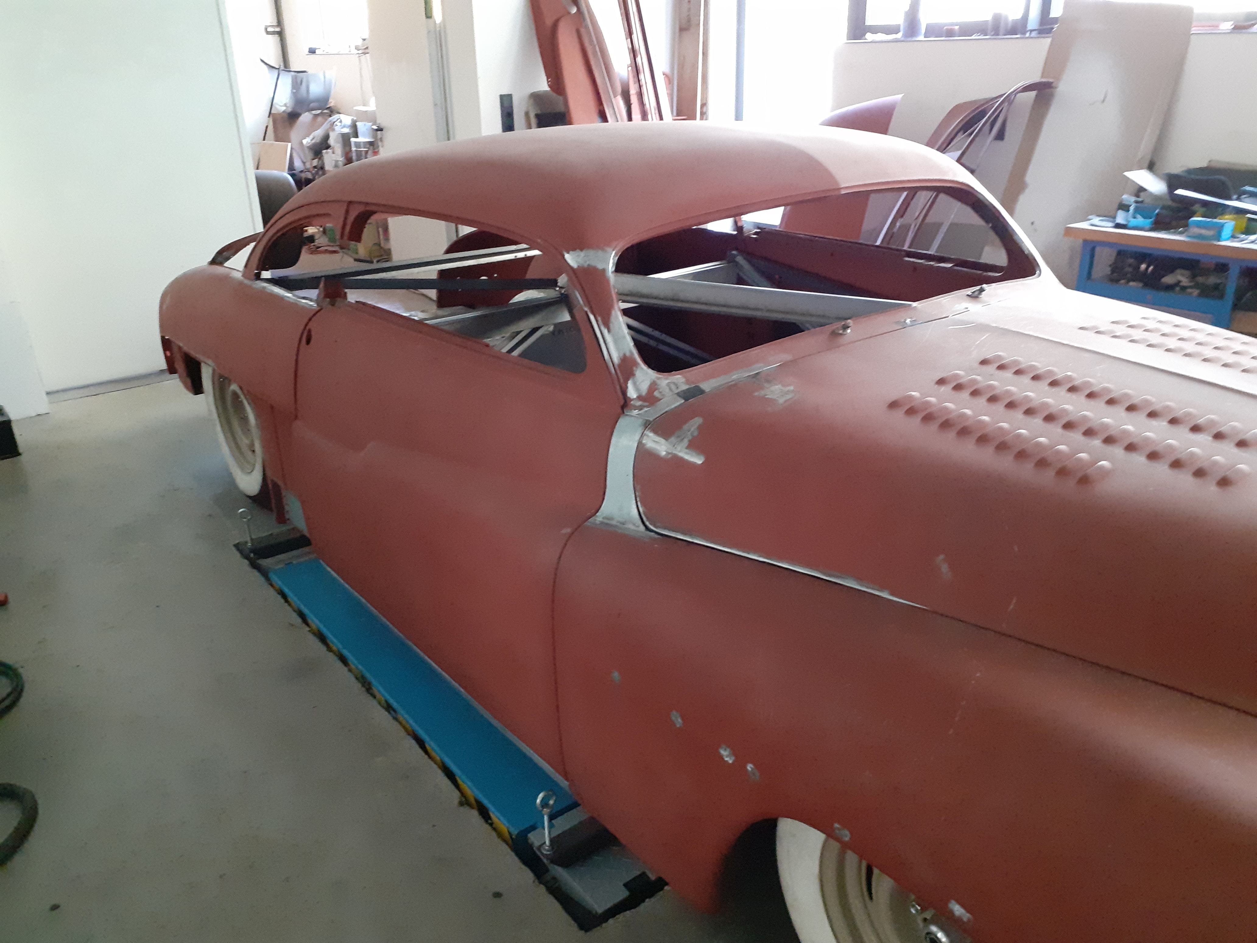

muehlpower
Posts: 570
Has thanked: 12 times
Been thanked: 96 times
Re: [WIP] 1950 Mercury Lead sled
Not that anyone thinks this project is sleeping. I only have a lot of sheet metal work and little electrics. The sheet metal is pretty wide at the front. At the moment I'm working on the top chop. Will also need a few months of sheet metal work until it comes to the finish (paint).
