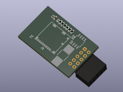

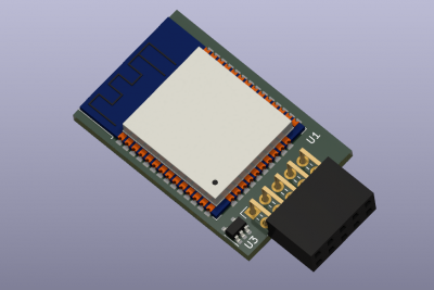

Been having a think about this too, just for fun I threw a few components onto a PCB to see what might be possible:
That's a PCB of around 0.8" by 1.3" (plus the IDC connector) with a ESP32-WROOM-32D on one side and a micro SD socket and a real time clock on the back. All looks possible, still a fair bit of work to turn it into something real though.
