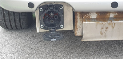

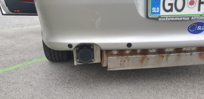

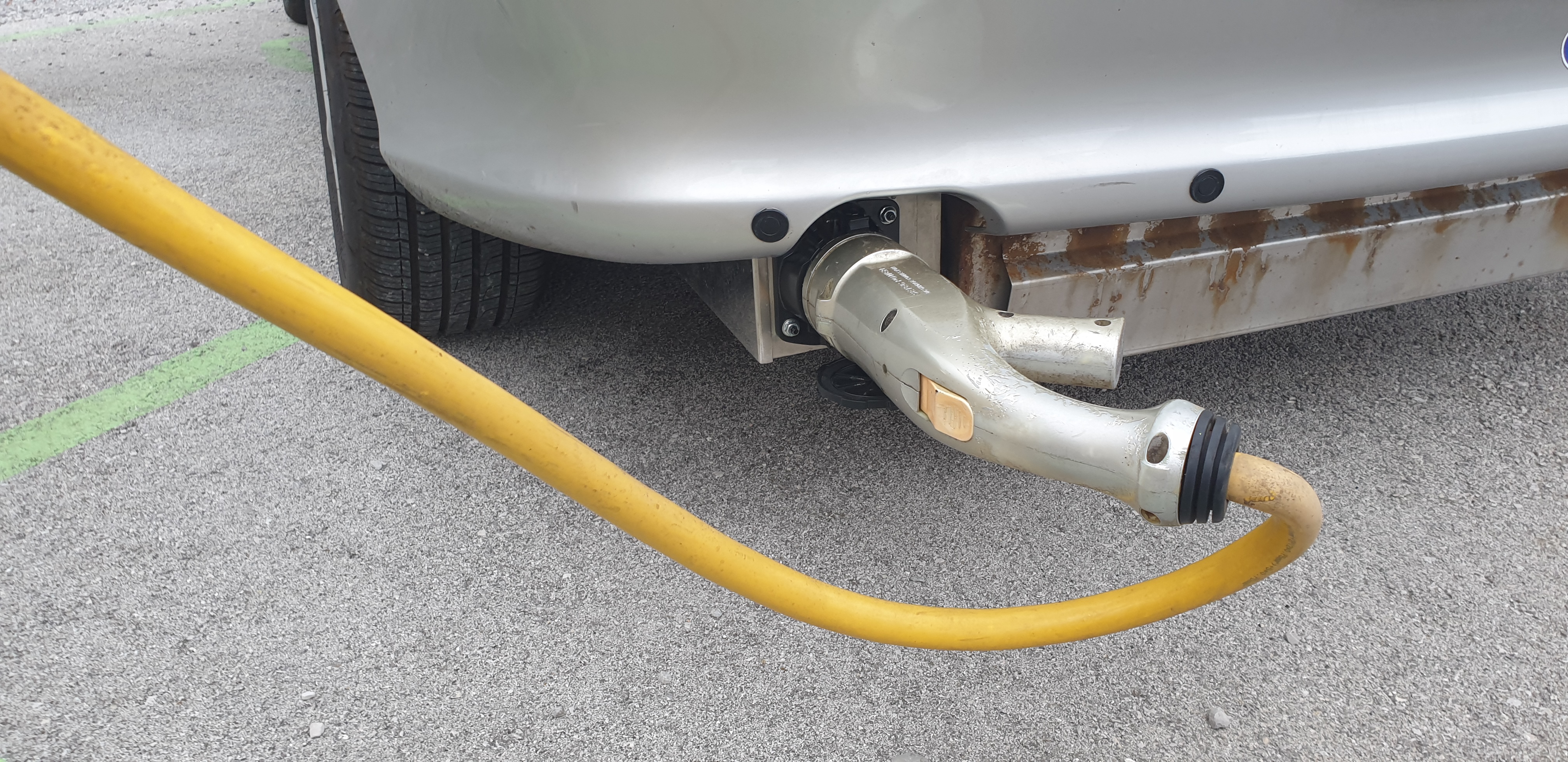

Finally the fruits of my labour...
I mounted the box to the place of exhaust. Self sustained no power from the car required. Apart from solid GND. I intend to test this a bit. In the end i will probably add CAN line to BMS for protection.
I intend to simply use a heartbeat telegram similar to Outlanders 0x285 to keep chademo operating. If that would be missing VCU would stop.
Edit: that rust does not belong there . I guess there is no inox welding wire. I have to sort it out before winter.

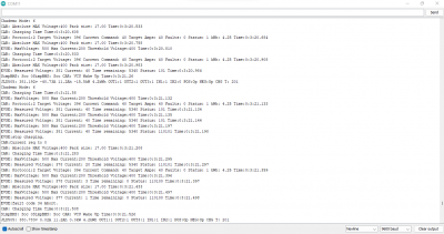

Hey Guys, I've set up a due with bigpies shield in the wiki. Testing on a nearby charger it stops charging after almost exactly 2mins every time I test it. Its a Tritium PK350 "ultra rapid charger". Has anyone else had a similar issue? I'm Planning on testing on the next closest station tomorrow, unfortunately its 40km away .
Attached is a screenshot of when it stopped.

Which version did you use? V1 had a few mistakes that needed correction:D
If V1, R4 needs to be a solder bridge, R7 needs removing. IN2 needs a 1k pull up to 3.3v adding too. I've also changed IN2 to use pin 5 vs pin 6 as I've blown pin 6 on my due.

Using V2 The charger stops at exactly 2mins everytime, I'm thinking a compatibility issue. I'll get a CAN log over the next few days.
One thing I found on the V2 board is the 3v3 wasn't connected to the can transceivers, The traces are there but a through hole is missing to join them. Great job on the board though, it's a neat little solution.

While i was charging at 100A my battery filled up fast and voltage raised to VMAX value of 390Vdc.
There Chademo stopped charging and shut down.
Immediately voltage droped and i was left with some 76% at 378Vdc.
This just wont do! I want to be able to have some current tapering at least at the last 10% of charge.
So i went to study the code and inside chademo.cpp file i found the routine to transmitt askingAmps parameter within CAN telegram.
Then i inserted a conditional to observe voltage and reduce askingamps when voltage would get above preset value.
I set minimal amps to 20A for testing.
I had some problems with parameter declarations and i decided to keep the old parameters and condition them by some parts.
I will let you know how testing goes tomorrow...
if (Voltage > (settings.targetChargeVoltage - 2)) {
askingAmps == settings.minChargeAmperage;
- Posts: 3265
- Has thanked: 80 times
- Been thanked: 233 times
Crap! I couldnt get any reduction at EVSE with previous code.
I will try with direct values.
@isaac96 could you elaborate how could we taper down charging by reducing amps in mid charge?
tnx
tnx
- Posts: 656
We use the targetCurrent variable to reduce charge current.
The change then propagates to sendCANStatus() where askingAmps is decreased if greater than targetCurrent. askingAmps is the real request going to the EVSE.
VMAX is a protection setting, so if voltage hits that level the charge will shut down. Use V=(desired setting) to configure your desired charge voltage.
It's been some time since I played with this code. Last time I had Chademo working I ran into issues with overheating EVSEs (it was 100F out) ramping current down and the software didn't like it, I made changes to fix that but haven't gotten those into the published version.
if (Count == 20)
if (evse_status.presentVoltage > settings.targetChargeVoltage - 1) //All initializations complete and we're running.We've reached charging target
//settings.ampHours=0; // Amp hours count up as used
//settings.kiloWattHours=settings.packSizeKWH; // Kilowatt Hours count down as used.
if (settings.minChargeAmperage == 0 || carStatus.targetCurrent < settings.minChargeAmperage) {
//putt SOC, ampHours and kiloWattHours reset in here once we actually reach the termination point.
settings.ampHours = 0; // Amp hours count up as used
settings.kiloWattHours = settings.packSizeKWH; // Kilowatt Hours count down as used.
chademoState = CEASE_CURRENT; //Terminate charging
} else
carStatus.targetCurrent--; //Taper. Actual decrease occurs in sendChademoStatus
else //Only adjust upward if we have previous adjusted downward and do not exceed max amps
if (carStatus.targetCurrent < settings.maxChargeAmperage) carStatus.targetCurrent++;
- CCSknowitall
- Posts: 105
- Been thanked: 28 times
Highly recommend implementing this as a number of CHAdeMO stations will adjust their max amps due to temp or available power modules. Most notably the Tritium Veefil 50kW units.
- Posts: 3265
HM... so it would be desirable that settings.maxChargeVoltage would be set lower than settings.targetChargeVoltage?Isaac96 wrote: ↑Wed Sep 28, 2022 10:22 pm VMAX is a protection setting, so if voltage hits that level the charge will shut down. Use V=(desired setting) to configure your desired charge voltage.
I guess i attributed a lot more importance to settings.maxChargeVoltage when it just seems to be a limit when tapering occurs.
Can you confirm this logic for me?
So if i set settings.maxChargeVoltage = 390V and settings.targetChargeVoltage = 392V askingAmps would be reduced down to minChargeAmperage by holding maxChargeVoltage steady. Then charging process would stop. Thus i could charge up to 390V and current would taper down to 10A if i would set minChargeAmperage so?
If it works like this then i just need to correct my settings . Maybe i will set a comment in wiki too.
tnx
- Posts: 656
Other way around. settings.targetChargeVoltage is the CV limit, settings.maxChargeVoltage is the 'safety valve'.arber333 wrote: ↑Thu Sep 29, 2022 6:57 am HM... so it would be desirable that settings.maxChargeVoltage would be set lower than settings.targetChargeVoltage?
tnx
- Posts: 3265
Hm... no i tries that already and it just stoped charging. No tapering of current... this is why i wanted to setup tapering.
Do you think i should setup greater difference? As in 390V for charge and 394V for max?
