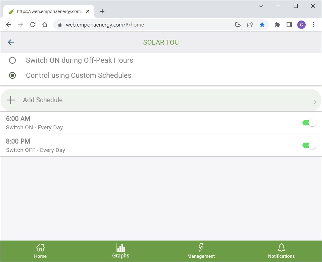

those concerned with back feeding after hours, (back feeding the way I understand it means, the Inverter actually sucks electricity from the wall instead of pushing it in, if it happens it's a small amount usually to have it's LED stay on or something like that, and no I am not saying this inverter does that, I am just trying to get ahead of this myth) can actually set a schedule and have the Smart Plug disconnect the Inverter from the grid at a set schedule, for example
8:00 PM = Turn Off
6:00 AM = Turn On
8:00 PM = Turn Off
6:00 AM = Turn On

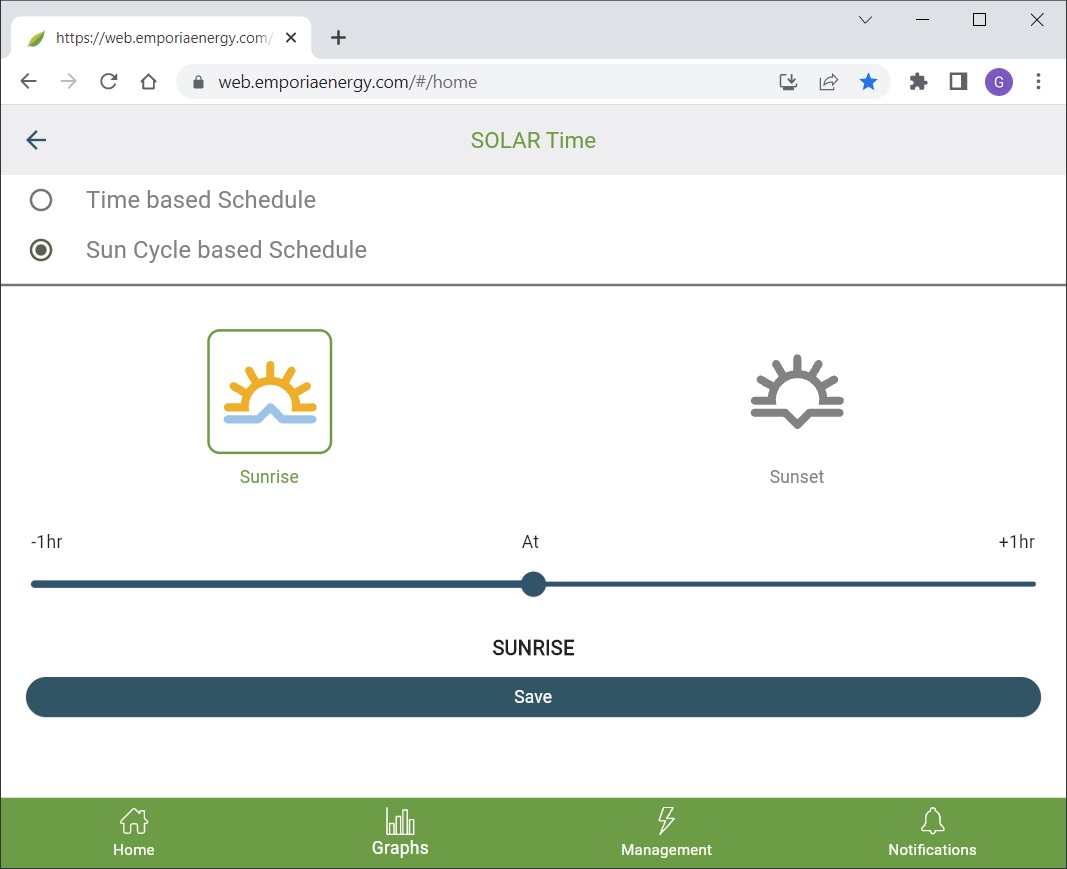

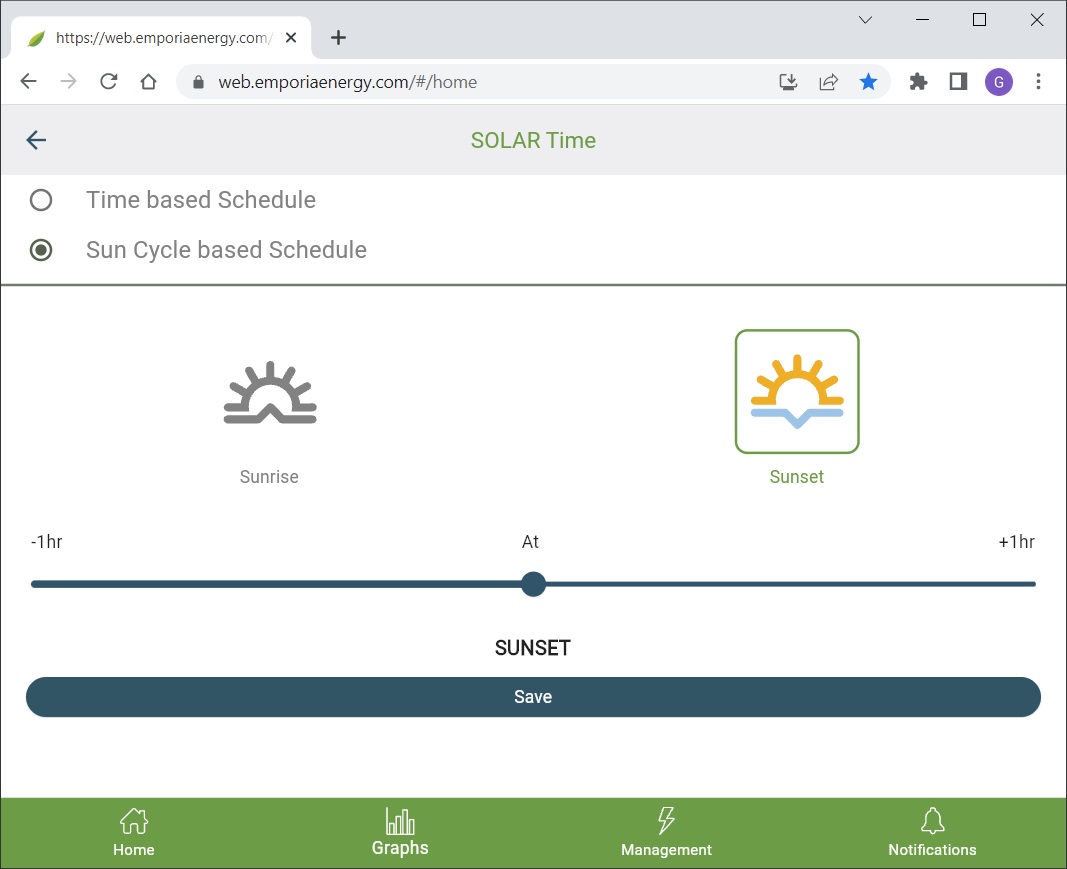

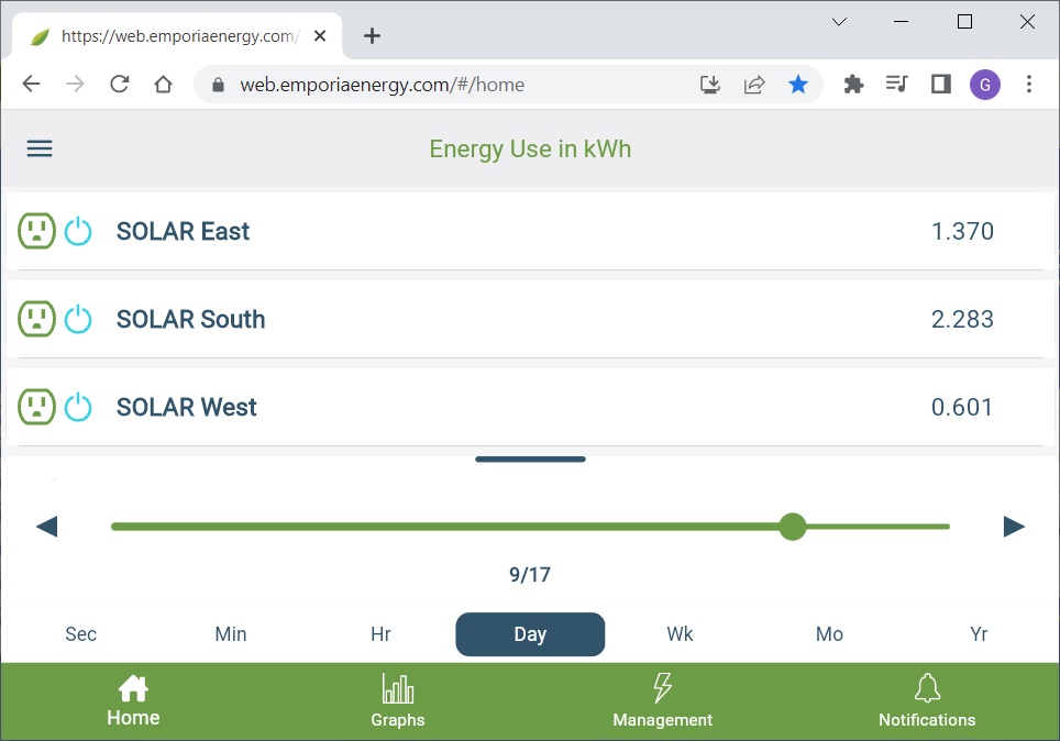

Re: The Greg's Grid Tie Solar Project

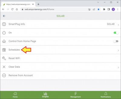

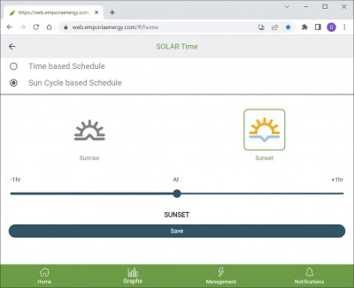

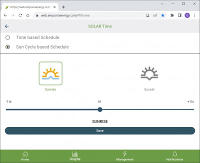

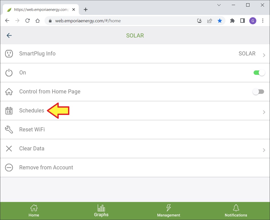

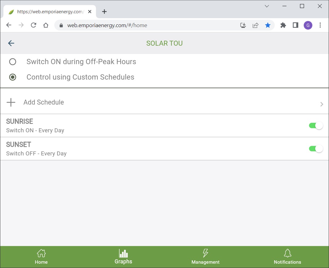

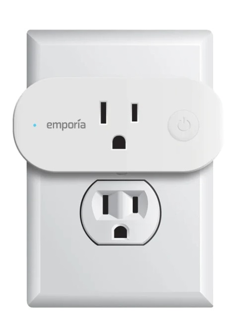

this next option blew my mind, the Emporia smart plug is not only integrated with my electrical company ie SMUD but it also knows my geographical location and therefor can operate based on ... [wait for it] the Sun Cycle
so we can once again power on the Inverter but this time based on Sunrise (and + or - 1 hour either way for compensation)
and turn it off based on the Sunset (and + or - 1 hour either way for compensation)

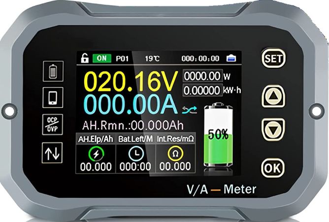

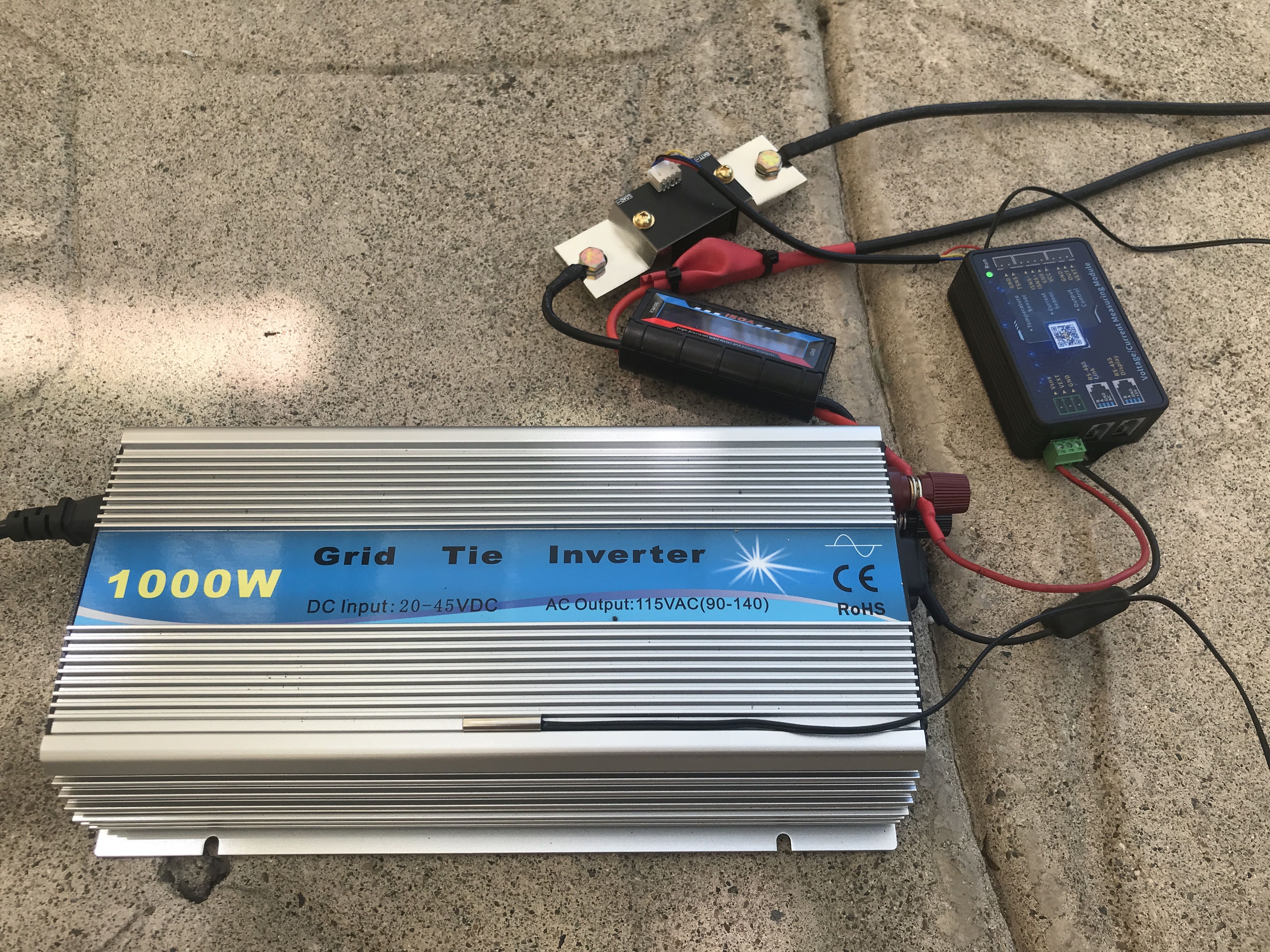

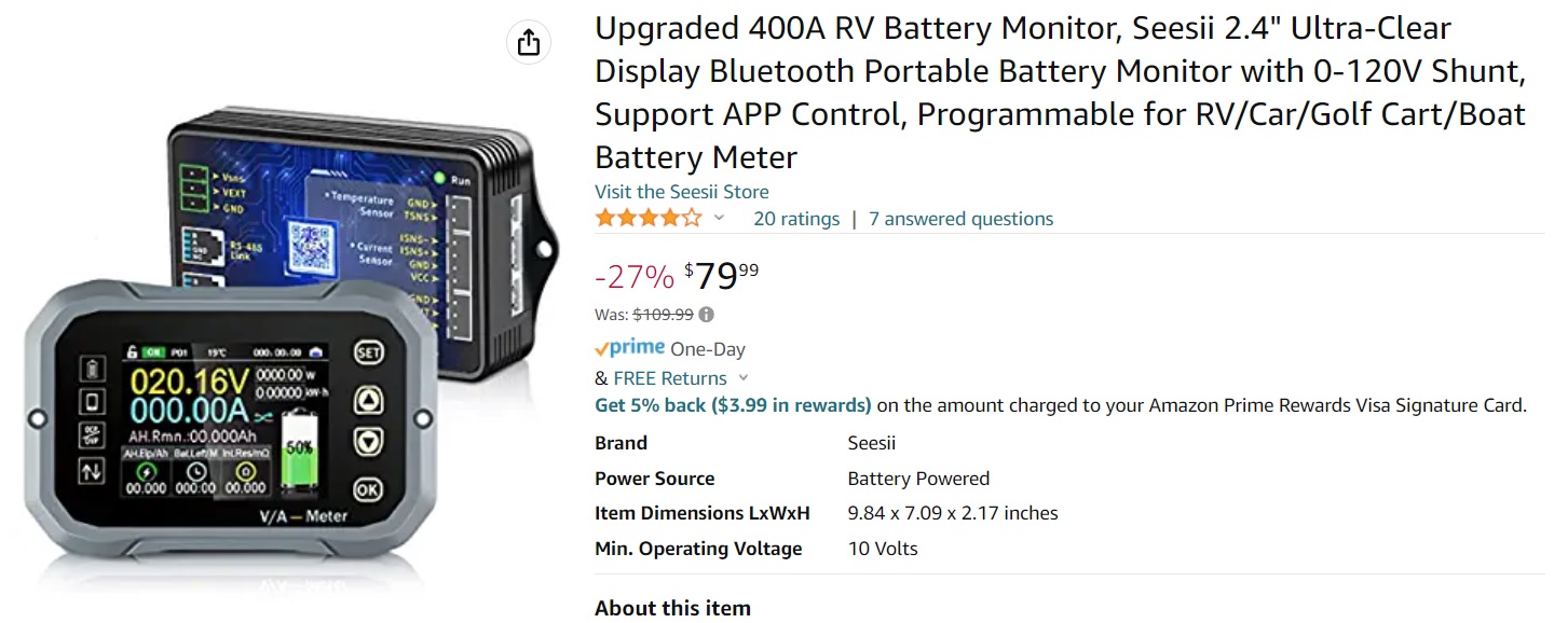

thought I share how I mange the DC input side, which appears to be a pricier solution than the AC side
I'm pretty sure it's a knock off of the Victron Energy SmartShunt 500 amp Battery Monitor (Bluetooth) which costs $130, so when I saw this one for $60 bucks I snagged it, and as soon as I did the price is now $80
for me the selling point was don't have to get off your butt to check the DC side input feature as it has Bluetooth, and some data logging, I would prefer the WiFi capability of the Victron with proper logging but I could not bring myself to spend more on a DC Monitor than the Inverter (so I will probably get both eventually, lol)

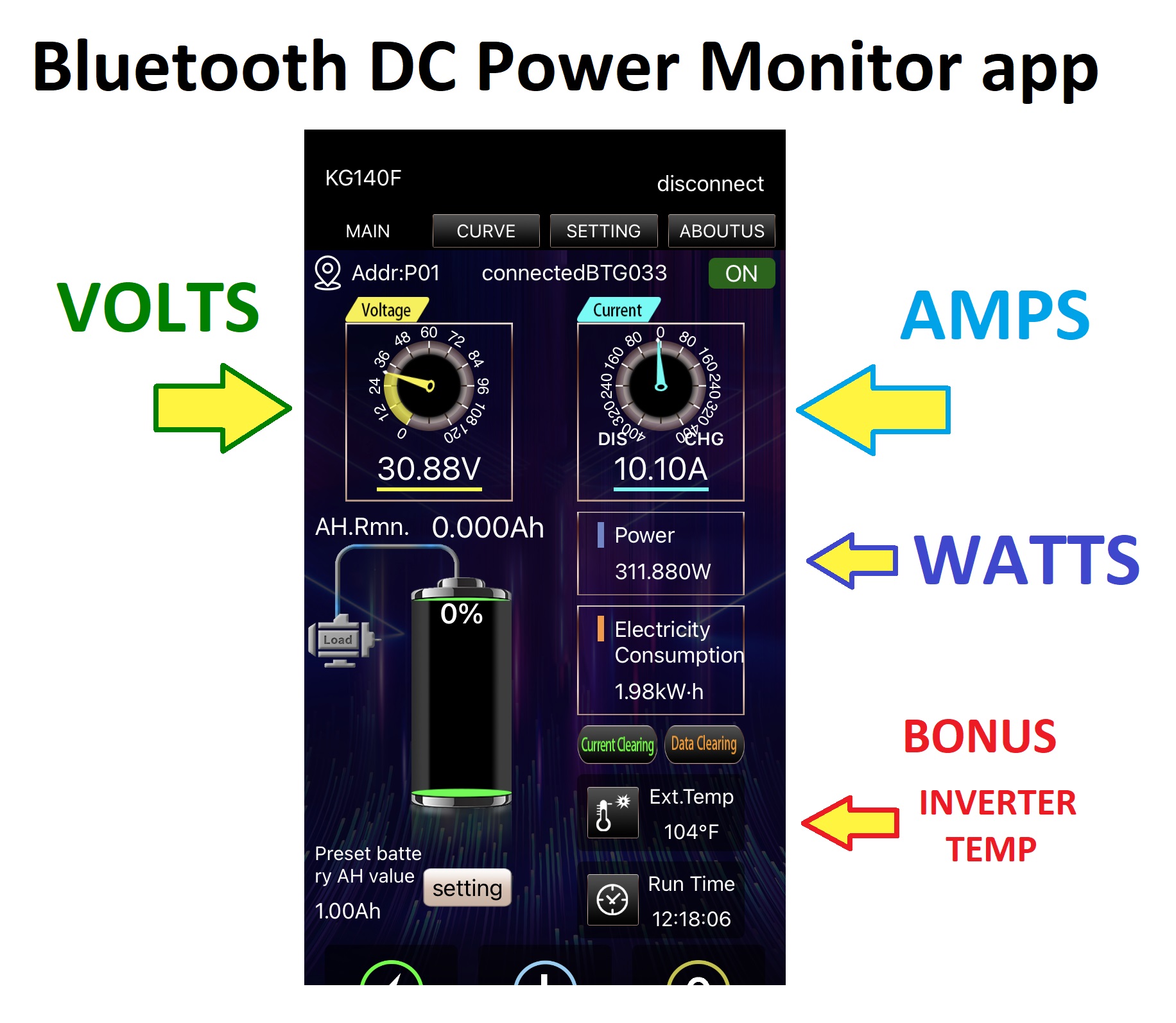

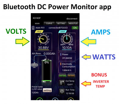

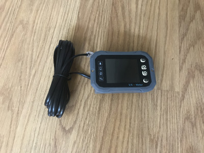

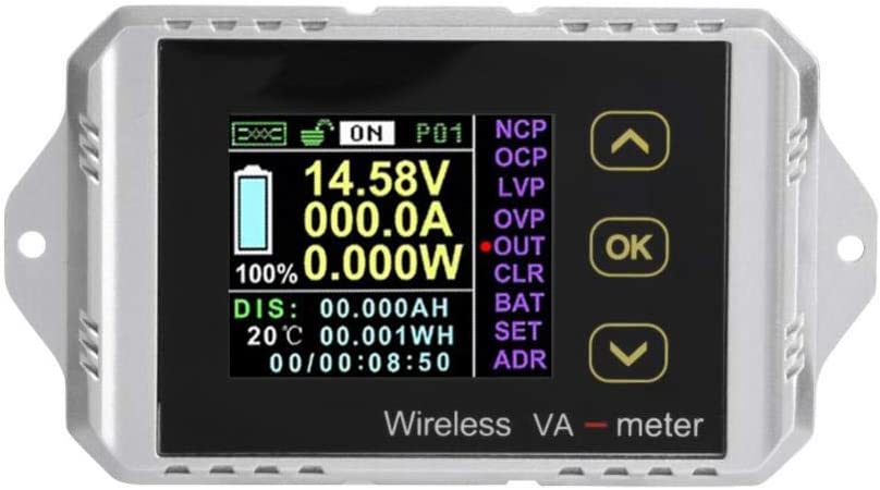

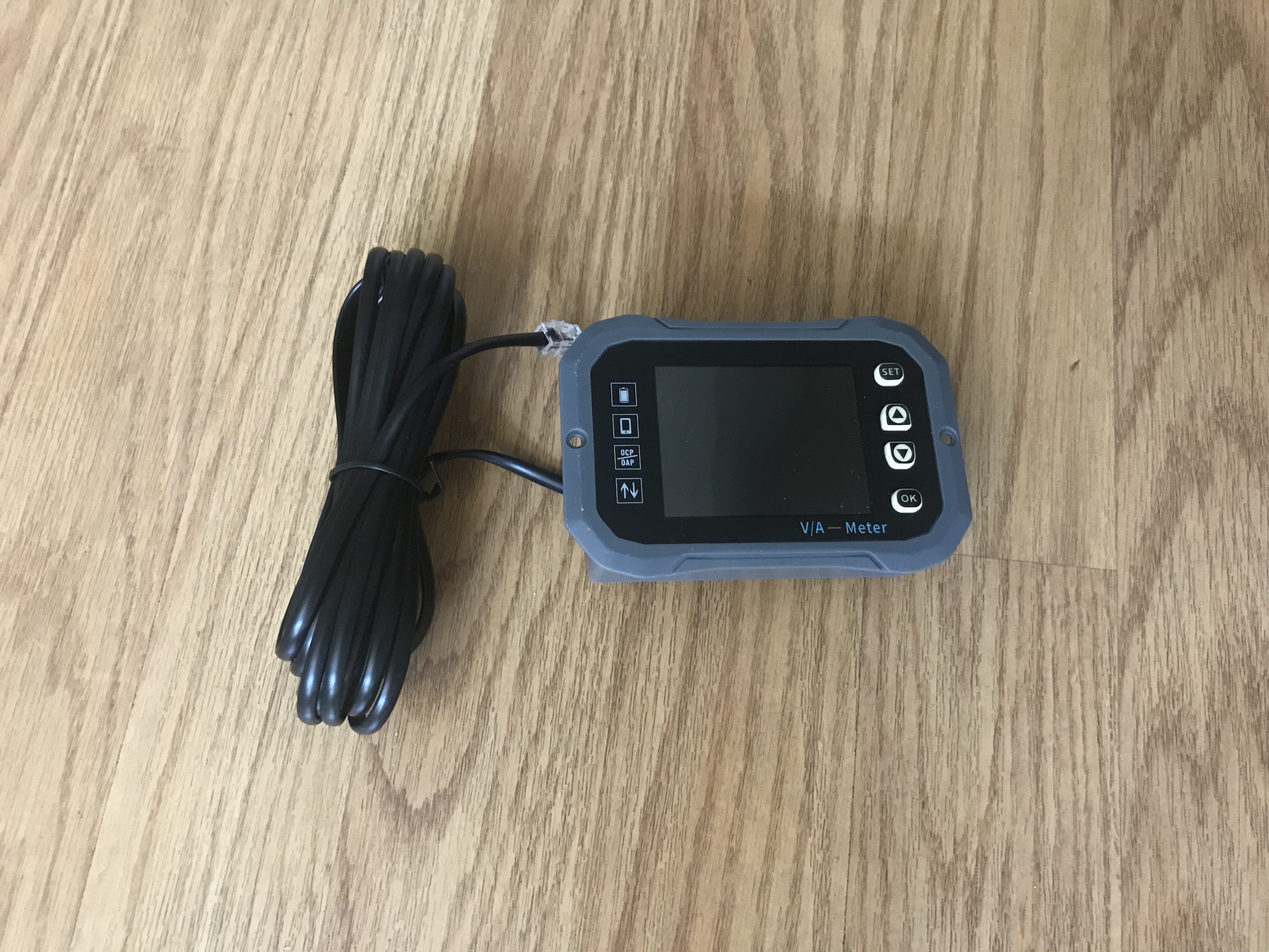

for me this screen is a bit too cluttered and I would be more than happy with their old much simpler display (shown directly below), however it does not have Bluetooth nor Wifi
here is that Junctek app running on my phone, showing actual data in real time, note the bonus temp feature, it comes with a little metal probe which I affixed to the top on my inverter, this allows me to monitor the inverter temp remotely
yes I am currently deploying the belt and suspenders approach by running both the dinky 150A $15 DC meter and the less dinky 400A $60 dollar one with Bluetooth, hey I'm having fun and I haven't burned the concrete patio down yet
Note I'm not even using the hard wired digital display monitor, which I think they could save themselves a few bucks and offer it as an optional add on, and not part of the base kit (shunt & brain module)
OLD DISPLAY DESIGN (No Bluetooth though) | NEW DISPLAY DESIGN (with Bluetooth) |

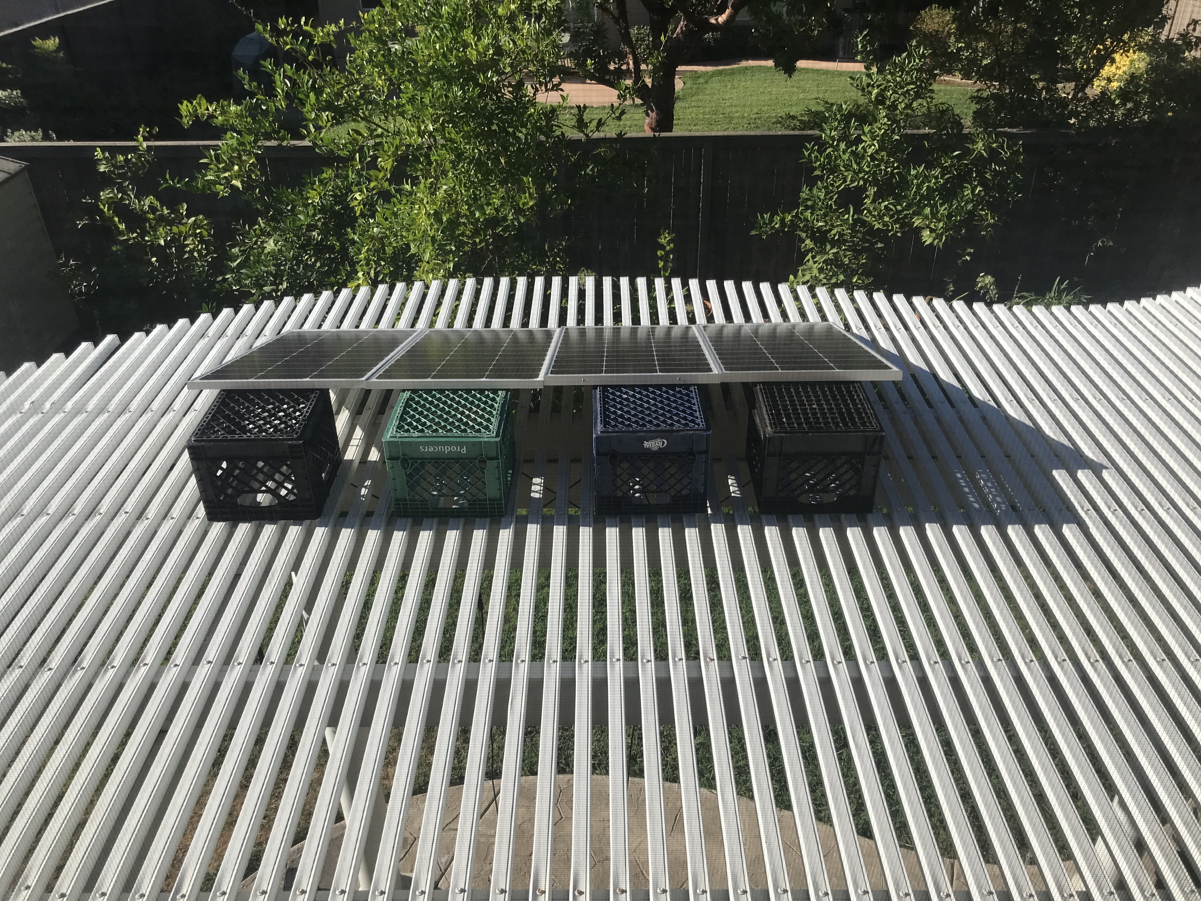

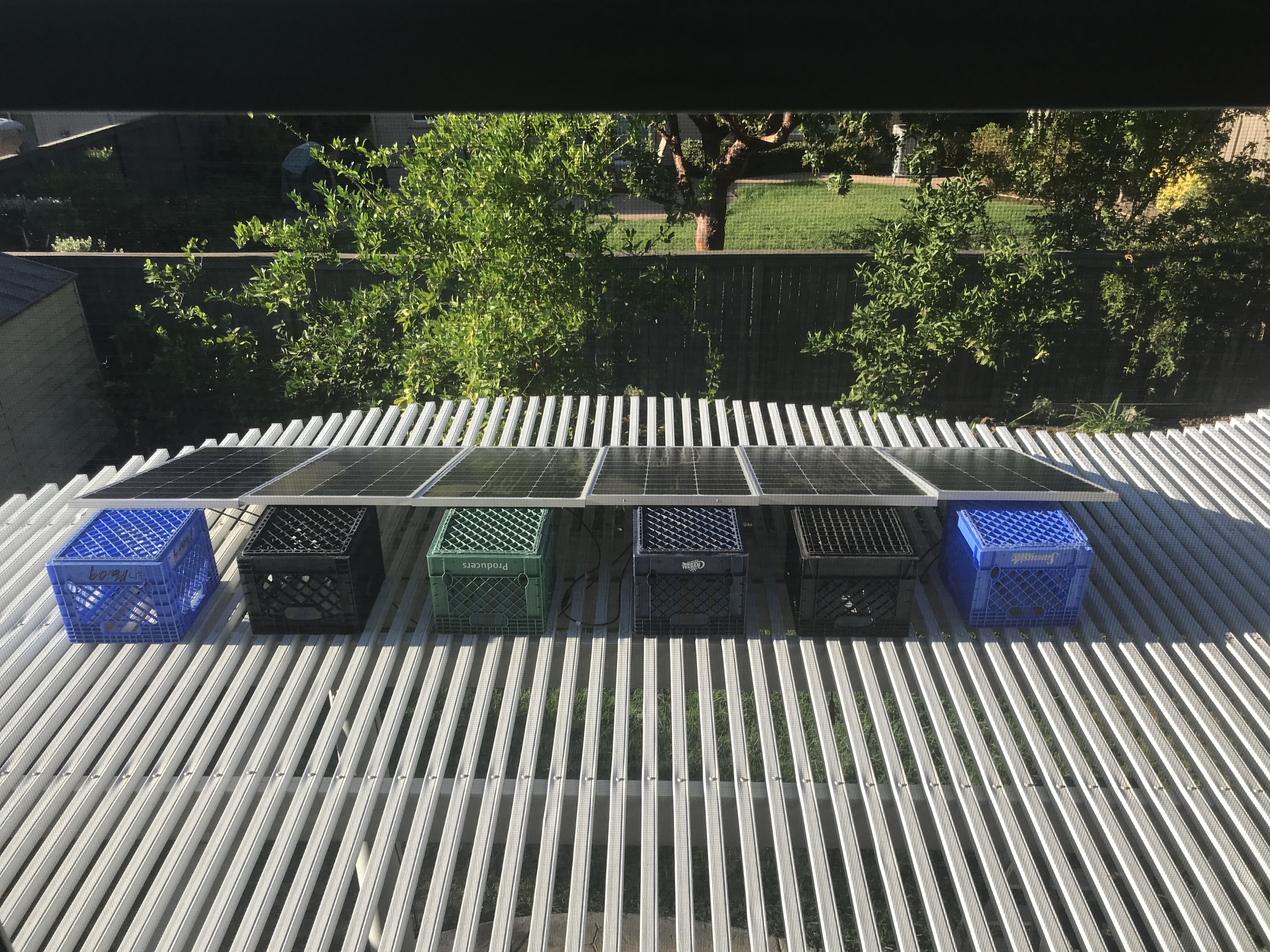

shown here is the perfect(ish) flat summer angle 20° or close to that panels facing South (mind you in the northern globalsphere)
as seen below this is just under $600 bucks (and growing, I really want to max out this little chep-O inverter) in it's current setup it produces 3 kWh per day (summers of 2022)
below we have eight 100w panels for a total of 800 watts at the minute, total cost around $800 bones so far

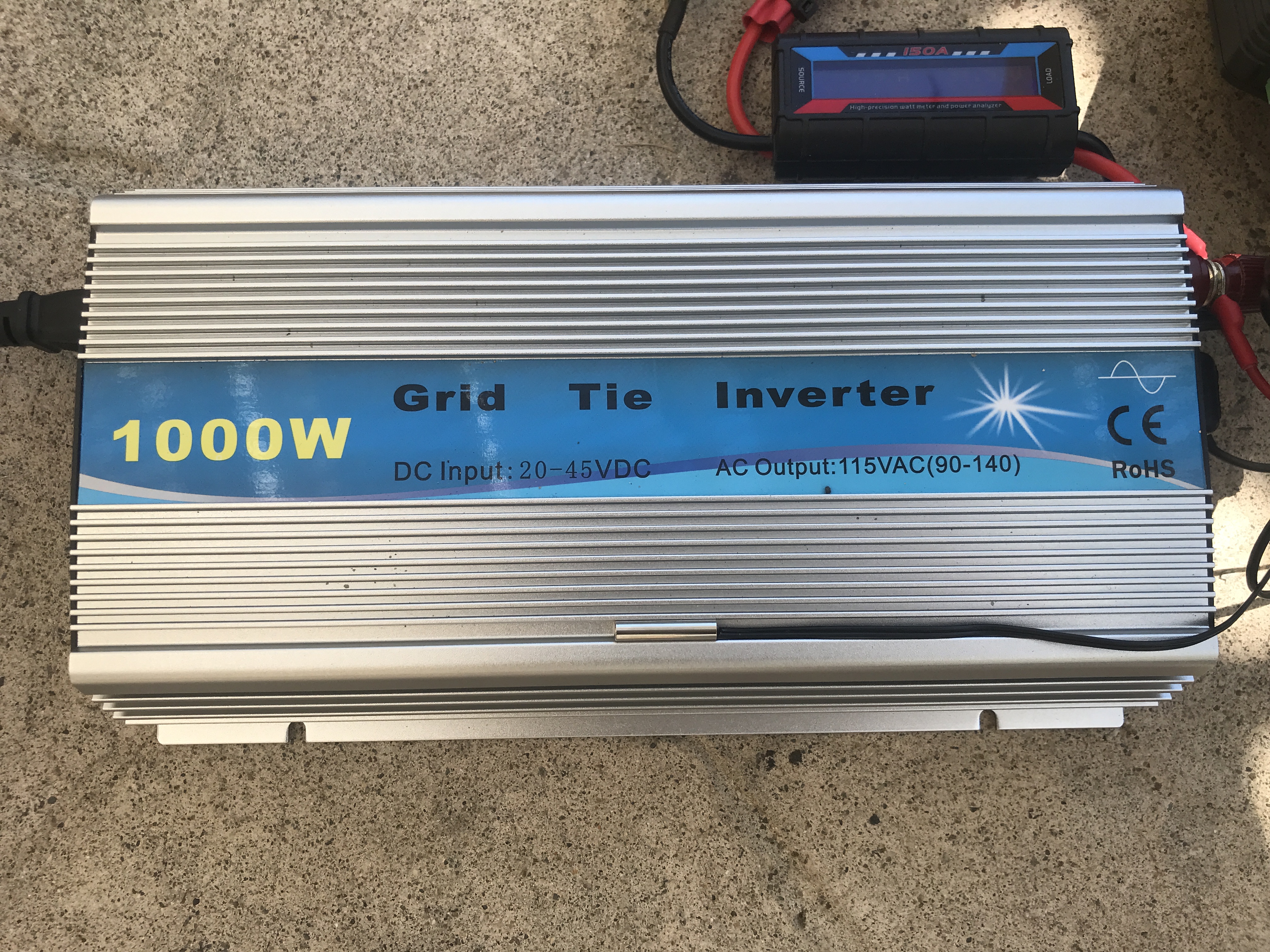

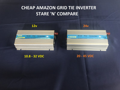

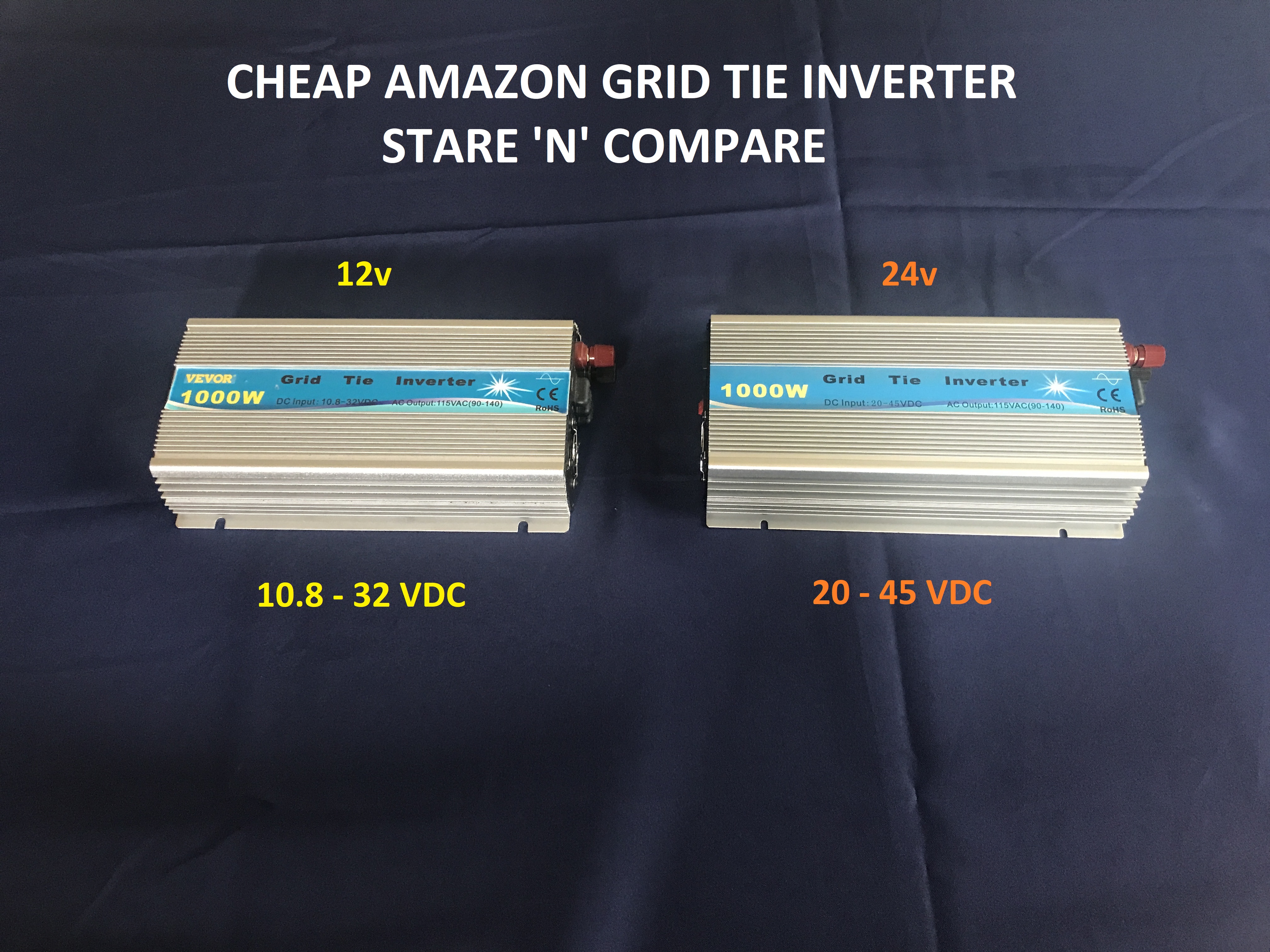

I shared a great deal on the cheap inverter when I saw one and now I want to do the same for a solar panel, again I am not associated with this Southern California company called Newpowa in any way, however these prices are the best I have seen in the last 2 years.
Also I realize the Polycrystaline (blueish) solar panels are the older technology, but I have four of them and they sometimes out perform my Monos sucking the sun out of the sky at up to 80% efficiency and for $72 bucks they are a steal plus free shipping directly from this company.
Note I believe 90% of all cheap 100w or 200w solar panels that we can get on AMAZON are made by the exact same factory and then shipped off to a bunch of resellers and rebranded, you know the deal.

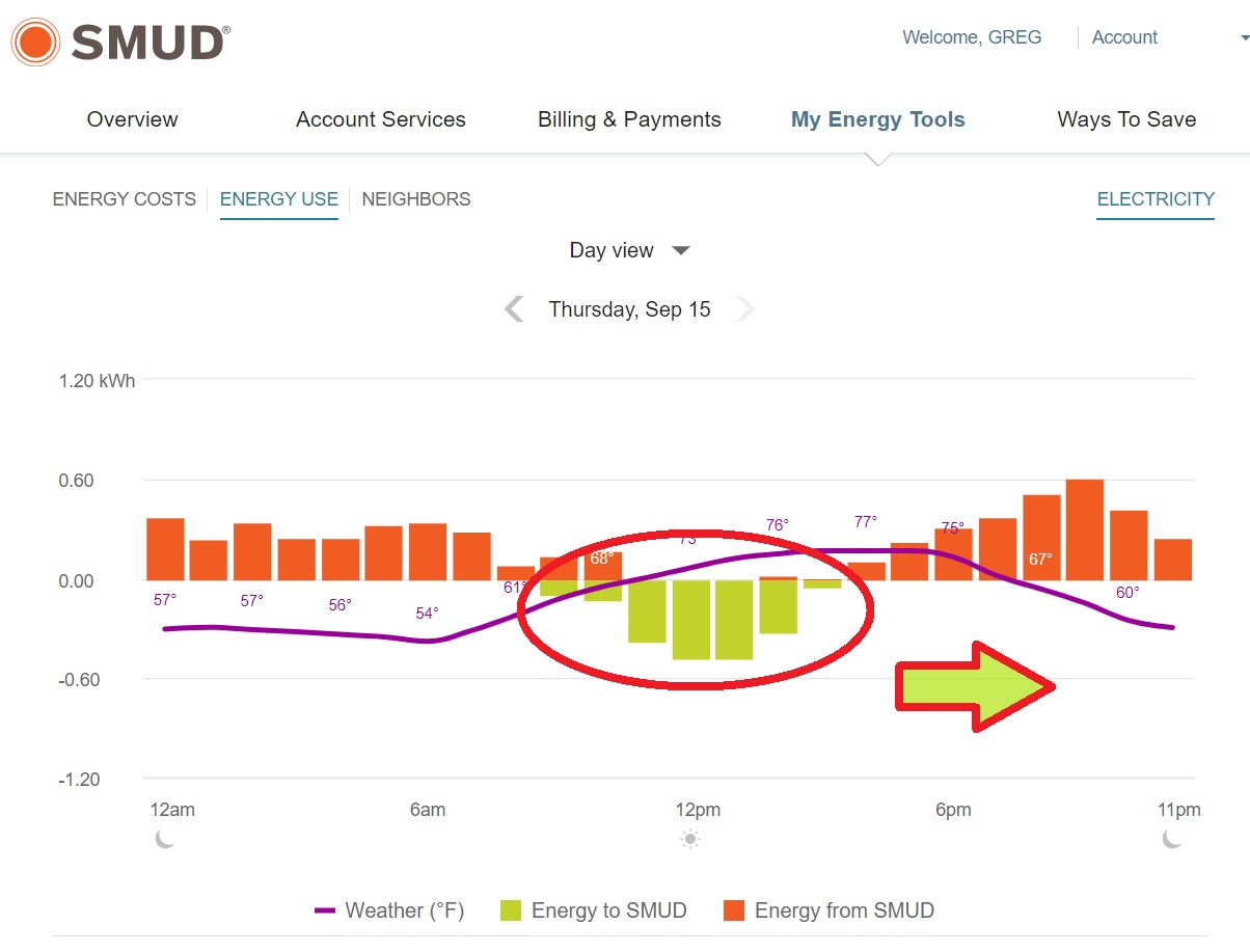

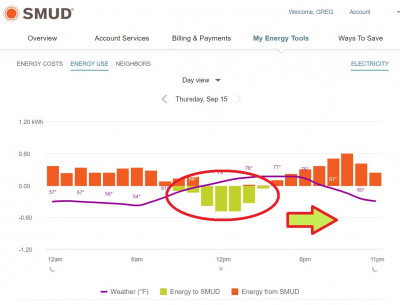

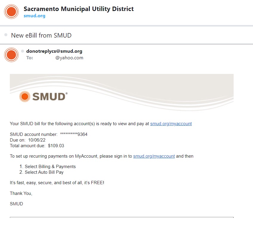

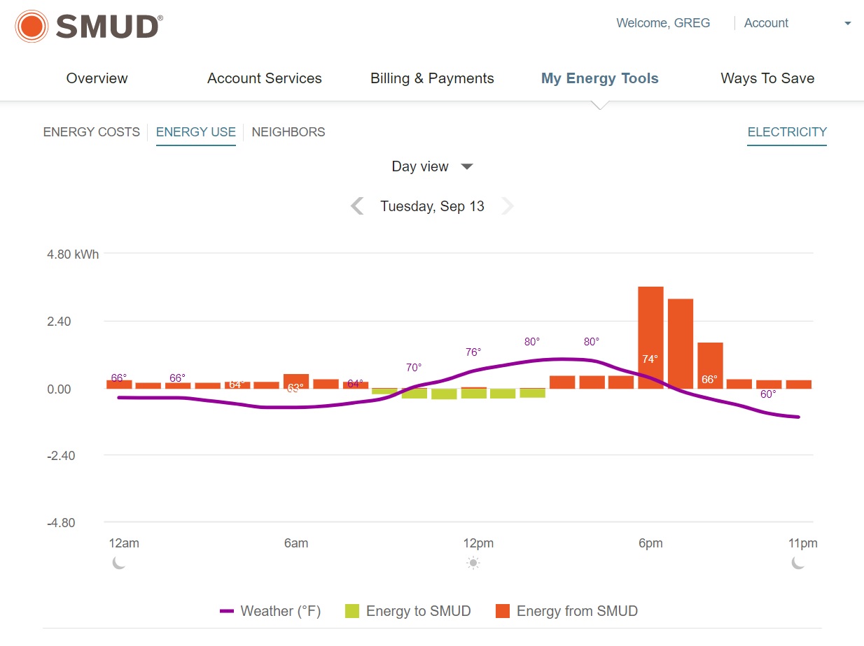

holy cow that's a first
SMUD = Sacramento Municipal Utility District aka my electric company
the green stuff represents my little $1k system sending energy back to the grid
I also just noticed my monthly electrical bill went down from $158 per month down to $109
I know that sounds too good to be true so here is an update in the spirit of full disclosure
1. We became empty nesters, for those of you not familiar with the term it means we are of age where our kids no longer live with us, more specifically both knuckleheads are in college at this time, so not quite living on their own full time yet, but at universities
2. Since we went down from a family of 4 down to a family of 2 we also powered off the extra refrigerator in the garage (a common thing to do here in the Independent States of America in an effort to support the big box stores and keep the tradition of freezer burn alive)

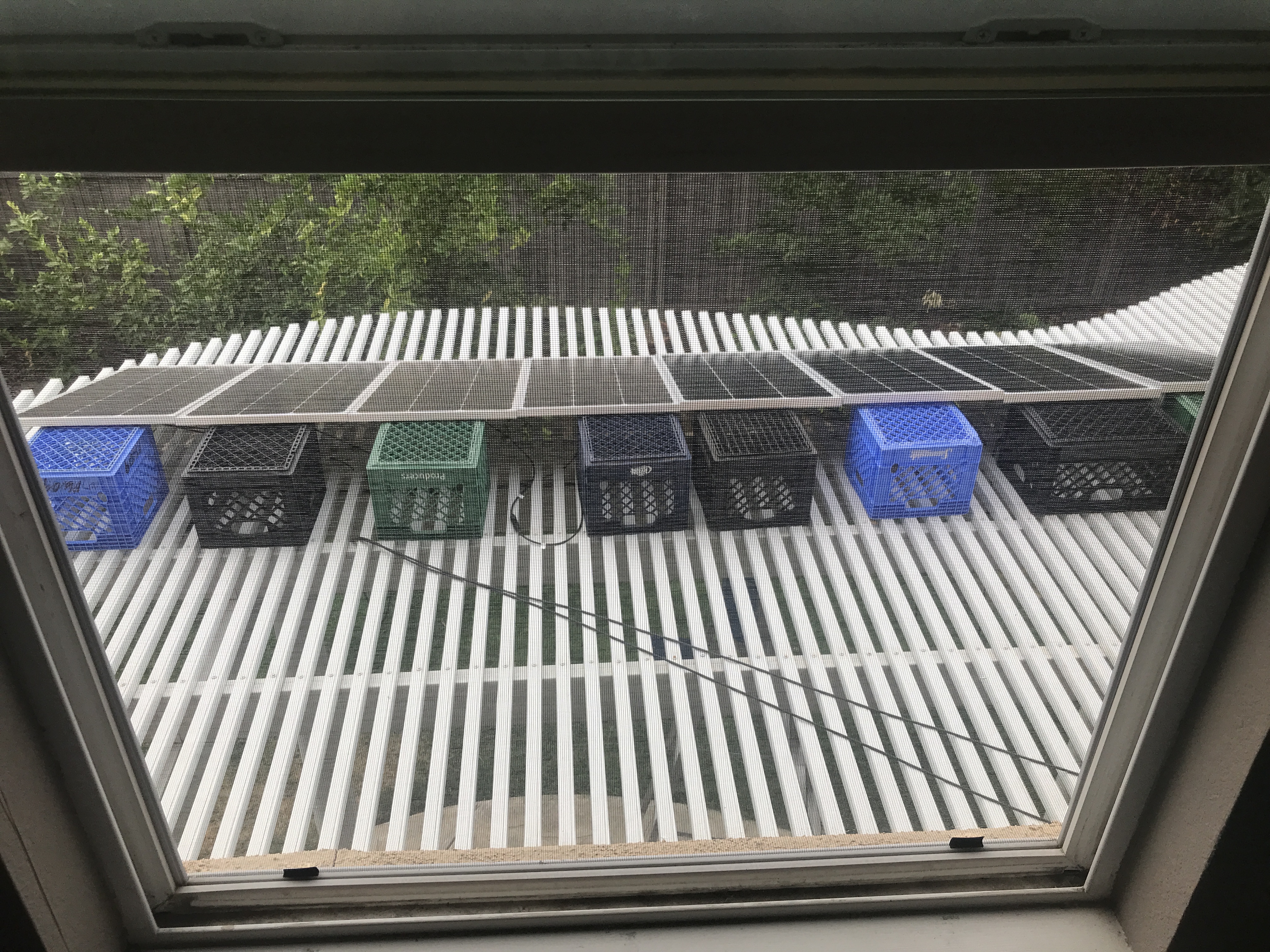

on this episode of First World Problems (FWPs) we talk about what can The Greg do to not overproduce energy between the hours of 11:00 am and 3:00 pm sending it back to the grid, but selfishly keep it for himself.
- Option 1. Simply rotate the current South facing solar panel array and point it more South West. Unfortunately that is not a viable option for The Greg since there is a friggen big tree in the way!
- Option 2. Remove some of the solar panels from the Solar Array currently pointed South and point them West in a second Solar Array (this will require another Inverter) this will reduce the current over production and increase the late afternoon one
- Option 3. Buy a "smart" second Inverter with something called a limiter sensor (this current shunt wraps around your mains power in your electrical panel and shuts down the Inverter when it senses the power is going to the grid instead of coming in to your house) this will only solve the first half of our problem

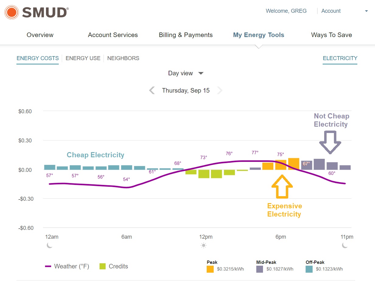

Because electricity costs must be incomprehensible in the State of California (it's in our Constitution, look it up) we do not pay a flat rate per hour, but it varies from Peak, Off-Peak, Post-Peak, Mid-Peak, Peak-Peak, Off-Mid-Peak, Mid-Peak-Off-Peak, you get the idea, lol
this is why I rather produce less during the Off-Peak aka Free green time frame and more during the orange (pronounced: expensive) time frame

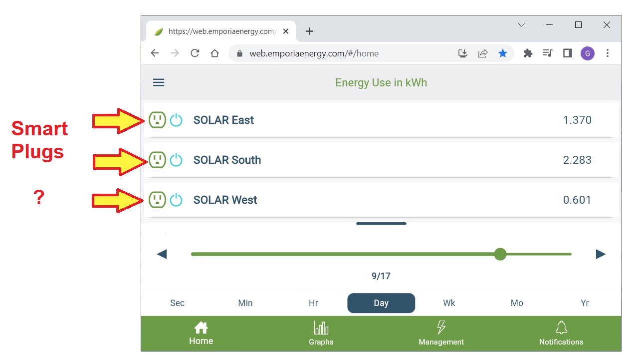

so I'm having fun with this project and have tried a number of different configurations, here I have it setup as three different systems
1. Solar East (four 100 watt panels and one 12v inverter)
2. Solar South (four 100 watt panels and one 24v inverter)
3. Solar West (four 100 watt panels and one 36v inverter)
total expenditure about $1,500 bones
all three systems plugged in to three different wall circuits (preferably GFI protected) using $10 dollar Smart Plugs from Emporia
so let's talk about what's wrong with using the Emporia Smart Plugs to monitor your Solar system:
