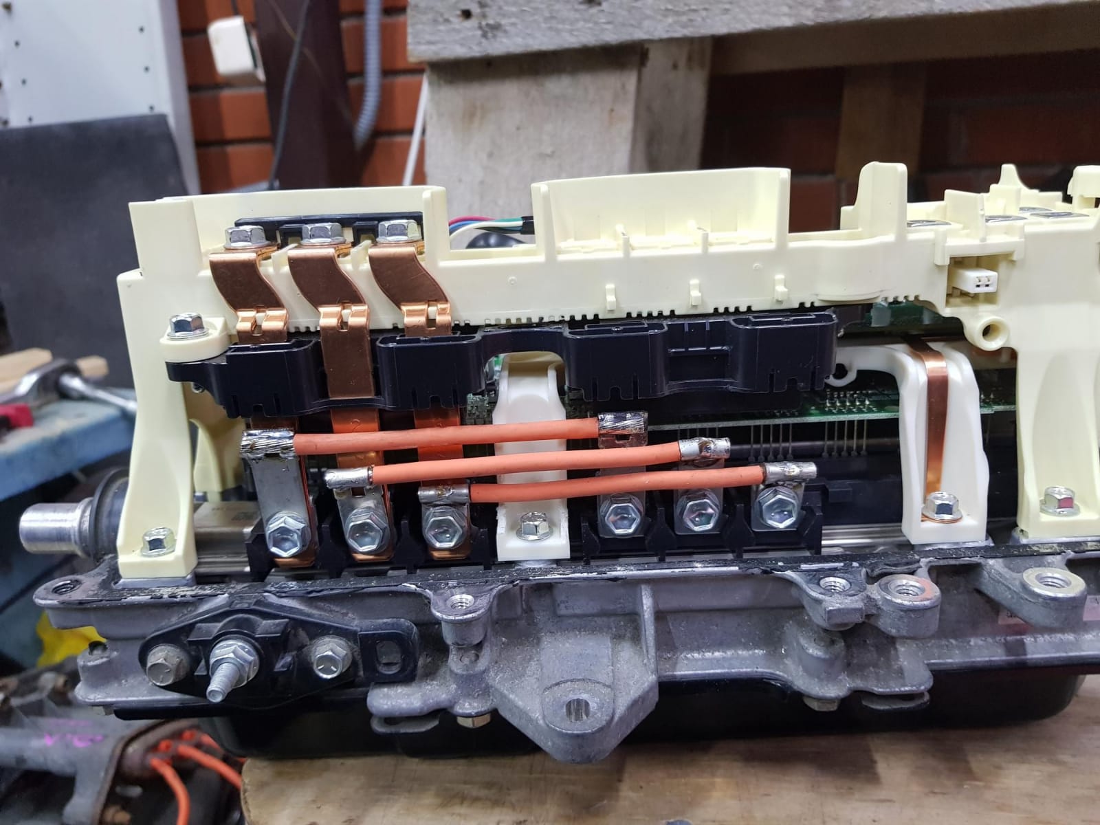

Re: EM61/EM57 driven by Prius gen3 inverter
Hiinvokeperformance wrote: ↑Fri May 21, 2021 1:03 pm I am using the gen 3 and EM61 combination, and paralleling MG1 and MG2 power stage to maximize current potential. I works very well and pretty straightforward to set up.
Where are you connecting those phase wires in parallel? Did you just bracketed phase connections and connect R,S,T lines from the motor to those brackets or do you use 6x cables from motor to each of 6 phase connections?
how does it behave on start?
tnx
- Posts: 45
- Joined: Fri Feb 14, 2020 4:23 pm
- Location: Atlanta
arber333 wrote: ↑Sat May 22, 2021 11:09 amHiinvokeperformance wrote: ↑Fri May 21, 2021 1:03 pm I am using the gen 3 and EM61 combination, and paralleling MG1 and MG2 power stage to maximize current potential. I works very well and pretty straightforward to set up.
tnx
This is how I have it wired to the inverter output and before the current sensors. On start both inverters are always active and synchronized.
