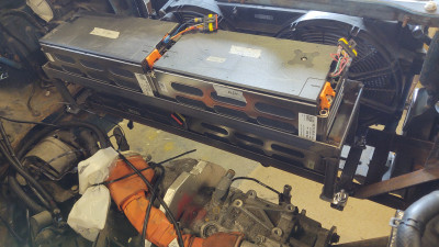

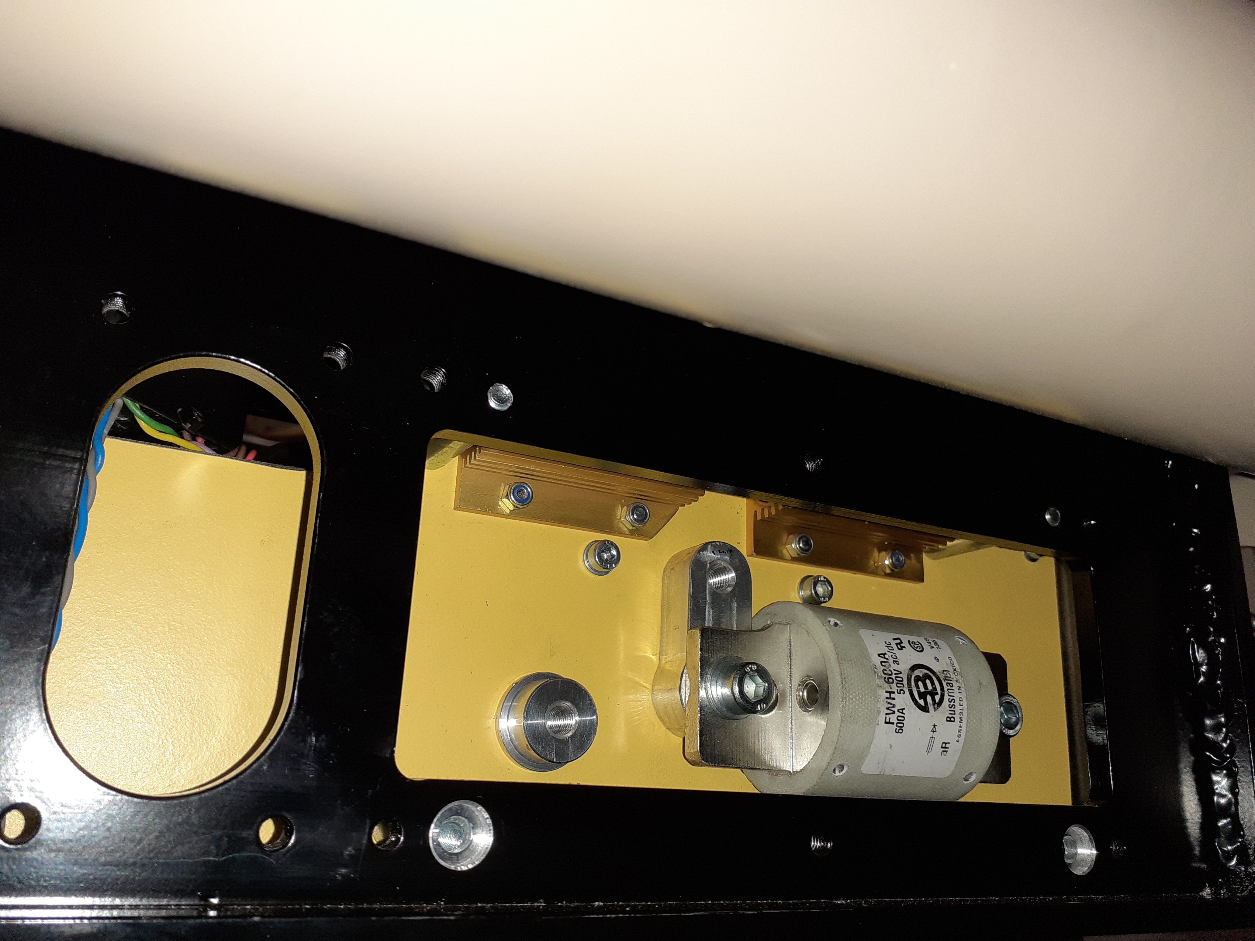

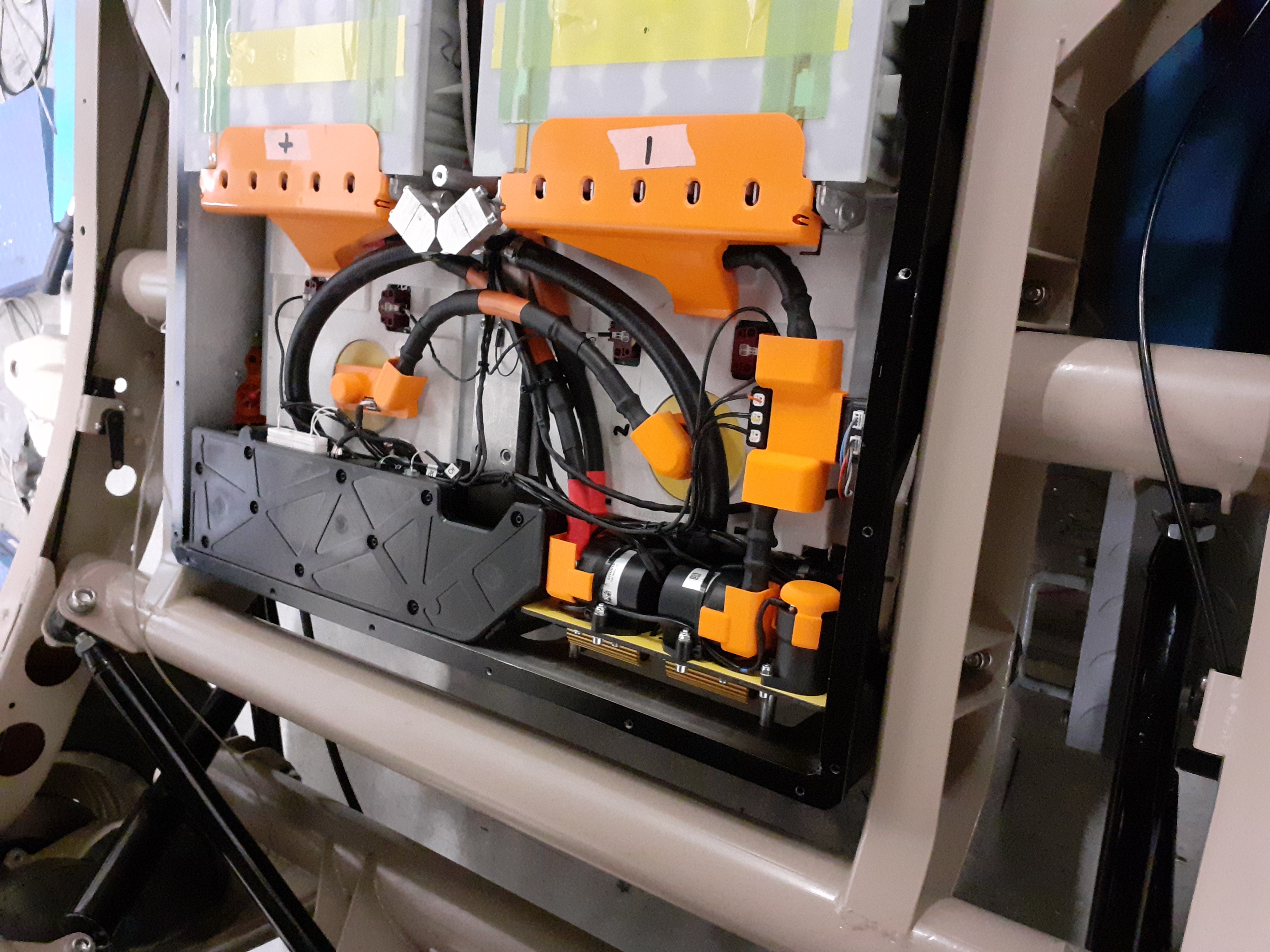

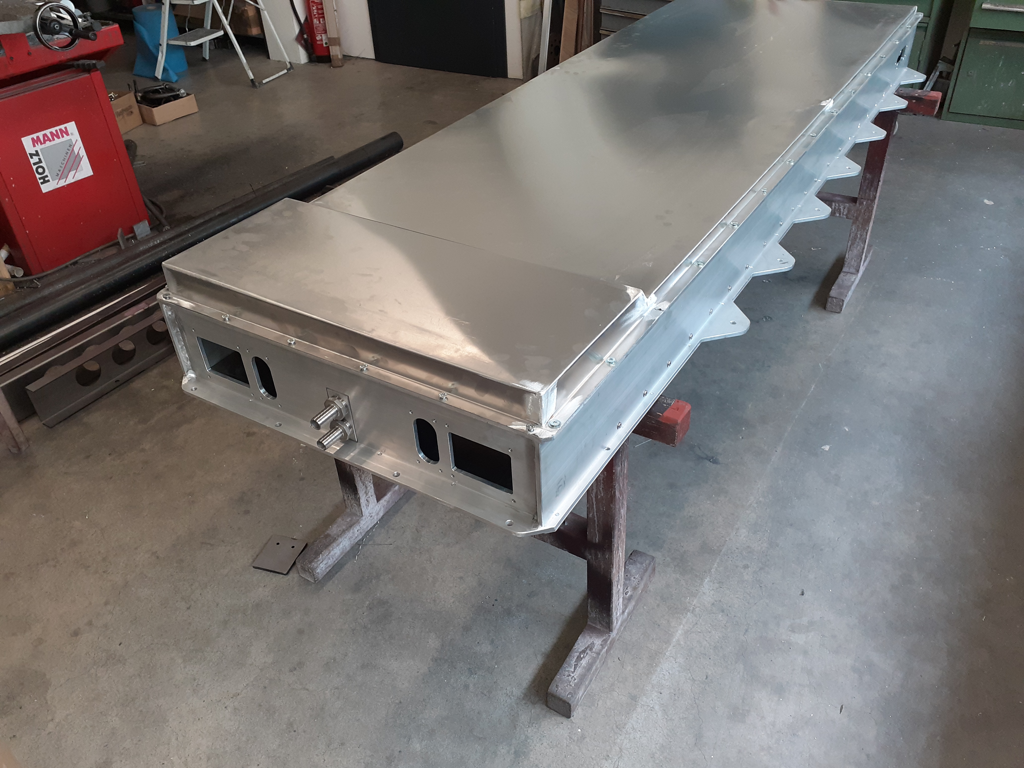

In addition to the right cable sizes and fuses, I think a mechanically stable structure is very important. My box is welded from aluminum profile and has a tin cover at the top (1mm) and bottom (2mm). The inside is lined with 1mm polycarbonate panels. The fuse and the cable connections can be reached by extra covers. Inside, all connections are insulated with caps.
In my case, the box is on the underside of the car and is therefore exposed to moisture and mechanical hazards.

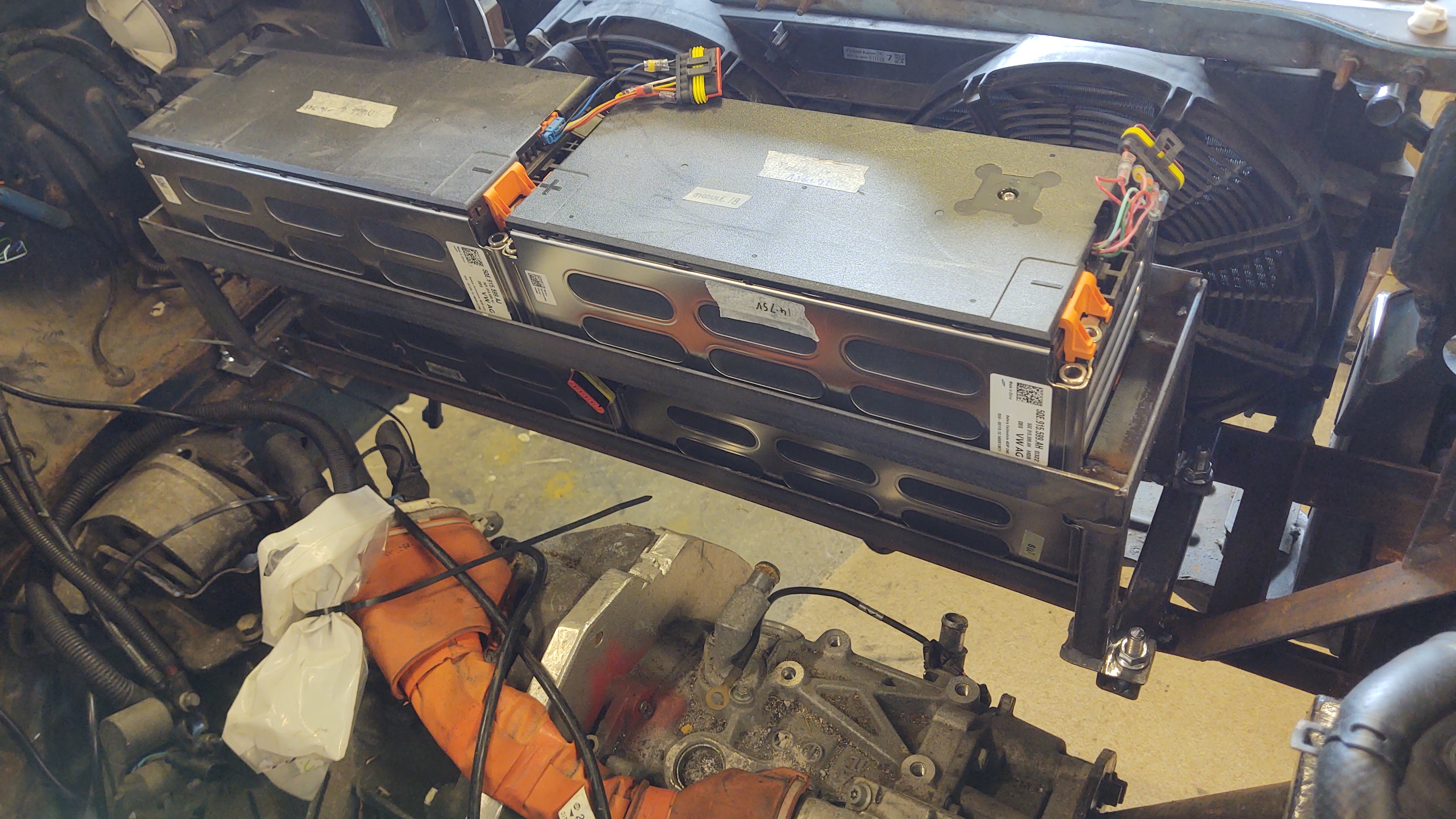

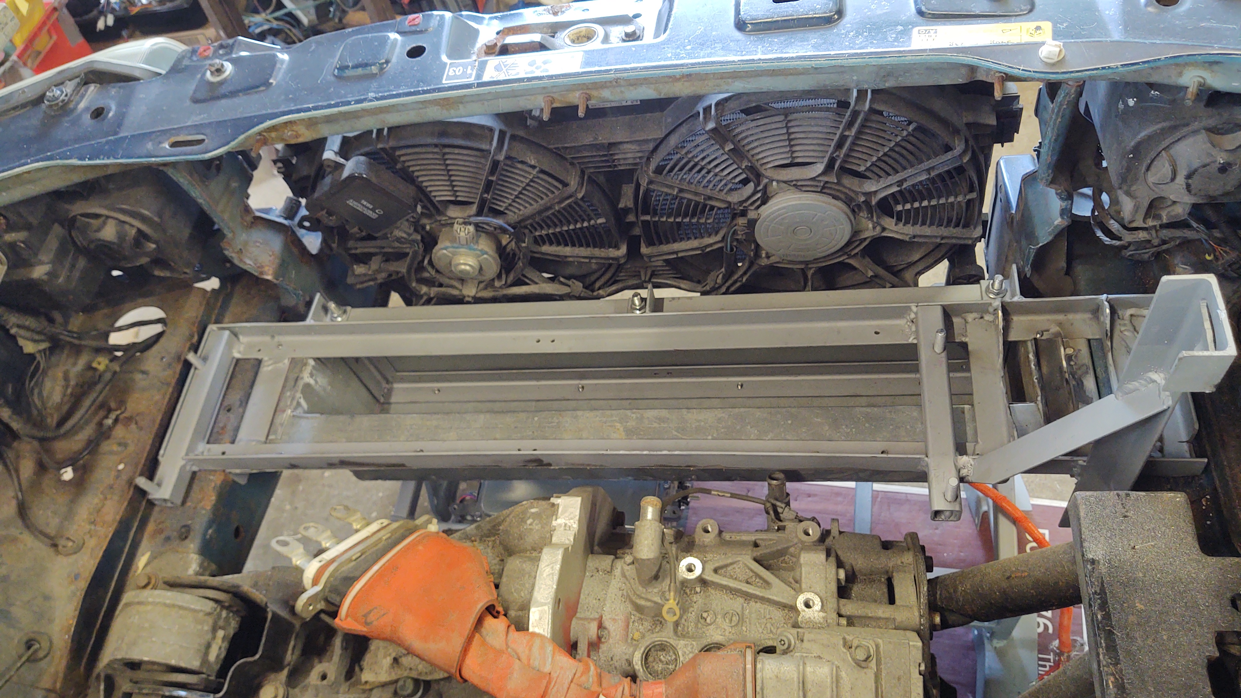

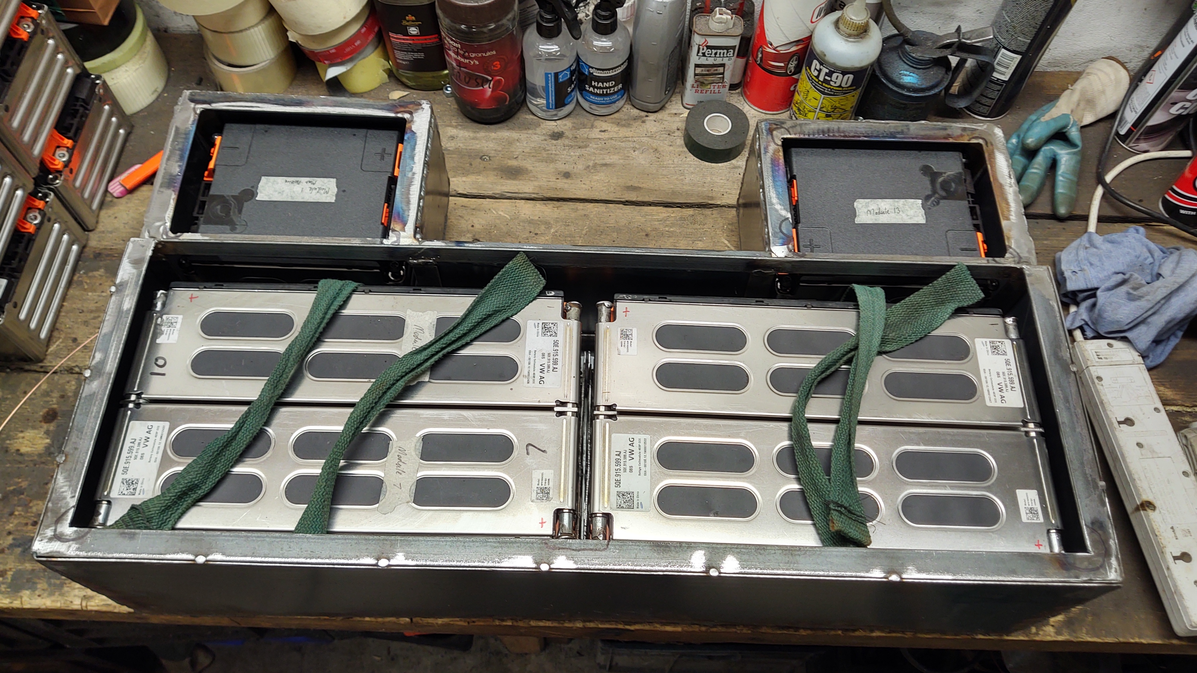

My first two are made from 3mm steel angle frame covered in 1.6mm sheet. I haven't made the other two yet and may try to get the remainder of the modules in the boot to avoid having to make a fourth.

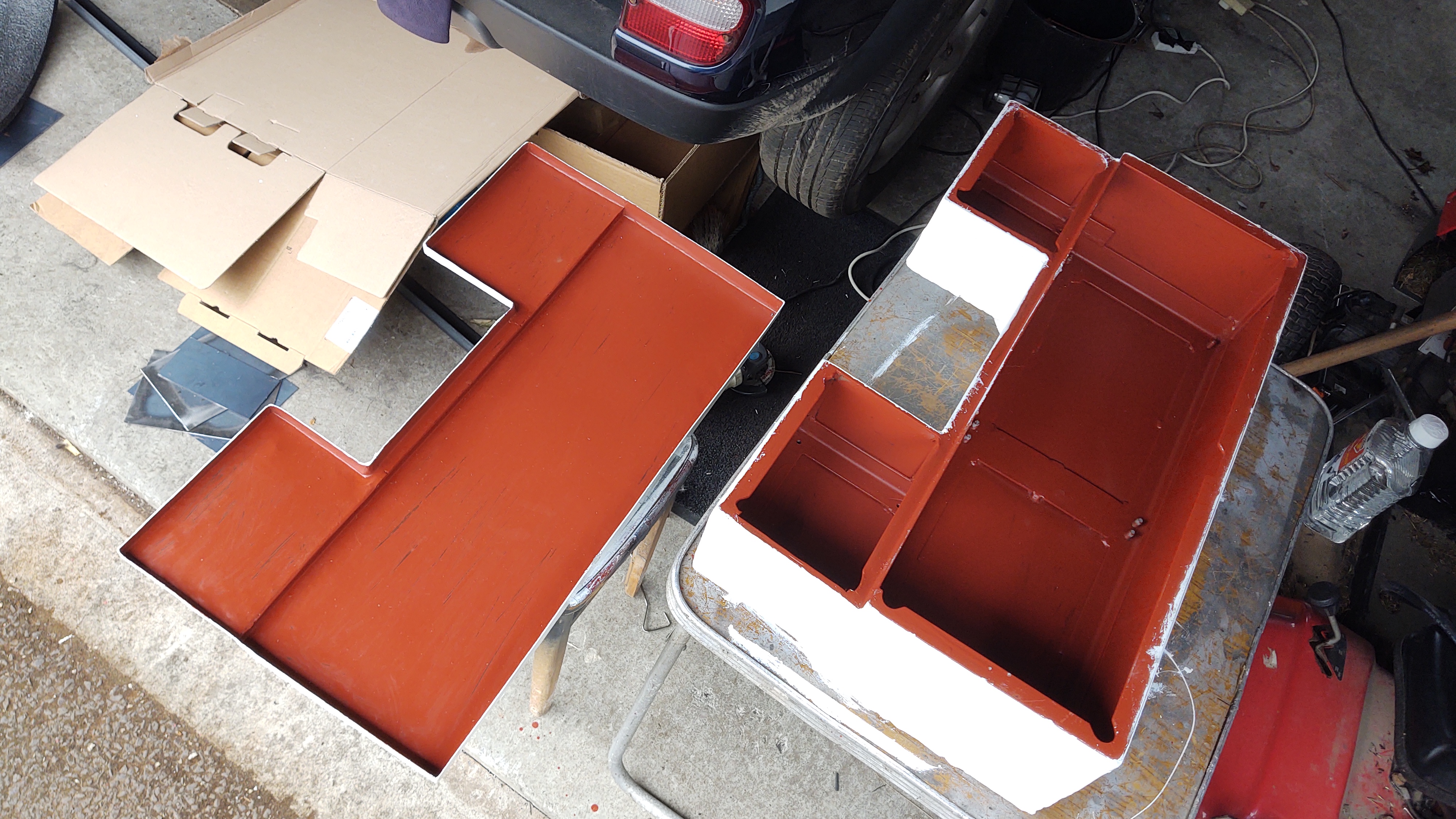

This is a box I made to go under the fuel tank but I didn't allow for fuses and/or contactor so this may need adjusted.
And this still has to have a lid made for the upper section but will hold six large modules under the bonnet
I would like to have made mine with aluminium but don't have the welding skills unfortunately.

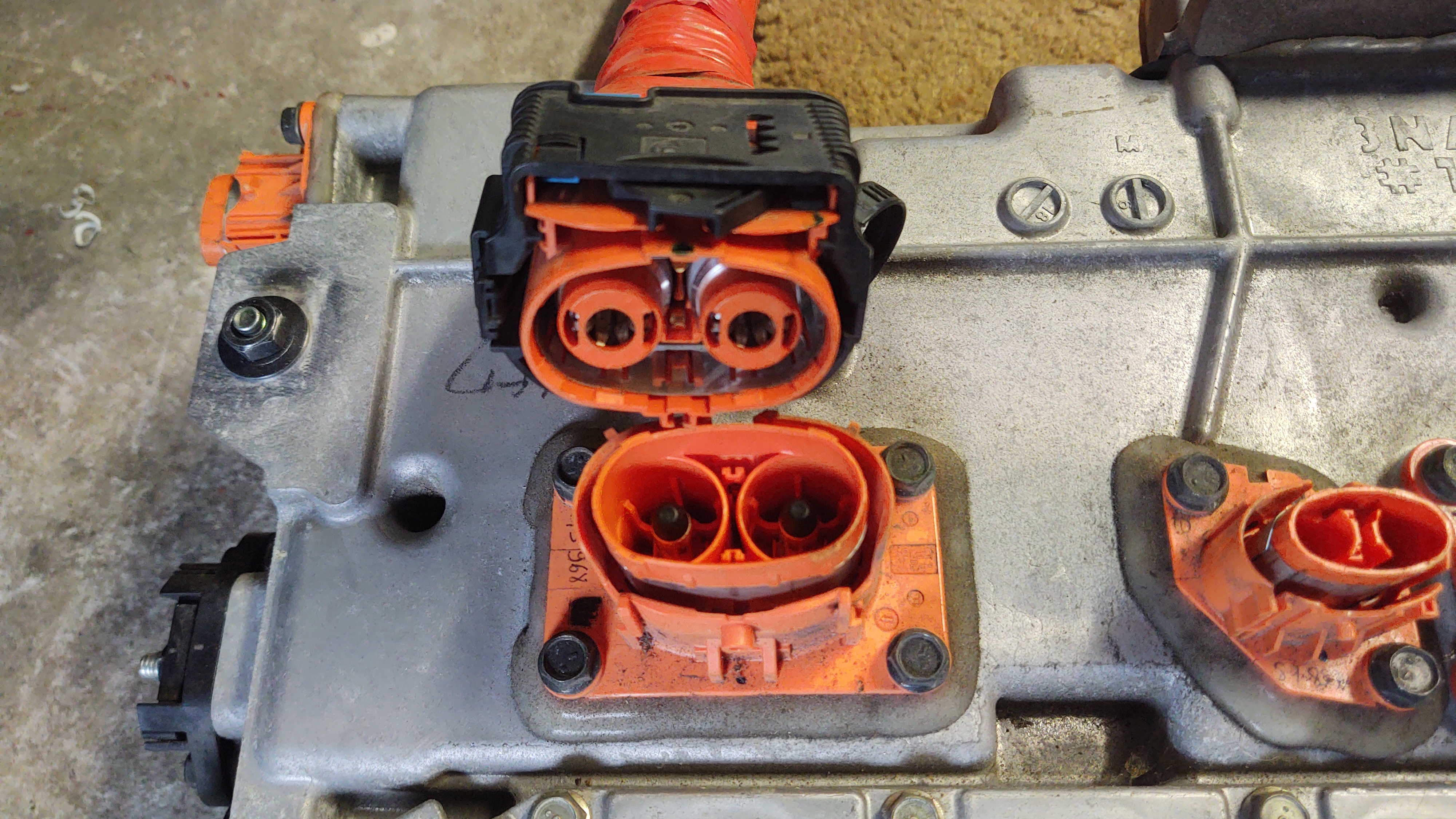

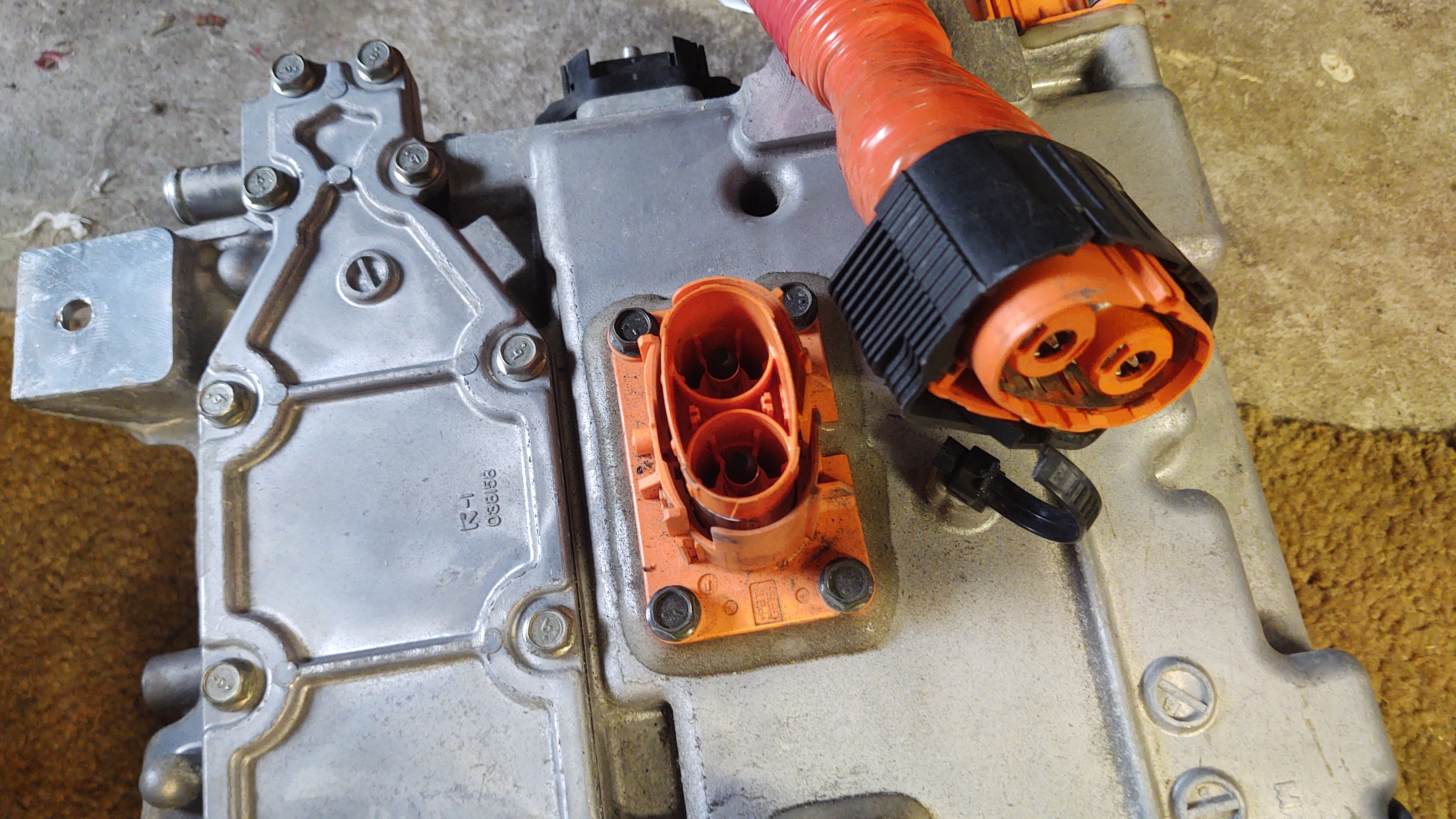

I'm more concerned about having a Service Disconnect and fuse so I was thinking about making my own service disconnect.
I have the PDM from a Leaf and cables so have all the connectors required to make two or three.
I haven't taken the connectors apart yet so don't really know if this is feasible or not but I suspect the cables would need to be cut and joined then probably potted in resin or such.
What do you guys think?
Have any of you tried this?
Do Service Disconnects need to be a certain type of connector?
Is there a cheap source for Service Disconnects?

In the process of tidying up my rear pack, I am reusing the same connectors as you have there in the pics. The panel mount one attached to the battery box and the other I intend using 35 or 50mm sq butt splices to lengthen the HV back to the service disconnect and fuse in the boot via two glands.
Try to harvest a service disconnect from a Leaf/Zoe/i3 etc, one with an inbuilt fuse anyway. Plenty out there but well worth getting OEM standard one for a piece of mind, so, I would avoid going cheap here as there will be a lot of connecting/disconnecting during your testing!
+1 on the Evcreate blast ports. I have a plan to put a couple in when I build my new packs.
Overall, the aim should be to have as few battery boxes as possible. Every link in that chain between boxes technically should be not only a fuse, but also a contactor. In the event of an accident, the inertia switch will kill the 12v power, open your contactors but if there are any links in the HV chain still live, there will be issues. Yes, you could put a fuse in the run from - to + terminals of the separate packs but the chassis can still become live and not necessarily pop the fuse if the hv and chassis come into contact.
I have three separate packs and not enough safety in there right now. I know that for sure! The knowledge I have gathered on the job where I am now has been an eye opener but have a plan to design something fit for purpose and safe. That includes dropping to just two packs. Also includes a isolation detection unit from Bender. You would have heard them talk about it in The Late Brake Show's vid from last week when Johnny visited the Young brothers at Santa Pod with their drag racing Beetle. Simple and relatively cheap (from a safety point of view! ) solution. https://www.bender-uk.com/products/insu ... ir155-3204
Unless someone can warn me not to for reasons I haven't thought of, I will go down the road of a contactor and fuse in every pack.
Also as all these sockets have a safety switch wire, I'll use that to kill the 12V power to everything if any HV lead is disconnected.
My thinking is if someone was to yank a lead off the pack there should be no possibility of the socket or cable being live.
If there is no 12V then there is no HV at any socket or cable apart from the BMS wires which I'm still thinking about.
It may mean a bit of redesigning and more fab work but I feel it will be worth it.
VW was happy to have no safety disconnects anywhere in their battery packs so it should be OK for me although I will still have one under the bonnet.
The Leaf/Zoe service disconnects with fuse are out there but only the plug. I've yet to find a socket for one.
