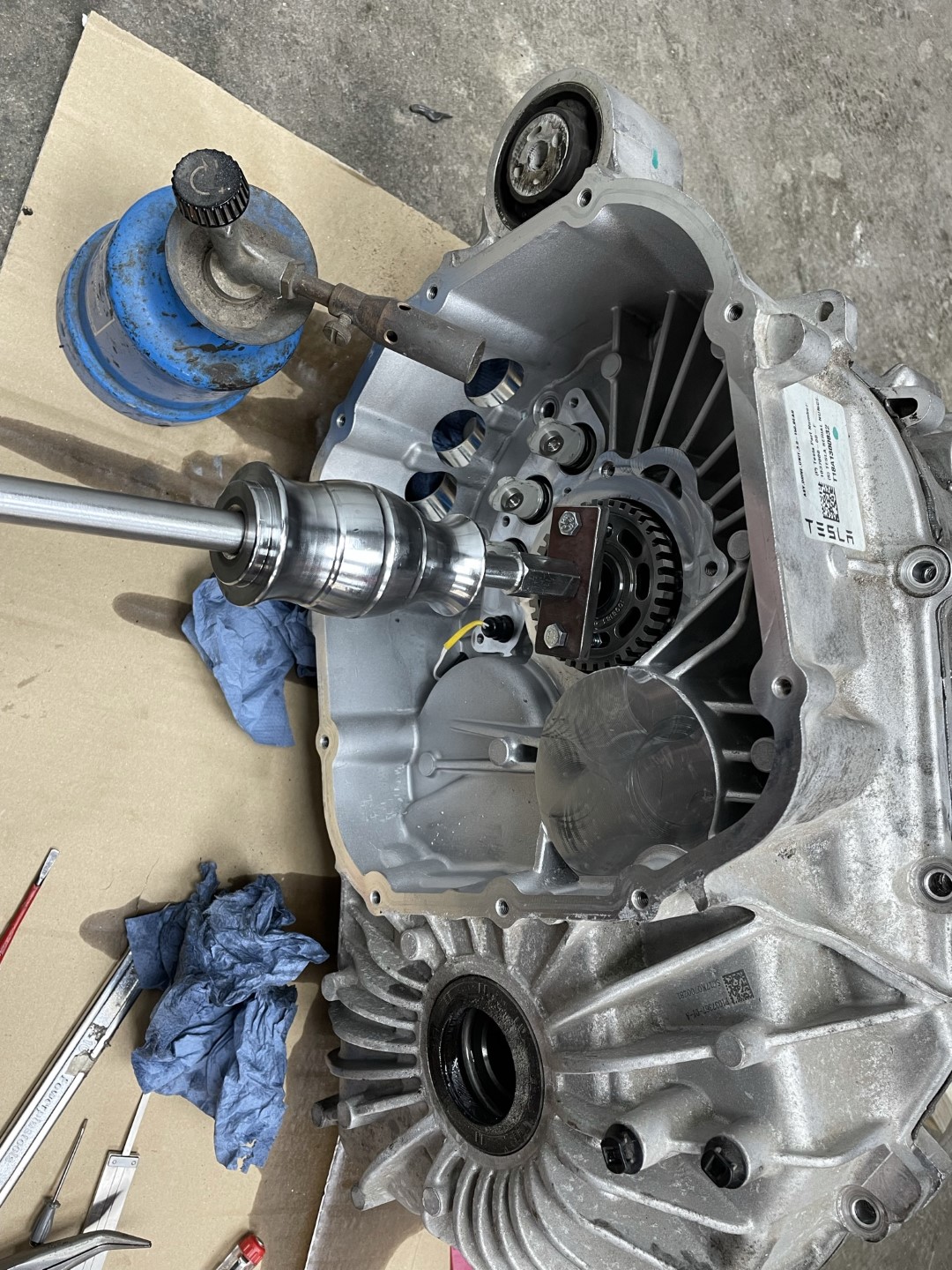

Some of you might already have seen the info below on my Instagram, but would like to document it for all of you here.
Started with the dismantling. Encoderwheel is pressed onto the shaft; had to make a (impact-)puller and pulled it off preheated. Motorshaft was really tight in the bearing and I did not want to apply too much heat to the bearing, so made a tool to push it out. When running the Tesla SDU in reverse, there are two (potential) issues.
1. Oil pump (does not work in reverse)
2. Bearings (possibly not designed for maximum torque in reversal). Did read some yells on the internet that you would destroy all

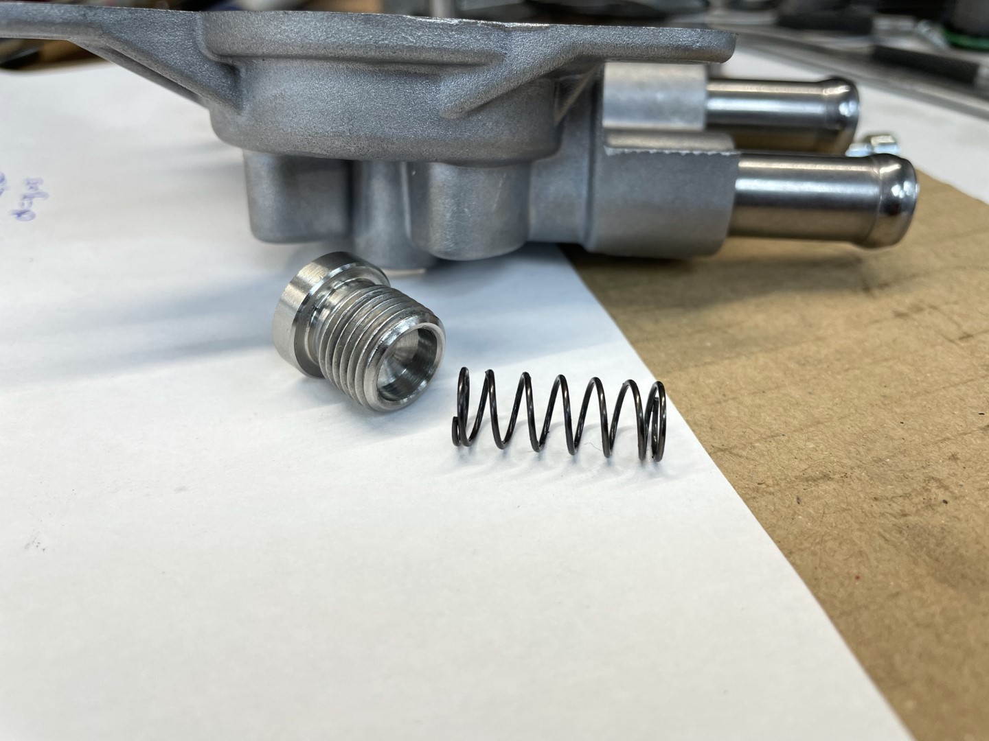

Oil pump:

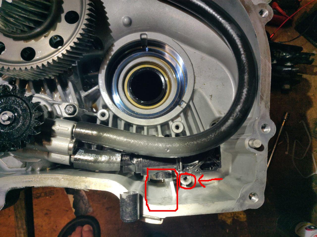

It indeed does not work in reverse operation. You could simply swap the tubes, then it will pump again, but the internal pressure regulation valve does not work anymore. This could lead to extremely high oil pressures popping hoses or destroy the plastic drivegear (due to the higher drive torque at high pressures).
Solution 1: Mount an additional oilpump. Have seen something like that on this forum
Solution 2: Modify the original oilpump. I went this way and made a quick test setup.
-> Pressure regulation valve seems to regulate the pressure at around 1 bar. First video in the Insta post below (could not upload movies here)
-> When running the original pump just in reverse direction, there is no pressure regulation, second video
-> After have modified the pump, regulation is stable at 1 bar when running in reversal, last video

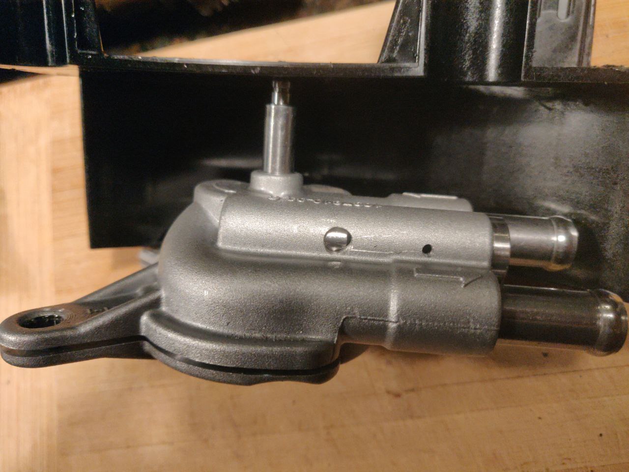

How did I modify the pump ?
-> Original pressure regulation valve is located between both hose connections. Behind the cover cap is a spring and a piston.
-> There are three ports. 1. Piston actuation (the regulated pressure), 2. pressure relief (back to the suction side of the pump) and 3. venting of the piston rear side.
-> What has been modified:
1. Closed the original piston actuation port with a turned piece (left on the picture). Inside has M6 thread, but that was just to be able to pull it out when it wouldn't work as expected. Piece is made of stainless steel (what I had around) and presses into the preheated pumphousing. This piece pushes the initial position of the piston 4mm forward. So the original 'relief' port now actuates the piston.
2. Made a new pressure relief port. This is de large oval port at the side of the pump. Just milled by hand (dremel). You can see the groove in the piston, that's not the piston top. The relief now unloads directly to the bottom of the transmission. Only drawback of this could be the generation of air bubbles in the oil which could be picked up by the pump if the bubbles don't disappear quick enough, but I don't expect any issues when that happens since we are just pumping some oil around mainly for cooling, not lubricating shell bearing or other air-bubble-sensitive things.
3. Closed the original 3mm venting hole (inside in the pump, not on picture) by threading and closing it with a M4 setscrew. Drilled a new 3mm venting hole on the side of the pump.
4. Compensated the cover cap for the 4mm moved piston travel to get the same spring force.

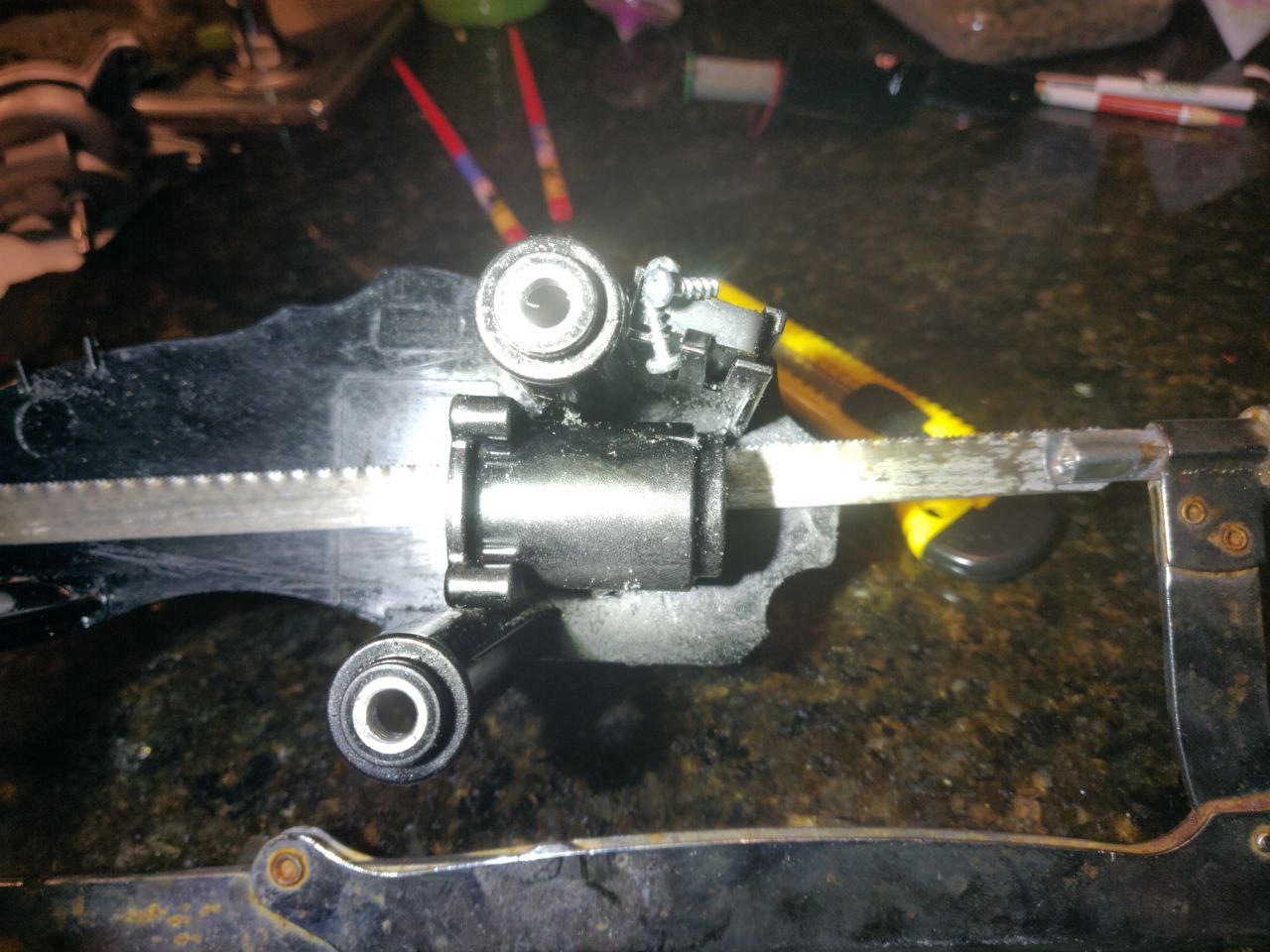

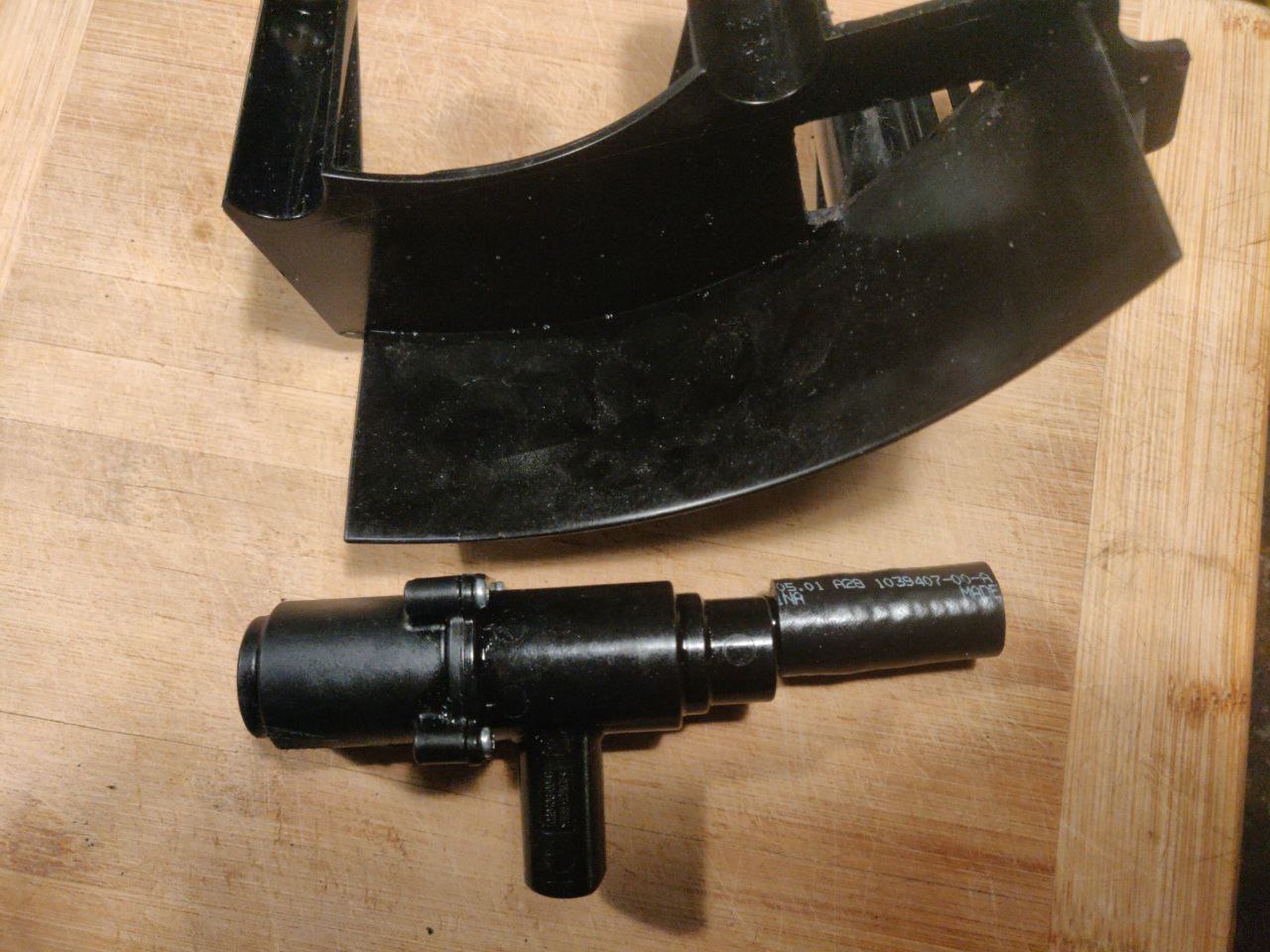

5. Original oil pickup filterhousing (mesh thingy) did not fit anymore. Tried to find a universal one (in the industrial hydraulic world), but it was difficult to find something that fits, so made one myself. Turned something from an aluminium bar that takes the original mesh filter and slides over the pump connection. Kept into place by the original plastic mount (grinded some unneccesary plastic away with the dremel).

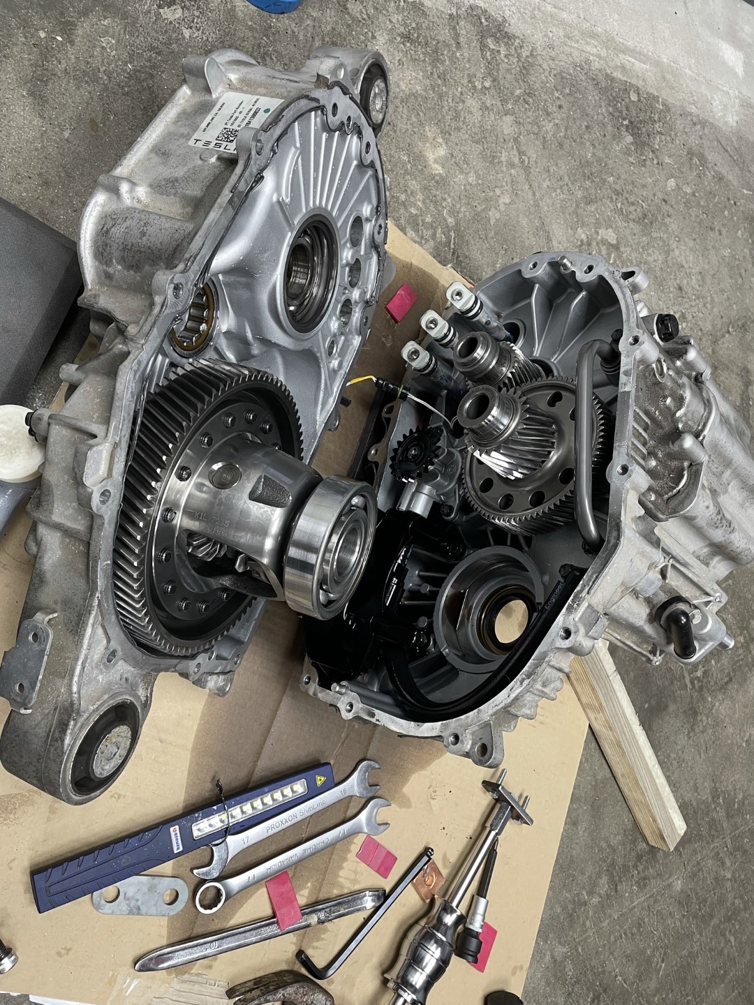

Re: Tesla SDU modification for reverse operation

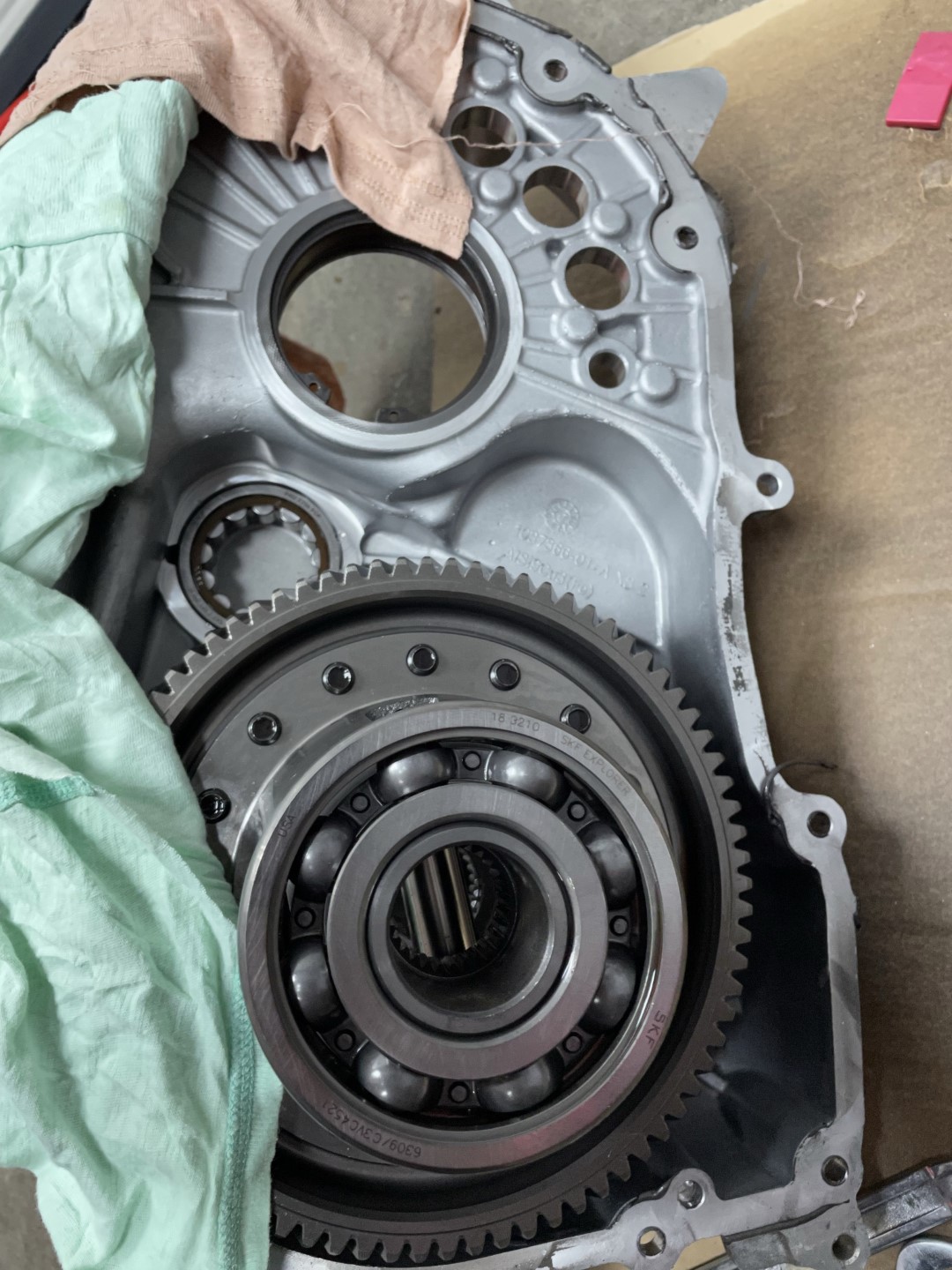

Regarding the bearings:
Diff: Two standard SKF 6309 deep-groove single row ball bearing. Diff axially shimmed into place
Intermediate-shaft: One standard SKF 6307 deep-groove single row ball bearing. Shaft axially tightened with a nut, bearing locked into place with a plate and five M6 screws. On the other side one SKF RNU2206 roller bearing.
Motor-shaft: One standard SKF 6208 deep-groove single row ball bearing on the encoderside. Shaft and bearing axially locked into place with circlips. Motorside not yet known, but I suspect a roller bearing, or a standard single-row ball bearing between some disc springs to allow the shaft for some thermal expansion.
Did read some messages on the internet "the thing will fail immediately, explode, fall apart into pieces" when generating max torque in reversal (because it is 'just designed for regenerative torque in reversal'. I really don't know why that would be a problem !
If anyone has some additions or corrections (I'm just a hobbyist as well), please let us know !

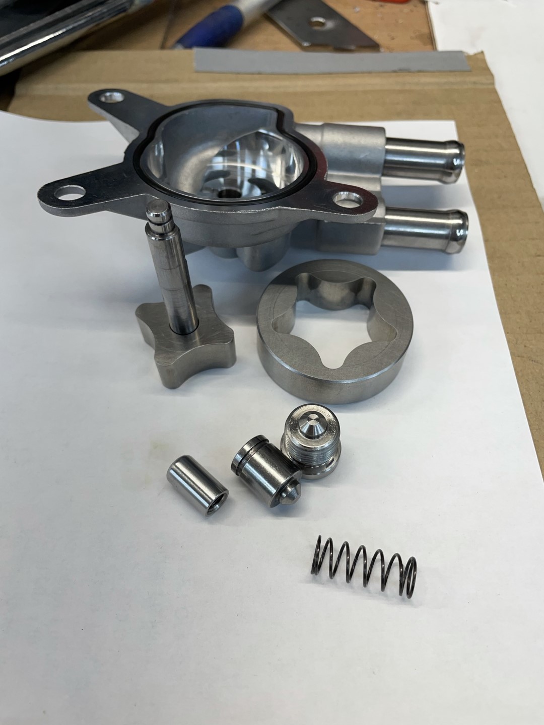

Thank you for your extremely detailed post! I have (I hope) replicated this on my own SDU today. I did the following:
1) Tap the original piston actuation port and insert M10 grub screw. Allow 5mm protrusion so that the piston doesn't return to the bottom. This allows the original outlet to become the new inlet as per the above design.
2) Tap the original pressure relief port and insert a grub screw (M4).
4) Drill new outlet and pressure relief holes. I have drilled the outlet hole rather conservatively to begin with.
I have not modified the spring or end plug yet. Hopefully in the next few days I will be able to get the pump hooked up to a pressure gauge. At that point I can test the pressure (I expect it to be excessively high initially), and then enlarge the outlet port and/or bring the spring back, until the pressure is steady at 1 bar.
Photos attached. I don't think they add much that you haven't already covered.
One major problem I experienced was that tapping the pressure relief port, and drilling the new outlet created significant burring inside the shaft. I had to very carefully file these to allow the piston to move freely. I'm still not entirely happy with this, as it has the potential to snag the piston in the future.

Thanks for the suggestion! I actually did enlarge the hole a little (arbitrarily, hopefully not too much), and after lots of very careful filing and cleaning, I'm happy with it.
I'm now waiting for a pressure gauge so I can test and adjust the spring if needed (I haven't drilled out the end cap that retains the spring yet and will do so if needed to reduce the pressure).
I've done most of the construction of the oil pickup too. I machined an open tube, and a plug for each end (one for a pipe, one closed), which will be glued in place once I've milled the opening to pick up the oil.

I've now tested my pump modification. The pressure is steady, generally around 1 bar, and can rise to about 1.5 bar depending on how much resistance I apply to the output pipe. Here's an example of the pump running with a moderate kink in the output pipe at 1.2 bar: https://photos.app.goo.gl/NvLVjM9acev4BazC9
I changed the design for the oil pickup. It's now a lot more like FJ3422's, though I used a pipe to reach into the sump (more like the OEM pickup) rather than a slot. The final pickup pipe was shortened a little, to increase flow.

I just modified mine but I used the original filter case. I cut it from the plastic cover and moved it lower.
The only mistake was to cut the intake shorter. I cannot move the original intake lower because of the cover support. Pretty much the back of the oil pump sits in the same position, but lower and it is connected to the original exit.

For anybody that wants to run the motor upside down, I would no do it. The oil is pushed by the Oil pump all the way back in the TOP of the motor.
The oil comes back at the bottom. if you run the motor upside Down the motor would swim in oil. probably would need 2 gallons of oil to come out of the opening if it is upside down.

The oil returns in the bottom opening, where the 3 phase cable go to the motor. If it is upside down the whole chamber of the motor will be filed by oil that cannot drain.
Best is to get the motor and open it to get a better idea of what is going on.

I see now that the front SDU oil pump is different than the rear SDU oil pump. The front pump has the intake and output ports on opposite sides, whereas the rear pump has them on the same side. Even if I could modify my pump to work in reverse, I'm not sure there is enough room to route both hoses past the differential gear (which would be required to swap the hoses around). Maybe if I made some rigid steel lines it would work, but I dunno. Seems like an external pump might be the way to go when reverse mounting a front SDU. Any other thoughts or suggestions?
Re: Tesla SDU oil pump modification for reverse operation
Hi nubster,
I did it like this: viewtopic.php?p=56088#p56088
Not yet driving so i dont know if it will last.
- nubster
- Posts: 77
- Joined: Sat Oct 29, 2022 7:20 pm
- Location: Los Angeles
- Has thanked: 37 times
- Been thanked: 6 times
Oh wow, that's a cool way to do it. So you modded the valve, rotated the pump 180, tapped a new mounting hole, and are only using two of the three bolts now? I see why you'd be skeptical about the longevity, but it seems like it could work. Rotating it makes it so you don't have to route both hoses past the diff gear. Thanks for sharing, I like it!Lood wrote: ↑Sat Sep 30, 2023 5:50 pm Hi nubster,
Yes only 2 bolts now. For the new bolt I used a rivet nut.

How did you manage to get the hose barb nozzle out? Is it just pressed in?
Yes just add some heat to the housing and pull/twist it out.
