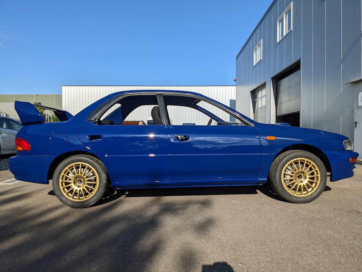

I loaded the car on my trailer to paint it one last time. At one rear fender the metal morphed a bit too much while welding and i had to redo it. So we decided to paint the whole car again for a perfect finish.
Finally the Impreza is mostly put back together.
Just a few more days of work and then full attention can be paid to the EV-conversion again.

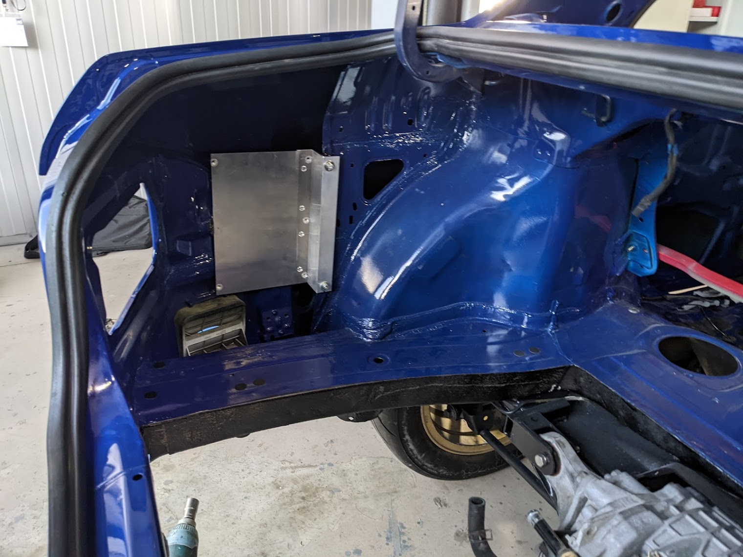

Meanwhile the long ordered Orion BMS from EV-Shop Europe in Romania arrived. I ordered the Orion the second time with them as they are very reliable and also have the cheapest offer in Europe.
I then fabricated a proper mount for the BMS:
In this position the original boot carpet has a door for the car lift and spare wheel tools. Now one can access the BMS there.

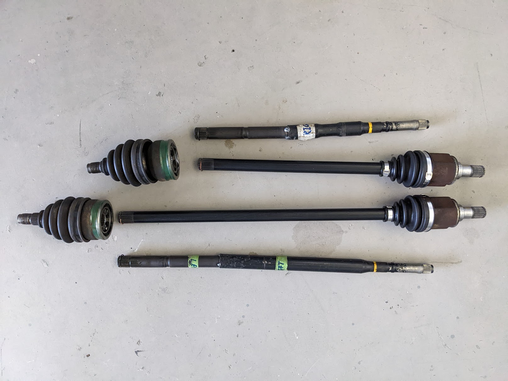

before painting the car again i installed the CCS charging port (uninstalled it for painting, again)
Also i received my custom drive shafts from motomax.pl. I had the contact out of this forum and must say they did awesome work for just 150Eur a drive shaft. I just sent them the two cut halfes of each side. Couldn't be happier with that and definately will let them do the front ones, too!
- EV_Builder
- Posts: 1199
- Location: The Netherlands
- Has thanked: 16 times
- Been thanked: 33 times
Re: Subaru Impreza 96 - AWD with 2 Outlander rear motors
Yeah just like mine! Perfect price for good product (complete new shafts).Zapatero wrote: ↑Fri Jun 10, 2022 9:47 pm Also i received my custom drive shafts from motomax.pl. I had the contact out of this forum and must say they did awesome work for just 150Eur a drive shaft. I just sent them the two cut halfes of each side. Couldn't be happier with that and definately will let them do the front ones, too!
When i'm ready for the fronts they get mine too!
