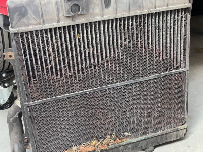

Finally got started on some work today. Only had a few hours but got the doors and bonnet off, oil and water drained, sorry looking radiator removed, air box removed, battery and coil removed and linkaged disconnected.
I can only work on it on Saturdays where it is, so progress will be slow.
Next week I hope to get exhaust off, fuel drained, fuel tank out, prop shaft out and possibly engine & gearbox out.
Some pics:
Some pics:

Re: BMW e30e
Great to see this build kicking off! Looking forward to updates. Let me know if you need anything as I'm just down the road.
