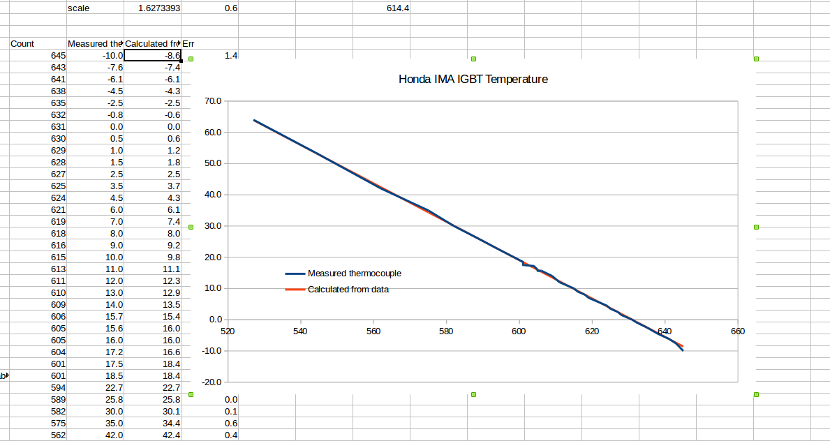

I then identified heatsink or IGBT temperature bytes in a similar manner by blasting the heatsink with a hot air gun and observing which bytes were changing. Once identified I put the whole thing in the freezer at -10C and let it warm up to room temperature and then heated with the heat gun to 60C whist monitoring the temperature bytes and actual heatsink temperature with a thermocouple. This allowed me to workout a scaling and offset factor.
The relationship between data bytes and real values are
V_IGBT2 = (bytes[7] * 8 + bytes[8]) / 4.095;
V_IGBT1 = (bytes[5] * 8 + bytes[6]) / 3.089; // 20% LOWER than IGBT1
temp = -((bytes[11] * 8 + bytes[12])- 631) * 0.6414;

I have identified 6 of the 13 data bytes but the rest of them are a mystery to me.
The idea is to somehow get these numbers into the open inverter firmware rather than make my own isolated voltage measurement or temperature measurement using a small microprocessor as a bridge.
I'm not sure if the open inverter hardware can accept serial readings for voltage or temperature so I plan on using a small micro to covert these readings back into an analogue 0-3.3V signal so the stock firmware and more importantly any future updates are compatible with this installation with zero faffing about when that time comes.
