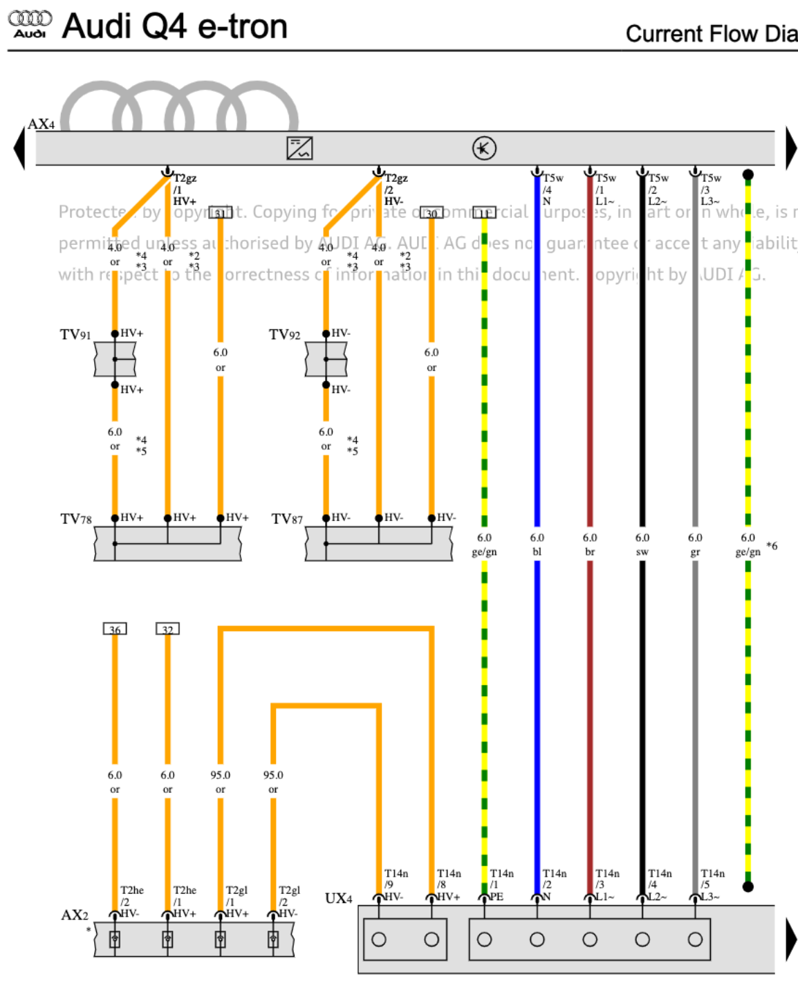

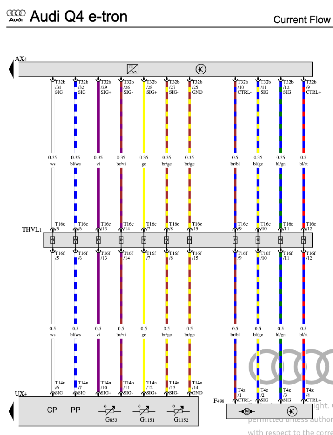

Someone knows the schematic / wiring colours meanings of this part?
Anyone an idea how to obtain the schematic?
CCS2 Chargeport from ID3/ID4

VAG have an online portal for service information: I think for around 10€ per hour to download info required.
https://erwin.volkswagen.de/erwin/showDSP.do
Parts schematic - seems lots of part number versions for different PR codes. Number 1 includes 19, 20 & 21.

I have a VW CCS charge port, just been figuring out the pinout this evening. Little late but I hope this helps for anyone else looking.
4 pin connector to interlock. 1J0973704 is the connector for this.
1. Lock drive - 12v to open
2. Lock feedback
3. Lock feedback
4. Lock drive + 12v to close
10 pin connector. 1J0073715 is the connector for this one.
1. LED ground
2. LED red 12v
3. LED green 12v
4. LED yellow 12v
5. PP
6. CP
7. Temp sender?
8. Temp sender?
9. Temp sender?
10. Temp sender?
2. Lock feedback
3. Lock feedback
1. LED ground
2. LED red 12v
3. LED green 12v
4. LED yellow 12v
5. PP
6. CP
7. Temp sender?
8. Temp sender?
9. Temp sender?
10. Temp sender?
Re: CCS2 Chargeport from ID3/ID4
If it’s like the taycan or etron chargers. The DC line plugs are made by rosenberger
https://products.rosenberger.com/power/ ... ngle-jack#
You can also get the STL file of the port from Phoenix Contact
Phoenix Contact use the same base wire colors out of all their ports
White - CP
Black - CS
Gray - AC plug temp +
Brown - analog ground (two wires, one for the AC temp sensor, the other for the DC temp sensors)
Yellow- DC+ temp
Green - DC- temp
Plug lock:
Brown/Blue - Lock motor -
Blue/Red - Lock motor +
Blue/Yellow - Lock Sense
Blue/Green - Lock Sense (Gnd) If it's like the newer ID4/Q4 E-Tron, the wire colors are slightly different:
White - CP
Black - CS
Yellow- DC+ temp
Green - DC- temp
Plug lock:
