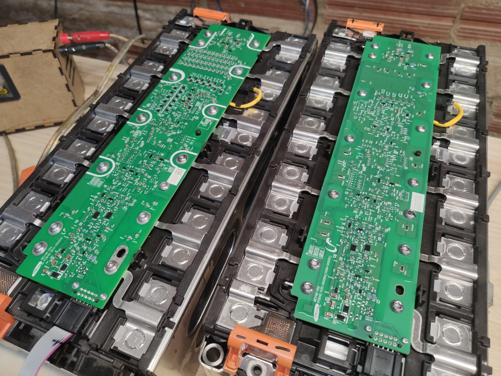

Re: VW eGolf hardware
Hello.
I introduce myself with the first message, I'm Alfonso from Spain.
I have bought 16 modules from VW (1.64kWh), and seeing that the Teensy 3.6 cannot be obtained right now, I am trying to communicate with a simple Arduino.
I am looking for the plot to activate cell balancing, but I see that it is not working.
I have a thermal camera, but I see that the resistances are not activated, sending in all possible directions.
I have unbalanced on purpose, but there is no cell balancing.
I have looked at the balancing datasheet, and it can dissipate a maximum of 150mA, so it will be there for a while.
I'll wait until tomorrow to see if anything works, or if the cell voltage changes.
Best regards

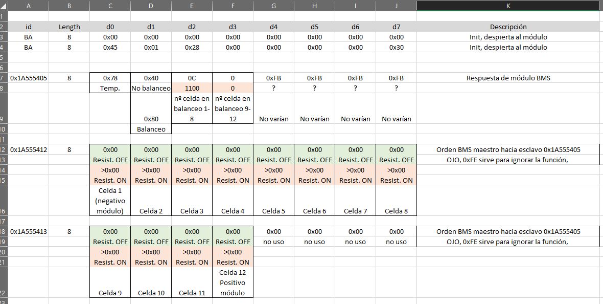

Hello.
I have confirmed that the commands for balancing work fine. I attach two images, thermal, and photo of 2 battery versions. This is a video with work balance https://youtu.be/fDm4_A2jWdU
To activate balancing, any value greater than 0x00 , except 0xFE (the latter ignores the function, neither activates nor deactivates balancing).
To disable balancing, 0x00. Best regards
Sorry, I don't know the DBC format, or for what system is it needed? Batrium? SimpBMS ? or app?
I am attaching a modified Excel (VW GTE Canbus Ids) with the results that I have experienced. Best regards

thank you for confirming my finds are correct. Good to see others being able to replicate my findings/hunches

Pretty sure those addresses are visible on the PCB else we should try to reconfigure a board. If it's not on the PCB it means that the # in the pack could vary with their position in the pack. Don't know if OEM's don't want to know the physical position..(or they should be programmed one by one which is costly).alfonatr wrote: ↑Thu May 05, 2022 10:21 pmIt's true.rstevens81 wrote: ↑Thu May 05, 2022 2:06 pm Tom de Bree (tom91) is the author, but what I do know is that ...
You can't have repeated addresses, basically the BMS is receiving a shunt on the can saying I am module 1, my cells are ... If you have 2 modules called 1 things are going to go bad quickly.
As far as I know then can't be renumbered.
You'll going to need to work out what the IDs are for each of your modules and then create some sort of can in the middle device that will translate the ids's.
They cannot be connected with the same address, it's difficult to identify them.
In my case, by the voltage I know which module corresponds.
But in case of sending balanced, it's a problem.
It's a shame, I was thinking of using 16 modules to install in a vehicle, a Think City, but I'll look for an alternative BMS.
Summarizing:
I understand that you cannot install modules with the same address if you want to enable balancing.
If you don't turn it on, no problem, it will read all the voltages but it won't be able to identify which module has the wrong voltage.
You are limited to 8 different CMC modules, so your final battery with slave BMS will be limited to 8x1.64kWh = 13kWh approx.
If not a conversion device would do the trick, except you have 3 modules #6 that means you need 3 can ports in your translator. I might have a solution for you todo translations. I need to check how easy i can make it 3ports... (It has 2 natively). So for all others it's easy.
P.s. i do think we should be able to change ID's.

In the small square section looks like some configuration to me?
Do you have closeup? What's printed on the small table?

@ the third screw on both HW revs. you see like a config zone.
(Could be)
The table is on the left side third screw on the left board. The right board has the table at the second screw.
That table might be interesting...
It's speculation best thing would be compare two boards same HW rev. different ID's.
(Could be)
