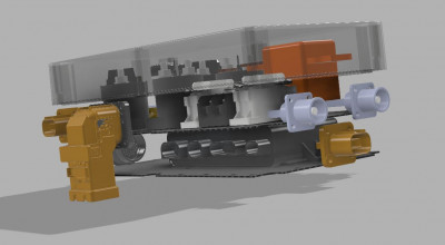

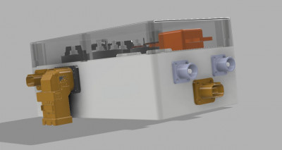

jon volk
Posts: 572
Location: Connecticut
Re: Anyone parting out an i3 KLE?
Post by jon volk »
Awesome, thanks. I was wondering what the back side looked like. Thats nice and compact.
Basically looking to do a two level box with the i3 LIM underneath. External connectors arent in the final position but thats the general layout.
