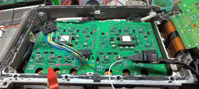

Hello everyone. I need help with this inverter.
I'm applying 5 volts to the red and black wires, but the drivers don't receive power, and connecting the inputs to ground doesn't open the channels.
What am I missing to get it working?
evil neodymium :twisted:
Posts: 3796
Been thanked: 413 times
Re: VOLT/AMPERA inverter single controler dual IGBT drive
Romale wrote: Tue Jul 01, 2025 1:42 pm Hello everyone. I need help with this inverter.
Volt inverter logic section is powered directly by DC rails. It will start somewhere upwards of 48Vdc. Its power converter is just there on that second board. Those large power transformers are part of it...
So you can simply provide DC and then you can connect the PWM pins AND common GND connection and you are good.
Drivers are turned ON by "Normally closed" signal. So a pull-down signal from inverter brain.
TomDB made a document with good pinout some years back
https://www.diyelectriccar.com/threads/ ... 2/#replies
https://www.diyelectriccar.com/attachme ... df.101753/
I made a simple board to interface with openinverter v2 using DS program.
https://github.com/arber333/Ampera-inve ... -interface
Then i made a Lebowski drive for TWO sides in parallel in DS.
https://github.com/arber333/Lebowski-dual-IGBT-control
You can find also Toms document there as well as some program for a precharge trigger with Pic chip

Thanks, I didn't think of that. It's a strange solution, but you could use 12 volts for this purpose, like everyone else.
I'm going to use it with a small V3 Joohu board and not use the small steering inverter.

You could make my interface board and only connect Openinverter V3 board by wires. It contains all items for full control even interface for DC voltage sensing. I didnt include resolver interface at that time, but you could add it and edit my board.
Also here is a full board for Johannes V2 interface for dual IGBT sections... And this has all interface on one board
https://github.com/arber333/Johannes-co ... IGBT-board
