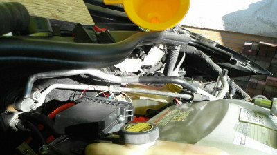

Trying to run the DC-DC converter now. Unfortunately it's not quite as straight forward as I though.
I am running the buck converter to produce about 230V on the DC-DC input. I hooked up IGCT to "ignition" 12V. When done that way, the DC-DC converter does not start up. It first wants to see some high voltage then IGCT.
Now I could simply add an RC lowpass to delay IGCT. Or produce another signal in the VCU

Fuse arrived today. Bolted it directly onto the contactor and, lucky me, I just needed to add an isolated standoff to one of those battery mounting studs

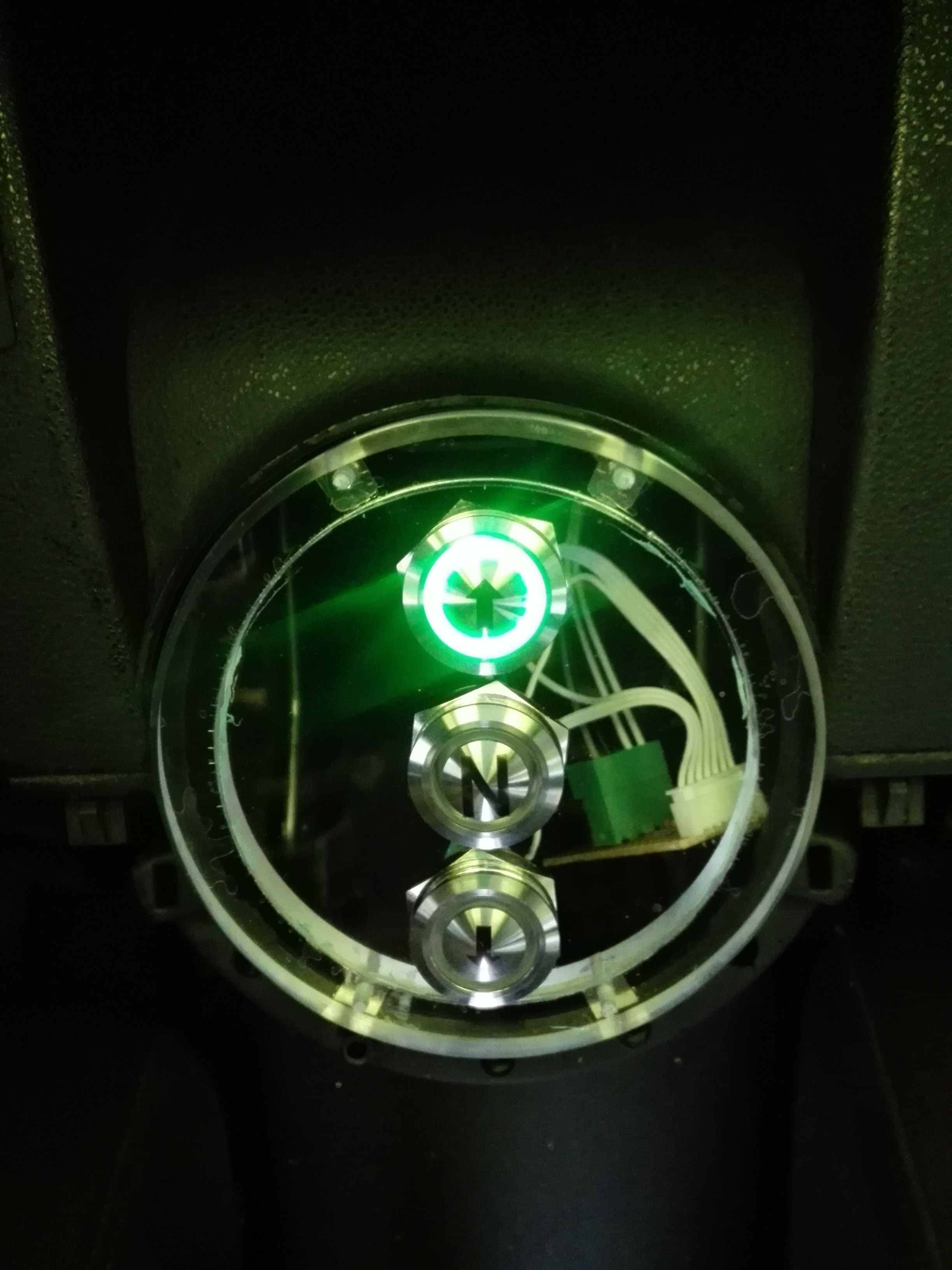

Today I did direction selection. Found it kind of pointless to have a "Neutral" so the buttons are working as follows:
- Inverter starts up in neutral
- When pressing brake and forward it will go into forward direction, vice versa for reverse
- When already in drive mode, pressing forward again will increase regen (4 levels, level 0 means off)
- N button decreases regen
- R button only changes into reverse when pressing brake and motor is below 100 rpm (logic of inverter)
The rev counter sits at 3000 rpm in idle and moves to higher speed when requesting power and to lower speed when regenning (proportional to DC current). When changing regen level it displays that for 1 second, 1000=level0, 4000=level3. Can't go to 0 as that would disable power steering.
Direction selection is done via resistor ladder on mprot input. Less wires to route. Actually I'm using the wire harness from the second lambda sond (4 wires). 12V, ladder, OC forward, OC reverse

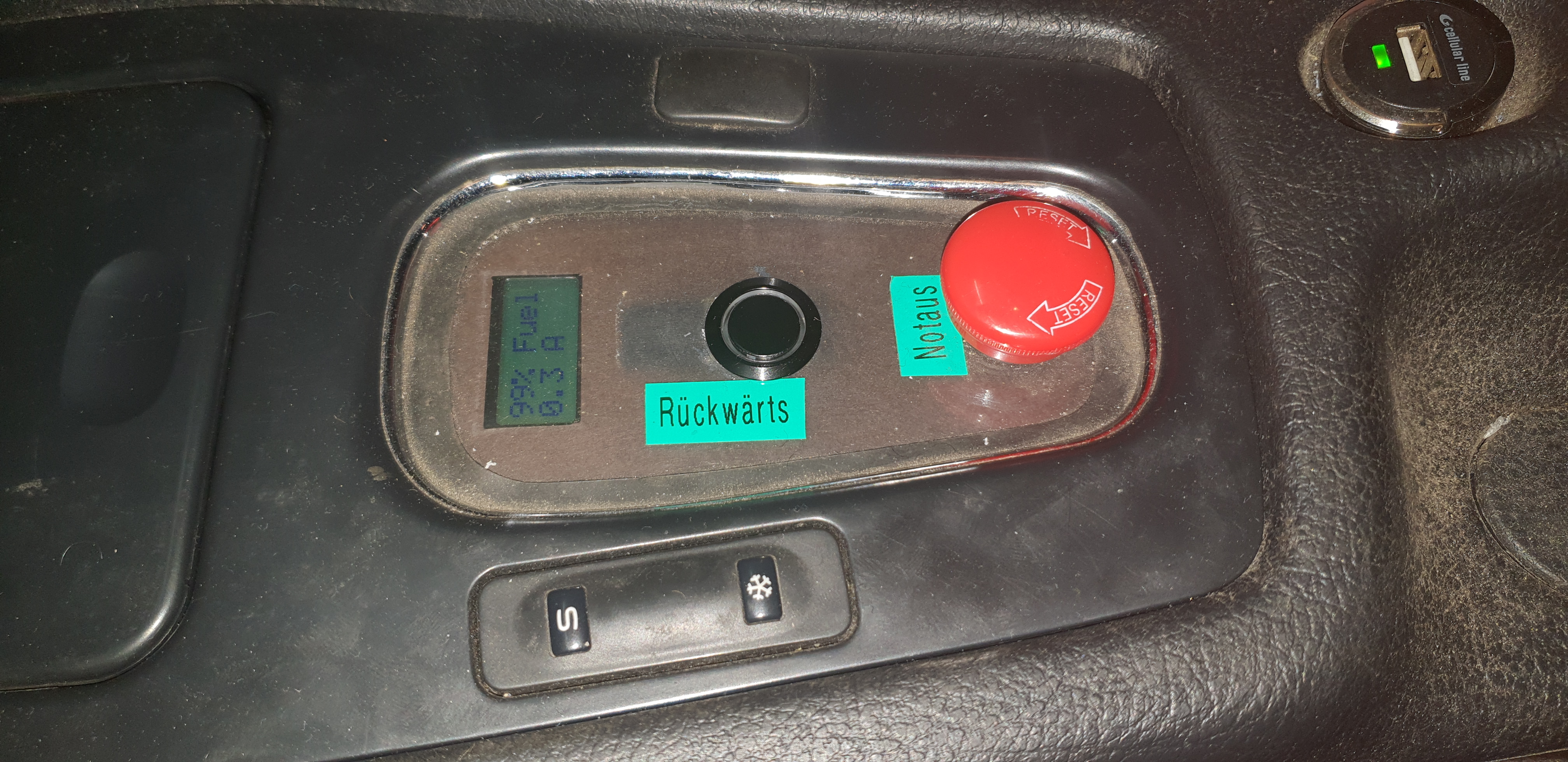

For more ideas...johu wrote: ↑Thu Mar 17, 2022 3:06 pm Today I did direction selection. Found it kind of pointless to have a "Neutral" so the buttons are working as follows:

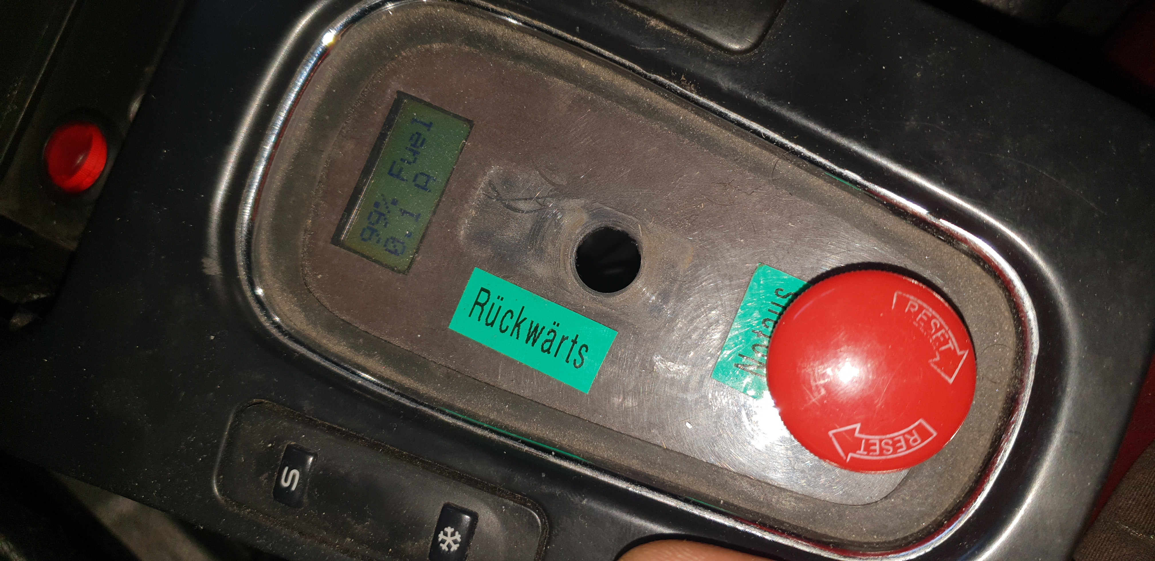

I just use a single latching switch with LED wired to reverse side. I use it in position Forward without LED and in Reverse with LED lit.
I simply use a series of relays to toggle ATX computer pins in predetermined way to show the car orientation on the dash.
So when i turn the key to 2nd position i get P illuminated.
When i apply start i get D illuminated.
If i toggle reverse i get R illuminated.
N is not affected by any position as the car is allways in neutral and i have to use handbrake to keep it on an incline.
Yes the brake interlock at start is active through the ATX computer pins. TUV Sud was content with implementation.
Photos of installation...
[/attachment]

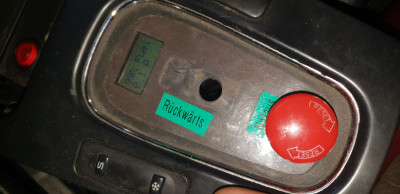

You have inverter setup a bit differently. Maybe you could use N pin as Notaus? You think your TUV would agree?
I also considered using N as a button, but i found out that Notaus is perfect for the job. I just never considered showing the N on the dash. It would require a lot of elaborate relay circuit. Hm... maybe it would be a good thing to have visual ID when notaus is pressed.
I have my inverter setup so it will pull controler enable pin to GND and this trips it unconscious. I use Notaus also with my Arduino DUE to disable inverter when charging.

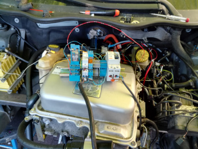

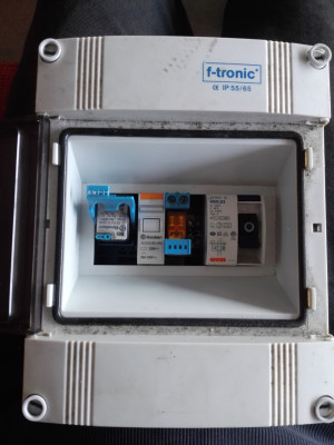

Today I worked on charging. Put together a DIN rail assembly
1. GFCI
2. Some terminal blocks
3. Charge enable relay, powers up the car, inverter etc.
4. AC relay
5. DC relay (also controlled by DC relay output of inverter). Enables the larger AC relay and also the DCDC enable signal
So now also the DC-DC enable problem is solved.
Charging via my lab supply worked flawlessly, basically pulled out the rectifier input from the AC relay and connected the 60V/16A lab supply instead. Then let the circuitry to its job. Worked.
Then I rigged up actual AC via a cooker element. The whole thing powered up but strange noises came from the inverter and smoke come from the heating element. Oh. Pulled out the plug, still smoking. Argh, DC came out from the A/C inverter and backpowered. Disconnected the cooker and finally everything switched off.
Next I tested connecting lab supply again. In one polarity it is a short. In the other polarity it seemed ok. So tried charging from the lab supply again resulting in a "bonk" from the inverter and power supply going into over voltage protection.
Next I checked that everything else still worked which thankfully it still did.
So either the rectifying diodes were overloaded or the A/C inverter actually tries doing something funky when it sees voltage on its output. Either way, I will replace those IGBTs with a proper bridge rectifier and try that.

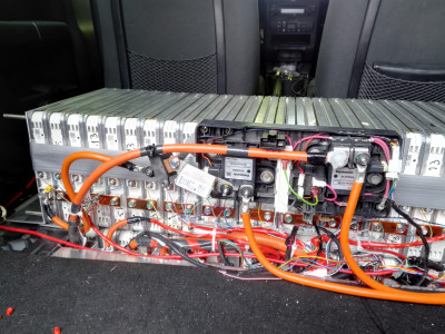

Oh and one more thing: replaced the heavy lead battery by a lighter LFP battery and relocated to the front.

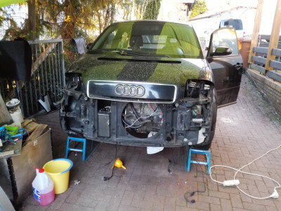

I have charging worked out now. Works a treat when replacing the IGBTs in the A/C inverter by a simple rectifier.
The power factor leaves something to be desired and I have to check what happens when the car is still turned on and then plugged in.
The reason for poor power factor is most likely a slow current sensor. It adds too much phase shift so the P-controller tries to counteract current that is no longer there or fails to compensate for current that is already there. I can still charge at roughly 3 kW, so might just leave it like that.

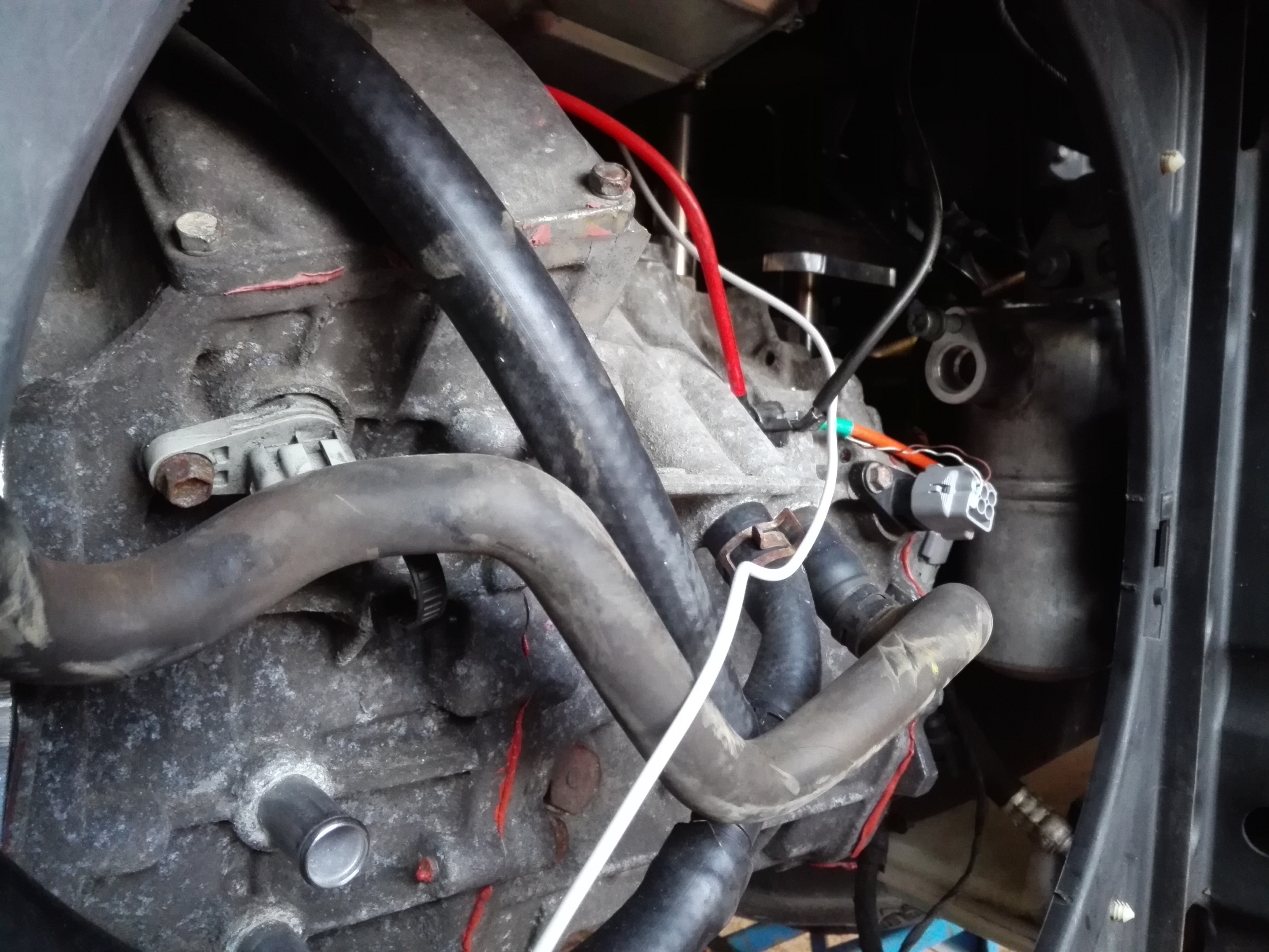

Put all the charging switchgear into a box.
Next I installed the A/C pipes from cabin to dryer and radiator. They actually fit rather well!
Then tried a test fit of the Audis front assembly. While it fits by itself it doesn't fit with the fan installed. The transmission sits too far forward. So need to do something about that fan, maybe a smaller one will do (it only runs A/C).
Also it seems the A/C pipes from dryer to compressor might not clear the transmission. I currently don't have them here, will see later.
