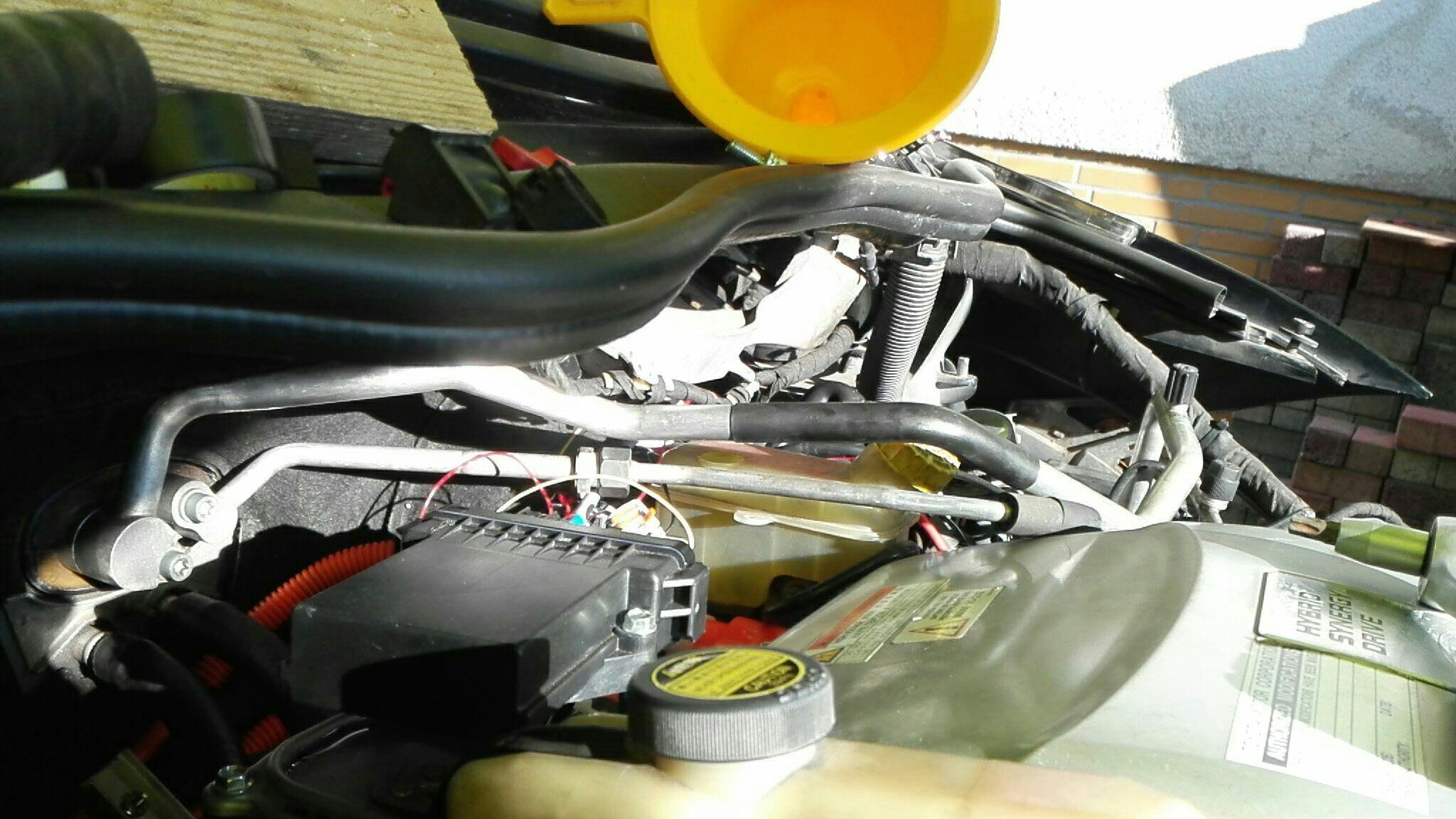

I just use a single latching switch with LED wired to reverse side. I use it in position Forward without LED and in Reverse with LED lit.
I simply use a series of relays to toggle ATX computer pins in predetermined way to show the car orientation on the dash.
So when i turn the key to 2nd position i get P illuminated.
When i apply start i get D illuminated.
If i toggle reverse i get R illuminated.
N is not affected by any position as the car is allways in neutral and i have to use handbrake to keep it on an incline.
Yes the brake interlock at start is active through the ATX computer pins. TUV Sud was content with implementation.
Photos of installation...
[/attachment]

Put all the charging switchgear into a box.
Next I installed the A/C pipes from cabin to dryer and radiator. They actually fit rather well!
Then tried a test fit of the Audis front assembly. While it fits by itself it doesn't fit with the fan installed. The transmission sits too far forward. So need to do something about that fan, maybe a smaller one will do (it only runs A/C).
Also it seems the A/C pipes from dryer to compressor might not clear the transmission. I currently don't have them here, will see later.
