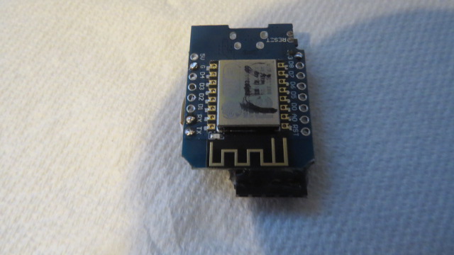

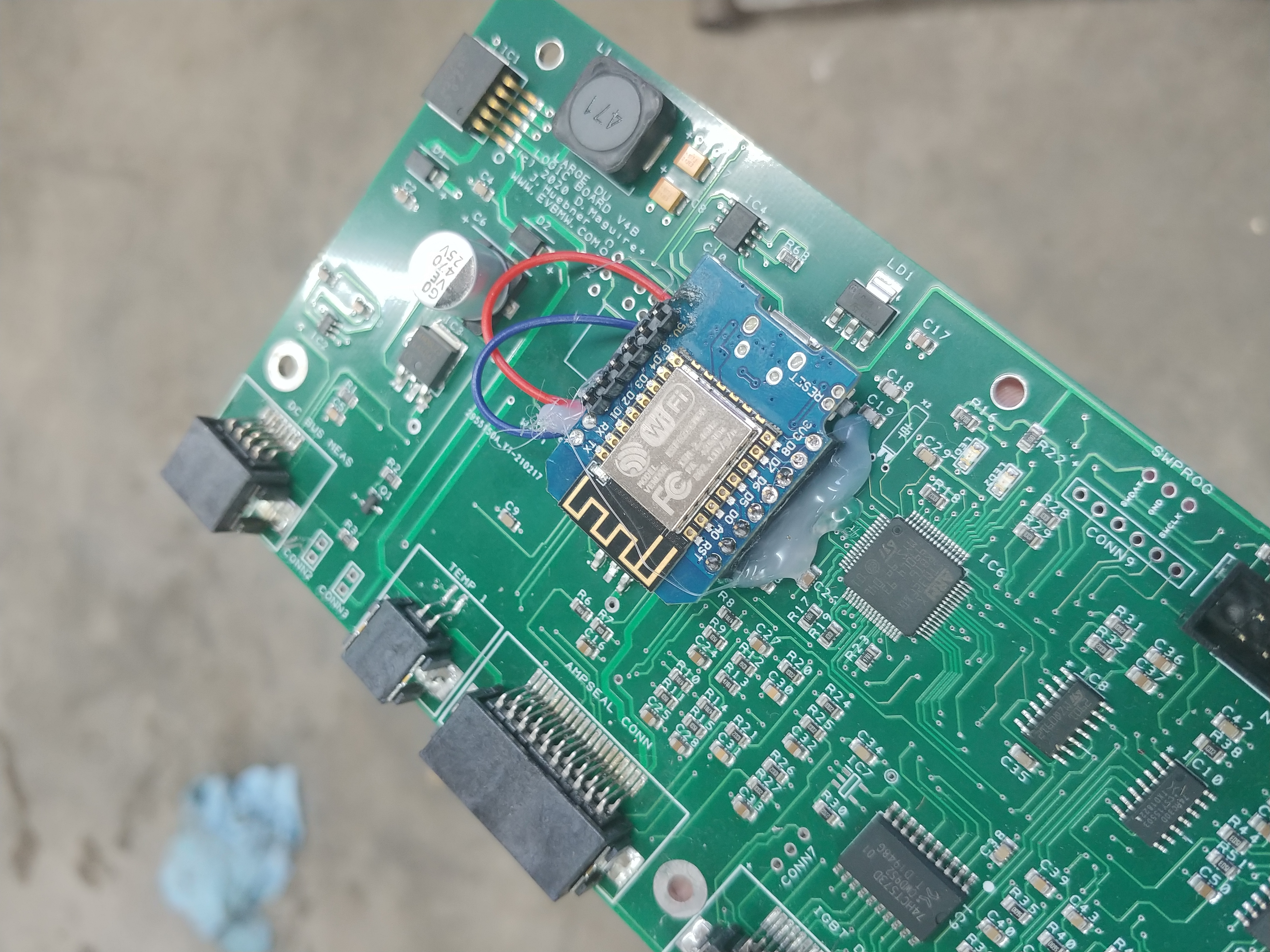

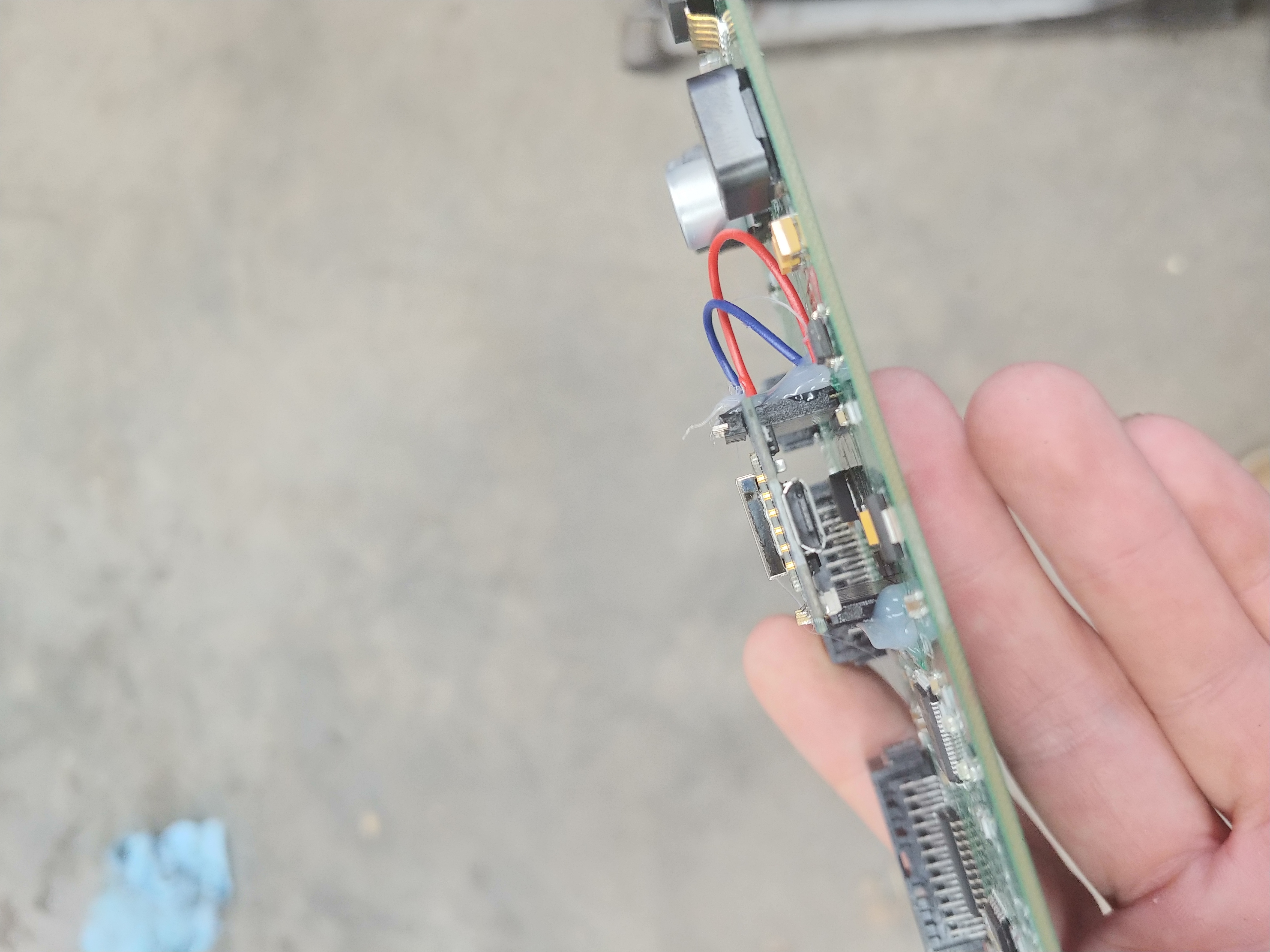

To upgrade to the commercial firmware in my Gen 2 charger V5 I ended up using a Wemos D1. Tried to program the stock 8266 with no luck. The D1 took the first time. I've uploaded a couple pics to show how I installed it as it has a bigger footprint. I used 2, 5 wide connectors and plugged them into the board with some glue between to bond them together. The header pins are staggered on the board so this way I knew there were plugged in all the way. Then I removed them once bonded and hot glued it to the D1 board. Used 4 short wires to do the connections. Plugged the board in and tested it. After testing a put a spot of hot glue on the one corner next to the black connector on the board to make so it would not vibrate loose. I also added a piece of electrical tape to the top of the D1 board because it was close to the aluminum cover, I don't think it touches but better save than sorry. Worked great.

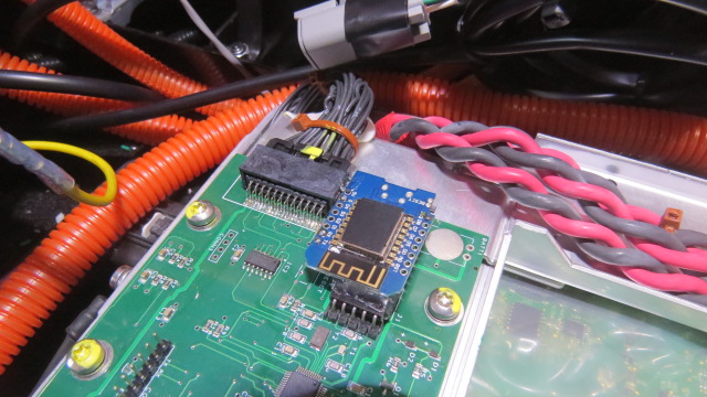

Re: Olimex MOD-WIFI-ESP8266 alternatives
Has anyone used a nodeMCU in place of the Olimex device? I'm trying to use this on a ZombieVerter.
I have loaded FSBrowser.ino.modwifi.bin bootloader using the esptool.py as described in the Olimex MOD-WIFI-ESP8266 wiki page.
The arduino software came from Johannes Huebner esp8266-web-interface on github
I've loaded the SPIFF files via Arduino and then loaded the LittleFS files and main .ino program.
All the above loaded without error but the server didn't start as I couldn't see a new network with an SSID of inverter
Has anyone sucessfully done this and if so, how dd you do it?
EDIT: after digging around for a day I found this. viewtopic.php?p=46247&sid=d758ca4f16bf7 ... d2b#p46247
Problem solved, although, for me, the SPIFF route worked, the LittleFS didn't - I don't know why!
Resolution to D1 mini and NodeMCU comms failure...
viewtopic.php?p=48518#p48518
