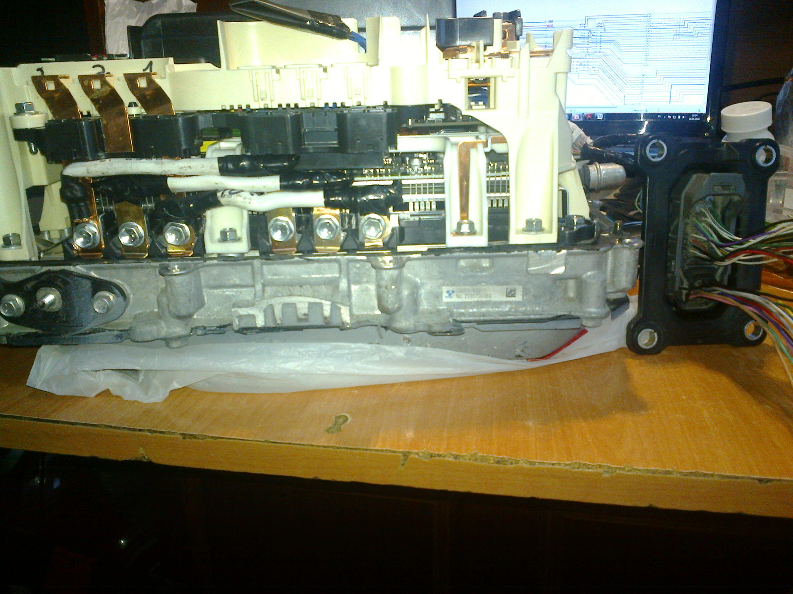

у меня хорошие новости от меня для гиорги.
инвертор готов дальнейшим испытаний.
I have good news from me for the giorgi.
the inverter is ready for further testing.

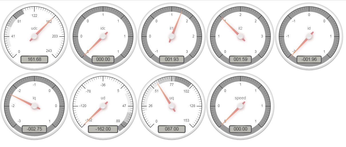

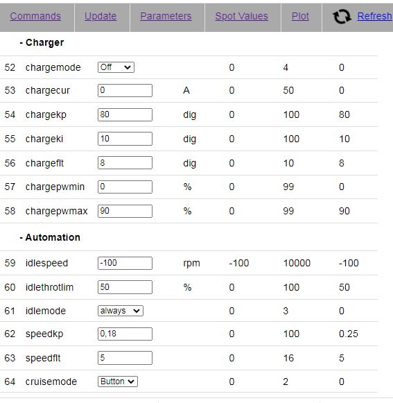

Hello everyone. The inverter was started from 12 volts, the Wi-Fi works, the gas pedal was set up as needed. We have a question. What are the parameters for the inverter for my engine, as a person wrote in my category parameters for my Lexus RX400h engine. Do I need to change them? And I will not have a recovery and brake pedal, I did not connect the changeable part, but only with the 12-volt brake plug in the right place. What parameters do I enable that will not recuperate and brake the rheostat pedal in the circuit?

I'm looking for someone to pay for money, transfer to a bank card, via video link, help set up the inverter. everything is connected, there is a pre-charge, the gas pedal is active. I don't need brakes and recuperation, but the signal from the brake contact was brought to the inverter. if the language is English, then we will try to guess and show the Wi-Fi table from the video and follow the instructions. the batteries are 42 volts ready, 14 volts too. who can help for payment, this work is not free, it is very necessary.

a synchronous economical and high-speed electric motor spun. but there are interruptions in work. it is necessary to adjust the voltage and restore 5 volts on the plate, as well as the table of settings of this program is needed for this electric motor

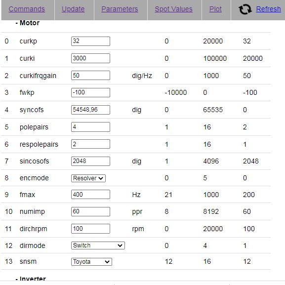

Почему двигатель так странно себя ведет? :o
Why does the engine behave so strangely? :o
что я сделала неправильно? :(
what did i do wrong? :(
вроде бы все сделал по инструкции йоханнеса и дэмиена
it seems that he did everything according to the instructions of Johannes and Damien
люди добрые прошу вас помогите :cry:
good people, please help me :cry:
ZooKeeper
Posts: 507
Location: USA
Re: Toyota Avalon Hibrid 4*4
Post by ZooKeeper »
mikmur wrote: Wed Jun 30, 2021 6:19 pm Почему двигатель так странно себя ведет? :o
I am not an expert, not at all, but the parameters are significantly different than those I had success with. Obviously the deadtime is needed on your inverter and not mine as shown below:
"curkp": 32,
"curki": 20000,
"curkifrqgain": 50,
"fwkp": -100,
"dmargin": -2000,
"syncofs": 10975,
"polepairs": 4,
"respolepairs": 2,
"encmode": 4,
"fmax": 400,
"numimp": 16,
"dirchrpm": 50,
"dirmode": 1,
"snsm": 16,
"pwmfrq": 1,
"pwmpol": 0,
"deadtime": 0,
"ocurlim": 50,

Hello everybody.
после долгих мучений мотор вроде нормально раскрутился.
after long torment, the engine seemed to spin normally.
для установки sincosofs необходимо измерить напряжение с энкодера (после резистивного делителя)
to install the sincosofs, you need to measure the voltage from the encoder (after the resistive divider)
чтобы раскрутить мотор-редуктор медленно, руками, один оборот трудно.
to unwind the geared motor slowly, by hand, one revolution is difficult.
как-то раскрутил и замерил напряжение между GND и с энкодера (после резистивного делителя).
somehow unwound and measured the voltage between GND and from the encoder (after the resistive divider).
от минимум бил 0 вольт, до максимума 0,65 вольт.
from a minimum beat 0 volts, to a maximum of 0.65 volts.
according to instructions (((U1+U2)/2)/3.3)X4096
U1=0.00V
U2=0.65V
Sincosofs=806.78
вот видео и если что не так с параметрами жду комментариев
here is a video and if something is wrong with the parameters I am waiting for comments
