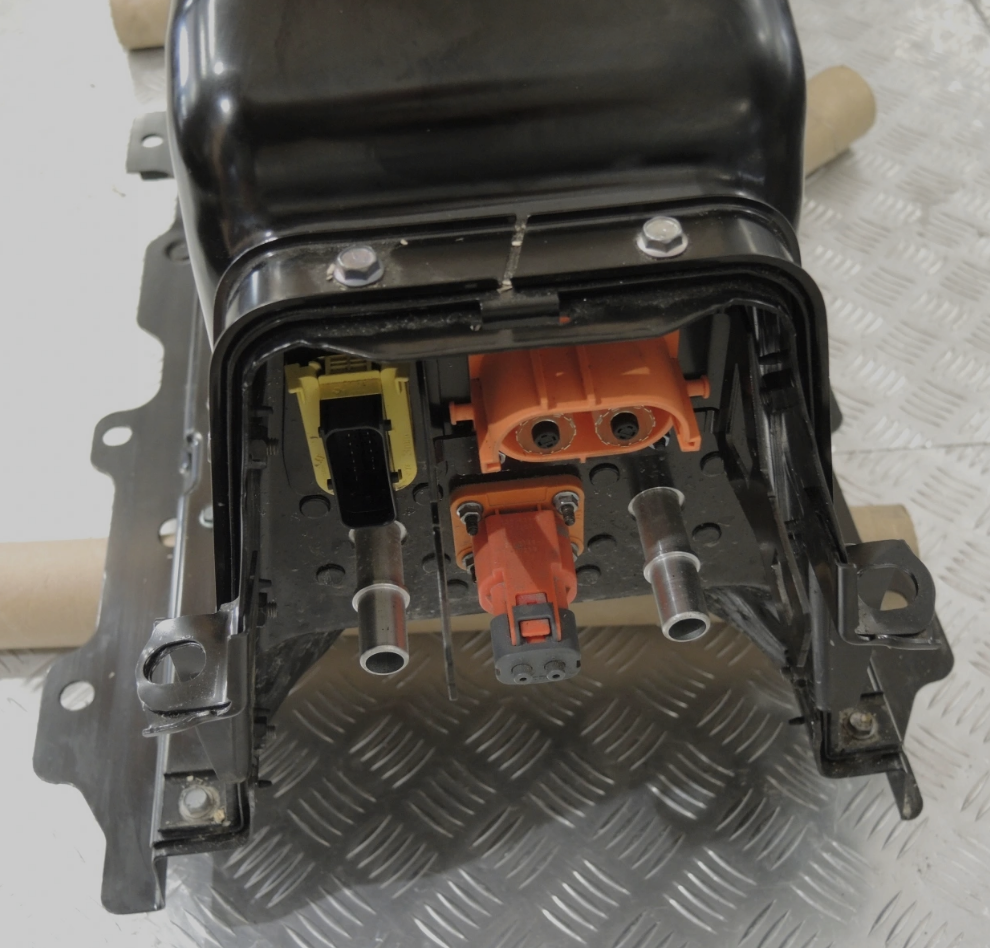

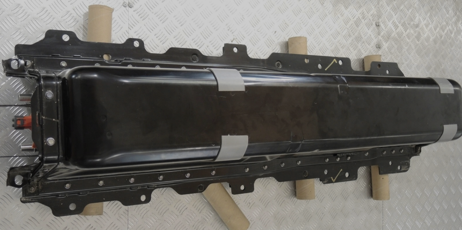

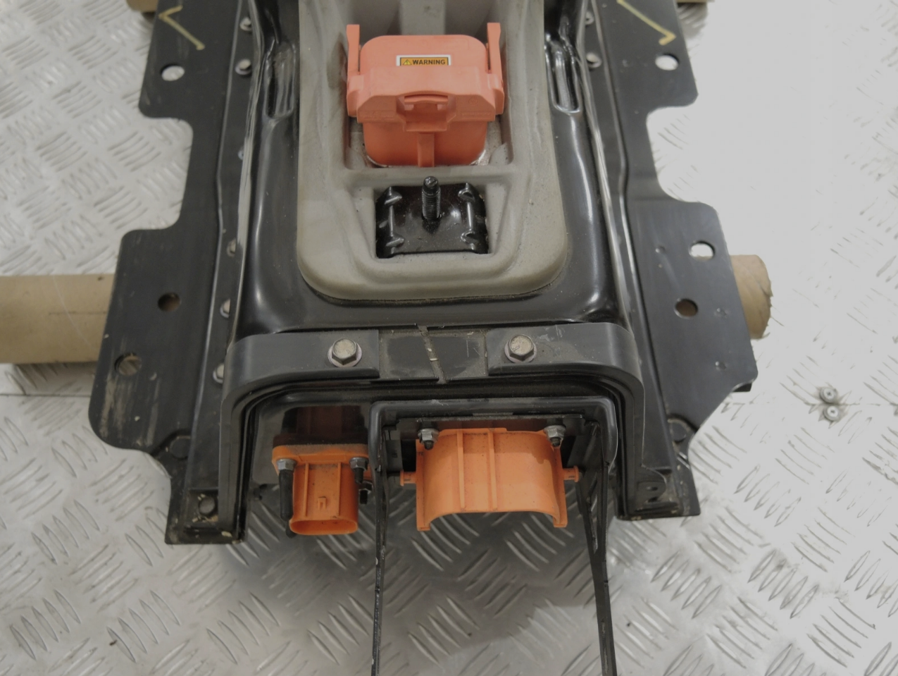

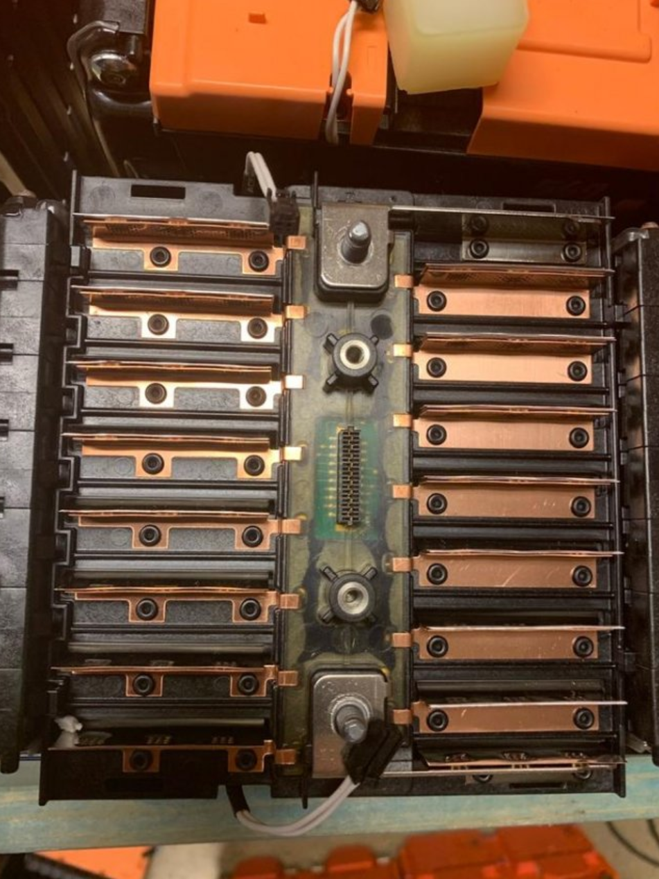

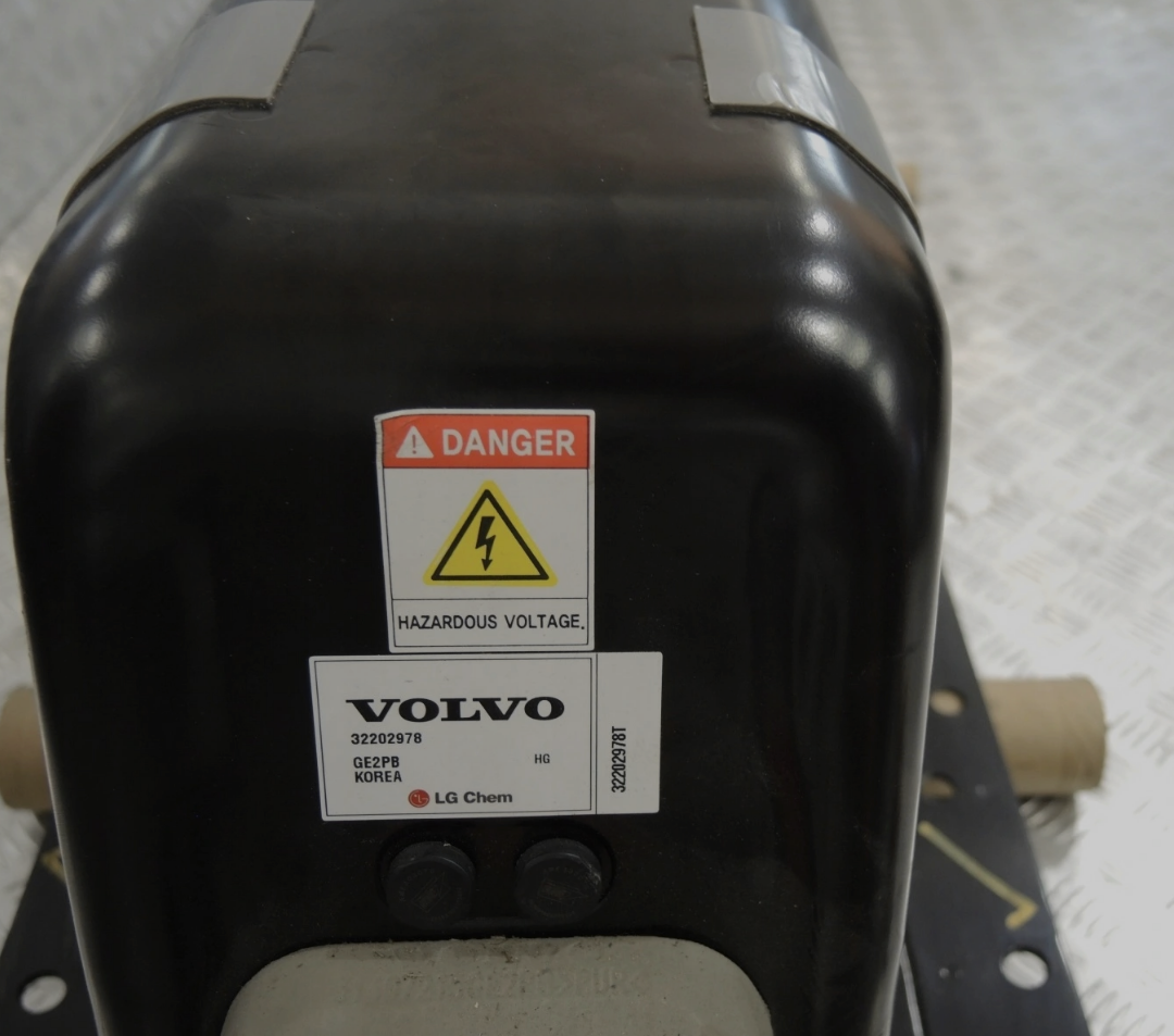

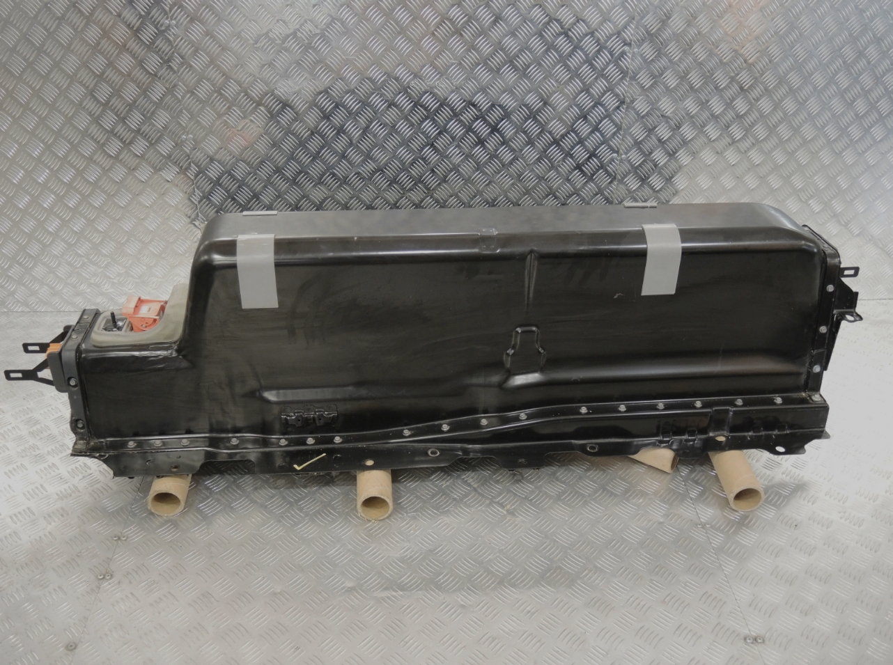

Anyone dissected this patient?
This one is form Volvo hybrid XC90.

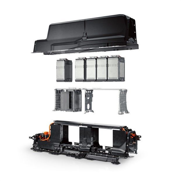

So from the video:
Chemistry: pouch Li-NMC, nom: 3.65V, max: 4.2V
Capacity: 12kWh
Voltage: 350V
Construction: 6x16S with liquid cooled plates in-between
weight: 16S = 13.6kg so whole pack = 81.6kg (with case and jewelry about 90-100kg)
Contactors: 450V 150A

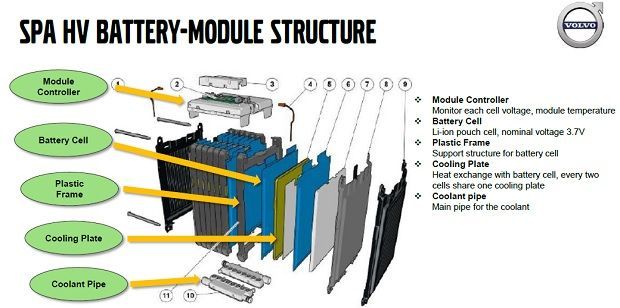

Any pictures of the modules and their BMS/CMC?

You can see in the video.
There is no BMS, only BMU.

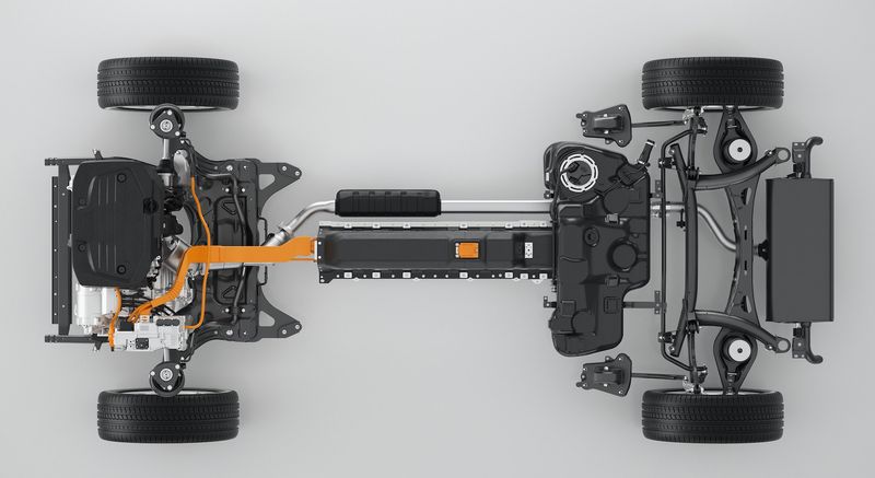

Volvo is delivering a battery electric vehicle based on its CMA products. And a pure electric car on its larger Scalable Product Architecture (SPA) from 2019.
T8 Twin Engine AWD on SPA platform (top) and T5 Twin Engine on CMA platform (bottom).
T5 Twin Engine platform
T8 platform

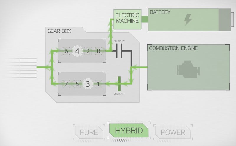

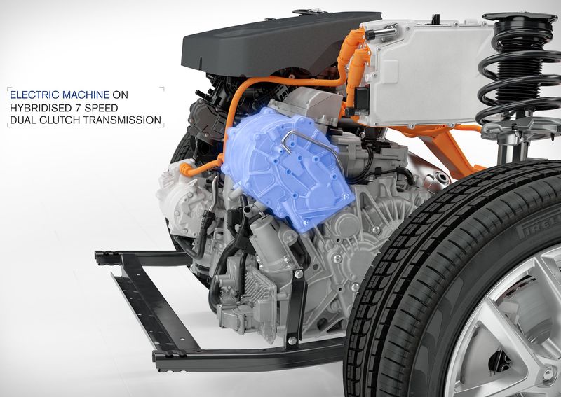

Hybridized 7-speed Dual Clutch Transmission on T5 Twin Engine PHEV

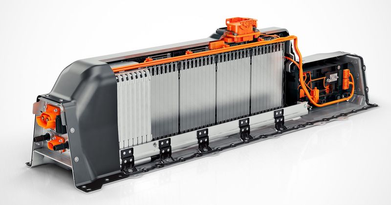

battery pack for T5 Twin Engine
Construction of the pack is similar to the Chevrolet Volt battery. https://www.researchgate.net/figure/The ... _341765274

EV_Builder wrote: Tue Jun 22, 2021 9:07 pm Any pictures of the modules and their BMS/CMC?
