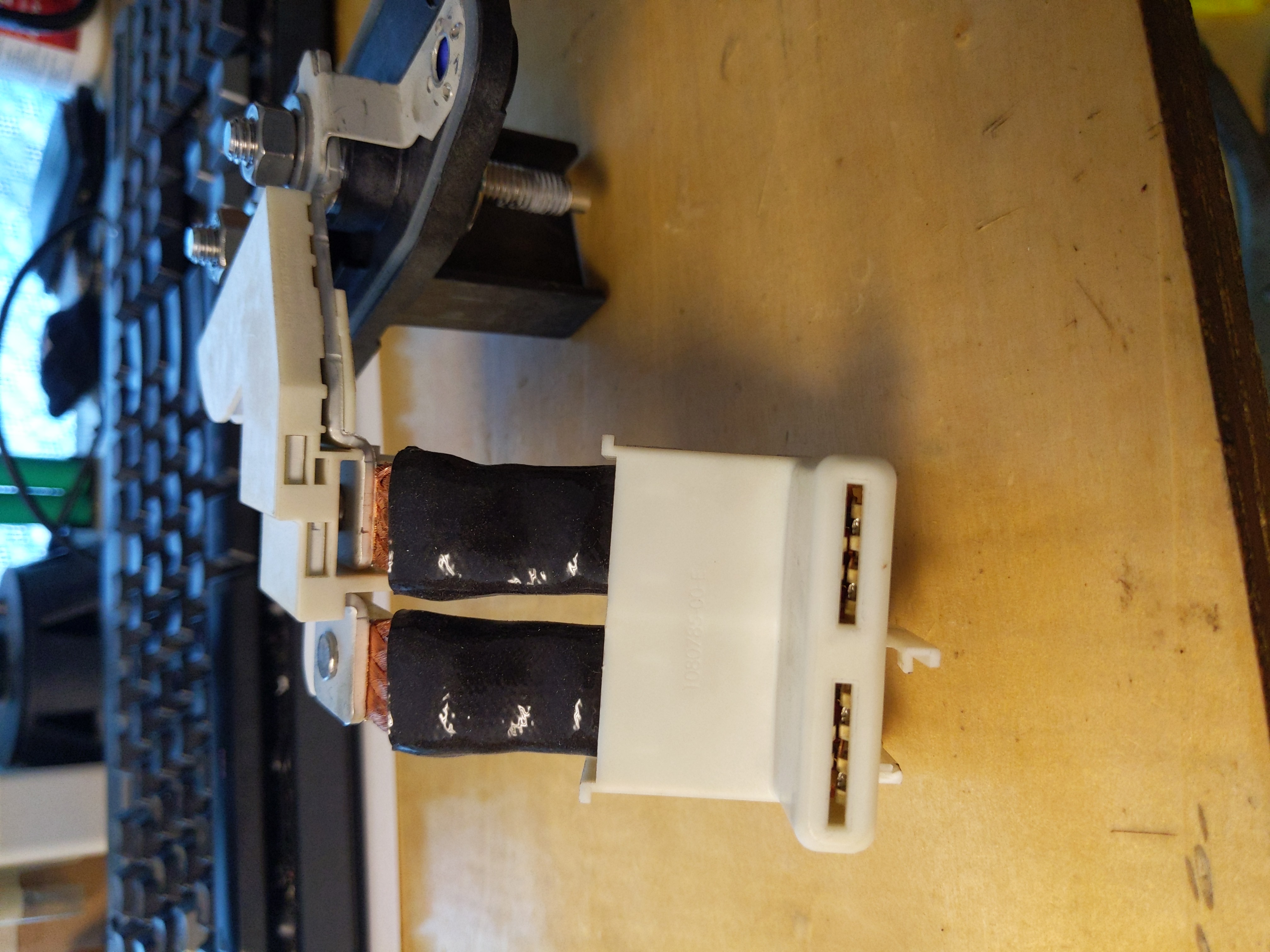

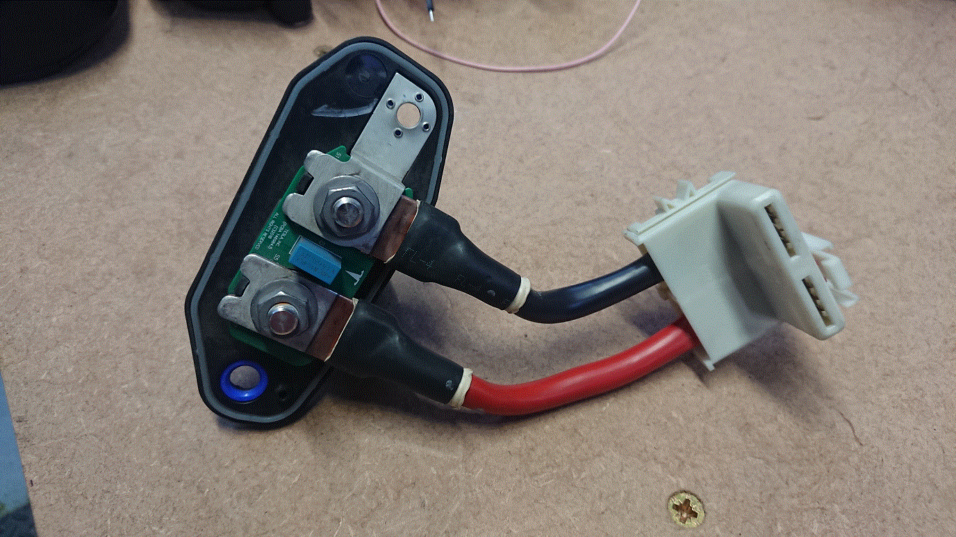

I disassembled my pack myself, so hopefully I can help here. This is the HVDC connector into the PCS.
Exposed HVDC contacts
HVDC connector labels
HVDC connector plug
HVDC connector plug
I think it is either made to spec for Tesla or it is a Tesla made part, none of the numbers turn up anything other than identical salvage parts.
EDIT: Some searching on Digikey turned up these TE contacts that look similar, and based on their drawings would fit. I choke on 14$/pc :|
https://www.digikey.com/en/products/det ... -2/2327759

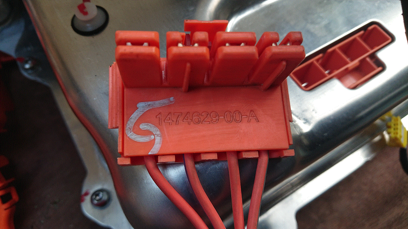

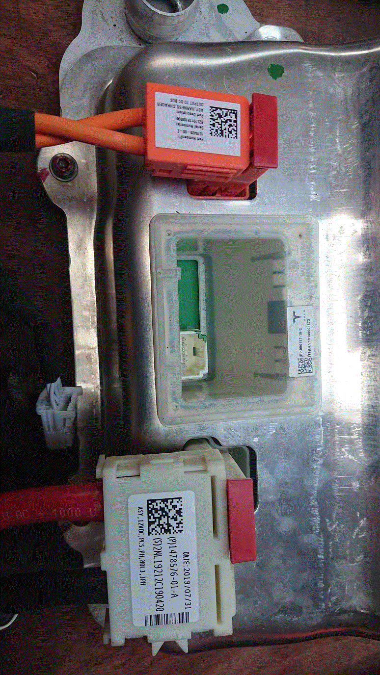

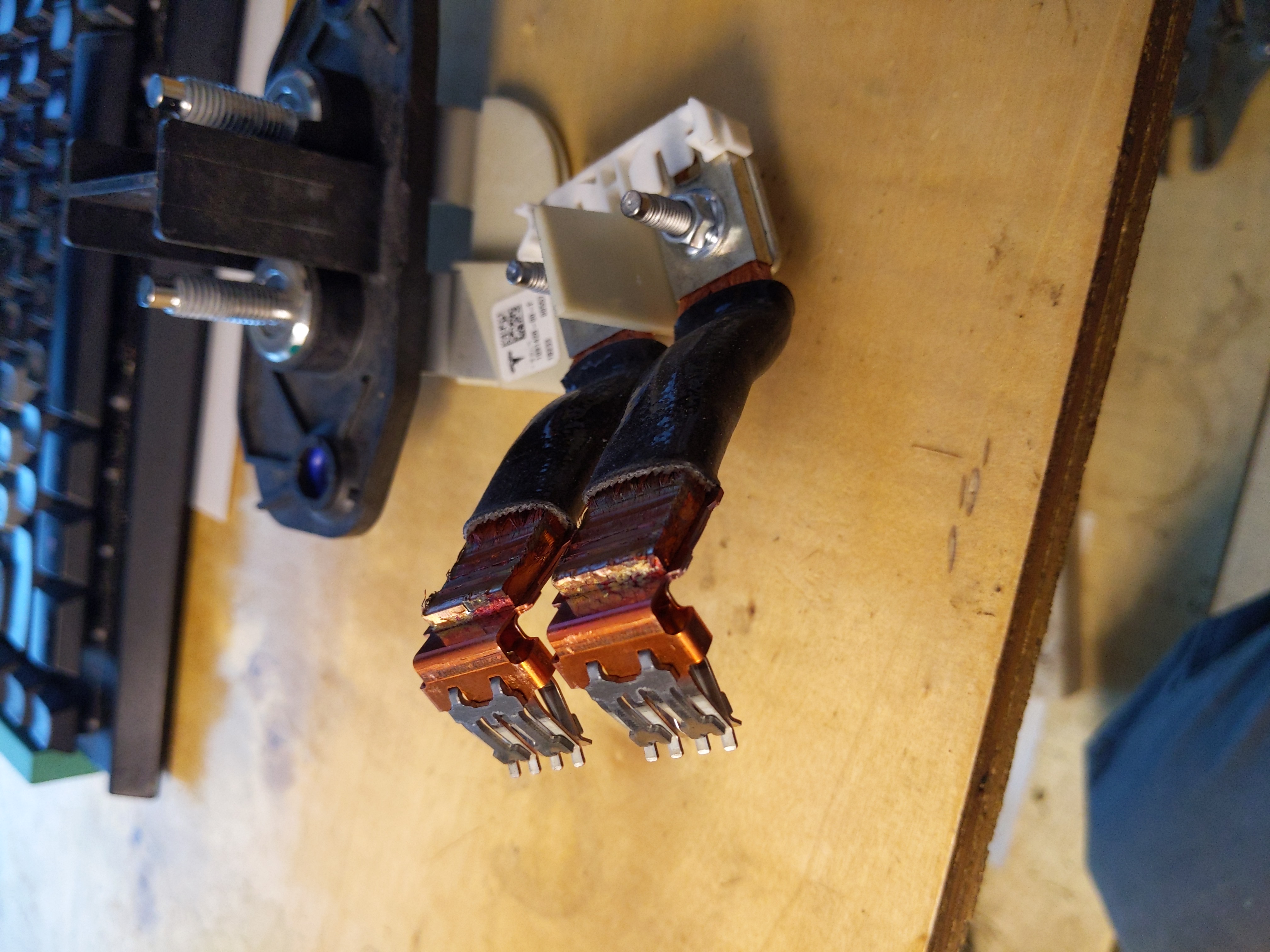

Just checked the connectors I have and slight differences. See photos and the stamped codes on the plugs:

Did your connector come from the factory with red and black cables?
nkiernan
Posts: 589
Has thanked: 514 times
Been thanked: 95 times
Post by nkiernan »
Ken_S wrote: Wed May 19, 2021 9:50 pm Did your connector come from the factory with red and black cables?
Yes, came as part of the pack:

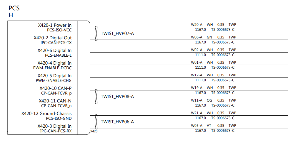

Can you double check the X420 pinout in your PDF? I only ask because I am re-using the harness from my pack, and in the harness connector to X420, there are no wires in the sockets for pins 10,11, or 12, at least according to the pin numbering defined in the connector datasheet. What pin numbering are you using?
Posts: 4000
Been thanked: 1114 times
That's interesting. So pins 10 and 11 are cp can that is not used by the pcs anyway. Sounds like they deleted them from the loom. Pin 12 is a ground that actually needs to be connected to the case of the pcs so I would also suspect they deleted that in favor of just using the case ground. My pin numbering is as per the service manual wiring diagram. The Wxx numbers are actually printed on the wires so you could check those.

Jack Bauer wrote: Mon May 24, 2021 9:09 am That's interesting. So pins 10 and 11 are cp can that is not used by the pcs anyway. Sounds like they deleted them from the loom. Pin 12 is a ground that actually needs to be connected to the case of the pcs so I would also suspect they deleted that in favor of just using the case ground. My pin numbering is as per the service manual wiring diagram. The Wxx numbers are actually printed on the wires so you could check those.
Thanks for confirming. I wasn't aware the service manual was openly available, I should have googled it a year ago:) Attaching a screenshot here for others to reference.
LHD 2018 model 3 PCS x420 Tesla harness pinout
/wrong At a glance it does seem like Tesla isn't using the connector manufacturers suggested pin 1, I will confirm in the morning. /wrong
EDIT: After further review, Tesla does in fact use the manufacturers suggested pin numbering scheme in X420... I incorrecly assumed the connector used a "snake" numbering pattern, which was incorrect. Below is a clip of the connector datasheet with the suggested pin numbering schemed Tesla uses.
Manufacturer/Tesla X420 connector pin numbering

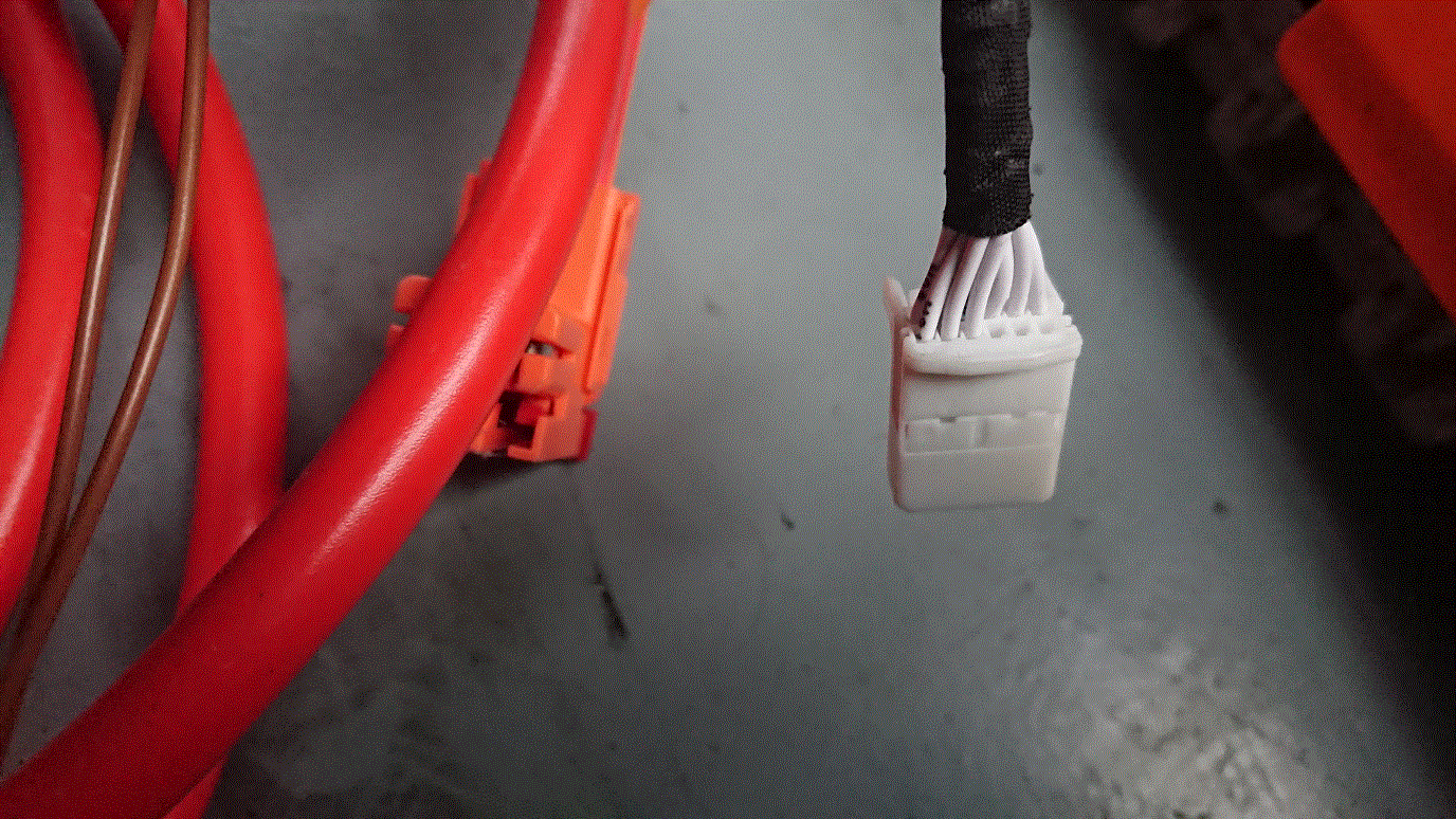

Attaching photos of the X420 connector I have for info, last three pins not used on this one either. Just got hold of service manual and wiring diagrams, send a PM

nkiernan wrote: Tue May 25, 2021 9:43 am Attaching photos of the X420 connector I have for info, last three pins not used on this one either. Just got hold of service manual and wiring diagrams, send a PM
I just went though the wire labels and the connector datasheet again, turns out I was wrong. Tesla is using the manufacturers pin numbering scheme, I just mis-identified the unused positions 7,8,9 as 10,11,12.
I edited my post above with the correct pin numbering scheme, so as to minimize future confusion.
