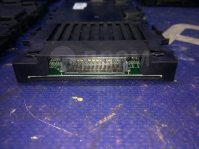

chuuux
Posts: 68
Joined: Fri Mar 12, 2021 5:11 am
Location: Ural
Re: Outlander CMU Simp BMS
Post by chuuux »
Hi folks.
Does anyone have a wiring diagram for connecting the balance wires to the cells? This socket pinout?
I got some of Outlander CMU, but the balance connector and wires are missing.
